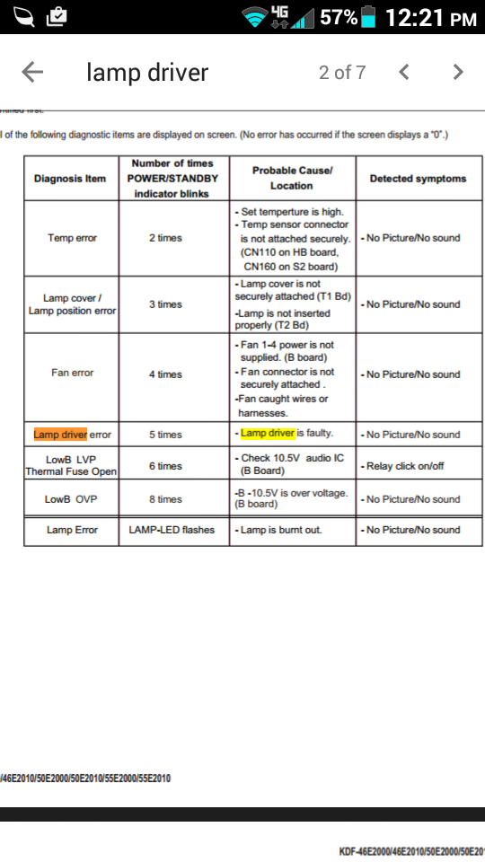

    Hey I got this TV and turned on and worked fine the later turned off. The light blinks red 5 times. Sony said that means a bad tcon board. I took the TV apart and the only visual damage is what I believe is the optical block. Anyway I'm trying to figure out what is the tcon board and is there a way to test it.

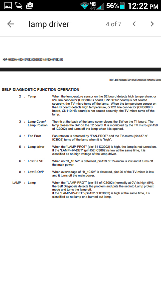

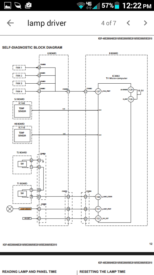

    Re: Sony Wega kdf-55e2000
    Here are some screen shots of the manual. I. Not sure what it all means but it looks relevant

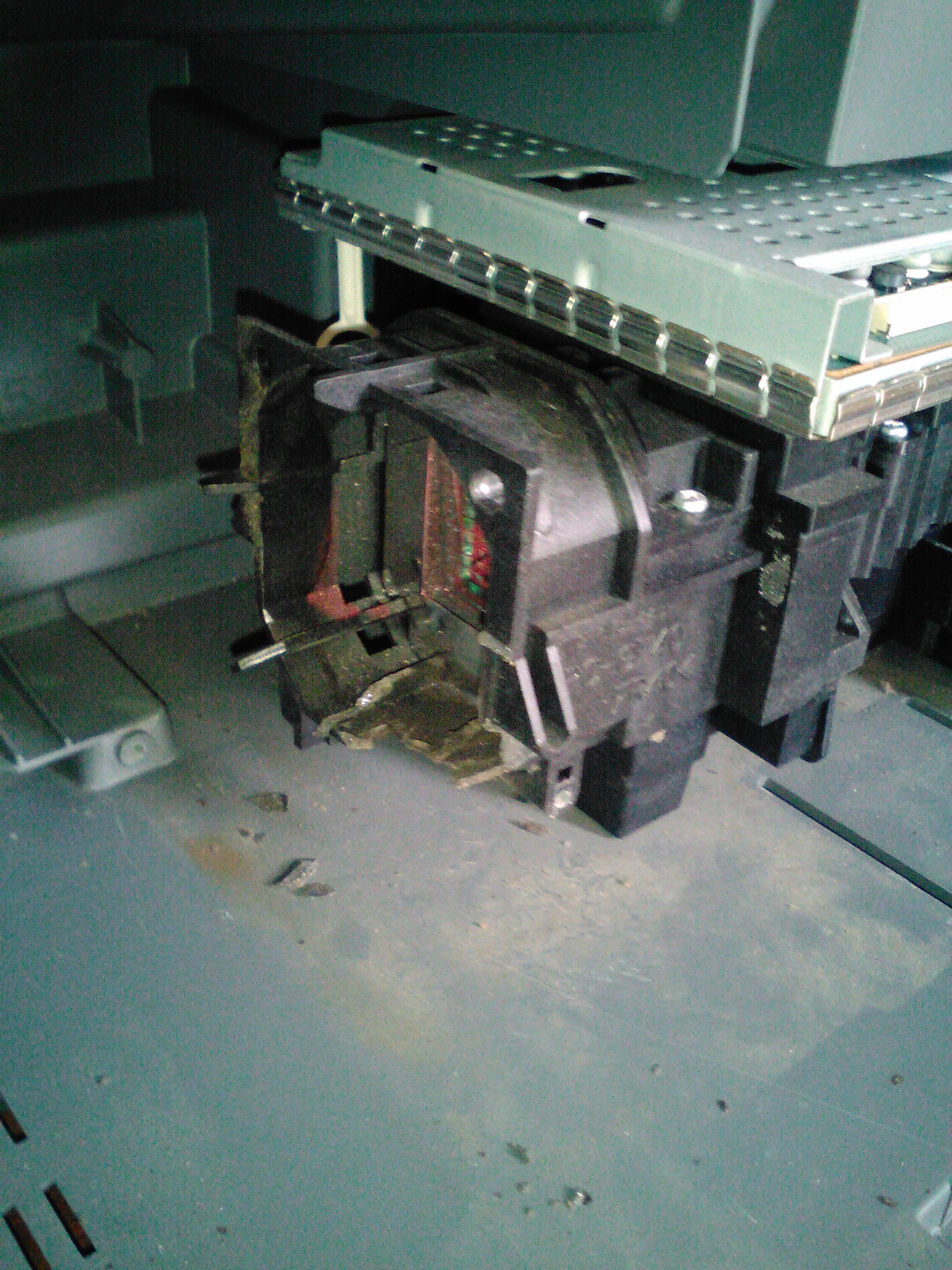

        OK now this is what I believe is the lamp driver but I don't know. I'm thinking this may be the piece that needsbto be replaced. The part in my hands is the part the lamp plugs into. I thought this was a power supply but now I don't know.
          Bad ballast module,
            So would that be what the lamp plugs in too which I'll try again to post a picture of. And would that damage on the optical block cause a problem?

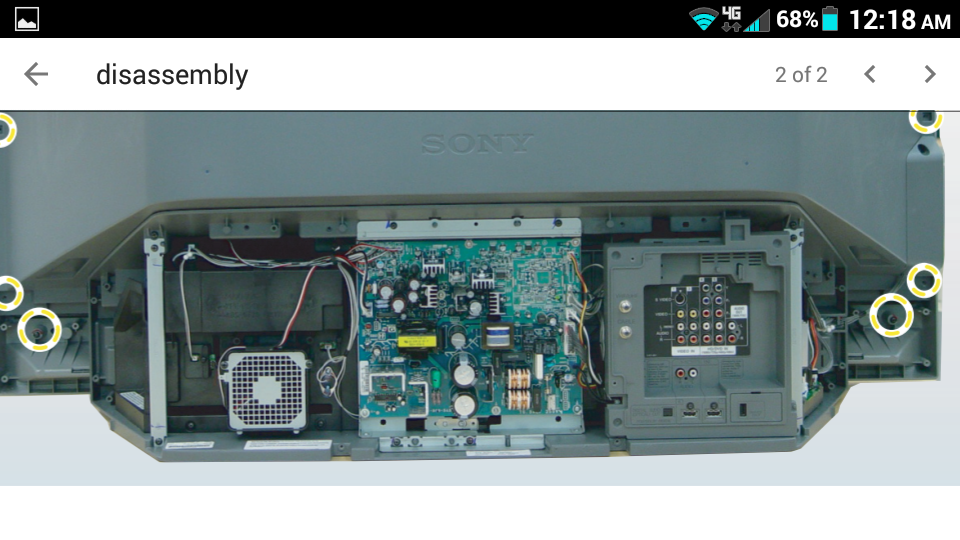

                    Ok your thread gets overlooked because you are talking to yourself and it seems you are being helped via the post count.
                    Ok 5 blinks means Tcon yet you change lamps?... Then you say its a bad ballast????
                    Slow down there, You do not know what a T-Con is so you don't know very much if anything about TV repairs... It is one of the basic boards of a TV.
                    Provide pictures of each board and one of the entire back of the TV so we can see how everything is connected.
                      OK here are some pictures of the disassembly and the TV is all took apart.

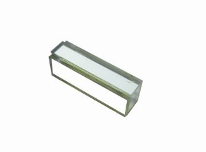

                                      Better known as light tunnel
                                      • R_J
                                        • Jun 2012
                                        • 9624
                                        The light engine is the complete assembly of mirrors, polarizer filters, some consider the optical block as the lcd/prism assembly.
                                        The light tunnel, see picture (only in dlp optics) is only part of a light engine, a bad light tunnel will usually cause a shadow on one of the sides, top or bottom of the picture, and usually will not effect the whole picture.
                                        LCD projection does not use a light tunnel or color wheel.
                                        I found this information but disassmbly of the optics is not an easy job and not for everyone.
