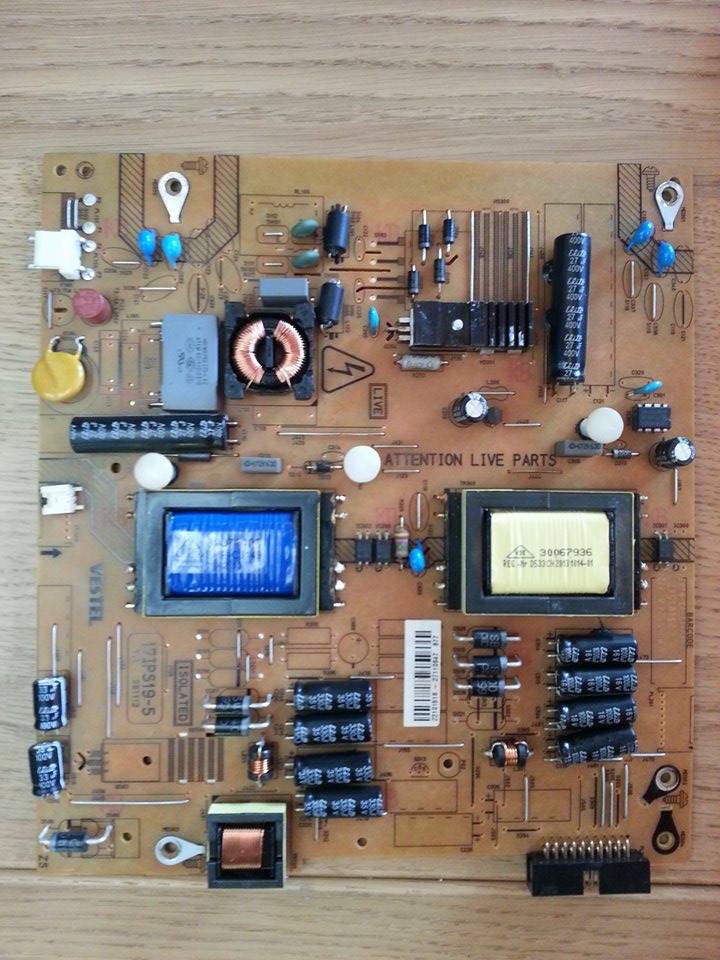

  • leo-saphira
    • Feb 2015
    • 32
    Re: HITACHI 32HXC01U - No backlight
    Image of the board:

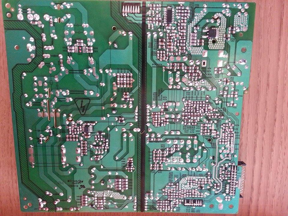

    • leo-saphira
      • Feb 2015
      • 32
      Re: HITACHI 32HXC01U - No backlight - Vestal 17IPS19-5 V.1 061112
      and the rear photo

        It looks like the same board as used in this TV:
        https://www.badcaps.net/forum/showthread.php?t=34222
        Can we see the whole back side of the TV so we can see how all the boards and the LED strings are connected together?
        We will have to check the DCV on the bottom left section (3 diodes, 3 large caps and 2 small caps) which is the LED driver circuit. You can check the DVC on those caps, measure them between the two legs of the caps.
          A known fault on these is shorted diode and FET in boost stage causing 24V to drop out.
          The set I had had a continuous flashing LED code, some might just not turn the backlight on (it depends on the design, if the main board uses 24V or not)
