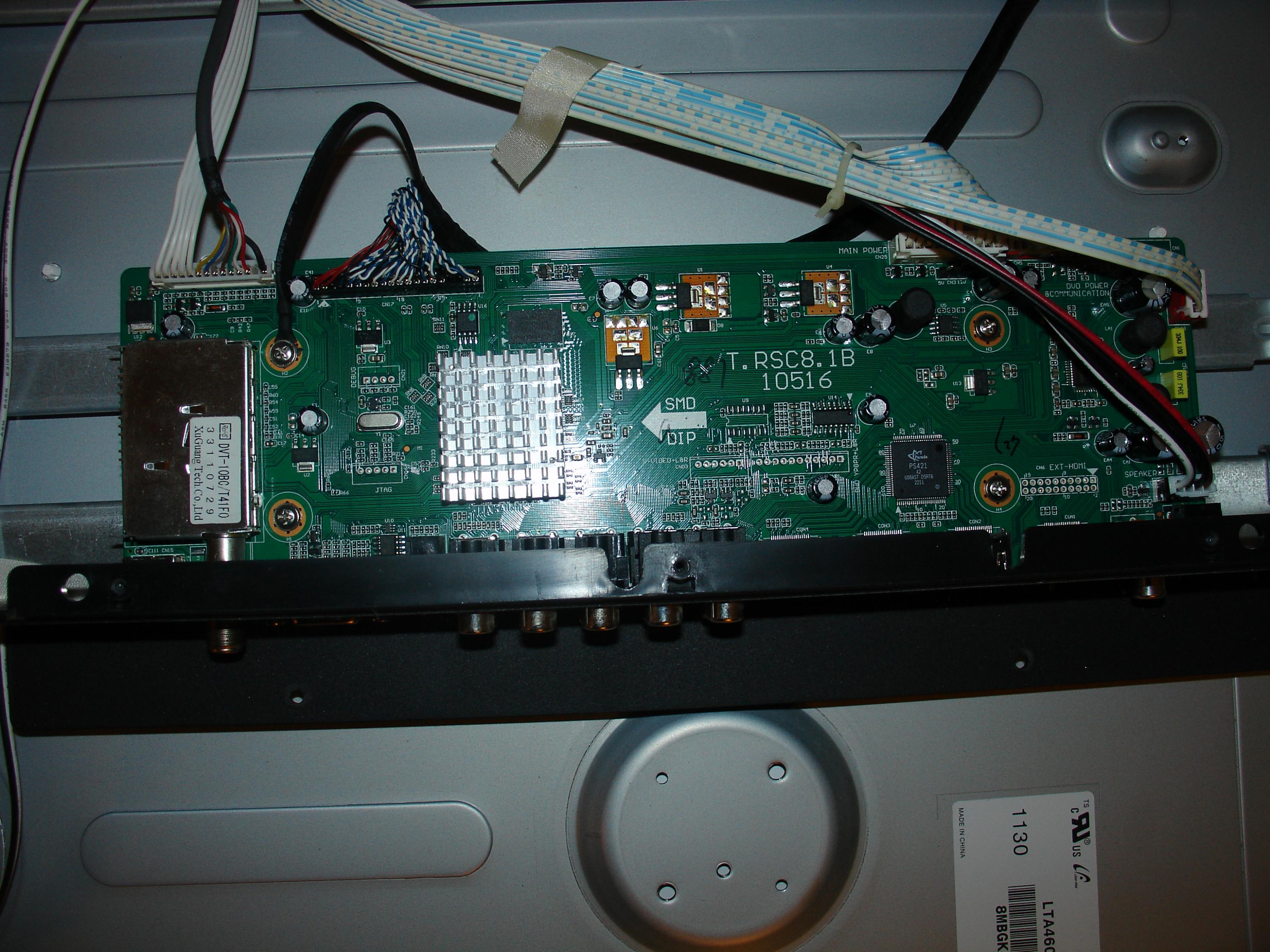

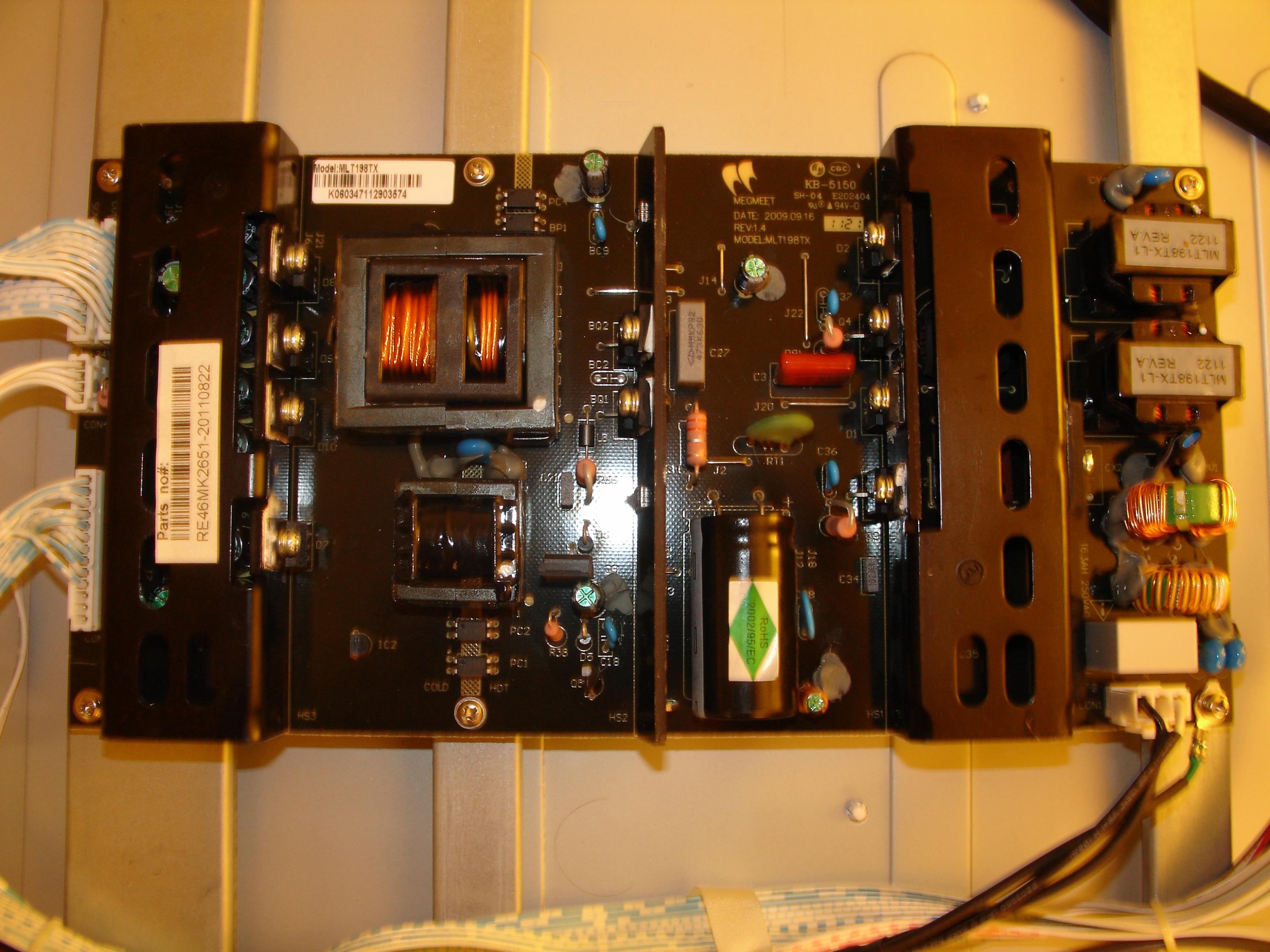

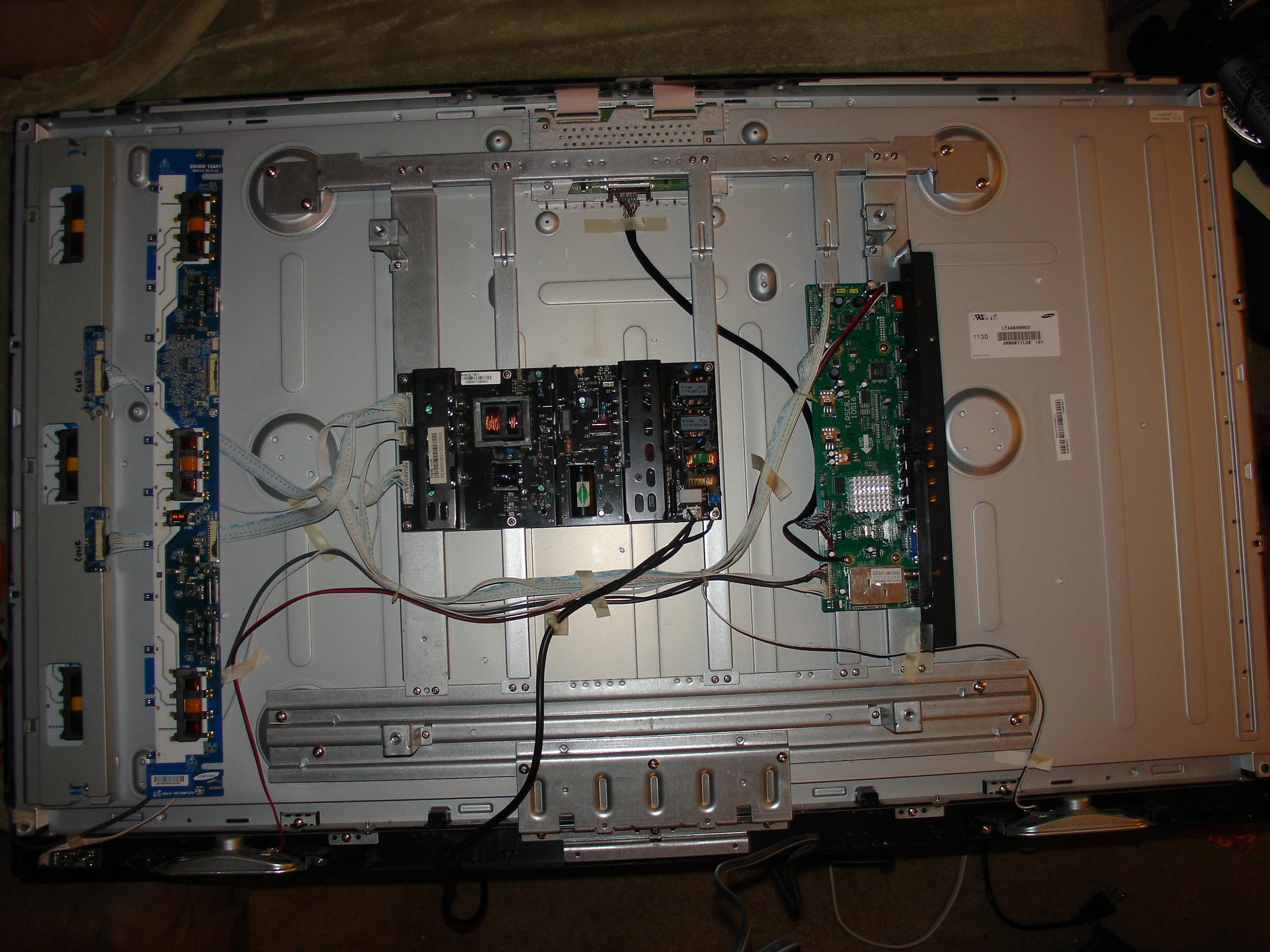

        Ah, I'm sorry about that, I totally missed adding pictures. Here are some. Since I have a spare of the inverter board, I just laid it on the panel in the first picture for reference.
        If close-ups of anything in particular would be helpful please let me know, I'm happy to take as many as needed.
        And thanks for any help you can provide!

          Re: RCA 46LA45RQ 2 seconds then lights out, intermittent
          So...
          Swapped Invertor no change, 24v present at invertor regardless of if the backlight is on off? Correct?
          Leaves one thing - Failing CCFL

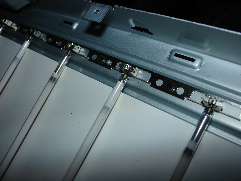

            Thanks! That makes sense. I took the panel assembly apart and have the bulbs exposed. They all stay lit at the moment, but one bulb had a "barbers-pole" look to it for several seconds. I'll keep trying it today to confirm if that is the (only) problem bulb.
            If I've done my measurement right, I'll be looking for a 4.0 x 1025mm bulb. Any recommended places to buy them? I noticed www.ccflwarehouse.com...
            Also reading through the threads, seems like I need to wipe down the panel with a dust cloth prior to reassmbly, someone recommended Guardsman.

              I believe the problem is solved!
              Was powering the set on/off on its back without the LCD panel for a good while trying to determine which bulb is bad, but without any failures. I decided to inspect the connections of each bulb more closely and found 2 ground sockets "unlocked" themselves. The cathodes of the bulbs were pretty black in those sockets; some light sandpaper brought back the shiny color. Locked them back in by pressing down on the sockets with my thumb and haven't had any problems so far. Awaiting an anti-static wipe to put the panel back.
              Thanks again for pointing me in the right direction, guys! Hope this post helps someone else with the same issue. Beers on me!

                Good job!. I can see some of the lamps has blackened ends so they will more likely to fail later, if it has backlights level control, I would set it to about 80% or so that may extend the life of the lamps.
