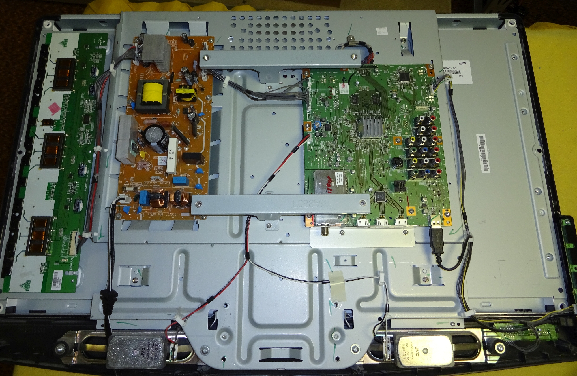

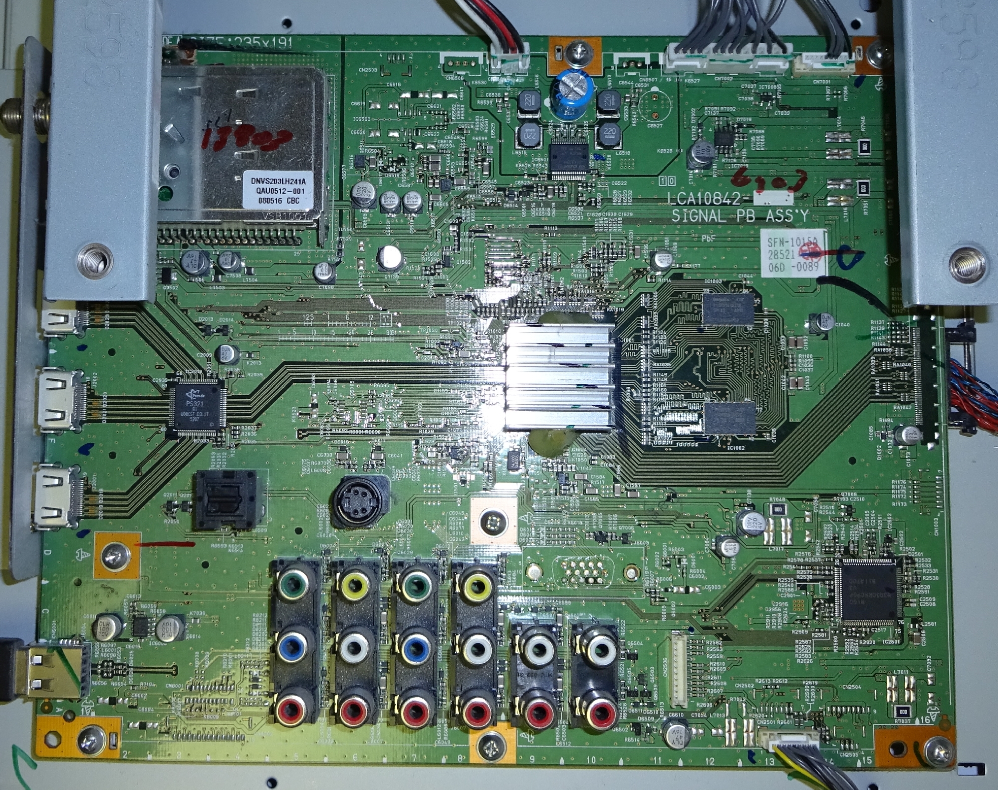

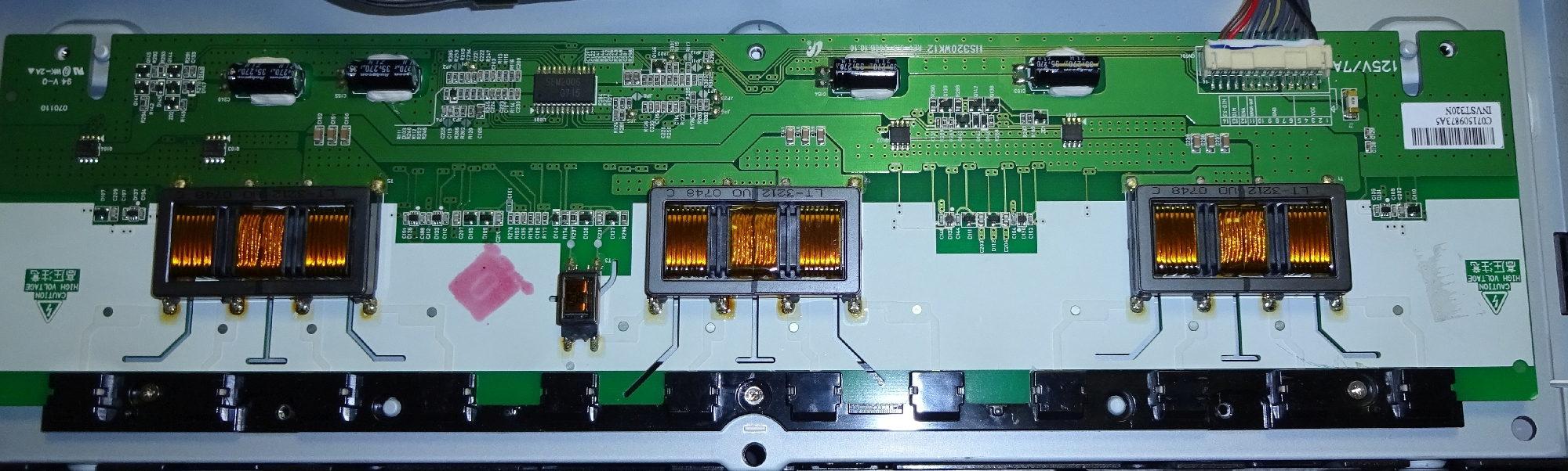

    JVC LT32W6HD When turned on I get the blue light on front and here the click but the screen remains black with no flash of the backlights or anything and after a few seconds relay clicks again and the blue light flashes constantly. I do get 24volts at the inverter board between the first and second click and even replaced the inverter board with same results. None of the boards have any markings to show what the wires are as I would like to try and force backlights on. Also the inverter board is the kind of slip in board so I can't really put a bulb on each to check. Anyway I was wondering if anyone would have some advise?

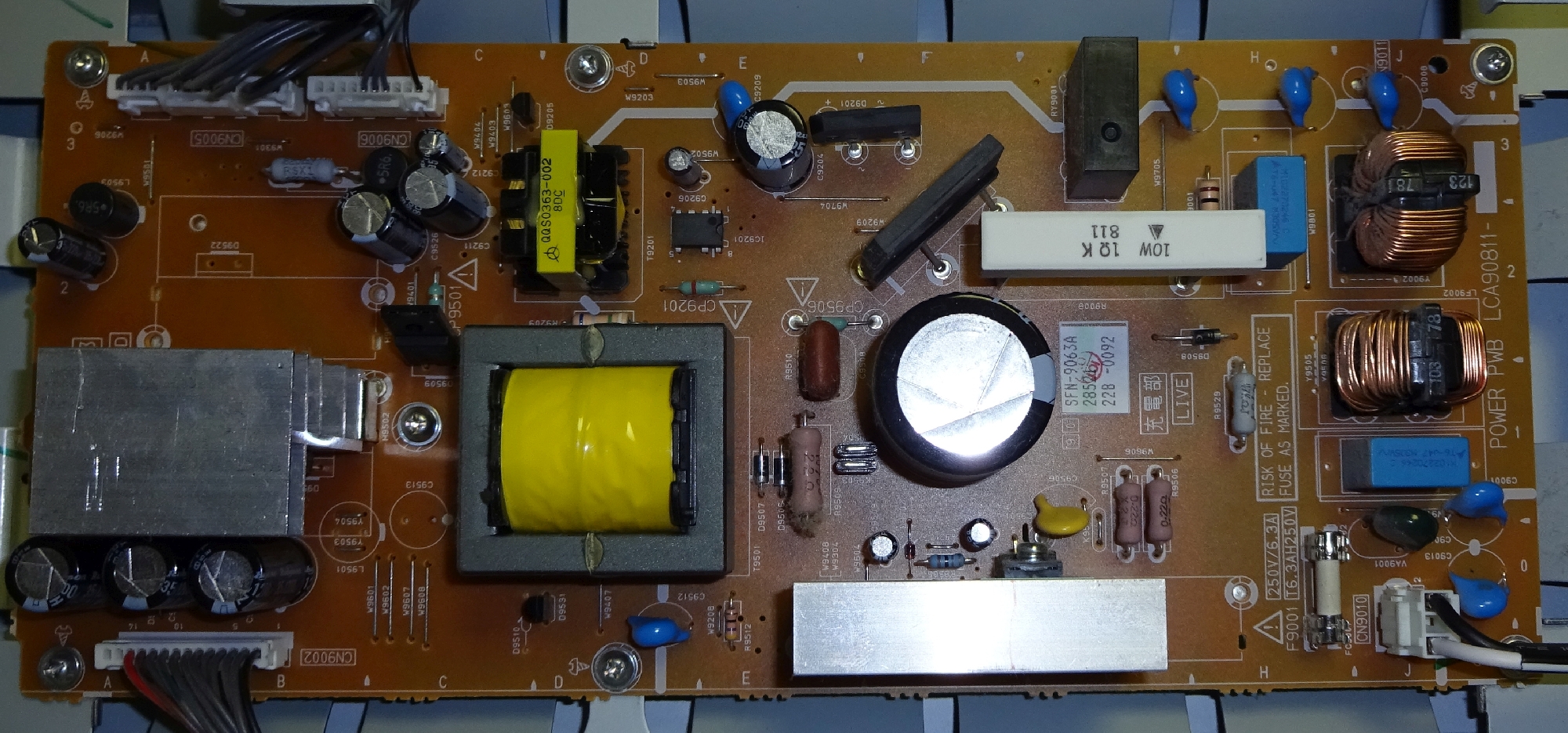

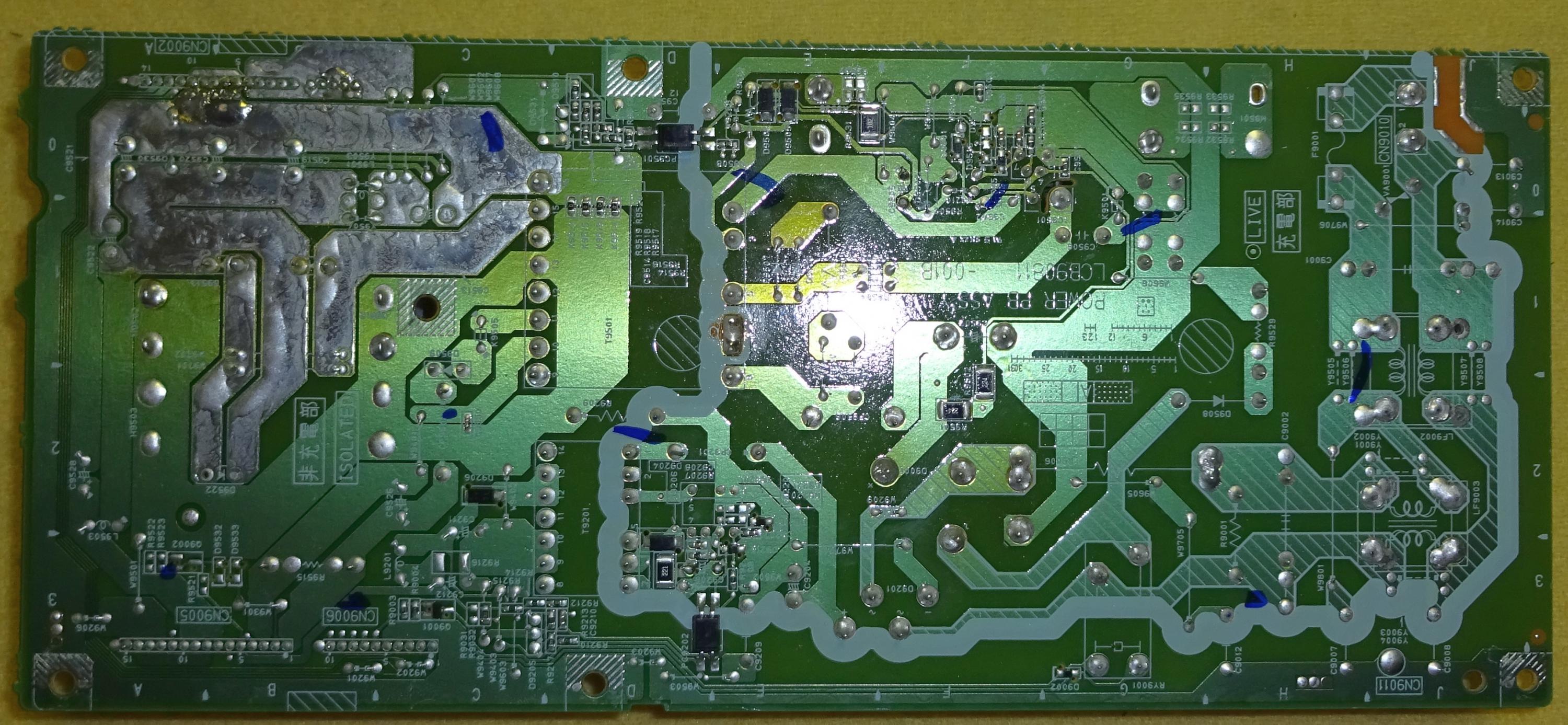

    Re: JVC Black screen
    Can you give us a picture of the back of the PSU please.
    So if we have to trace the circuit to figure what is what
        Check pin 12 (ENABLE, same as BL-ON) of the inverter connector to see if it has >2.5VDC.
          Looks like that's dead there.

                      I got a 52 inch JVC today with same problem. I took off the back and saw one of the backlight inverter boards was un-pluged. I put it back on and did the reset and it works great again.
