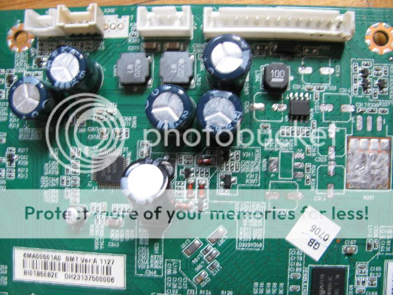

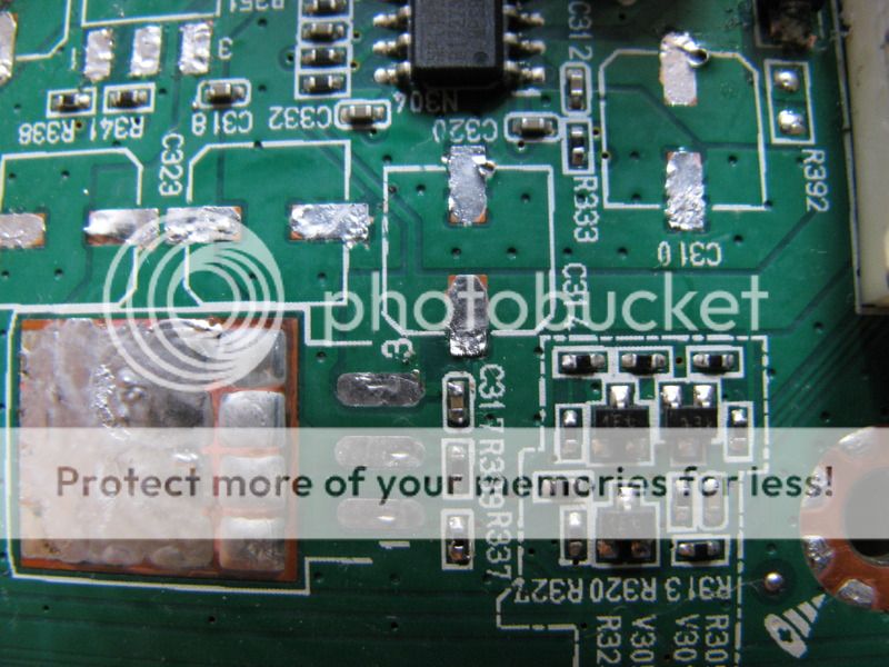

                  I have taken some of the caps off to look at the traces.....here are some high res pictures. Do these help?

                    #29

                        There are many SMD MLCC (Multi Layer Ceramic Cap) that are connected in parallel with the electrolytics caps you removed, for example C318 is in parallel with C329.
                        The MLCC usually failed as shorted circuit.

                          In post #28, top of first photo, what is the part number of the 8-legged surface mount ic?

                            I guess I'll take off some of the MLCC to check whether they are shorted.
                            As for the 8 legged surface mount ic, the p/n is MP1482DS - how can I check this ic?

                                I think the mlcc caps are too small to sense the temperature change. I took C331 out and tested the capacitance and it was 200nF... does that sound right, since it seems to be parallel to C325, which is 100uF. I'm confused.
                                Also, when I touch the pads of several of these capacitors that I took out (C325, C313, C323) to ground, both sides of the pads are shorted....any ideas?
