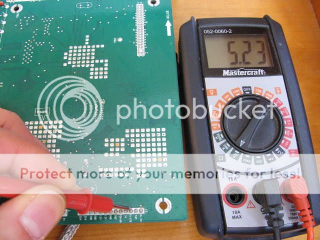

    When I disconnect the main board from the power supply, the 5v standby is constant. As soon as I plug the connector to the main board, the standby drops down to less than 1v. I believe the main board is faulty.

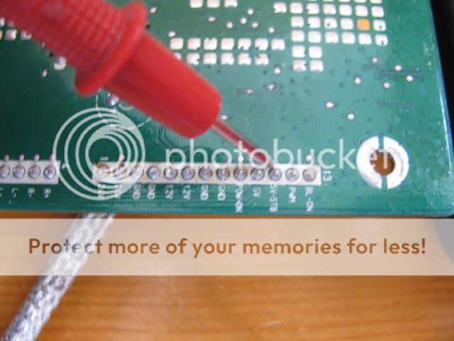

      I have tried looking everything on the net for a schematic but I cannot find it. I have tested the resistance and it seems quite high (all in kilo-ohms).
      BON - 12.7 Kohms
      STB 5V - 5.2 Kohms
      5V - 12.2 Kohms
      Pwr on - 6.3 Kohms
      12V - 10.1 Kohms
      24V - 8.2 Kohms

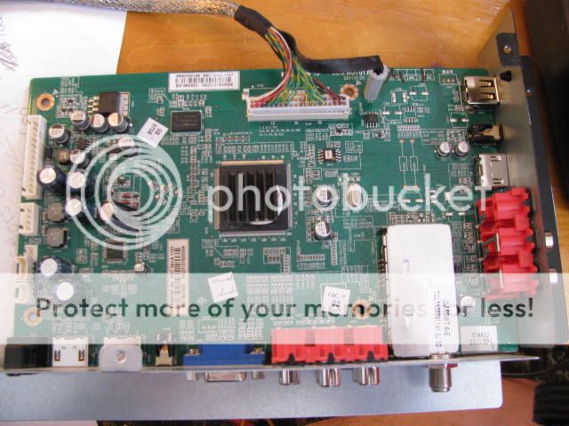

      I am attaching some pictures…hopefully someone can help me out more.

        good and bad news. Good news, the rail isn't shorted to GND. bad news... Maybe some IC that's fried or some voltage regulator that is using that 5v rail. I think I see a regulator on top left corner. Can you post high res pics? What happened to it? a lightning strike special?
          Re: Sanyo LCD-40R50F lcd tv shorted mainboard - need help
          I would check the output pin of the Voltage regulator ICs to see if any of them show low resistance.

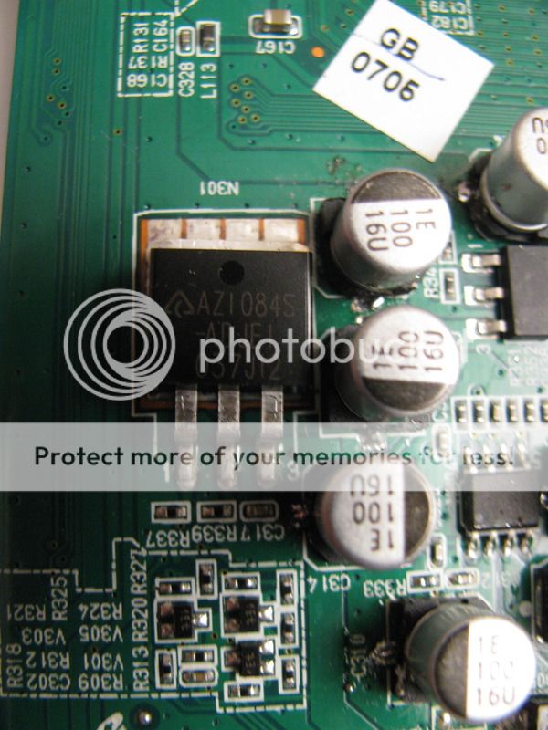

            As for the ic regulator, here are the markings:
            AZ1084S
            ADJEI
            037J12
            As for checking the voltage, I'm not sure if I am doing it correctly: I reconnected the main board to the back of the tv and reconnected the cable from the power supply. When I plug in the a/c cord, and try to read the pins (left to right, 1,2,3), I get 0v on all three pins.
            I'm not sure if I am doing this right.
            let me know as I am attaching a high resolution of the regulator
              You check the resistance of the Regulator pin against GND, no power apply to the board. There is no other regulators on the bottom side of the board?
                  Well,
                  Pin 1 is ADJ (for Adjustable regulator) or GND (for fixed regulator).
                  Pin 2 is the output pin
                  Pin 3 is the input pin
                  So the output pin is connected to a shorted circuit (load) or the internal output pin of the IC is shorted, shorted MLCC (Multi Layer Ceramic Capacitor), etc.
                  You will have to isolate what ever are connected to the output pin, you can try lifting the output pin first and see if the shorts will go away.
                  BTW, without the diagram to see what are the loads that are connected to the output pin will make it very difficult to troubleshoot.

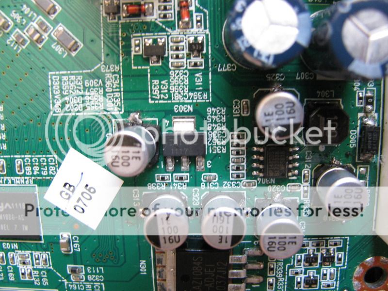

                    sounds like you had the negative probe on the tab of the voltage regulator, which is connected to the the output pin 2 in this case. Anyway... it's fubar. So you need one of those. No wonder it is dragging the 5v rail down. Take it off or lift the output pin and redo measurement.
                    Are you sure there isn't anything on the backside of the board?
                    Right next to the big regulator there is another smaller something looking like having 3 legs and a tab. What is it?
                    Aahh crap... just read budm's post all the way through... oh well now you have it double!

                      Yes, I noticed another smaller regulator (thanks CapLeaker!). I measured the resistance on that and here are the markings and results:
                      01c (line 1)
                      1117 (line 2)
                      Pin1 - 55 ohms
                      Pin2 - 162 ohms
                      Pin3 - 5 ohms
                      • jetadm123
                        • 2169
                        1117 pin 3 is the input pin. Try lifting pin 3 off the board and take a resistance measurement from the pin 3 pad of the circuit board to ground. If the short goes away, then remove the 1117 and check for shorts between the pins.

                          Hi
                          I lifted pin3 and took a resistance reading between it and ground - the short went away. So, I removed 1117 and checked resistance between all the pins and there is NO SHORT!! (1-2, 1-3, 2-3). I also checked between the tab and the pins and, as expected, it is open for pins 1,3 and shorted for pin2.
                          What else can I check?
