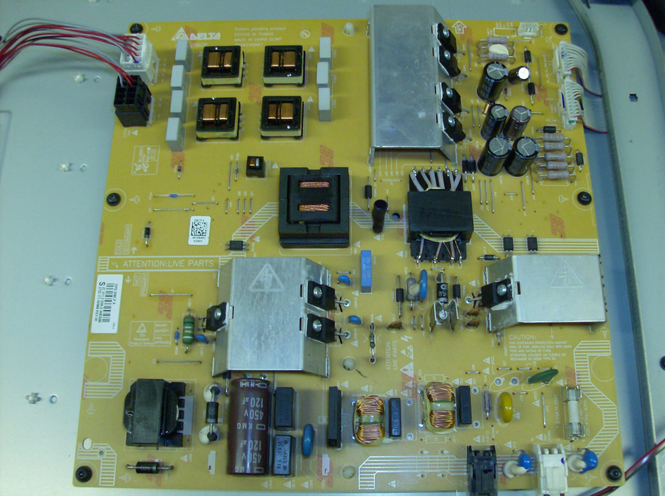

          Pictures of the model number sticker with chassis number, and pictures of the whole back side of the TV, the boards (especially the power supply board top and bottom sides) will help.
          Is this your board?
          http://mcsimple.com/index.php/taobao...id/39269016760
          Since it is made by the OEM so I doubt that Philips will publish the schematic for the power supply made by DELTA.

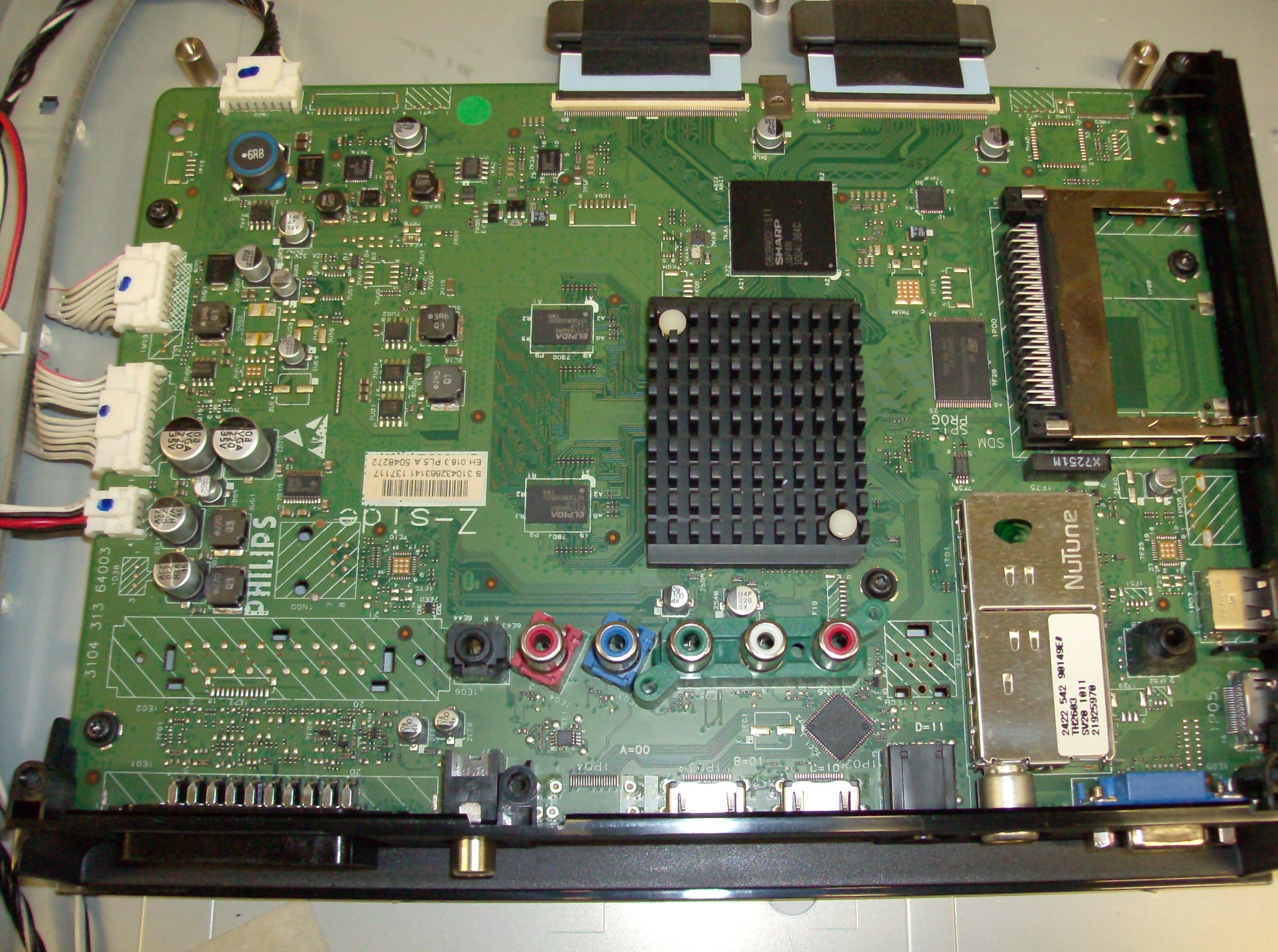

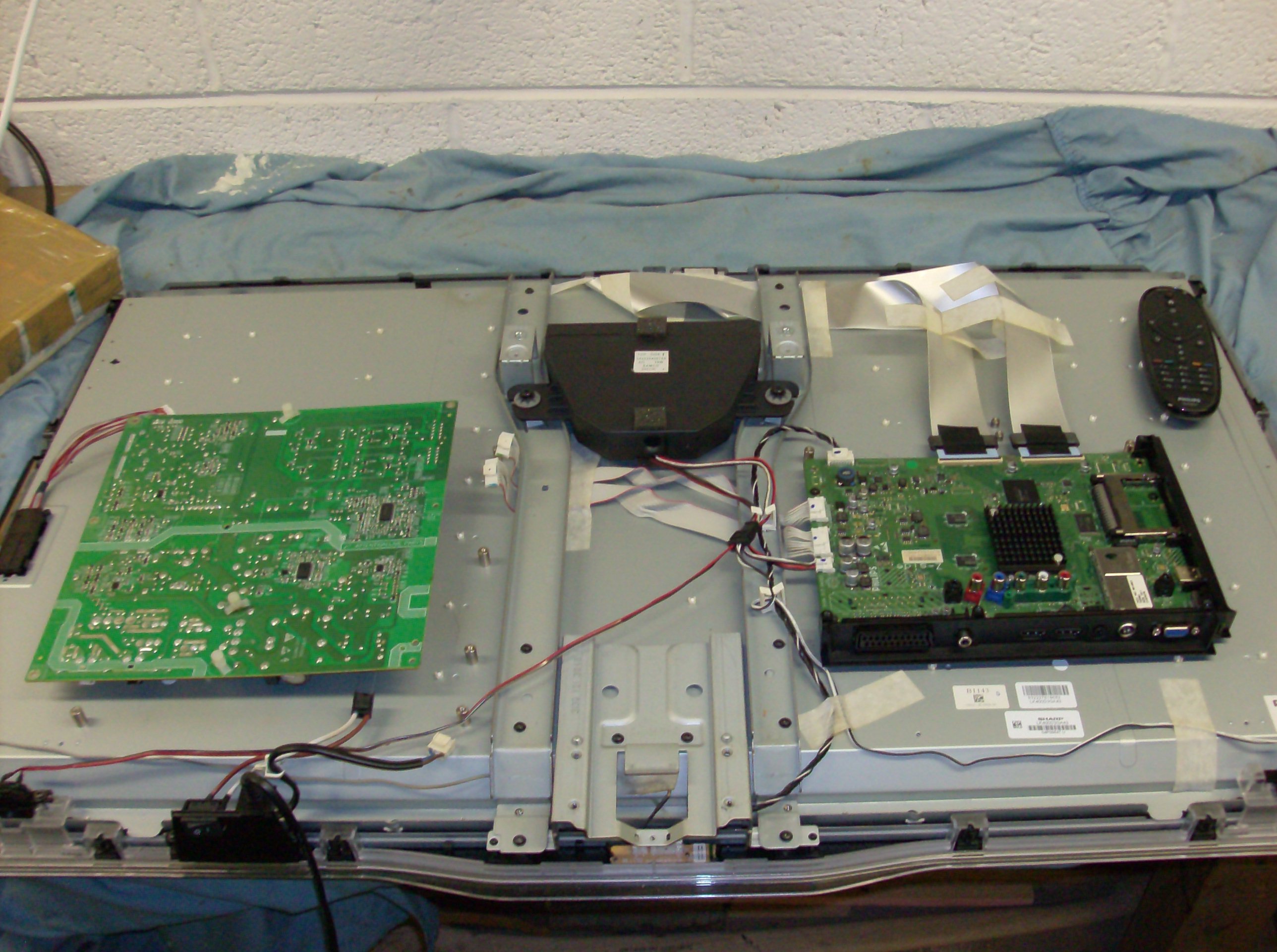

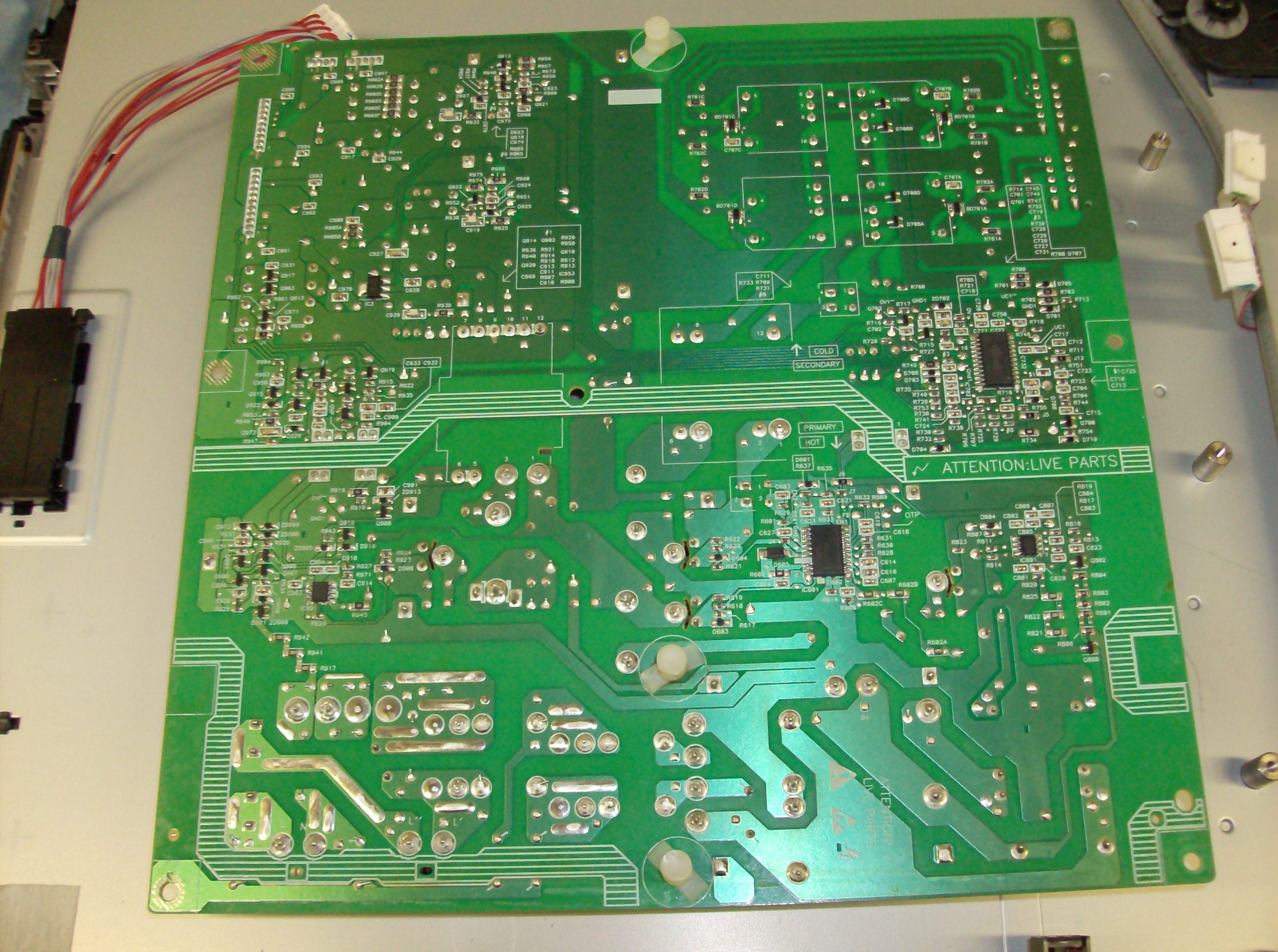

              Yes, that looks like my board.
              Here are some pictures.

                            Re: Philips 40PFL5605
                            I managed to find the below from a Philips manual.
                            PNX doesn't boot (HW cause) 2 15 Stby μP P BL PNX8550 SSB
                            This basically says that the main SSB board is faulty with a processor hardware problem, stopping the SSB from booting up.
                            So unless somebody can explain otherwise, it looks like I have a dead processor board.
                            If I buy a new board (where is best?) is it probable that I'll get this TV up and running again? Or could there be other problems?

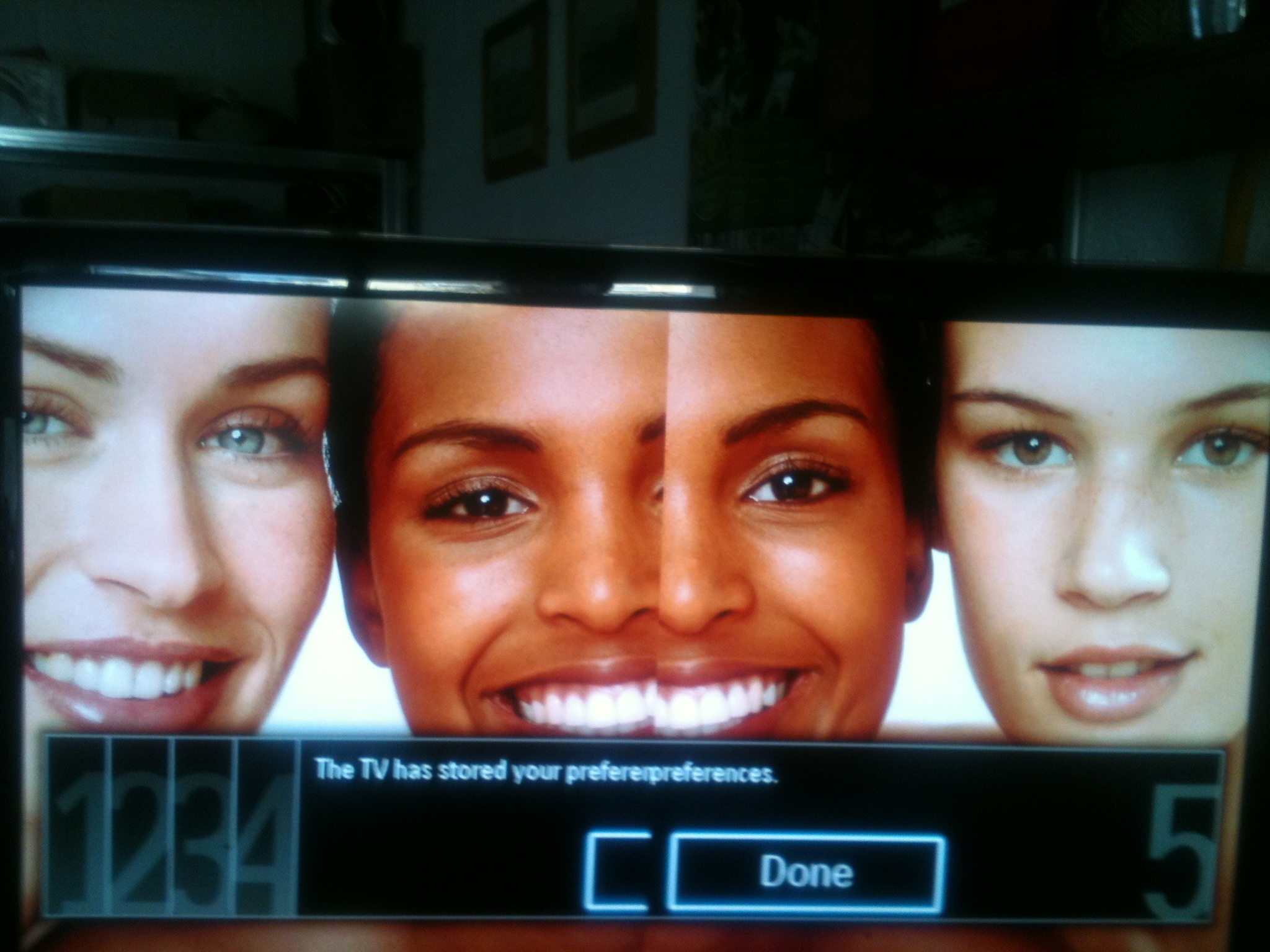

                              Hi, I managed to replace the main board.
                              TV now powers on fine but the image overlaps as shown in the picture.
                              As you can see this problem is common for onscreen menus and external video.
                              Was my replacement board incorrect or is there something else I need to do to fix this?
                              Thanks.
                                It looks like the main board is not compatible with the panel, did you get the same board version and same P/N?
                                May be TOM66 can chime in on how to get into service made to change the setting.
                                • habanerocat
                                  • Nov 2014
                                  • 96
                                  • Ireland
                                  Thanks for your reply.
                                  I went into the service menu. The only relevant option I saw was TCON alignment, which is set at 0109.
                                  I tried to change it but it made no difference.
                                  Does anybody know what this is, or how to fix my problem.
                                  Thanks.
                                    No great suggestions here I'm afraid. I would guess your ordered board is incompatible.
