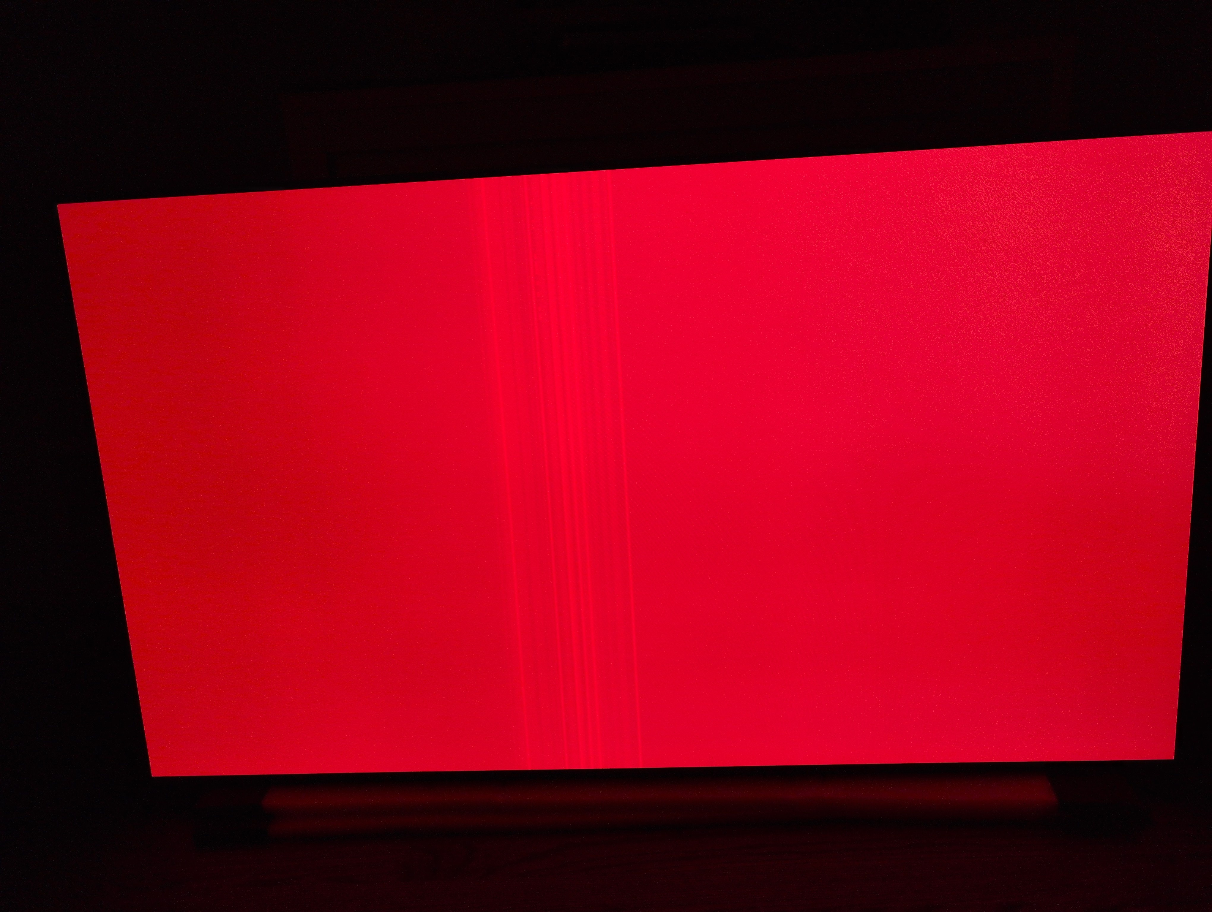

    ​​​​​​ Hi,
    I'm trying to resurrect a LG OLED C1 TV that has some panel banding. I used the TCON error bypass to get a picture. I was able to update the firmware as well. But when I performed a pixel cleaning to try to get the banding out, it made the image significantly worse. I tried to undo the effects of the pixel cleaning by performing a factory reset and IN_Stop, but that didn't work. Any way to reset pixel cleaning data?

      Thank you for the quick response. I'll try to disconnect the EVDD cable and leave the tv on to try to trigger the cell refresh without VCC.

              I tried disconnecting the TV from power overnight and that didn't bring the picture quality back.
              I tried disconnecting the EVDD and kept the 12v VCC connected then powered on the tv to refresh the cells. This also didn't work.
              I tried swapping out the TCON with one from an A1. This didn't power on the tv. It tried to turn on, but all I saw was a faint light all across the screen.
              I then swapped out the Main board with the A1 board. Then the tv turned on and the picture was much better. However, this meant that I was downgrading the tv. This combination of A1 main board and TCON also produced a picture that was not uniform in brightness.
              Based on my testing it looks like when you run Pixel cleaning, the results from the process is stored on the TCON. I'm going to try to find a way to reset the C1 TCON or put it into another TV and run Pixel cleaning to store new values.

                  yours photo , it show the same distribution area on the screen with A1 boards... ( this had nothings to do with Pixel refresh as i said early ), if you keep these boards in place you will kill them because of the fault on panel,
                  back to yours C1 T-con... show please yours DIY blocking the SOS Signal.

                    So if I keep running the tv with the panel defects, it will kill the TCON?
                    Attached is the picture of the cable with SOS signal blocked.

                      The vertical lines were there with the C1 and A1 board and TCONs. The change in picture quality (decreased brightness, crushing black, and blotchy picture) was after pixel cleaning was performed. That's why I'm hesitant to run it again with the A1 board and TCON.
                          ok , was not clear to me.. i saw photo on a cellular.. now on a PC..
                          where do you saw there is compatibility within C1 panel - A1 Tcon? It sounds a bit strange to me.. i can guess that the calibration process involves also a part of the column / row drivers within the panel...
                          apart from this, i think bad caps on panel are impossible, but the vertical defects now appears to me possible defective panel, maybe bad connection on the center bottom tabs... besides this, i think there's no elctrical compatibilty problems between A1-C1 tcon, and if it was mine, i think the possibility to run calibration on various passes.. remember every LCD or OLED panel pixels have a capacitance, this capacitance disappears not as fast as an eye blink, i saw personally a videclip where a suddenly unfed panel , with applied backlight, showed faint image for long time.. i think OLED panel needs to be turned on for hours to go back to normality..
