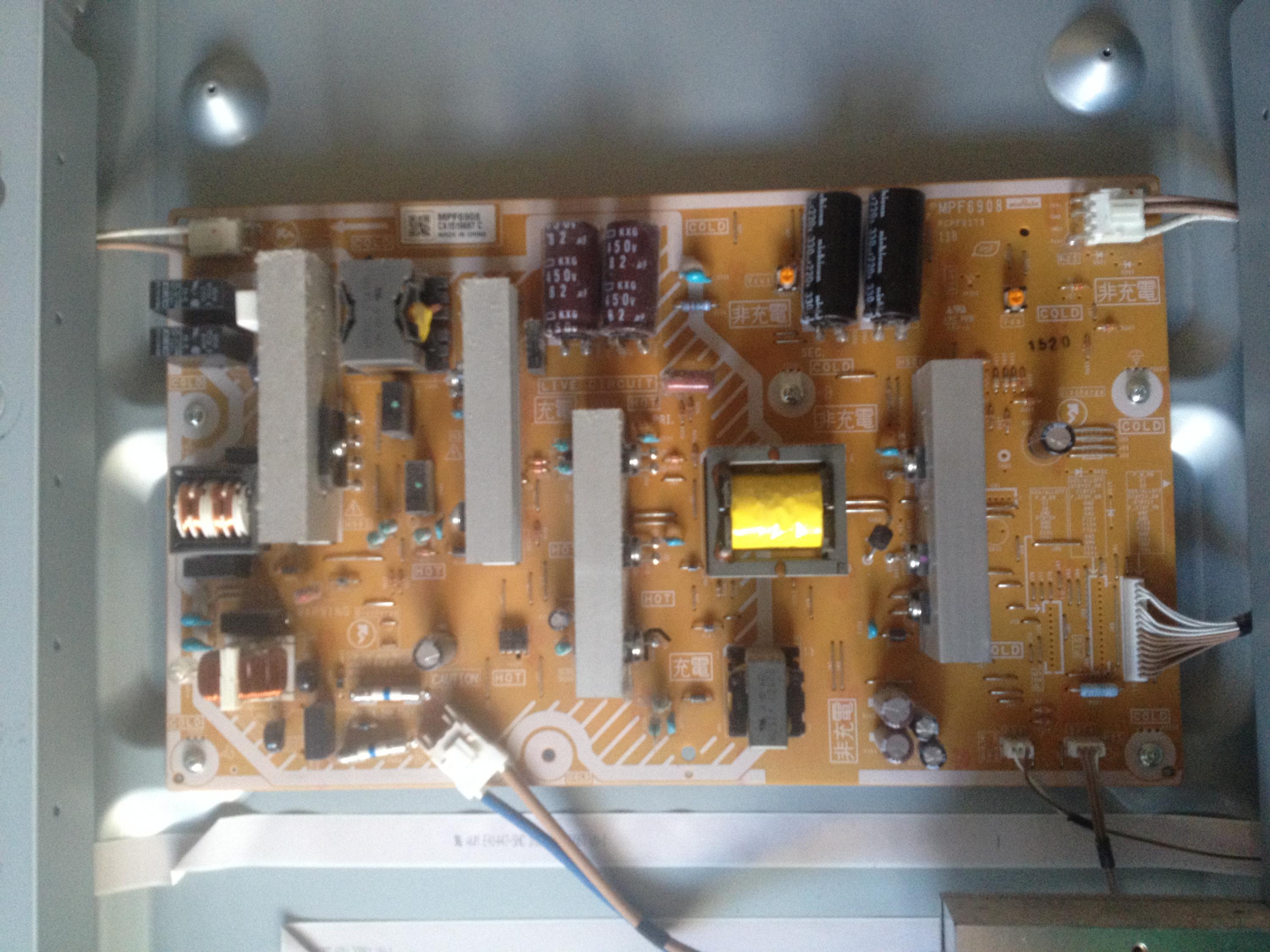

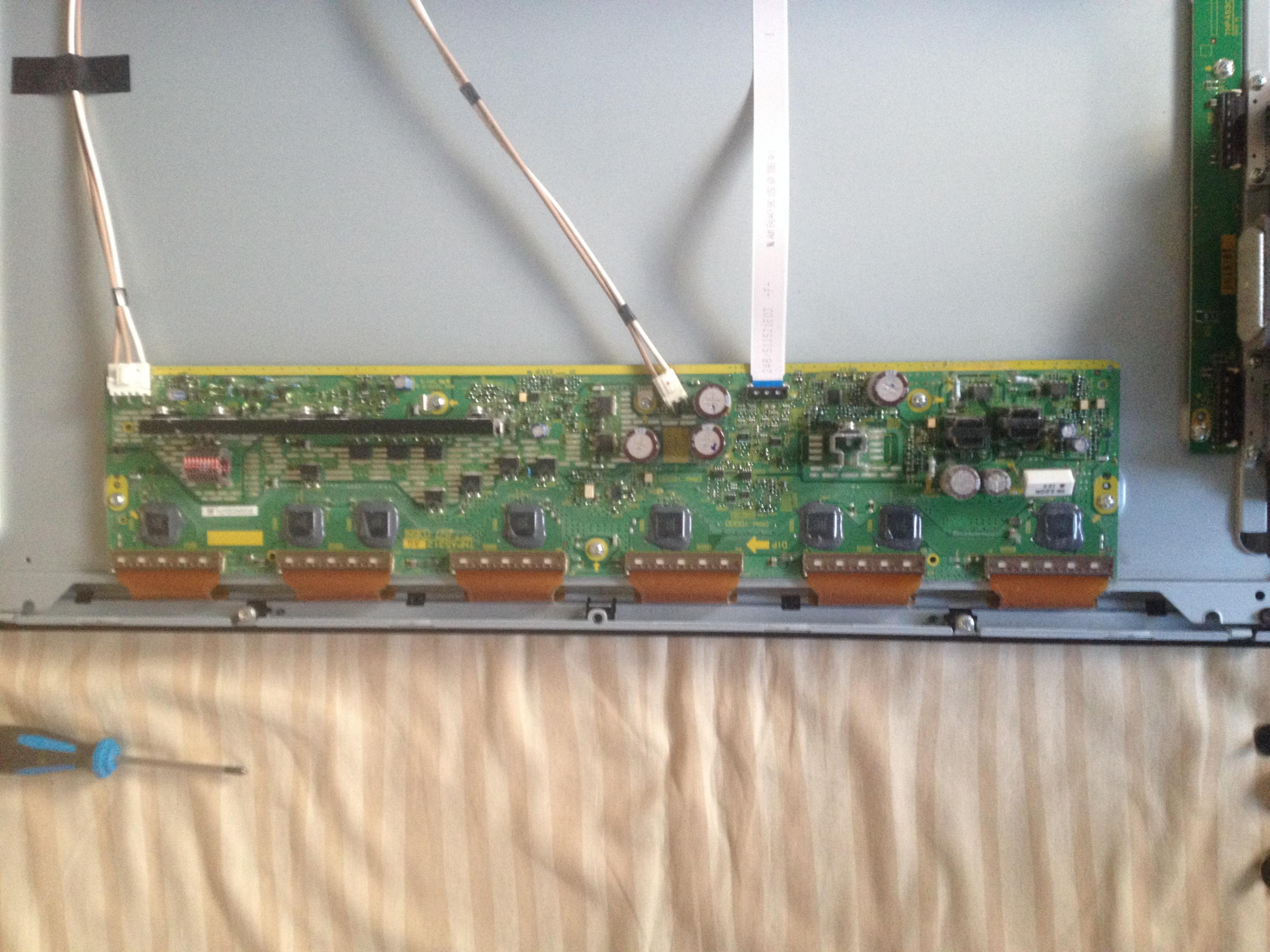

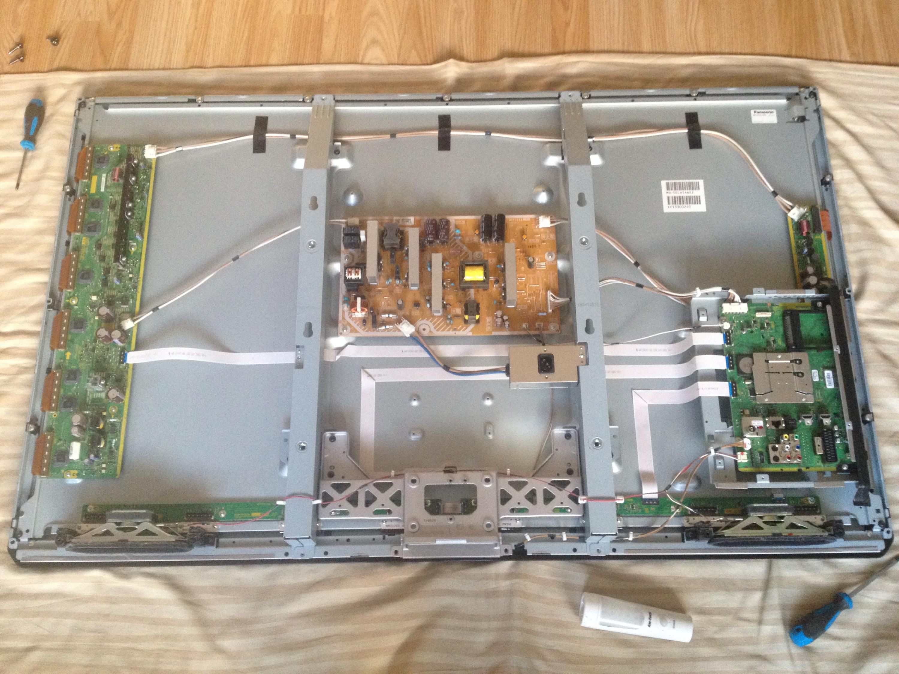

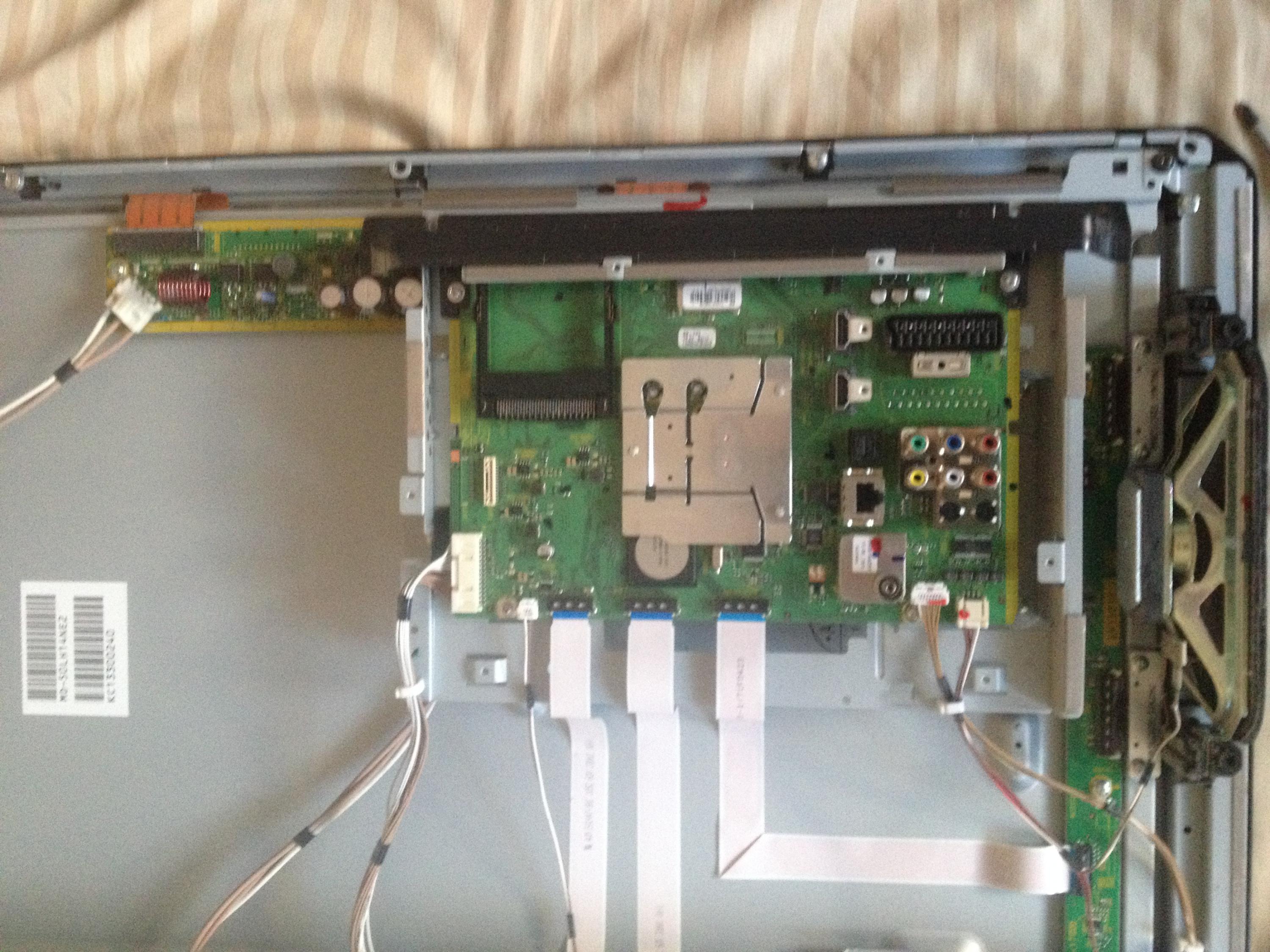

          Re: panasonic TX-P50C3B, wont turn on
          here's some pics, got SN out and can't find a short, also SS and can't find a short, unless im doing it wrong, tryed on ohms and beep modes,
              my browser is having a fit with showing images atm,
              Its a TX so probably same format as a few I have here.
              On OHMs check the 2 pin power input on SN, What reading do you get?
                ok, finally got round to getting this out again,
                in answer to your question,
                i set DMM on 2000 ohms and got a steady reading of 620, this is the same with all wires and ribbons disconected as well,
                also tryed an auto range meter but had no luck with any steady reading, it just keeps climbing and dropping.

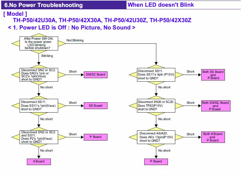

                                  Originally posted by finntricky
                                  yep still the same as when i first git the tv, blinking green light very fast, maybe 5 or 6 blinks
                                  Well, I'd be interested in input from the other guys but doing that it's only the A & P boards in play and it's neither staying on or generating an error blink. I'm leaning towards A board but not sure other than backprobing voltages as you turn it on to prove the p board is ok.
                                  And from what you've said you have not found any shorts on the SN or SS but even if that was the issue a change in result should have been seen if they were having an affect on things.
                                  This is a flow chart I was looking at which seems to describe your scenario. X30 will be the same design essentially as X3 i.e. HD TV 720P
                                  last check would be checking the p board with ss/sn removed for short on P2 vsus.
                                  Hard to know what this result means, really depends on how good the meters are. The first result could be wrong due to incorrect range, the second is most likely the cct charging. try reversing the probes but usually i see 100's K ohms on first probe and when re-probed to 2-3 meg ohms.
