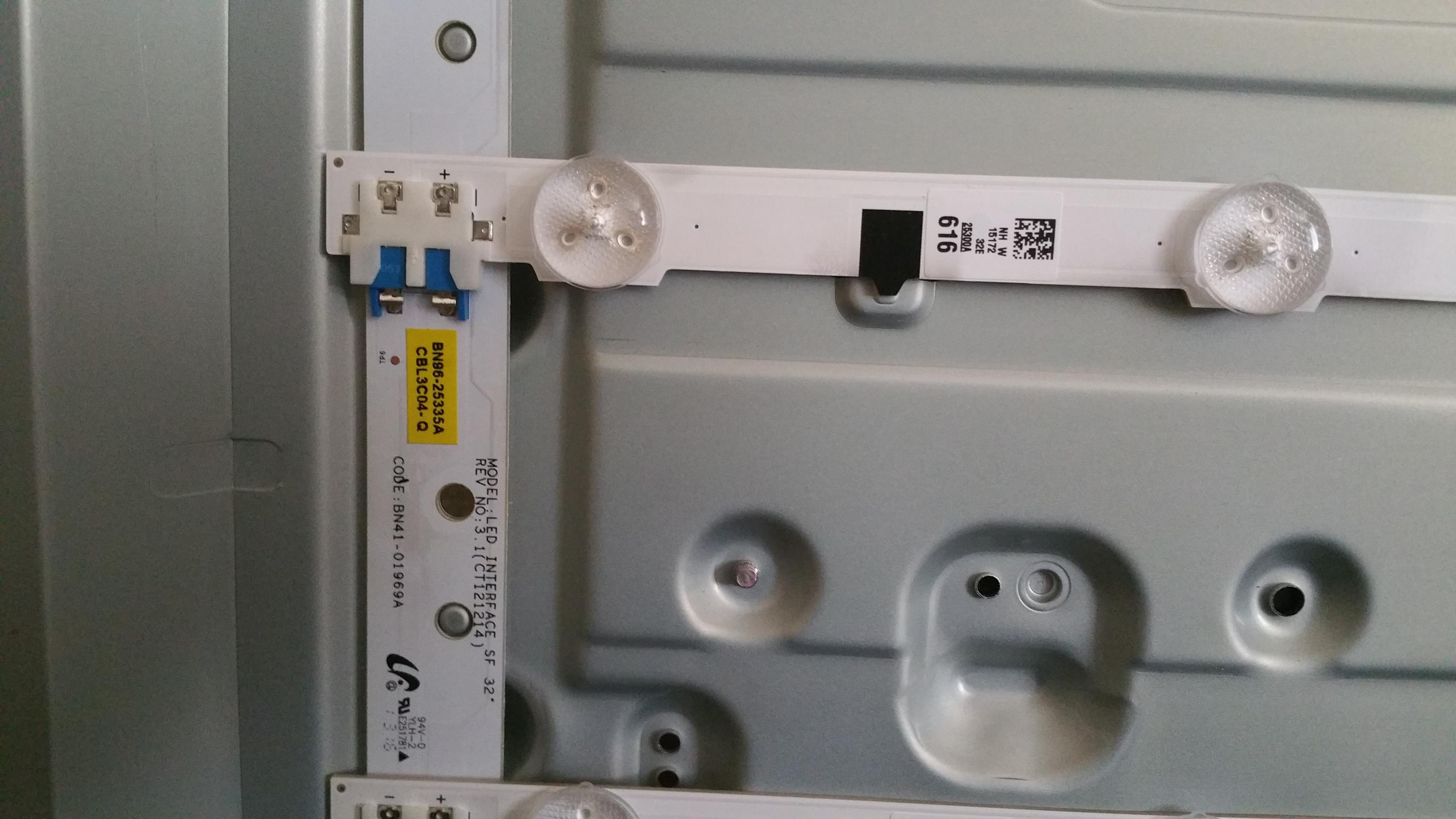

    The backlight of my 1 year old TV (Warranty finished) stopped working. Replaced PS board but that did not help. Opened the LED backlight panel and found 1 strip (out of 5 strips with 9 LEDs on each strip) not working. Because of not having experience, I ended with 2 entire strips burned out.
    LED driver output from PS board reading: 160 V, 320 mA
    Made custom LED arrangement (36 V and 240 mA) per strip using cheap 4.8 watt/meter led strip. The TV is working for 2 days (not uniform light though) but don't know when it burns again.
    1. Can anyone please help me finding replacement LED strips for UN32F5500afxza?
    2. Does anyone in this forum have spare parts?
    3. Can I find some suitable replacement surface mount LEDs ( I think 3.5 V, 320 mA).
    Thanks.

    There should be some kind of #'s on the strips that may help locate some replacements. Sometimes the same strips are used in other models.
    I had luck on a different set by contacting a seller on ebay that had other parts for tv I was working on for sale. He had the strips I needed just not posted. Managed to get a handful for cheap.
    Posting some pics of the strips may help also.

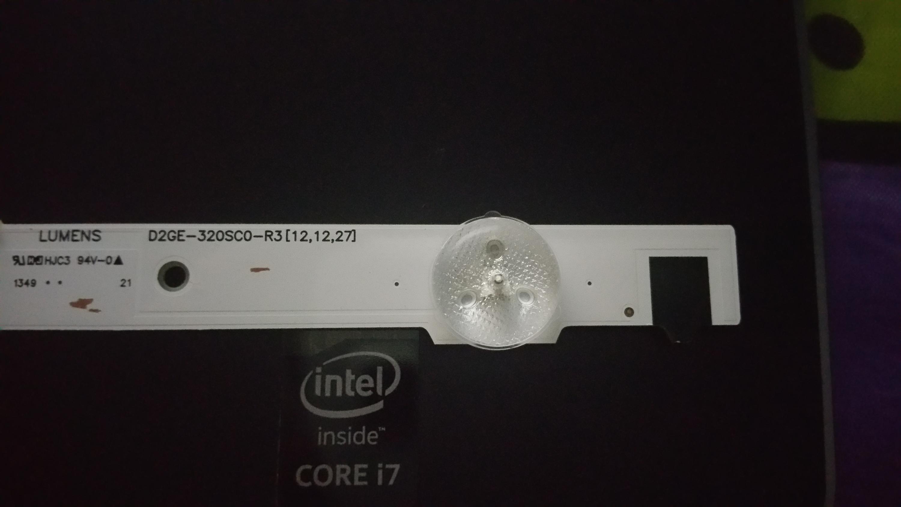

      Attached are two pics of the main distribution panel and the number on a strip.
      There are 5 strips and each strip has 9 LEDs in series.

                Is there a P/N on the led strips? Like the one on the connecting strip, the BN41 #.
                Found this here. Says you can special order? Maybe call them and see. Although I don't know for certain that is right P/N for your tv. Need complete model #.
                https://www.partstore.com/Part/Samsu...5300A/New.aspx

                  There is a number but I dont know it is part number. It is D2GE-320SC0-R3[12,12,27].
                  I tried searching using this number and it brings many russian and chinese pages showing the correct strip.
