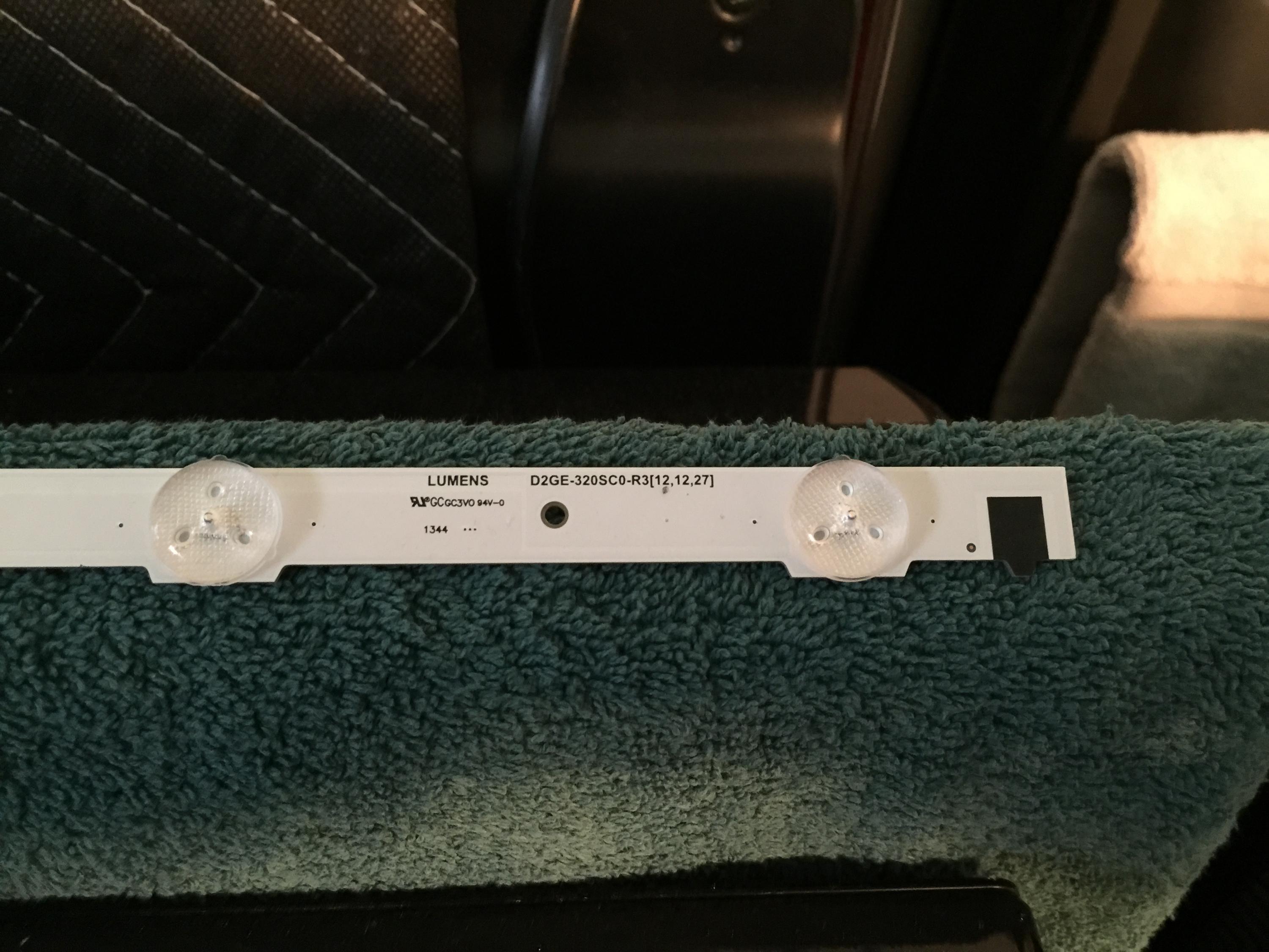

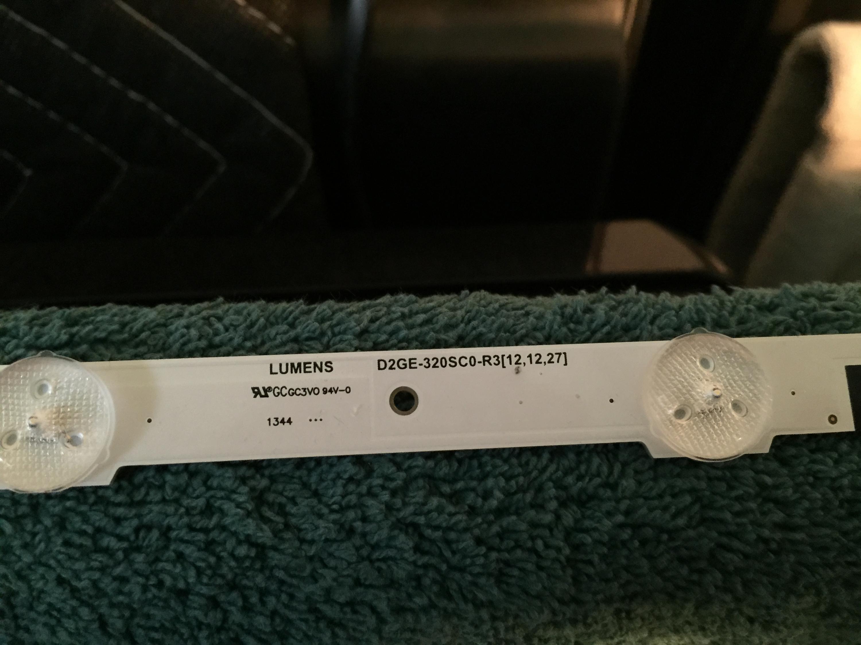

    Yes,indeed we are all in the same bind!I have a UN32F series with all
    strips bad. Part number D2GE-320SC0-R3 Mfr.by LUMENS.We need a source,
    even China will do!

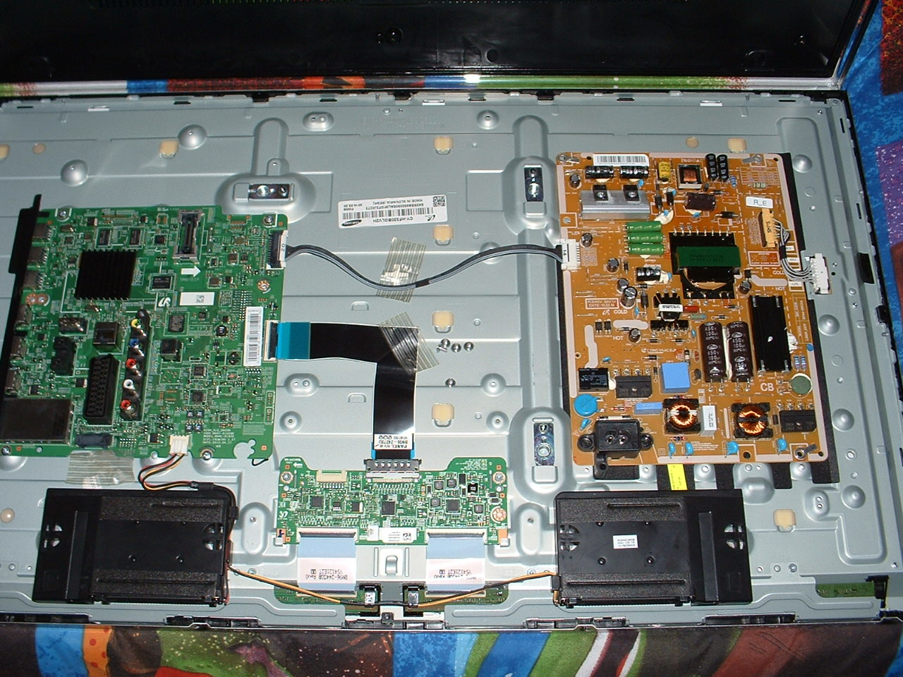

            Re: Samsung UN32F5500 smart TV no backlight

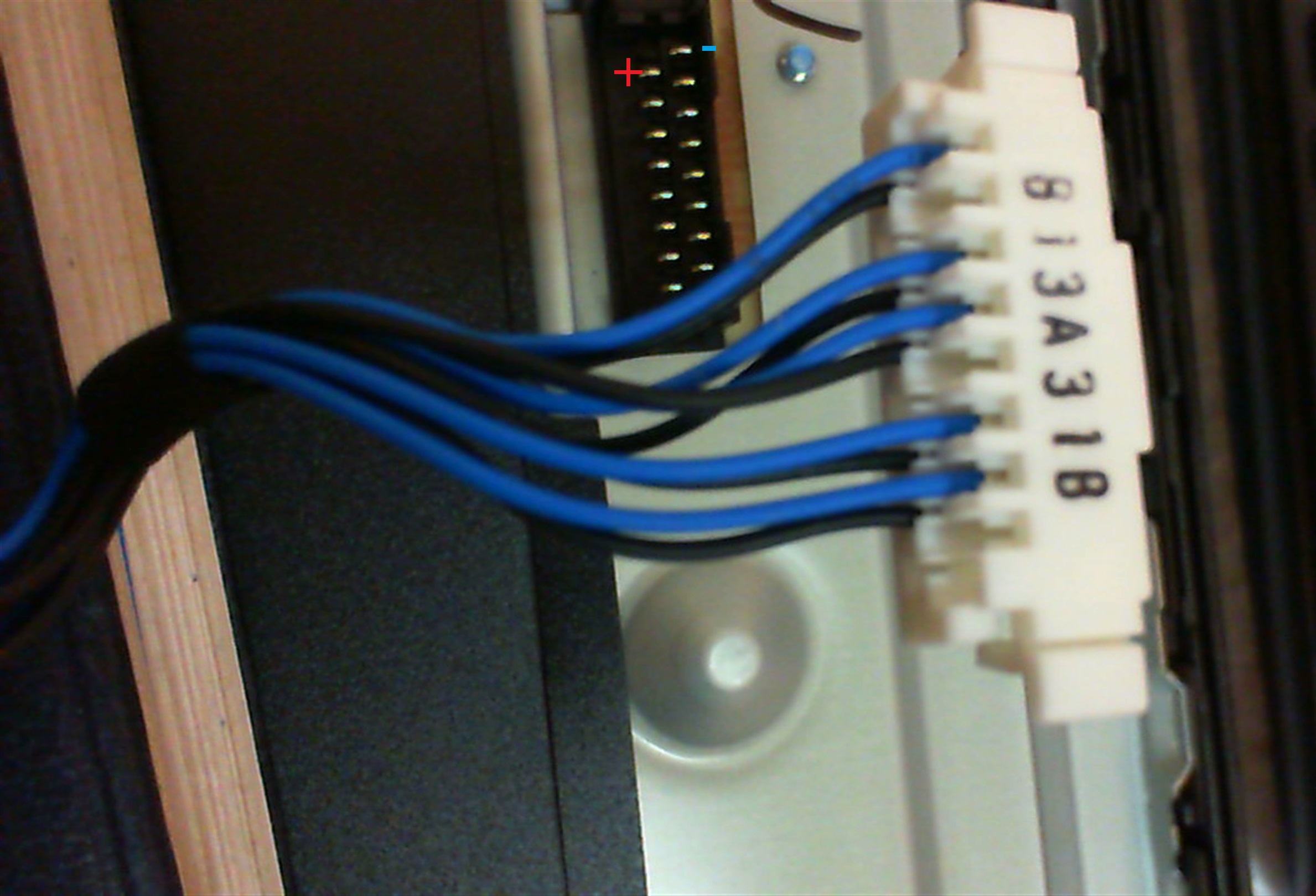

            Same problem. Would be nice to know the EXACT wiring of the strips. My panel is not open yet though.
            Tested them all with 20 to 25V.
            +-4 does not light up
            +-3 does light up
            +-2 does light up
            +-1 does not light up
            IF1 IF2 does not light up
            They don't seem to be all equal, or why would they give a different name to the last pair?

              All 4 strips are connected in series, the one I work on has one strip with shorted out LED, and another strip has open LED, very common failure.
              https://www.badcaps.net/forum/showthread.php?t=46403
              You will have scrape off the white paint to make contact with each LED legs, the LEDs in each strip are connected in series.
                  there are 5 strips not 4.
                  they are all in series, but 4 and 5 are connected in series inside the panel. So when you test +4 -4, you are actually testing 18 LEDs not 9 LEDs like the other ones. You would have to give it 40 volts probably to get them to light up.

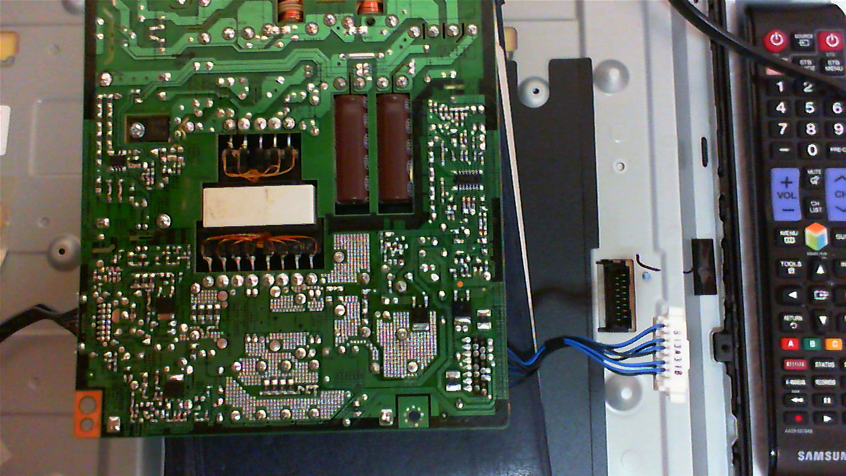

                      okay. i'll try and clear this up. The power supply puts out the full voltage of 160V on 1+, it goes out to string 1, then comes back on 1-, then on the PCB 1- and 2+ are connected together. (Flip over the board and you can see the trace). Then from 2+ to 2- it goes through string 2, 3+ to 3- goes through string 3. Then it gets a little weird. 4+ goes through string 4 then without coming back to the PCB it goes through string 5, then comes back to 4-.
                      1+ >> string1 >> 1- =[PCB]= 2+ >> string2 >> 2- =[PCB]= 3+ >> string3 >> 3- =[PCB]= 4+ >> string4 >> string5 >> 4-
                      • mrhappypants
                        • Aug 2015
                        • 8
                        • canada
                        #31
                        the only pins that power anything are 1+(power), 4-(controlled ground). So the scheme does work it just seems confusing at first.
                        I say "controlled ground" because it is actually the ground that is switched on and off to control the backlight.
                          Ok, so they are in series on the PCB for the first 4 strings and then 2 strings in series inside the panel. That answers my question. I have definitely open LEDs on string 1 :-|

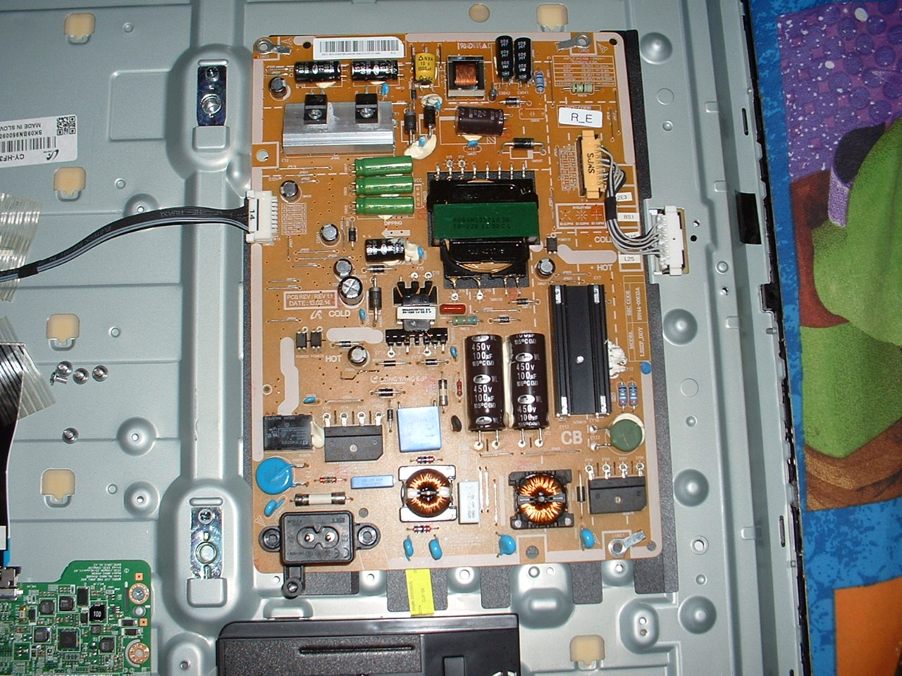

                                  when you find the one blown I would highly recommend putting about 20 diodes in series to limit the voltage strain on the LEDs. I am currently running mine with 12 LEDs burnt out and it's still lots bright (limited the current with resistors).
                                  Since I believe the LED controller is a current controller, diodes in series or resistors will only help if the voltage from this controller is maxed out, otherwise it will just keep increasing the voltage in order to maintain the current through the LEDs at the level it's supposed to be. The right thing would be to lower current as Bud said via menu or electronically.
                                  I have 7 shorted LEDs, will try to replace just the diodes with some from spare strips from another TV.

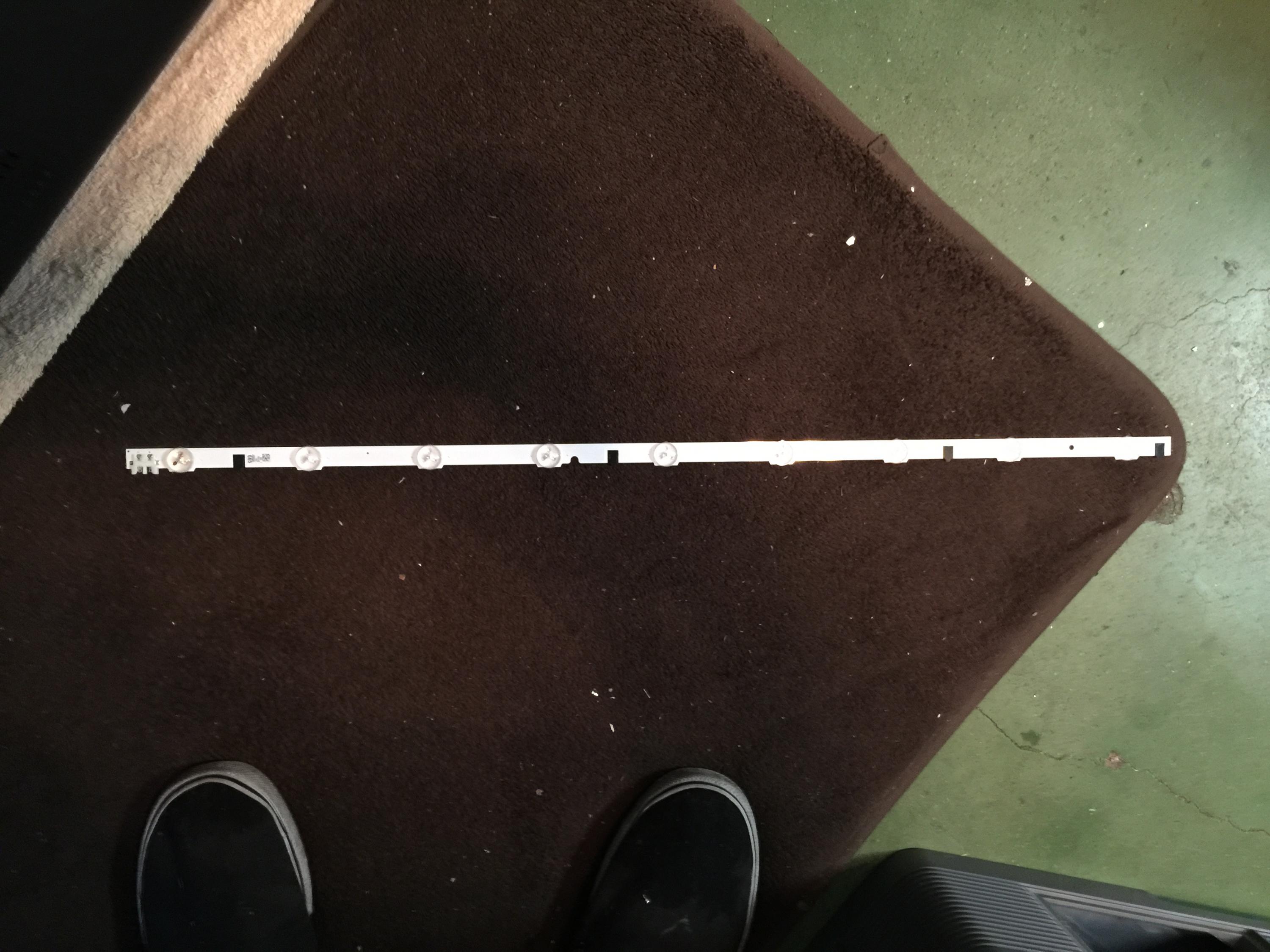

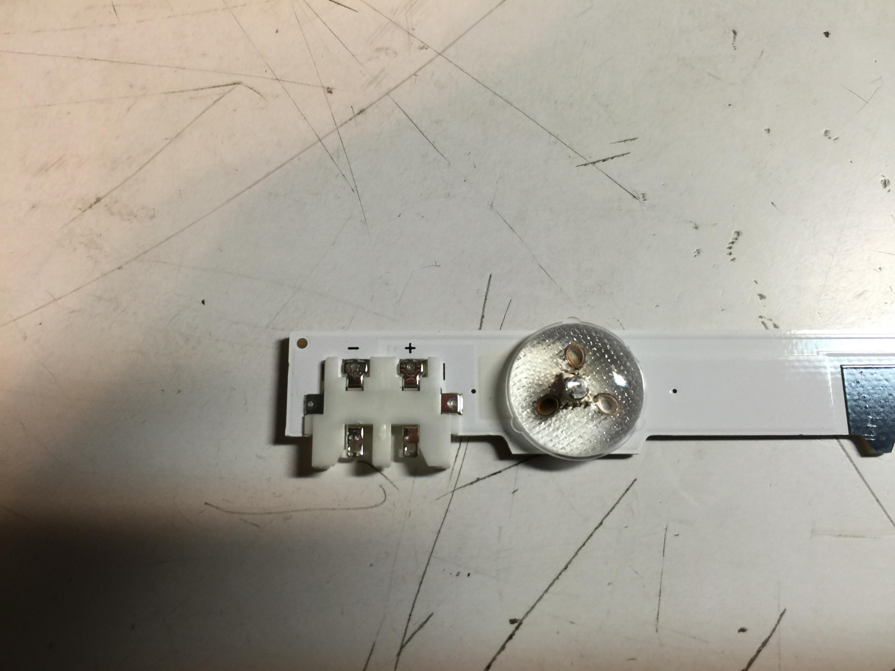

                                        This thread is about 1.5 years old, but I appreciate the information. I have bought some replacement LEDS, and am going to try and repair 3 bad strips out of 5.
                                        From what I can see in this case, the LEDS short, not open. Each strip I tested would light up, except for 1 LED on 2 strips, and 2 LEDS on the other strip. So the LEDs have to be shorted.
                                        Ordered 10 LEDs for about $25............
                                        http://www.ebay.com/itm/SAMSUNG-LUME...UAAOSwax5YnfL~
                                        Let you know how I make out when the LEDs come in in a couple weeks.....
