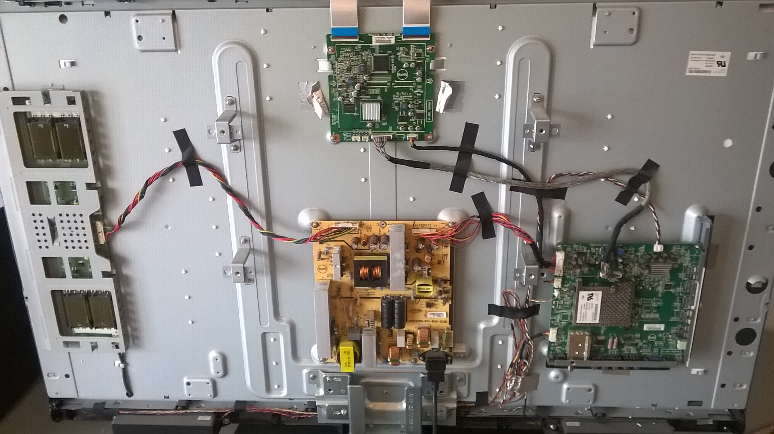

    Vizio E470VA - Backlight On But No Picture
    Backlight works but no picture.
    Below is a list of all the readings I have taken...
    Power Board
    Out to Inverter: 24v=Yes, On/Off=Yes
    Out to Main Board: 24v=Yes, 12v=Yes, 5v=Yes, PS-ON= Yes
    Large Filter Caps= ~Good~ reading was >360Vdc
    Inverter Board
    Backlight On: Yes
    Fuse: ~Good~ measured 24v
    In from Power Board: 24v=Yes, On/Off=Yes

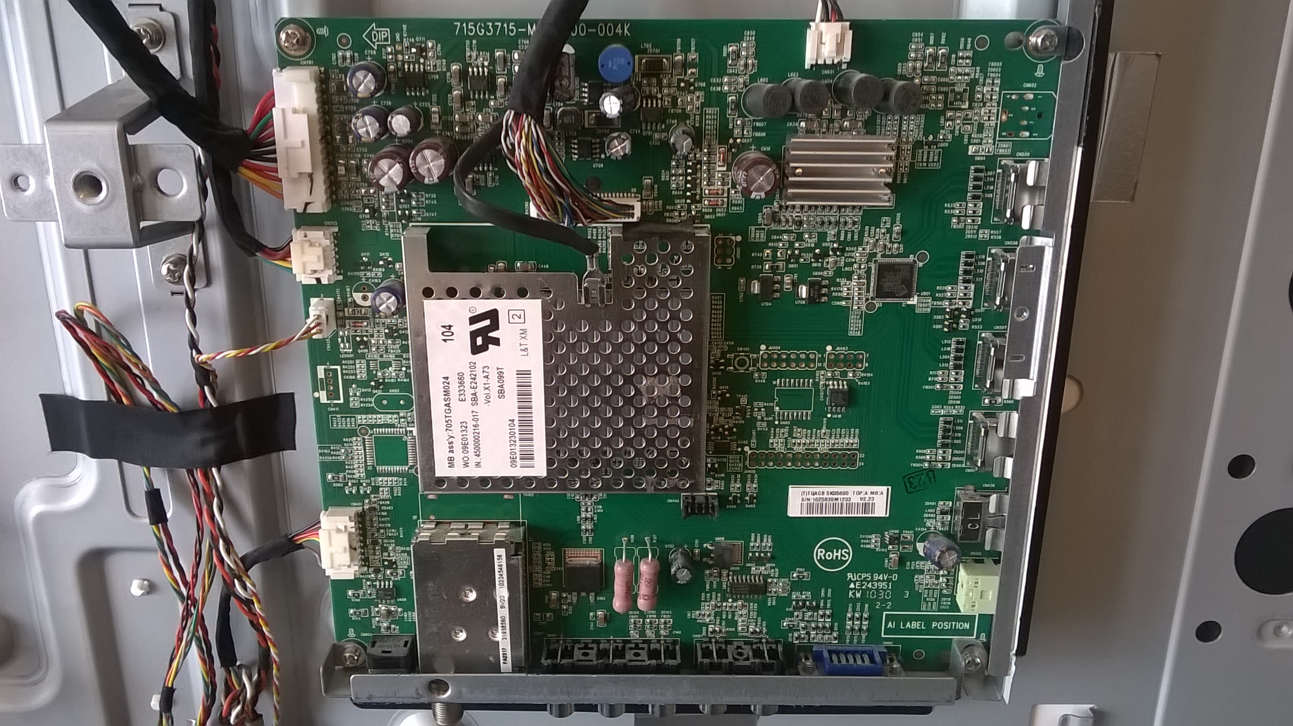

    Main Board
    In from Power Board: 24v=Yes, 12v=Yes, 5v=Yes, PS-ON= Yes
    Out to T-Con: 5v=yes
    Voltage Regulators:
    U103 (G9084)
    Output tab = 0v
    Pin 1 = 0v
    Pin 2 = 0v
    Pin 3 = 0v
    U608 (17809 0501)
    Output tab = 0v
    Pin 1 = 0v
    Pin 2 = 0v
    Pin 3 = 0v
    U704 (M171 1117-18)
    Output tab = 1.80v
    Pin 1 = 0v
    Pin 2 = 1.8v
    Pin 3 = 3.32v
    U706 (M189 1117-33)
    Output tab = 3.32v
    Pin 1 = 0v
    Pin 2 = 3.32v
    Pin 4 = 5.12v

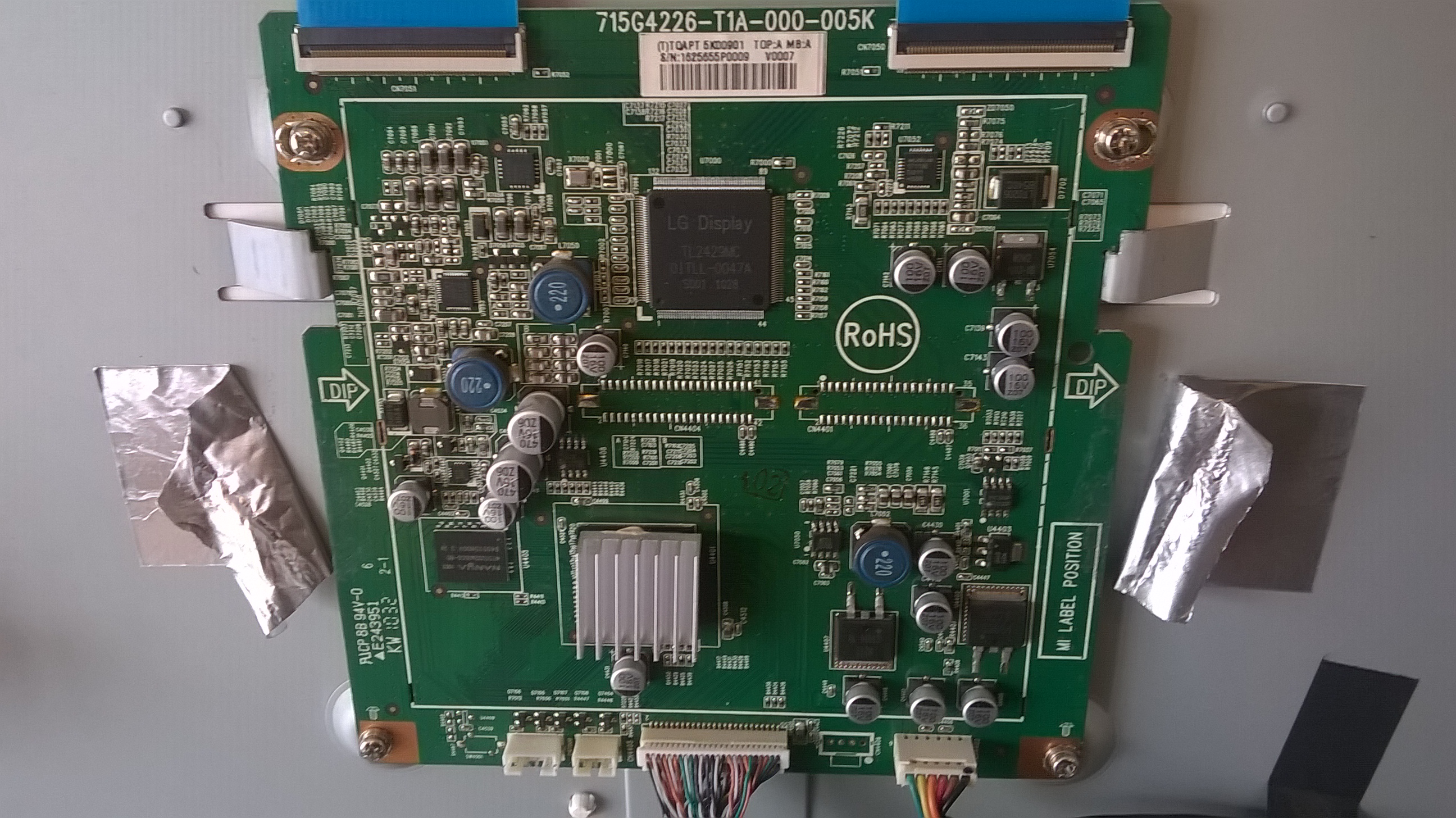

    T-CON
    In from Main Board: 5v = yes
    Fuse: Good 5v on each side.
    Voltage Regulators:
    U4407 (G1084-18)
    Output tab = 1.80v
    Pin 1 = 0v
    Pin 2 = 1.8v
    Pin 3 = 3.28v
    U4402 (G9084)
    Output tab = 3.28v
    Pin 1 = 2.04v
    Pin 2 = 3.28v
    Pin 3 = 5.06v
    U4403 (G1117)
    Output tab = 1.25v
    Pin 1 = 0v
    Pin 2 = 1.25v
    Pin 3 = 3.28v
    U7054 (1117-18)
    Output tab = 0v
    Pin 1 = 0v
    Pin 2 = 0v
    Pin 3 = 0.62v
