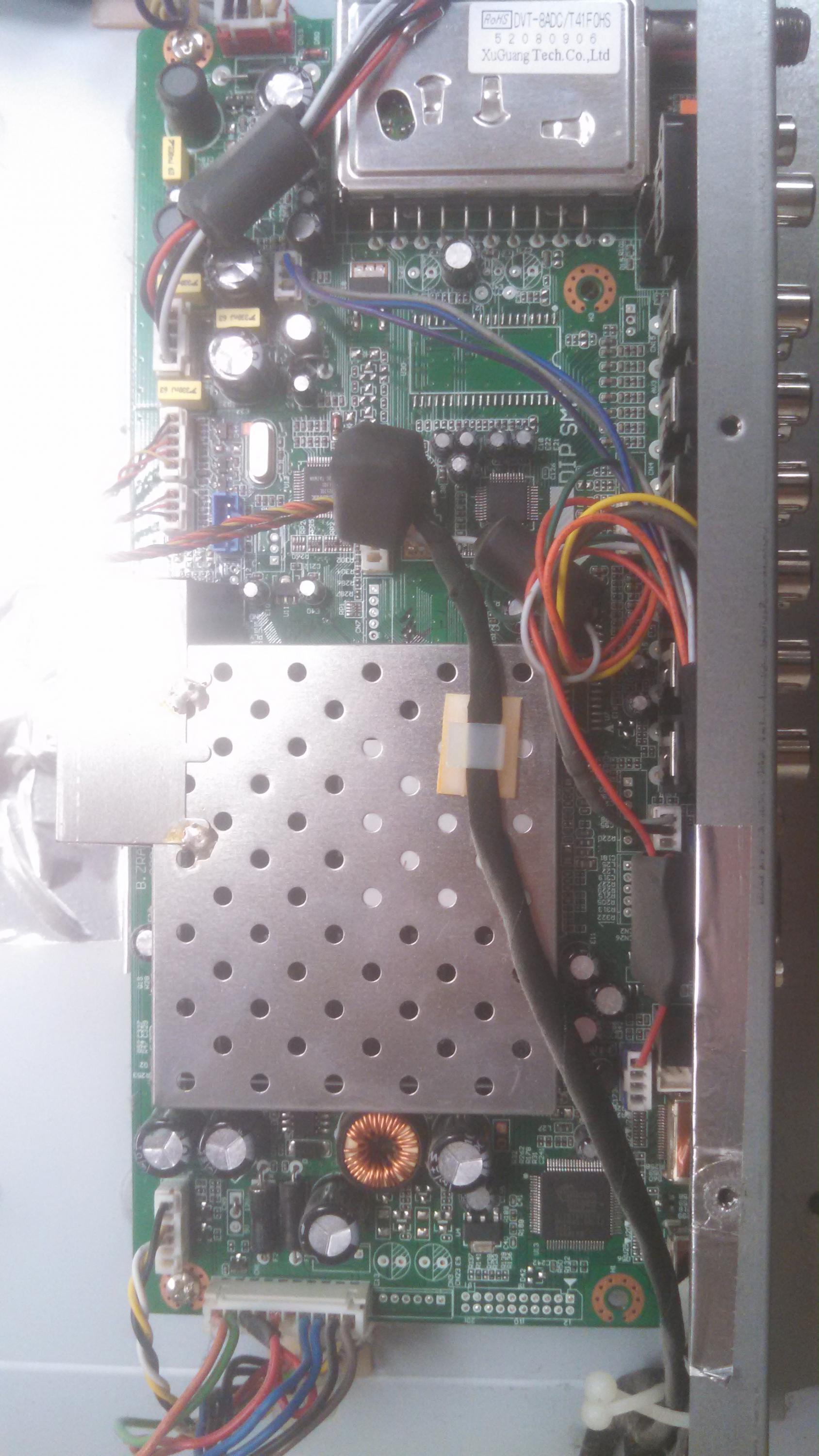

    Could you take a good clear photo of the mainboard please, I have had a similar issue on a vestel set where the audio amp was bad, the tv started backlight came one then a crackle and it shutdown, I replaced the amp and it came back to life.
    Thanks, here you are:

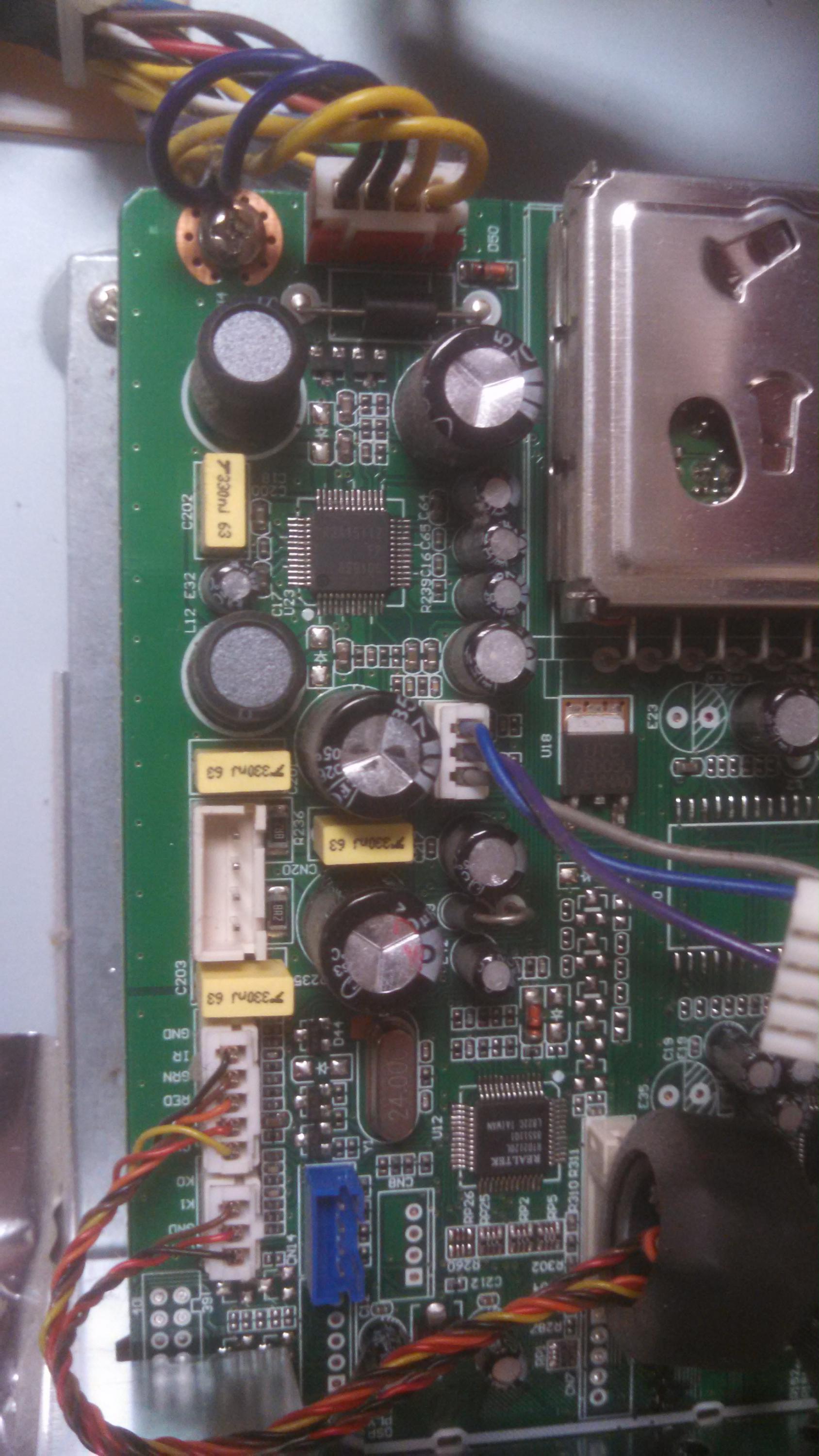

        Could you take a photo of the section where the speakers plug into please ?
          Re: Polaroid TLX-04244B Power Supply/Inv board didn't fix?!
          Here you go. The speakers plug into the empty plug there.
            Hmm maybe easier to just replace the mainboard or trying a new epprom, can you find a new board ?
              Yes, I have one on the way. Thanks for your input on this! I really hope a new Main Board will do the trick!
                  Well, the Main board did not repair it. I have to assume there is a problem with the lamps or panel and give up on this one. To the scrap heap you go!
