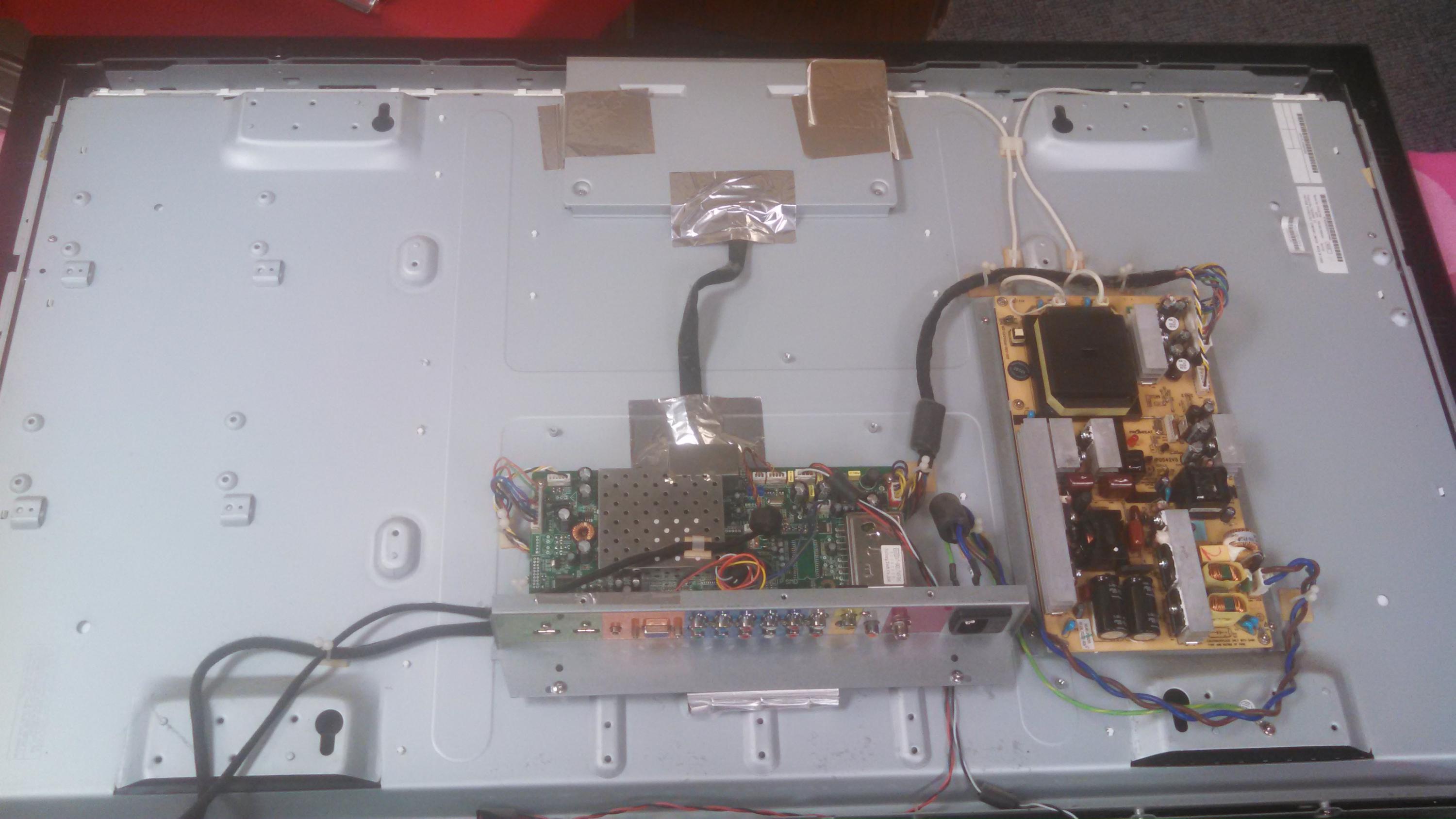

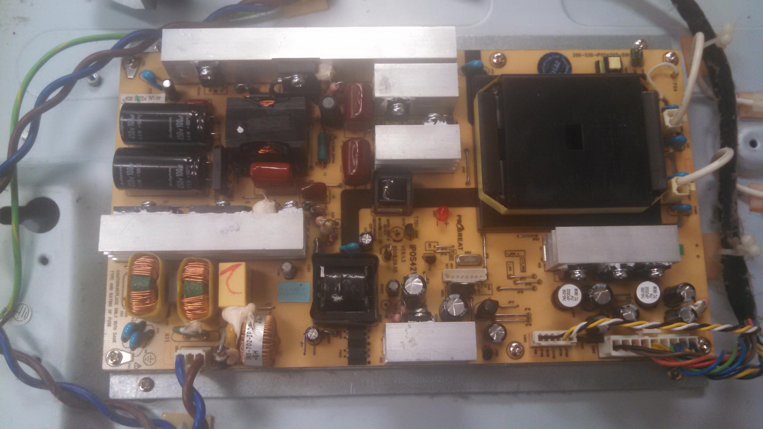

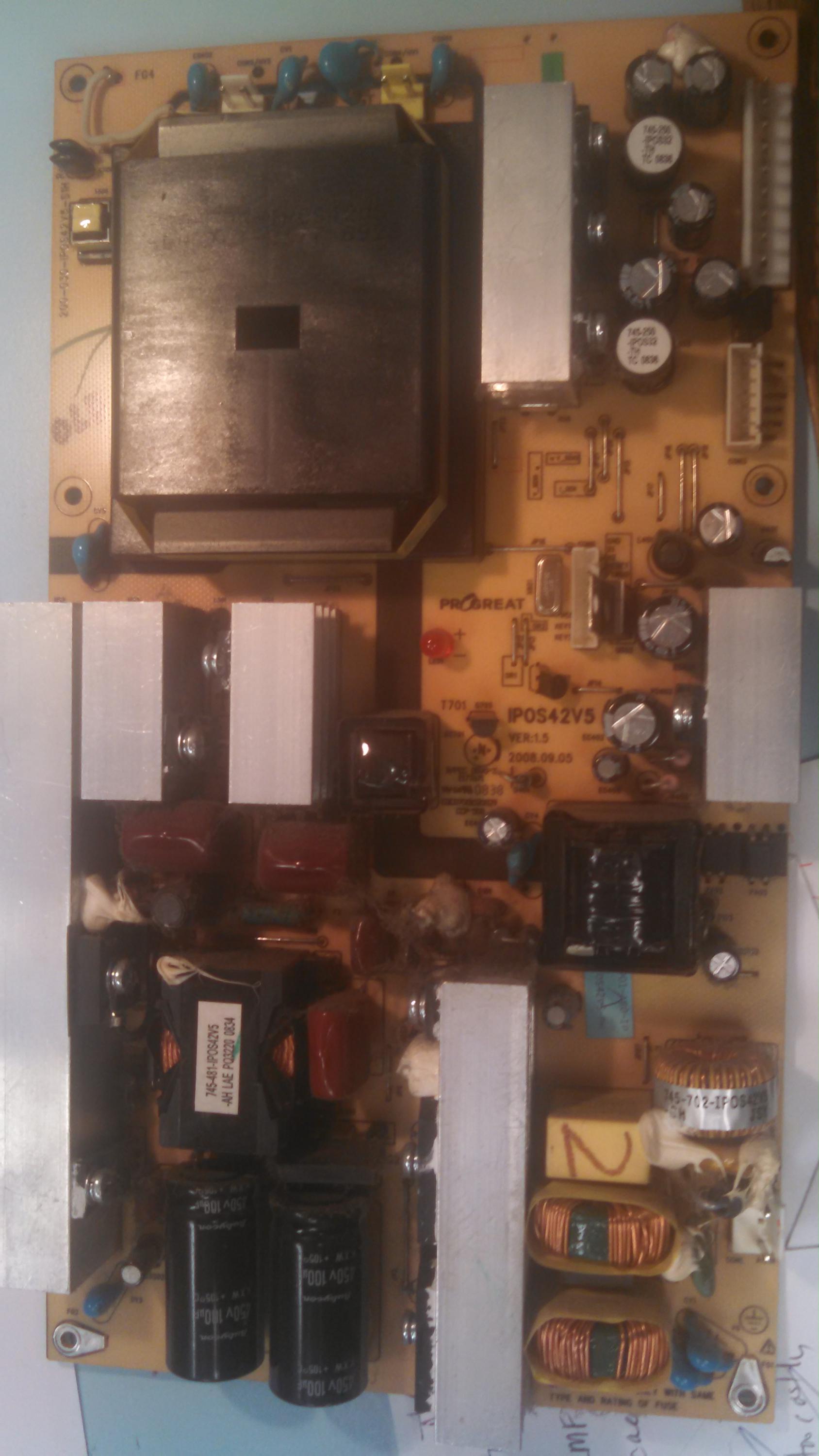

    Polaroid TLX-04244B Power Supply/Inv board didn't fix?!
    I have a Polaroid here with exact same issue described in this thread: (Comes on with Polaroid logo on screen and then shuts down with a static noise heard from speakers momentarily)
    https://www.badcaps.net/forum/showthread.php?t=13335
    In that thread, replacing the PS/Inv silved the problem, but...
    The problem here is, replacing the PS/Inv board did not help; I have the same exact symptom. I don't think I got a bad board. I've check all the blue caps on the edge of the board near the outputs to the CCFLs. I can't figure this one out.
    Help would be greatly appreciated!
    Thanks!
    Here are some pictures. (The 1st PS/Inv picture is of the new one installed and the last one is of the original PS/Inv)

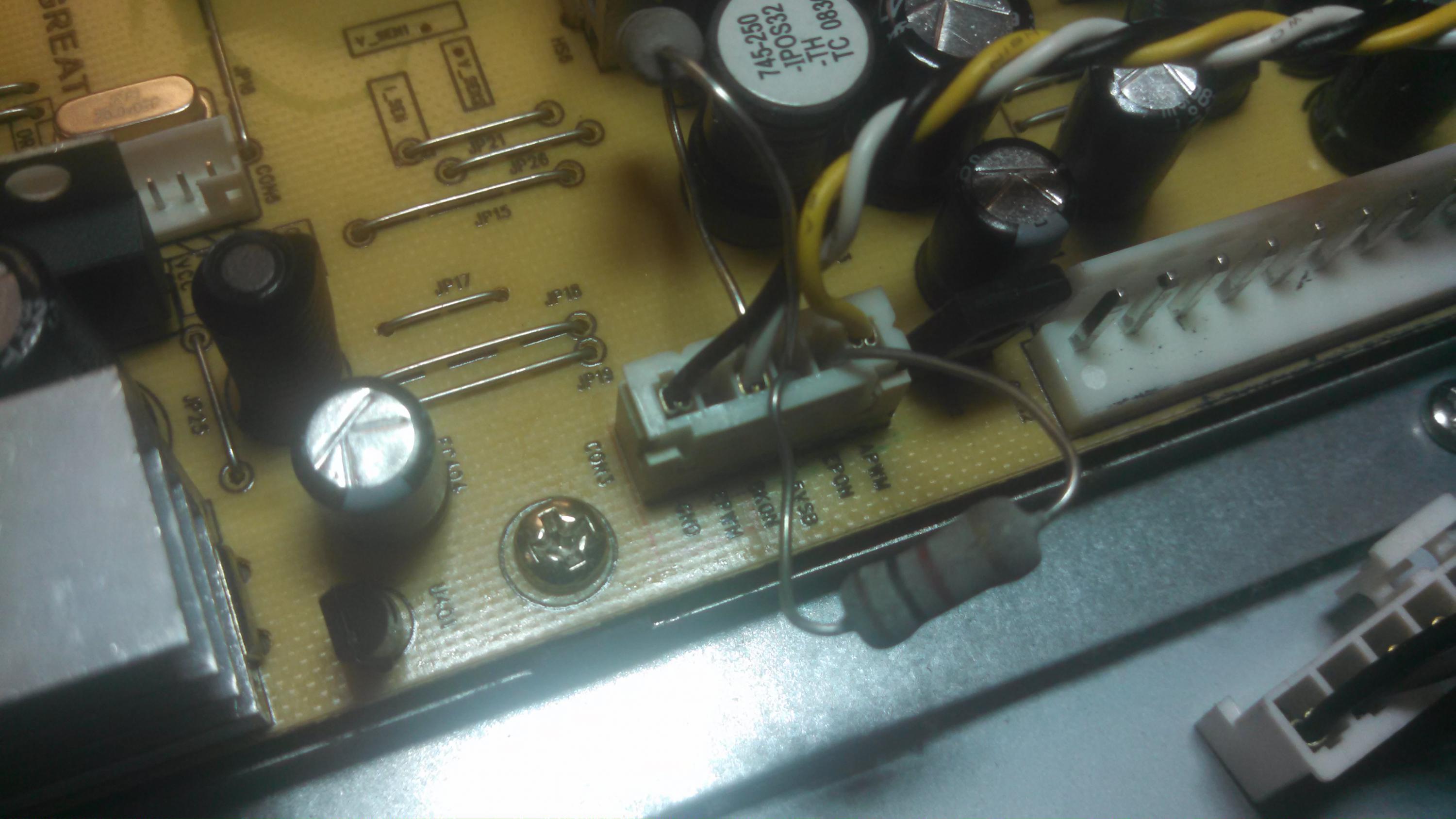

                Re: Polaroid TLX-04244B Power Supply/Inv board didn't fix?!
                O.k. shortcut. Unplug all the main board cables from the power supply. Take two 1k ohms resistors and put one between 5v STBY and PSon. Take the other resistor and jumper 5v to BLon (backlight). Plug the power supply in and all voltage rails should be up and the backlight should be on.
                    Thank you, I will try that tomorrow and let you know.
                        Okay, so I unplugged both the plugs coming from the Main Board; (the smaller plug I unplugged at the Main Board so I could use the plug holes to push in the resistors at the Power Supply side) and I tried it, but the TV will not power on/nothing happens. I sent a picture to show which pins I am shorting. One thing I noted is that that cable is not using all of it's wires even though the pins are there and labeled on the board. I do get the voltages there (before unplugging anything), but I don't know if it matters that there are no wires going to the Main Board there anyway? Also, am I using the correct pins? See the attached picture.

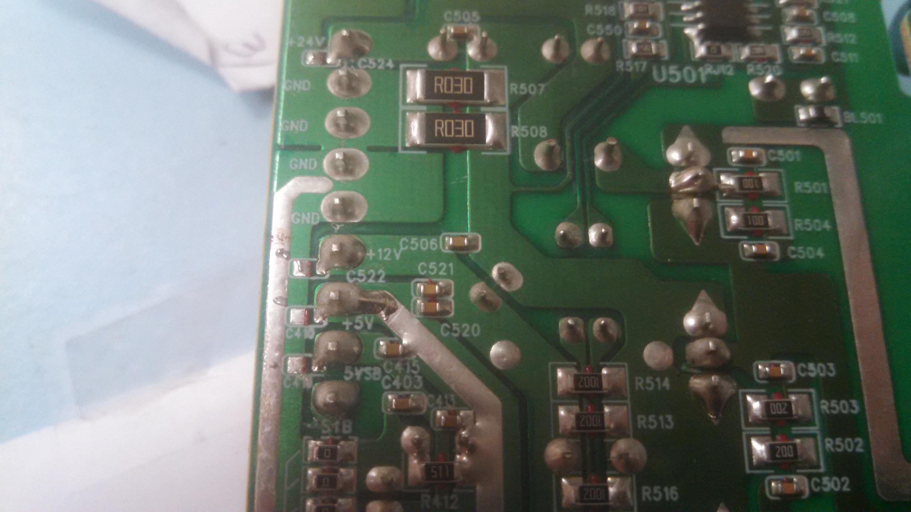

                              what is the pin out on the other connector?
                              That larger connector to the right? It doesn't have anything printed on or near it on the top side of the board, but here is a picture of it's markings on the bottom of the board:
