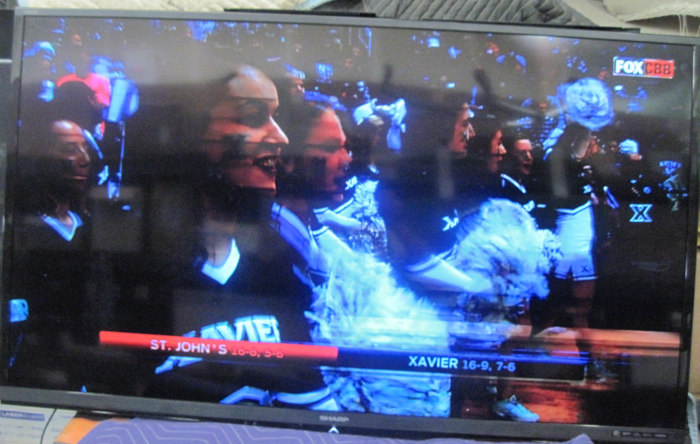

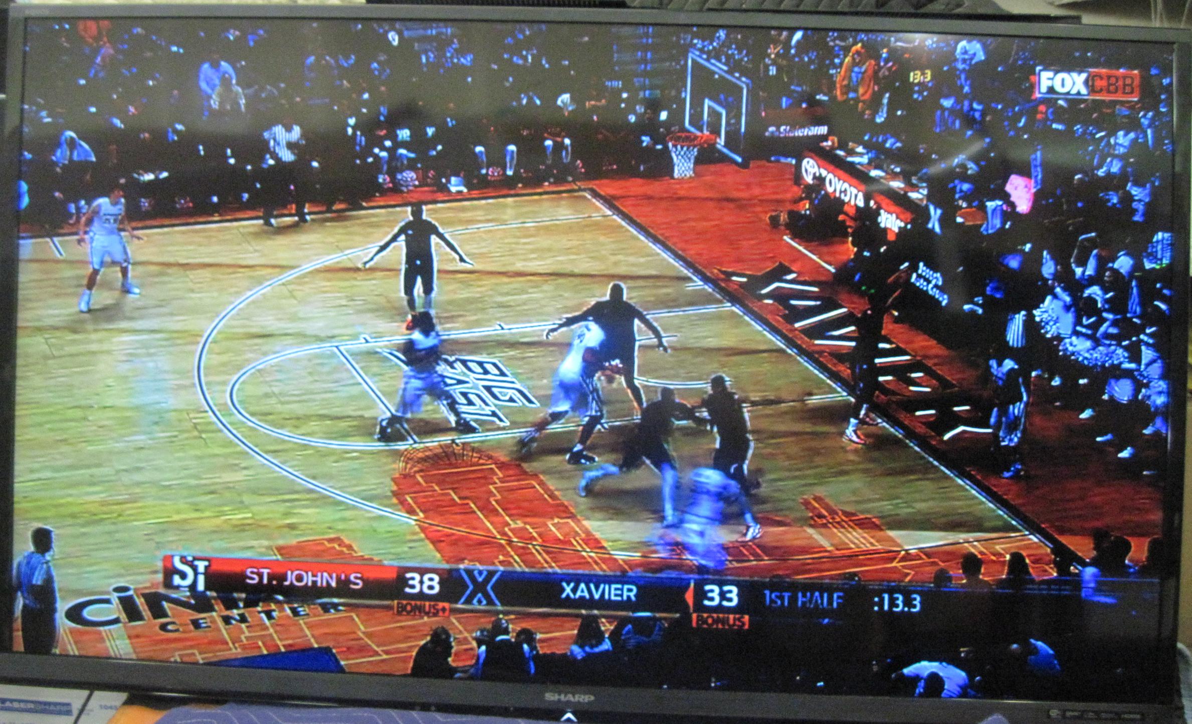

    I have a Sharp 60" TV Model LC-60LE650U LCD TV. The picture is darker, distorted and keeps getting horizontal dark flashing lines or bands.

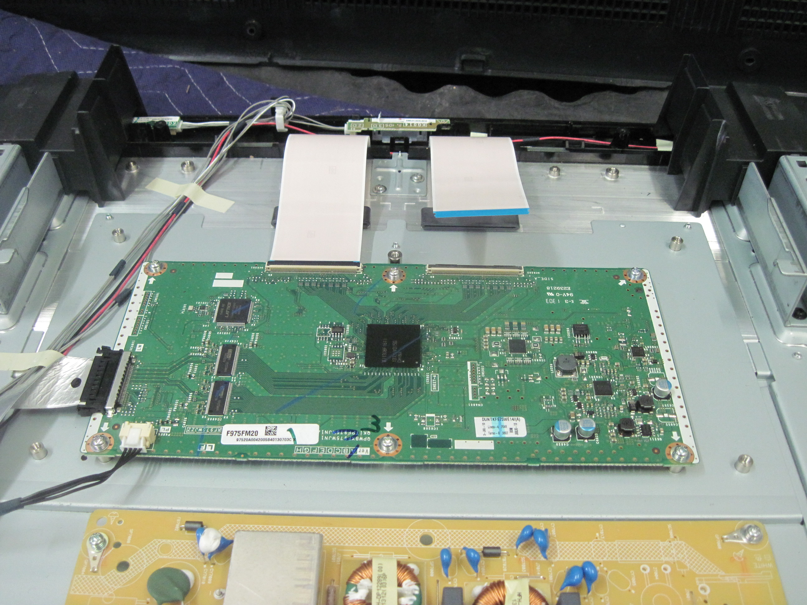

    2. Ordered new T-con card, problem remains.

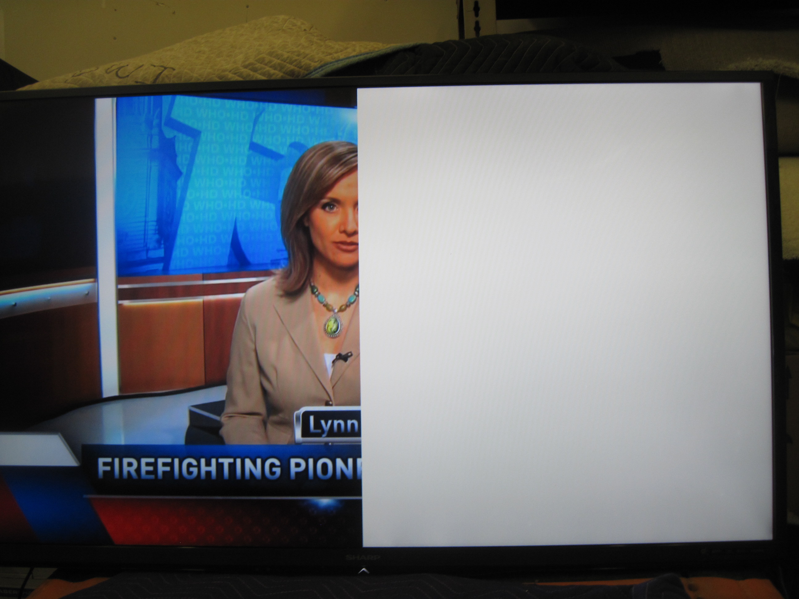

    3. I thought of taking one ribbon out of the t-Con and turn the unit on, then half of the screen went white and the other half remained having the same problem.
    4. I put the one I disconnected back, and disconnected the other one ... then half of the screen went white, and the other have was perfectly fine nice picture.
    5. hm, that got me thinking may be the ribbon is the problem, so I switch ribbons, but that did not have any effect on the previous results. Ribbons acted the same when switched.
    Any idea what could be the problem? Since one half of the screen works perfectly when the defected half is disconnected, why when we connect both the whole screen goes bad?

      If you look at the last picture, it shows half the panel working fine when the other half is unplugged. That made me rule out the panel failure. Pressing on the tab bonds does not make any difference.

        Yes but if there us a short in the panel on the bad side this will take down the drive voltages and functions that the tcon uses to drive the panel causing both sides to display the problem. Kind if like mirroring the image.

              freakaftr8 seemed to be confident that the panel was the problem. So I did not want to waste much more time on it. Decided to part it.

                  I have same issue with right ribbon disconnected the tv remanis on only left side got video on right its primarily white.I gus theres a short beyond that point.Otherwise i have also 2 short and 5 long pulses and unit wont power up.Thanks for good info guys this site rocks.

                      You could remove the tabs on either the left or right side of the panel. You need to figure out wich side of the panel is bad and remove those tabs on the side ( 3 or 4 small tabs ).

                        Mine was same as your pic abe700 tried switch to other side no luck.Saved all boards rest trashed
