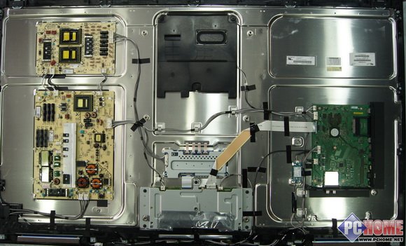

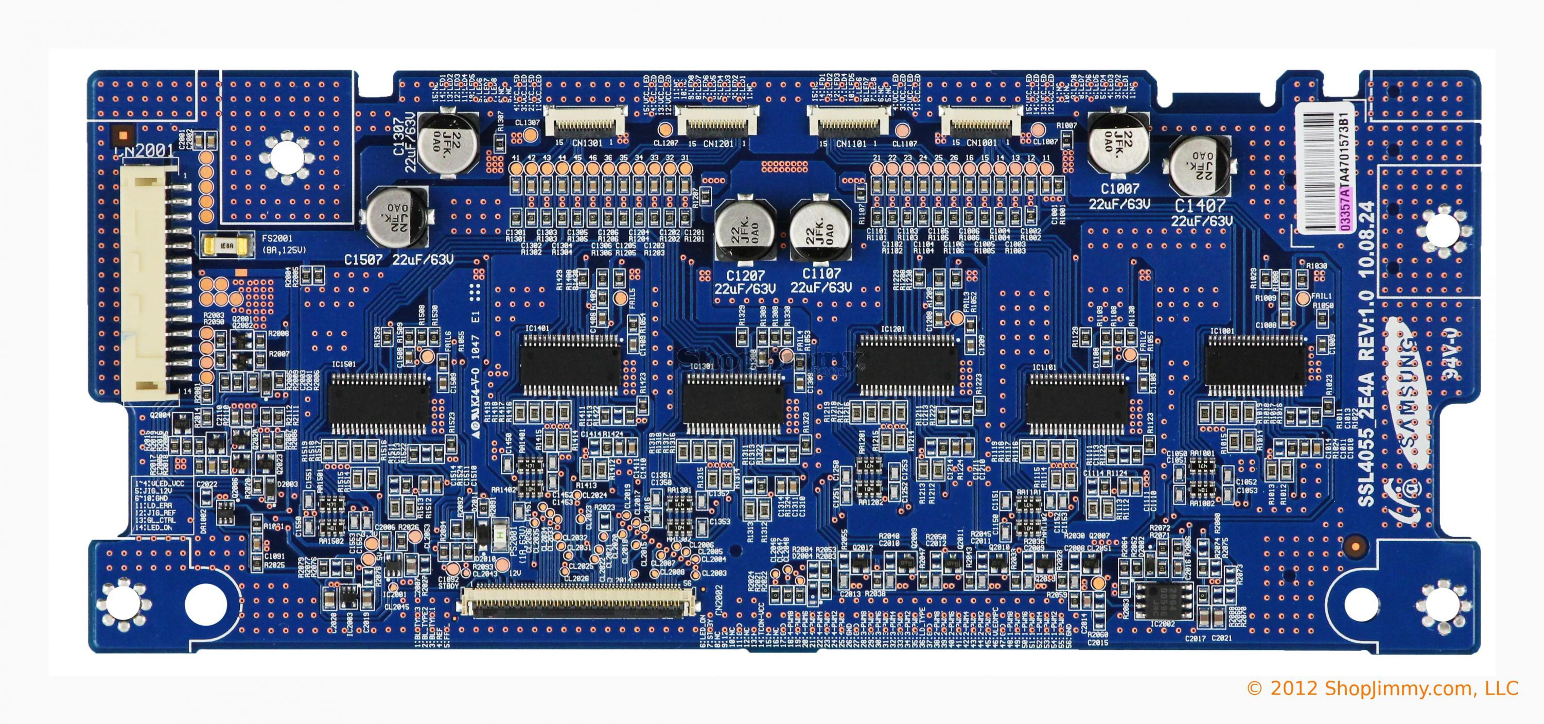

        • zomi
          • Nov 2011
          • 512
          Re: Sony 55hx823 4 Blinks

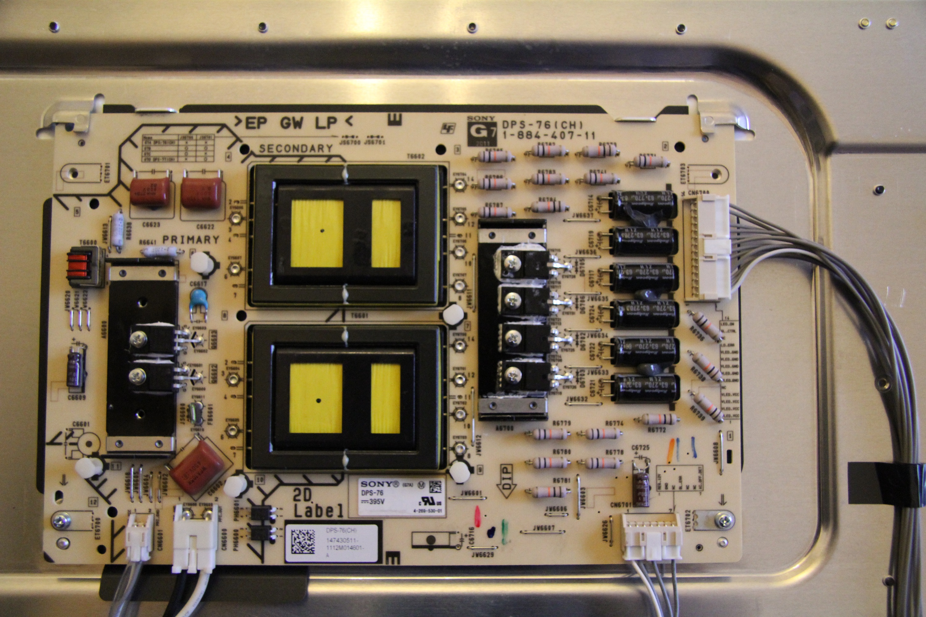

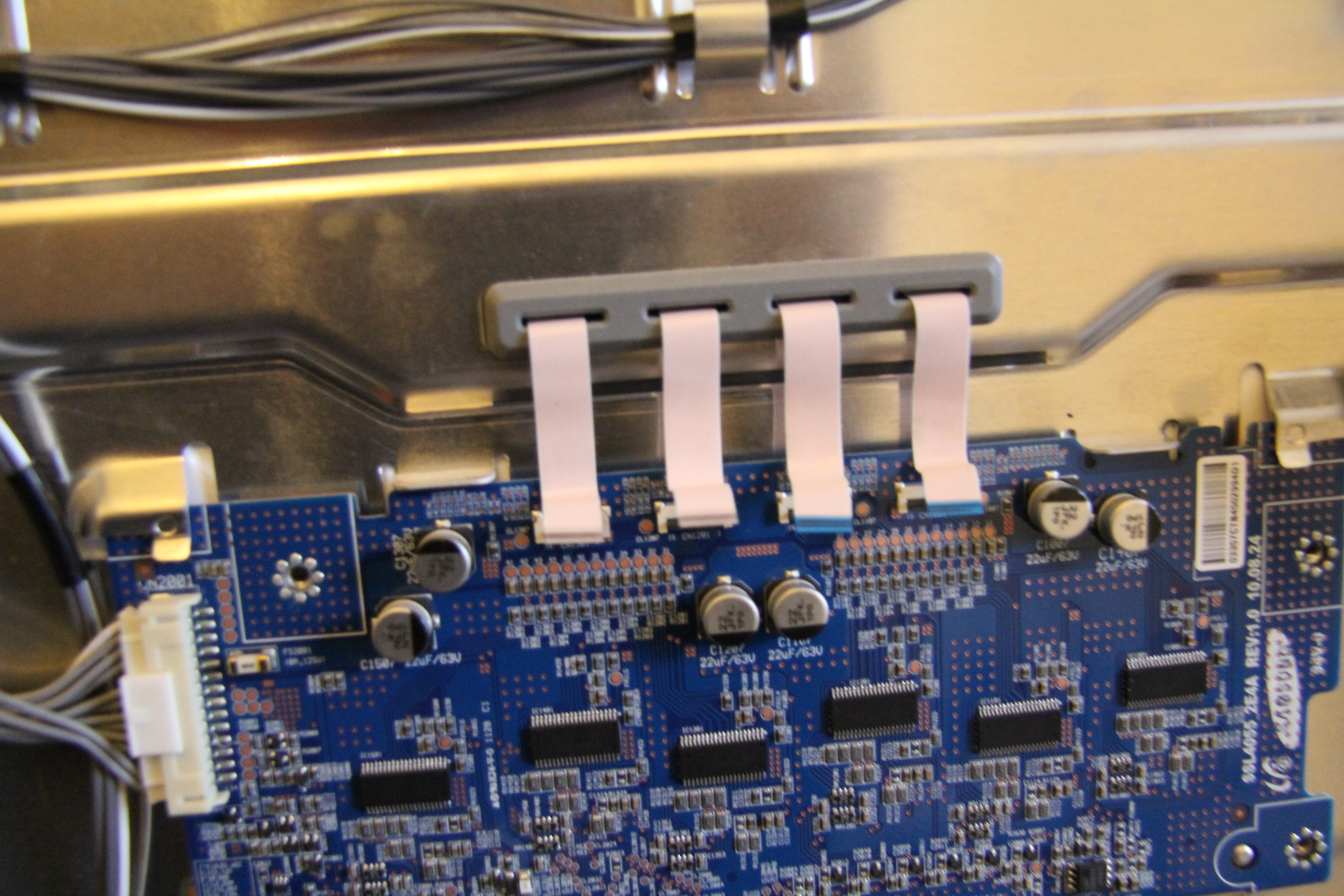

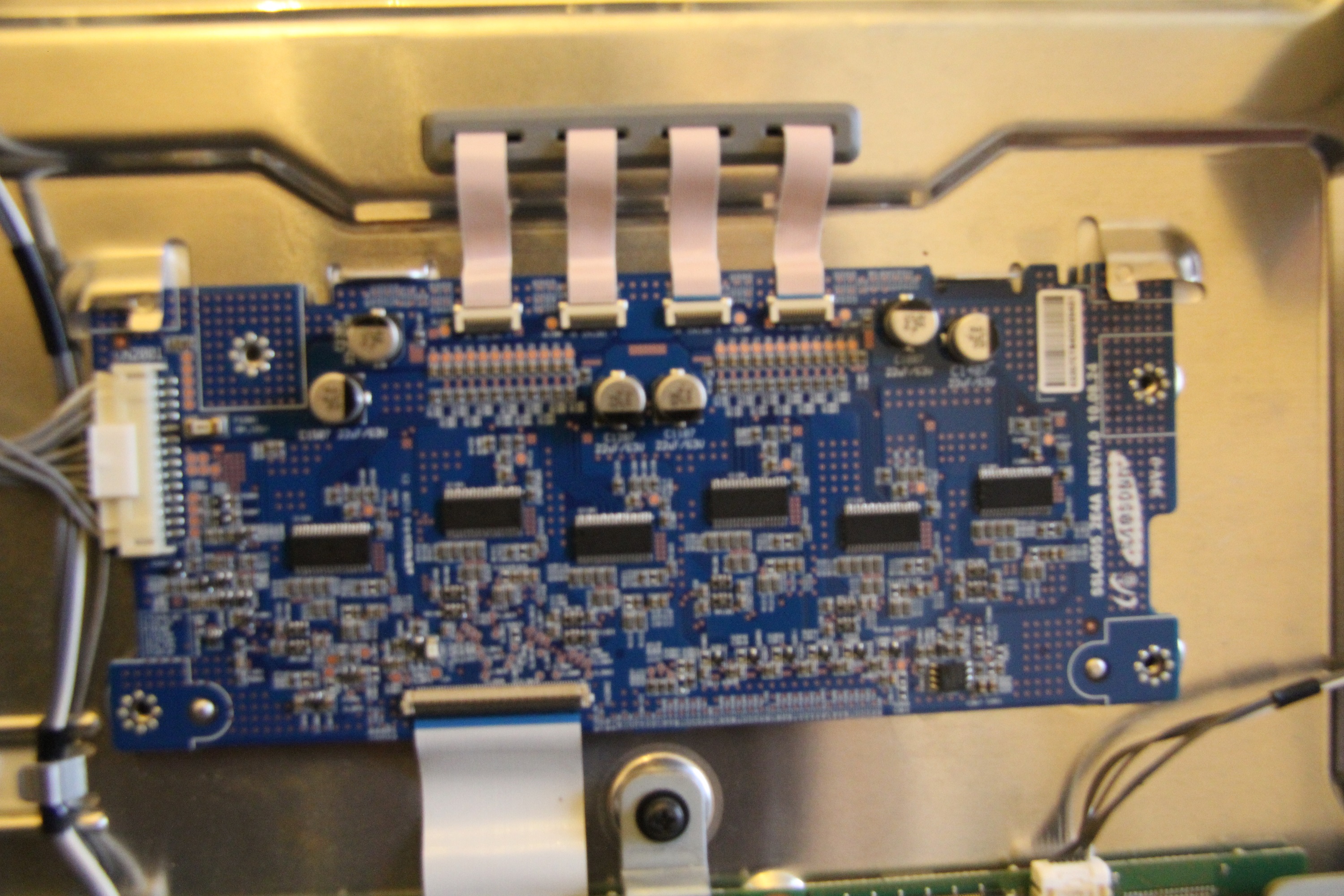

          here are some internet pics of the inisde of the tv
          and the led driver board
          its the same as the 46hx823 one.
          • nomoresonys
            • Jan 2013
            • 12332
            • U.S.
            could be bad capacitor/s on power supply.
              yep that picture on the right is the led balancer board and those driver ICs are known to fail like I said I've worked on a few of these now with the same problem they're very intermittent but if the LEDs light up then they are good.
              of course there is always a chance that you have a short in one of the wires that go to the LED backlights that run into the back frame behind the LCD panel. I've seen that too and that could present a problem as the TV starts to warm up things move in the wire touches ground. What happens when it shuts down with 4 blinks and you immediately disconnect the power and connect it back up and then power it up does it come right back on and play for awhile again? because if that's the case and it does come back on then that would blow my theory about the shorted wire
                  I have worked on an NX one and the ballancer board looks very similar, if not the same. The IC it was available, but the whole board it was $58 from shopjimmy and I couldn't way for three weeks, for the ICs to arrive from China.
                  There are test points at each IC, you could compare them and see which one is bad.

                      Yep that balancer board is identical to a kdl-55hx729 I repaired. It came on with perfect picture for 10 seconds them the bottom right would go out. After that 4 blinks. Like tibimakai said there are testpoints you can use to check each ic with the next til you find the bad one.

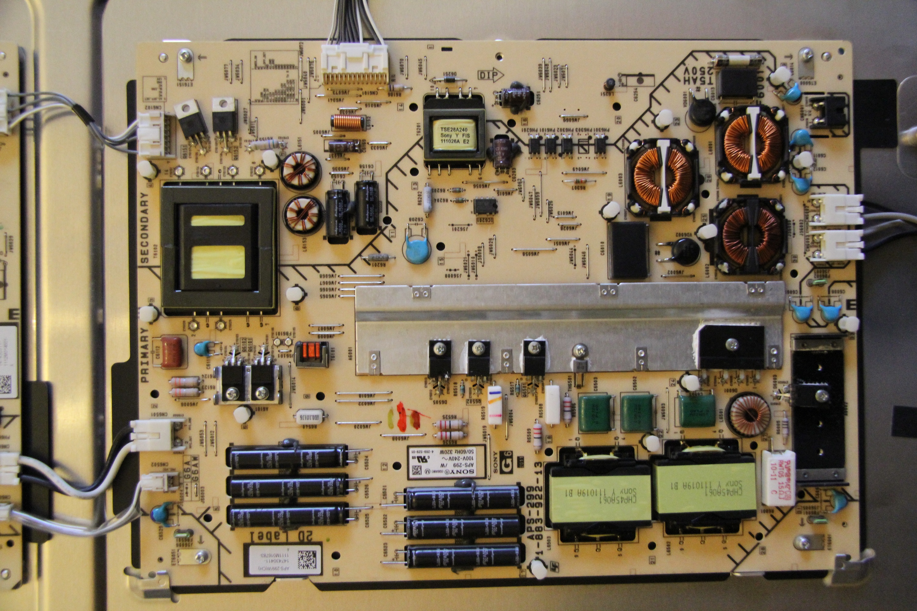

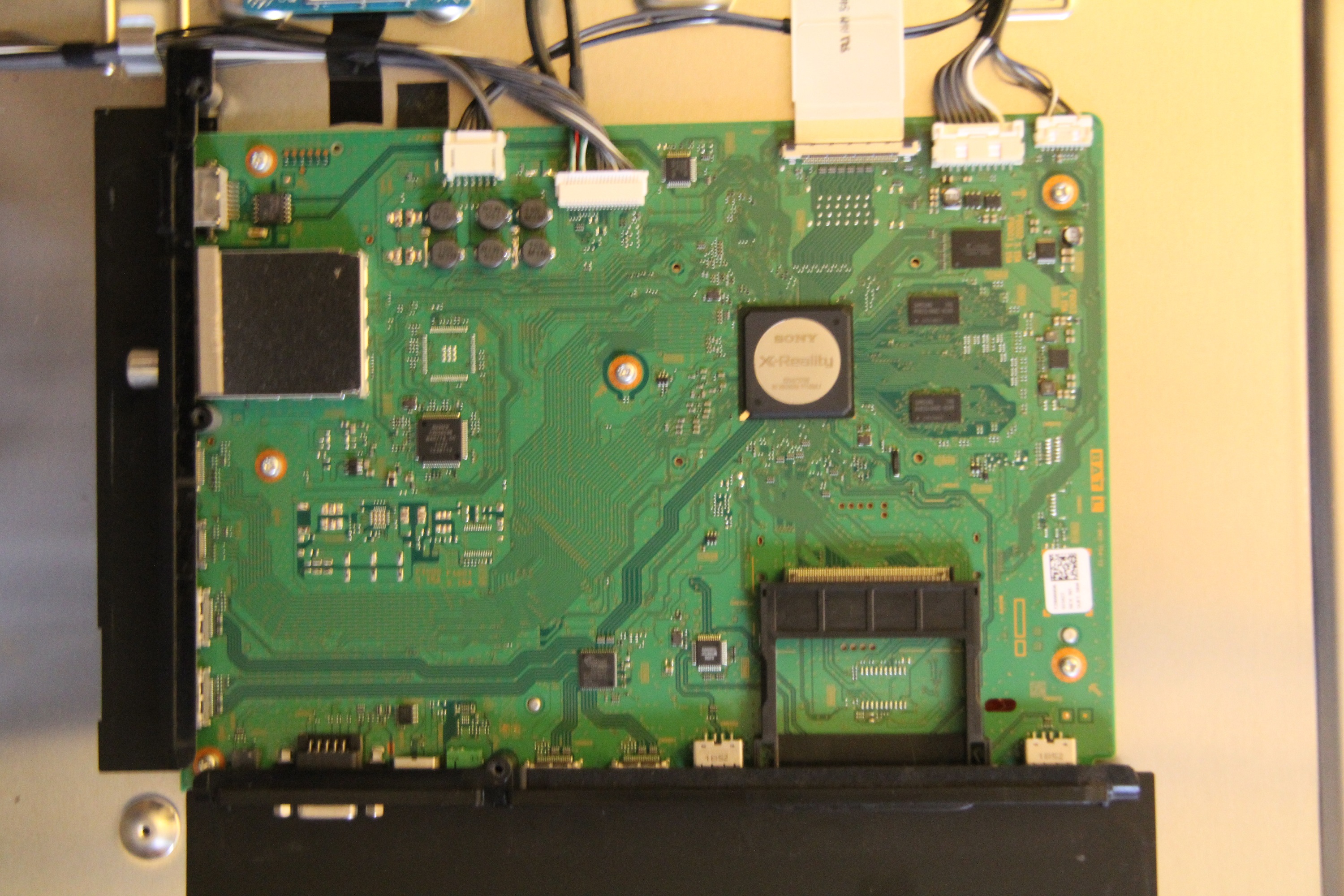

                        • zomi
                          • Nov 2011
                          • 512
                          Voltage at the fail point on the ic is 2.848
                          At cn6002 i have 2.79v
                          • zomi
                            • Nov 2011
                            • 512
                            At the test points near the 4 clips for the ribbon cables I have 29.84 across each one

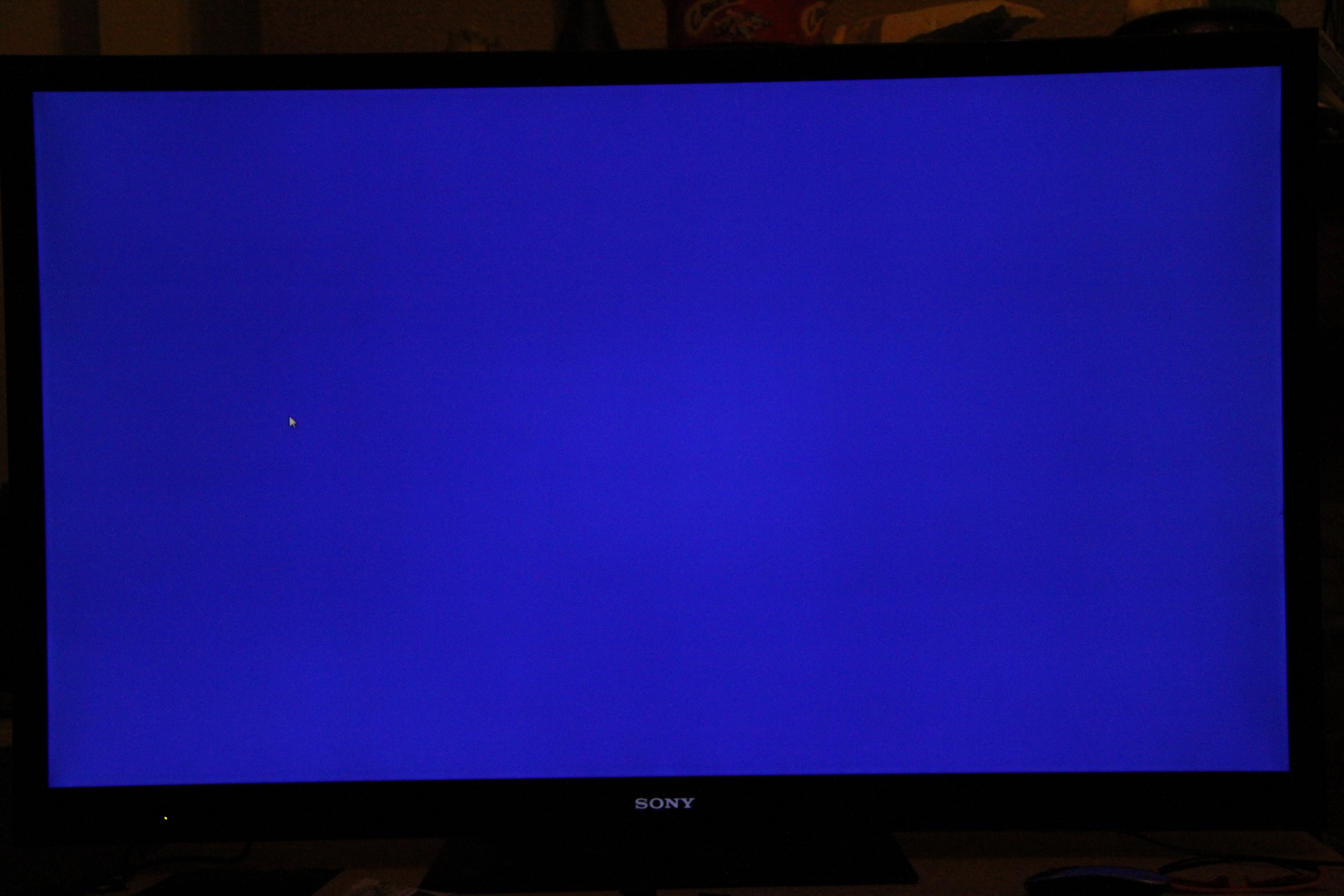

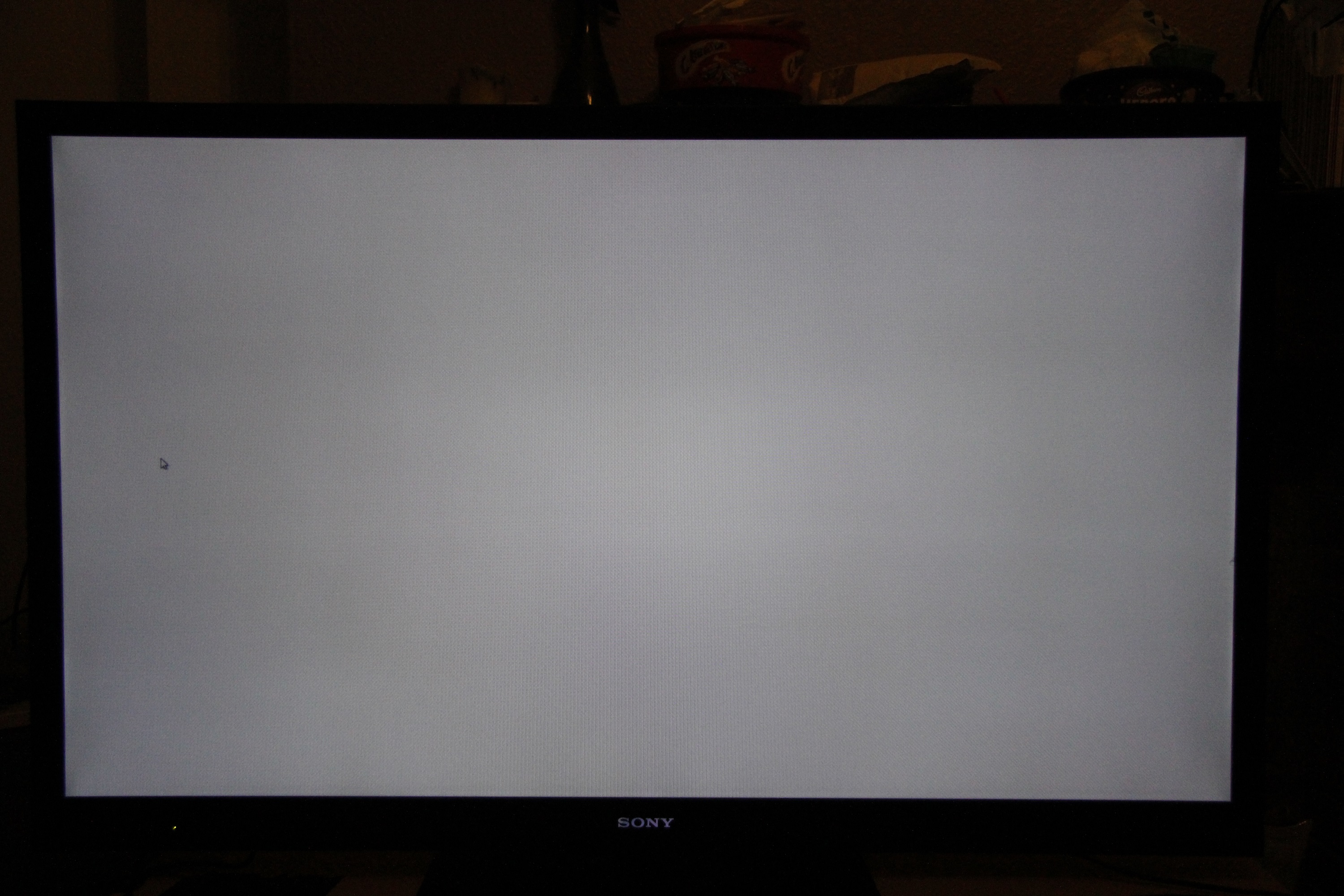

                              I tried the method with Tcon disconnected
                              and power on and plug in to create white screen
                              All whiteness is uniform
                              no indication of led gone out.
                              When turning on today it was on and off intermittently
                              Now I have released the tension clip on 2 /4 of the led cables its been working for
                              20 mins
                              no issues..
                              If it works for min or 2 then turn off for few secs its back on for a min or 2..
                              @freakaftr8 i think that rules out cabling ??
                              So not sure at moment what issue is

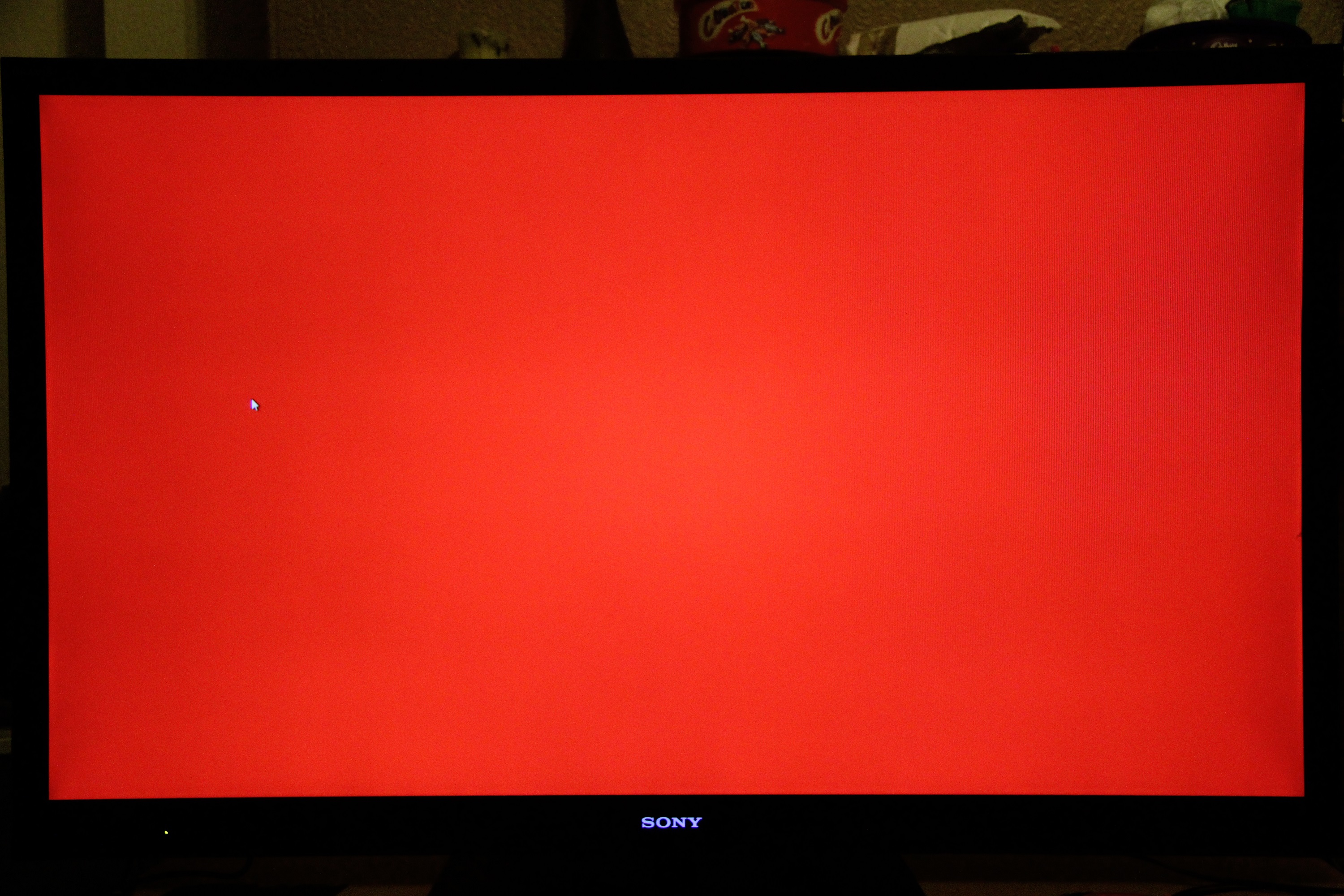

                                    • zomi
                                      • Nov 2011
                                      • 512
                                      As you can see leds themselves seem to be fine..
