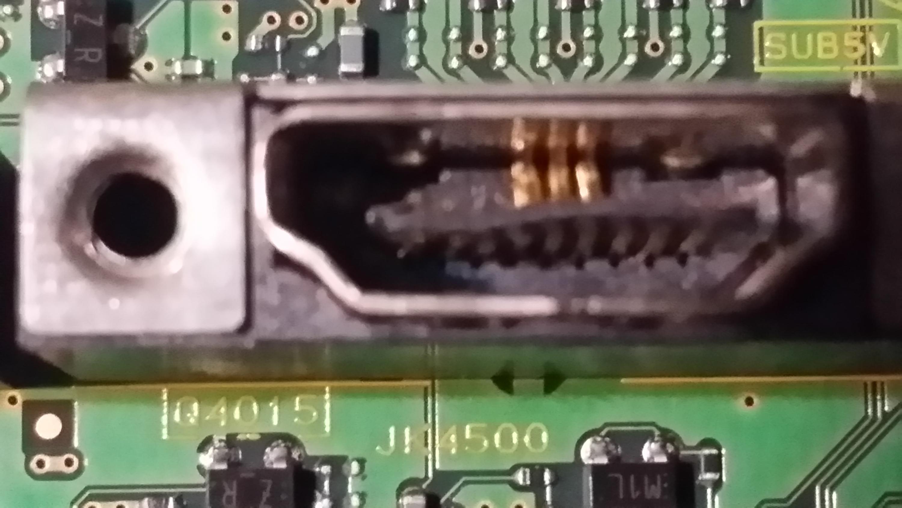

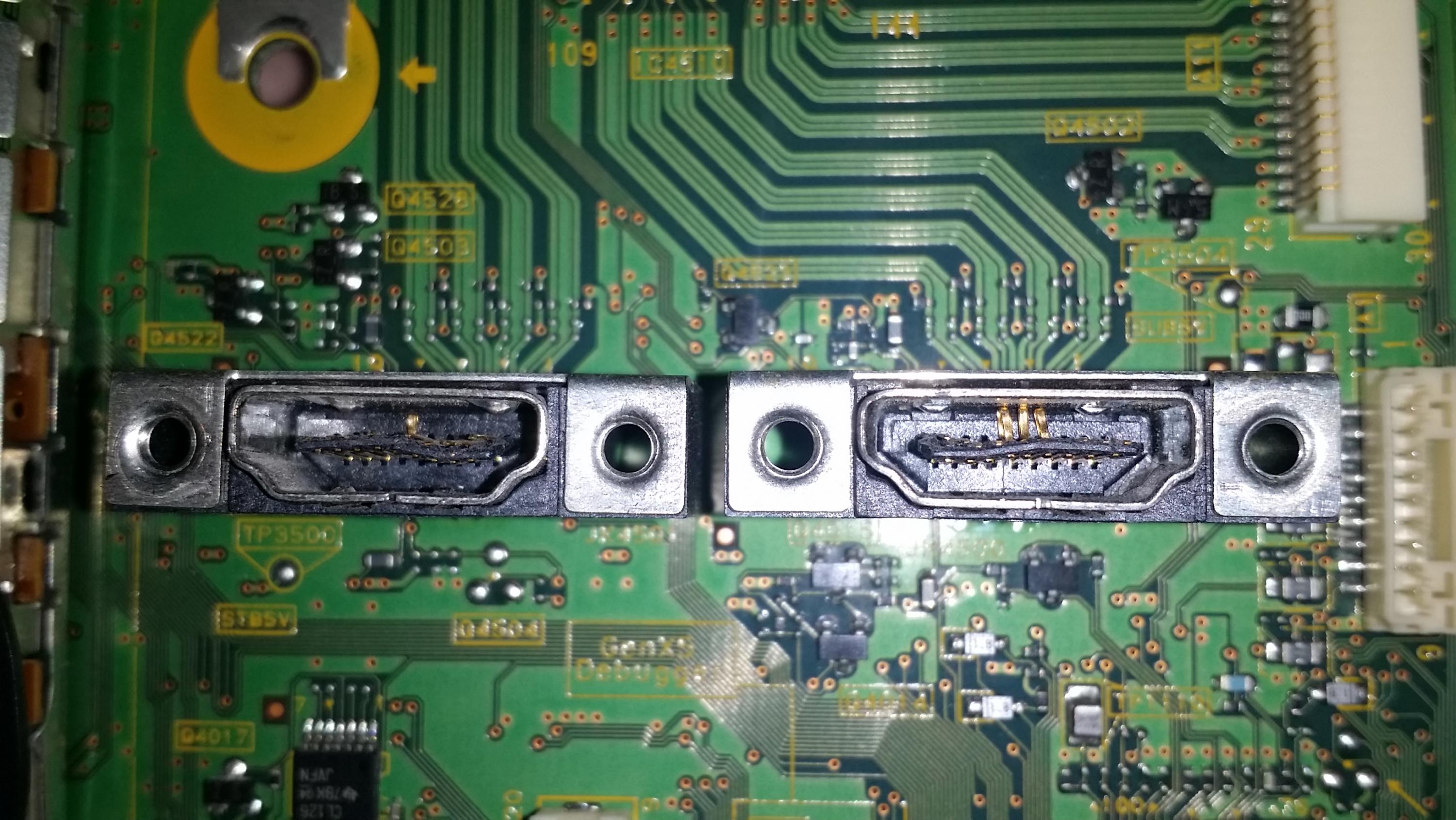

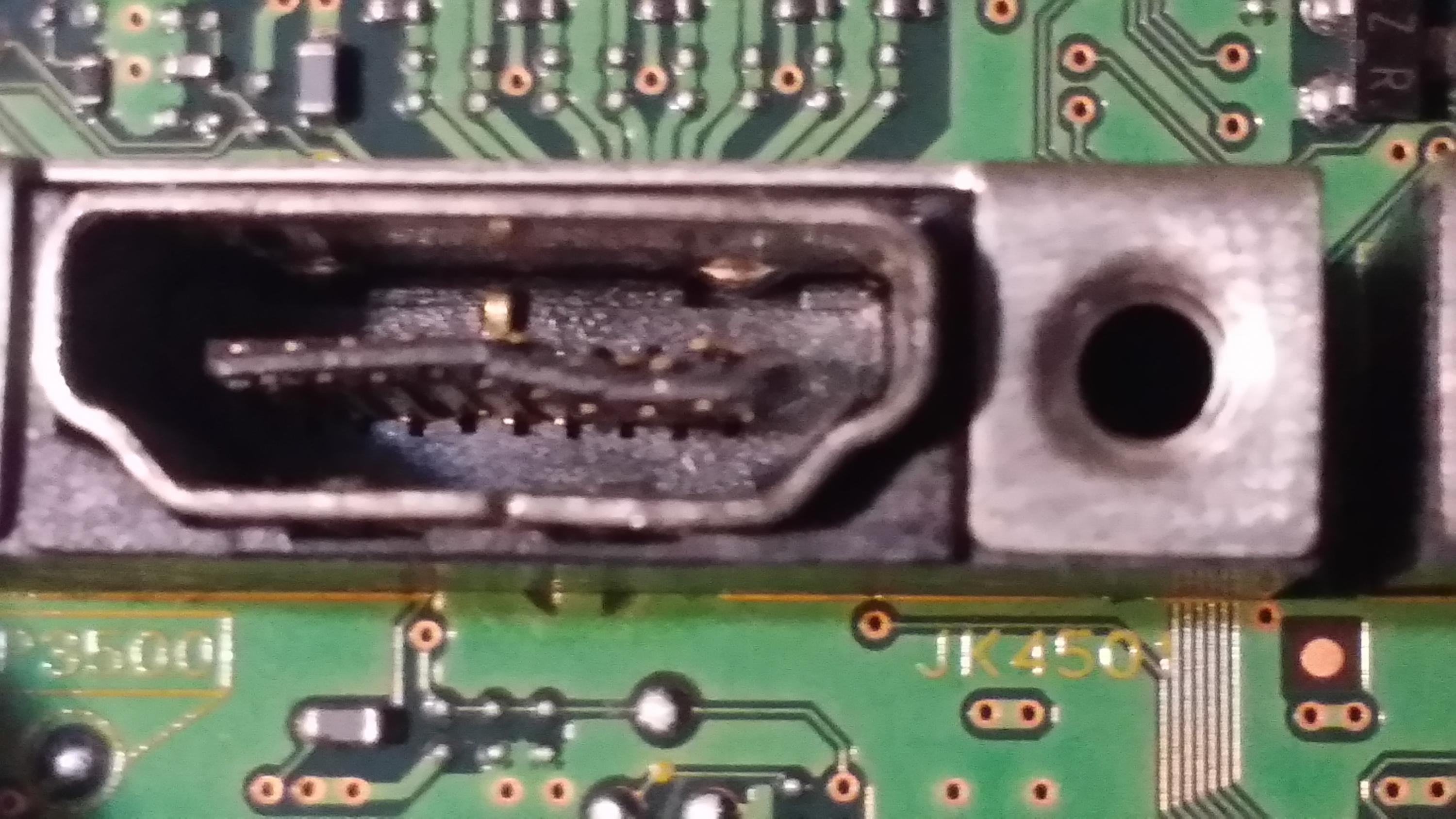

          Quick question, anyway of of taking the HDMI ports off my old board and putting them on this one, looks like they were put on by machine and near impossible to change out, unless there is a plug and play option of some sort? Heres a pic.
            Re: Panasonic TH-42PZ85U No Picture
            Looks to me like that board was baked - a little too high or a little too long. Any other evidence of plastic deformation anywhere ?
              None at all, It works thought. I managed to straighten out the pins on HDMI 1 and got it to work, oddly enough HDMI 3 is a remote port on the side of the tv connected with a pin cable internally so you would have assumed that one should work no matter what. But it didnt, even after I got number HDMI 1 working. I straightened out the pins thinking that them touching eachother was causing HDMI 3 not work like shorting it out but ended up getting lucky and fixing one of them. Luckily the seller refunded me in full for the board because of the defective ports.
              But I agree it looks like it had been reflowed and baked too long. Oh well the tv has gone to a happy new home now and I put a couple of benjamins in my pocket.
