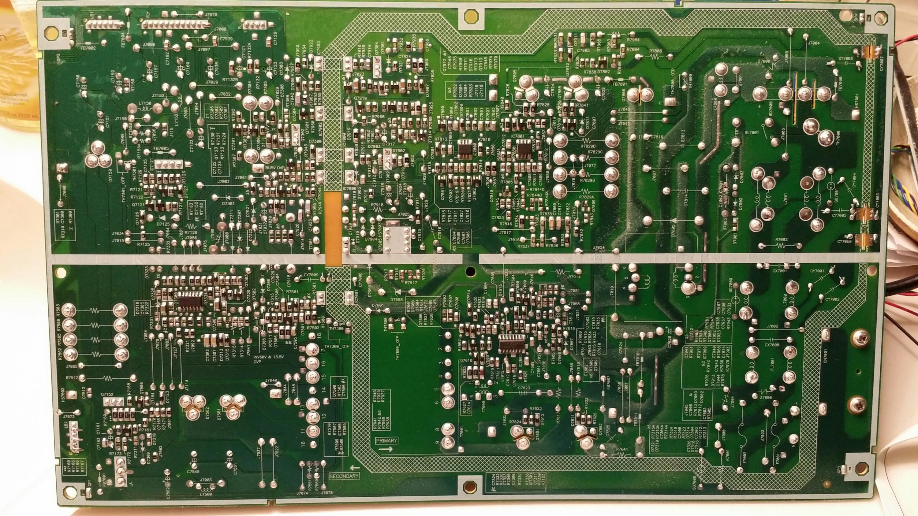

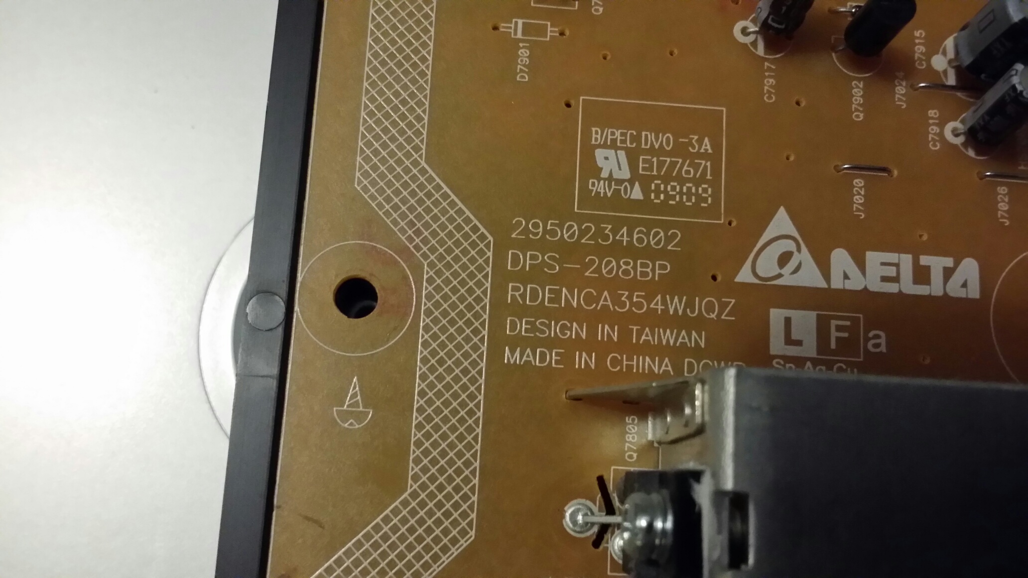

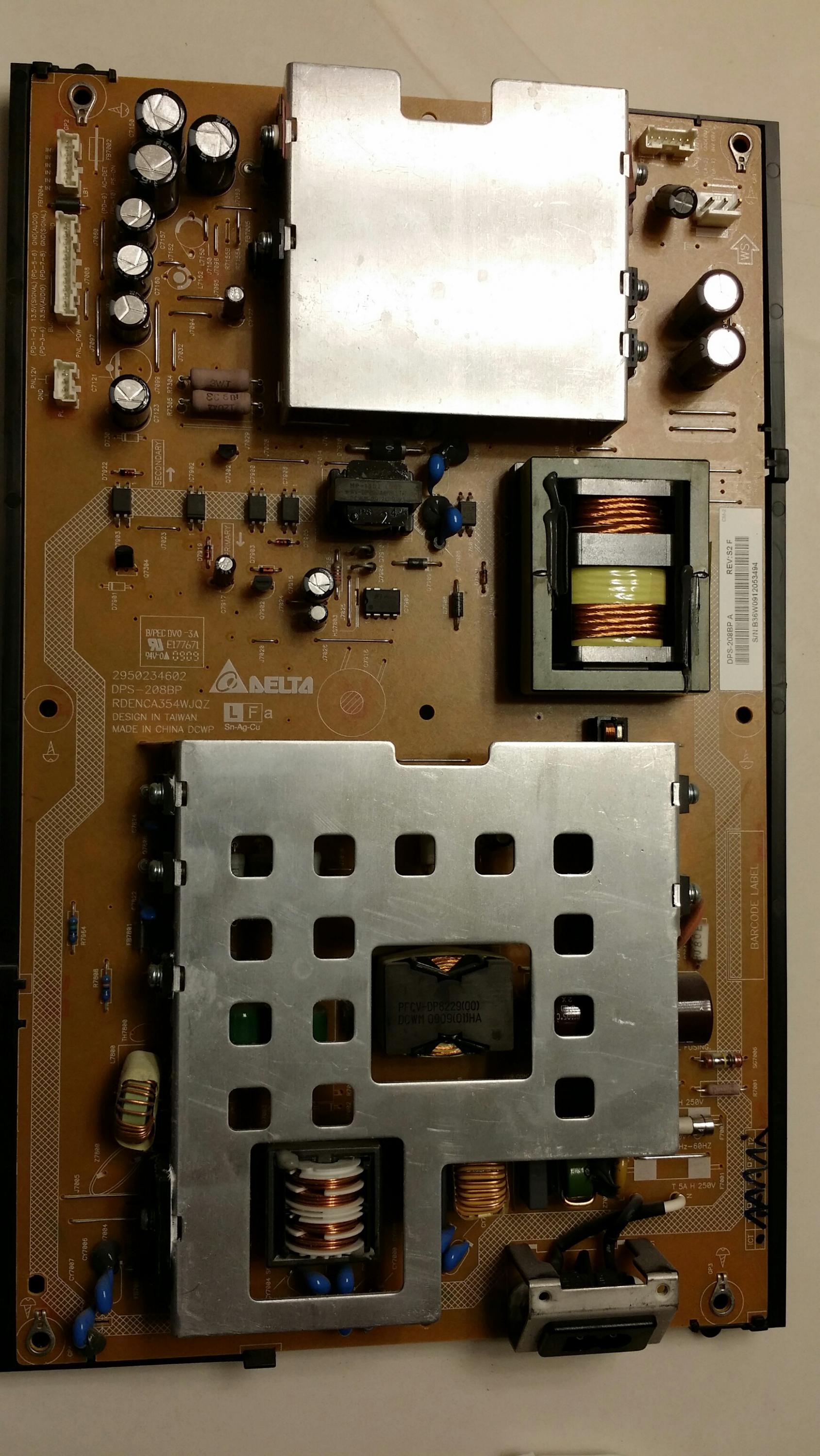

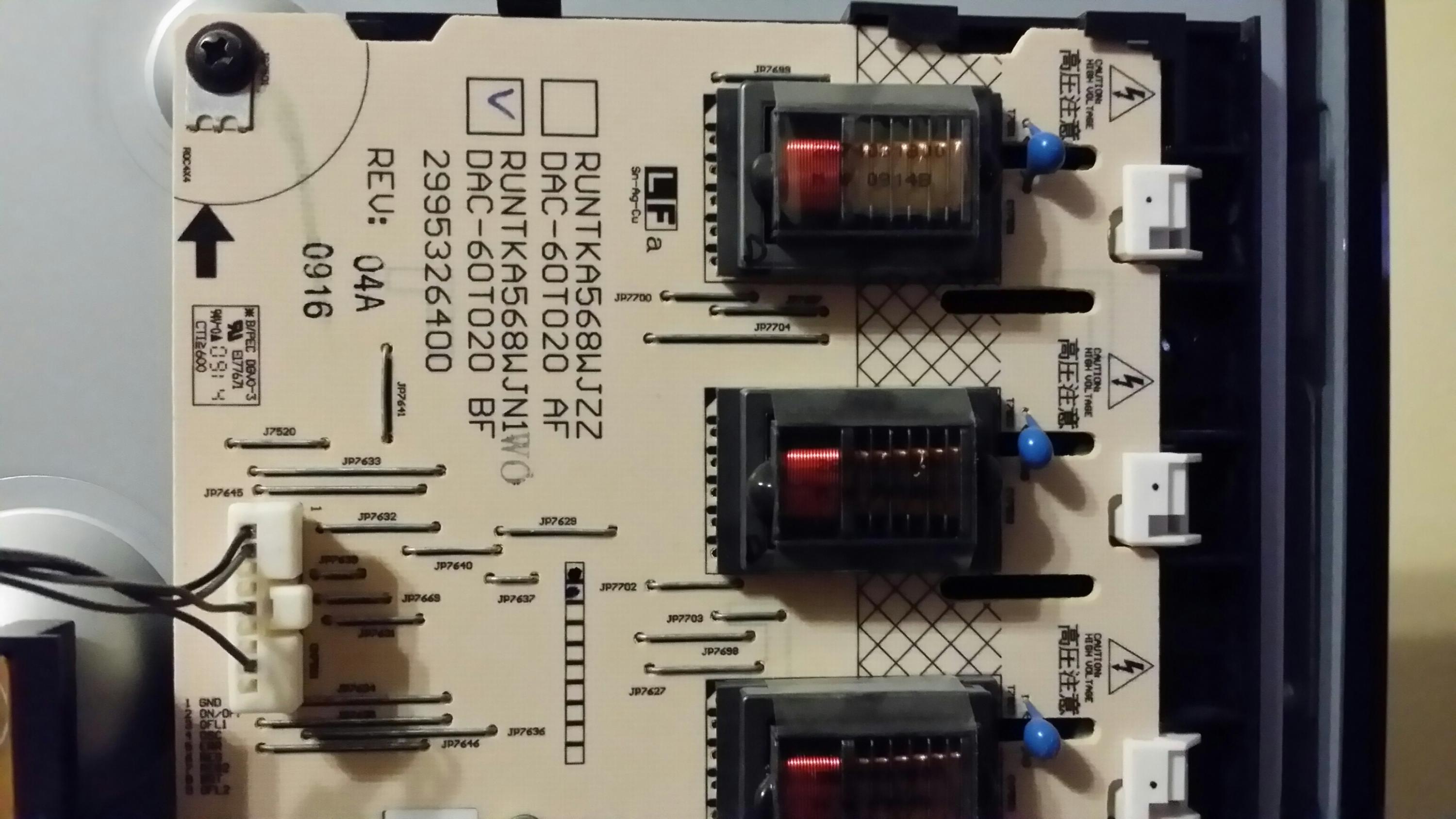

    Re: Sharp LCC4067UN Red Blinking Led
    I am attaching a picture of the back of the power board as well.

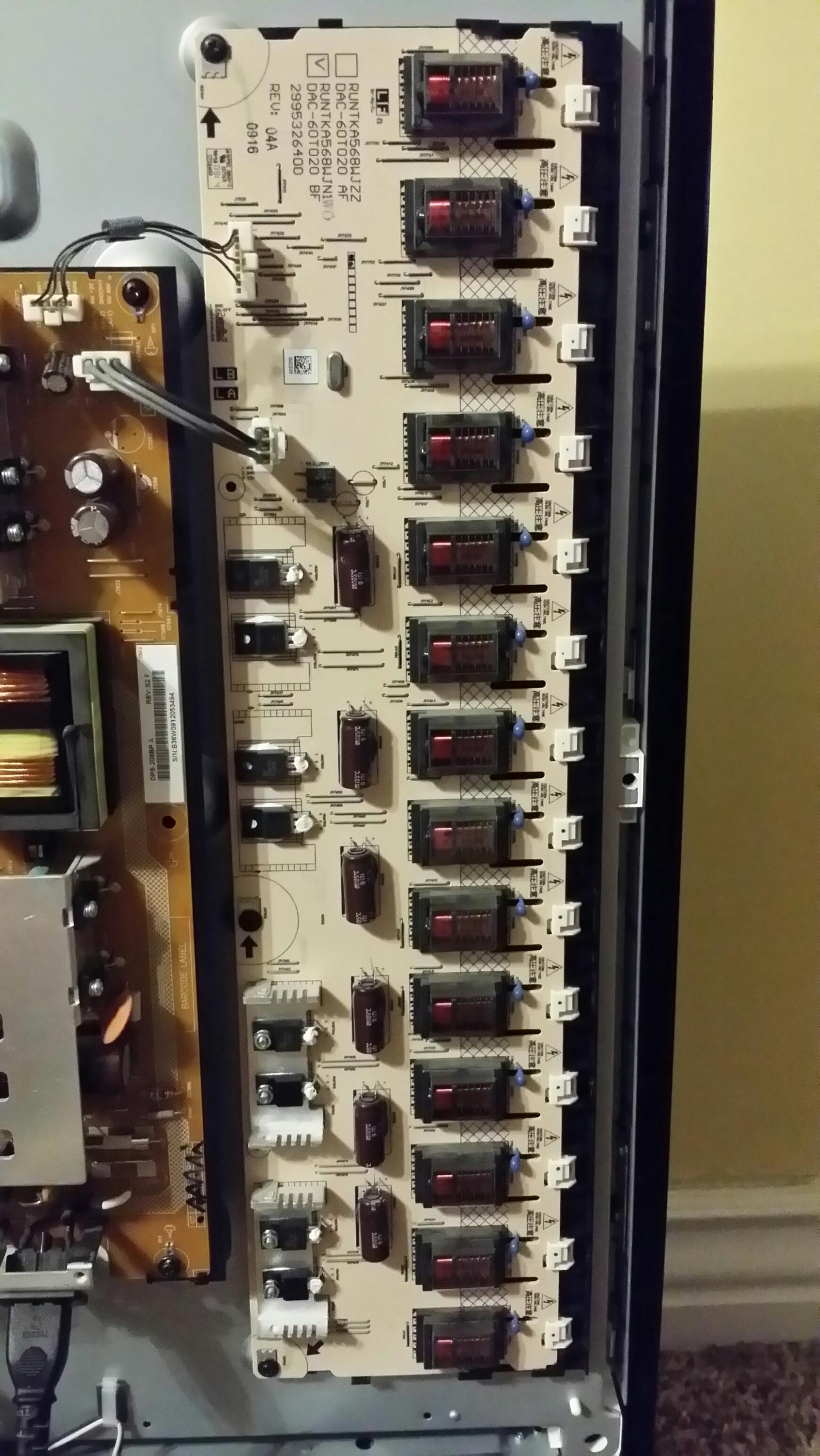

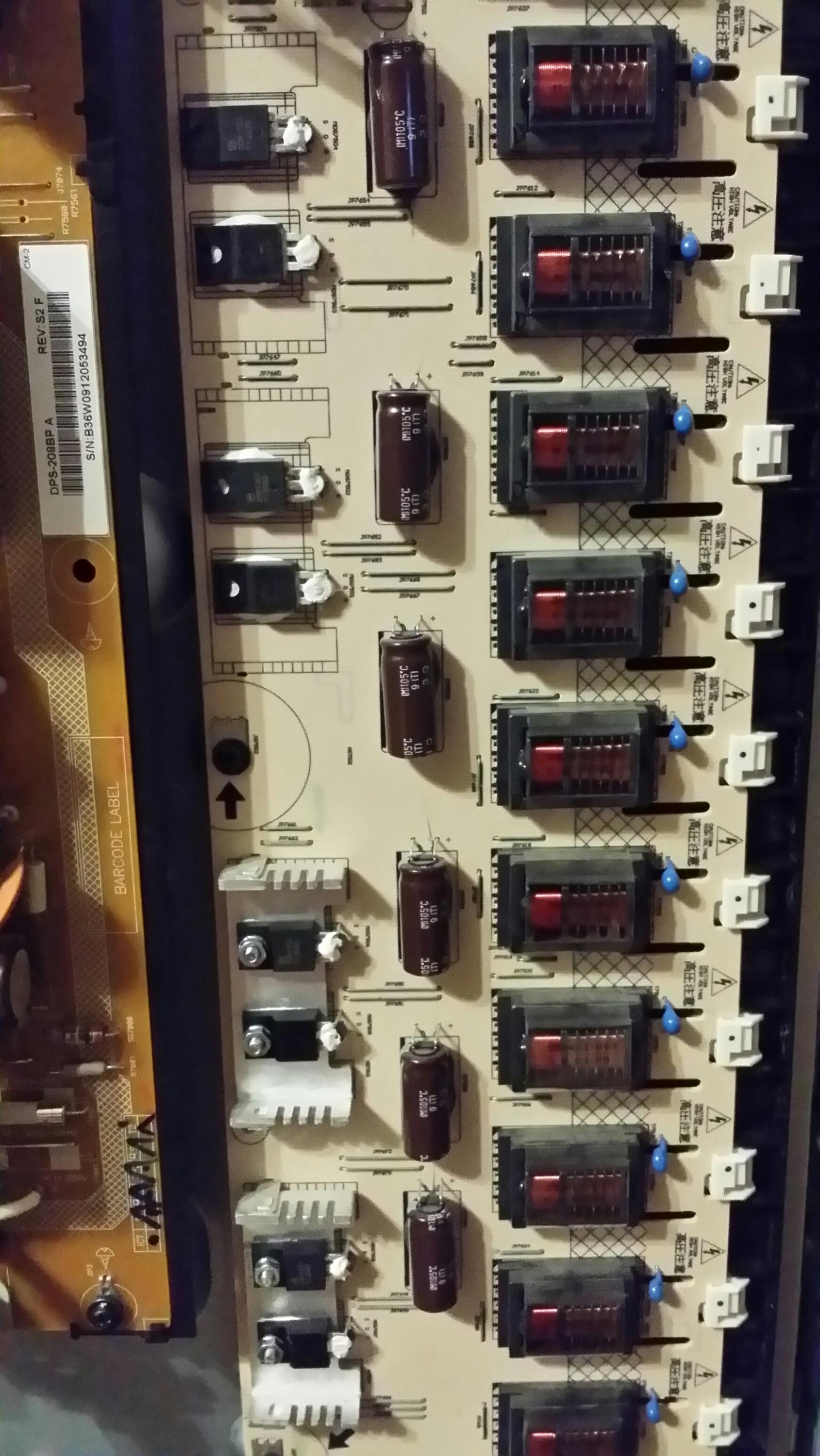

            Here are the pictures of the inverter. I think it is strange that half of the Fet's are heatsinked and half are not.

                  I tried to do a firmware update but the TV shuts down before it can do the update. I have noticed that when the tv does turn on the backlight for the few seconds that there appears to be several of the lamps that are not turning on. so I don't know if I should purchase an inverter board or if there is a way to test to see if it is the lamps that are bad.
                    Measure each transformer on the inverter board with your meter in the Ohms setting. They all should be within 3% or so. Also you could disassemble the LCD, then you can check the CCFLs visually for any burn spots.
                      so I have tested each transformer and they all test very close to each other. I am nervous to tear it down to the lamps. How long are CCFLs suppose to last?
                                Ok last update.. I tested many places on the inverter board. I was getting the correct voltage but when the back light would come on I could see several lamps not turning on. I looked and found an inverter board for a great deal and thought I would try a new board just to see. I got the new board today and installed it. It fixed the tv. I have watched it for several hours and all the lights look good. Thanks for your help.
