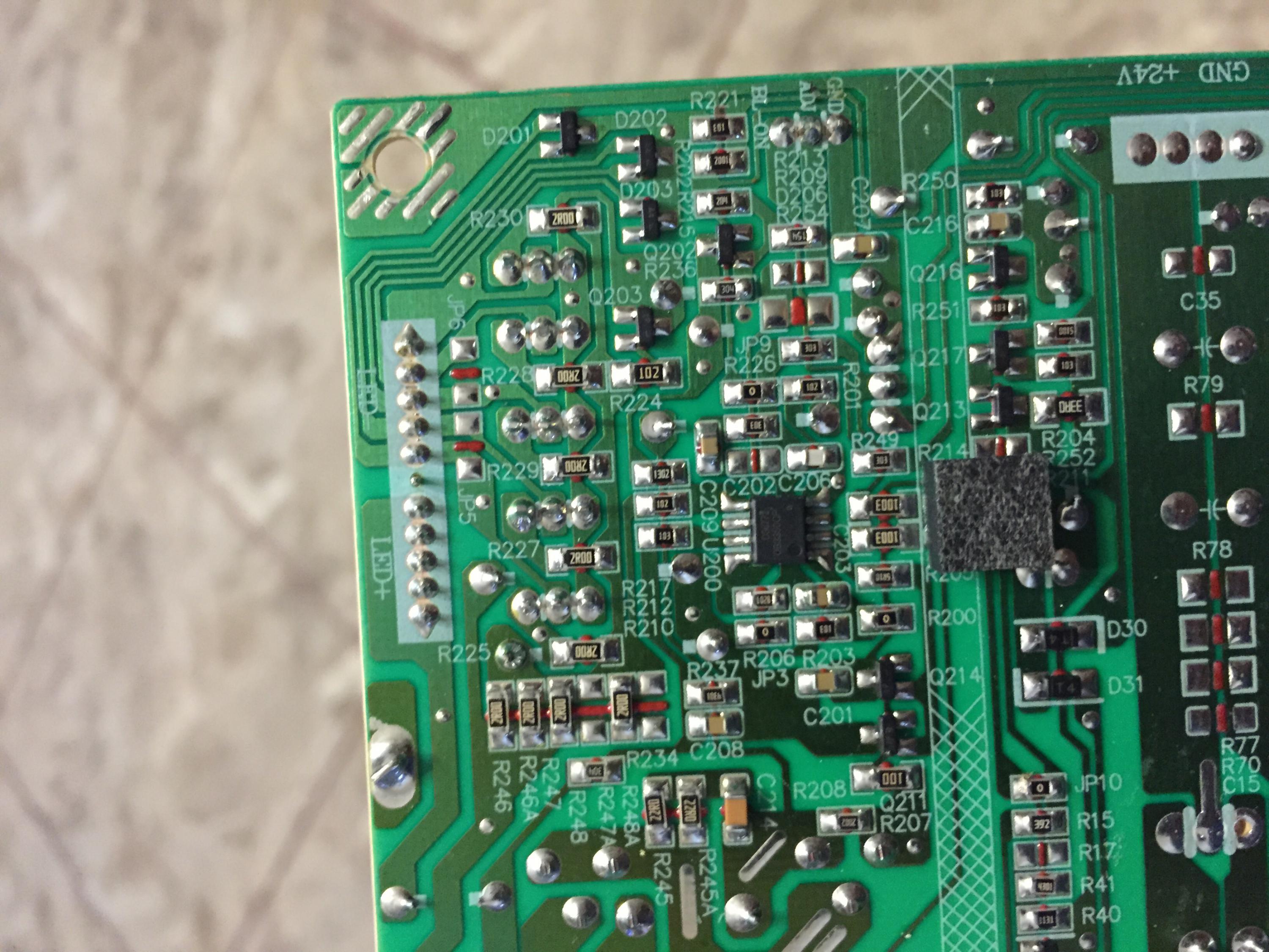

    I was wondering is there a way to turn on the backlight tv shows no power led light.Try to jump 5v std to on/off switch the tv did not turn.

    Need more information.... maybe you have a short that is holding down secondary supply voltage? Does the standby (power supply) voltage change if you unplug the main board?

      The standby is at 5v the power led is not on

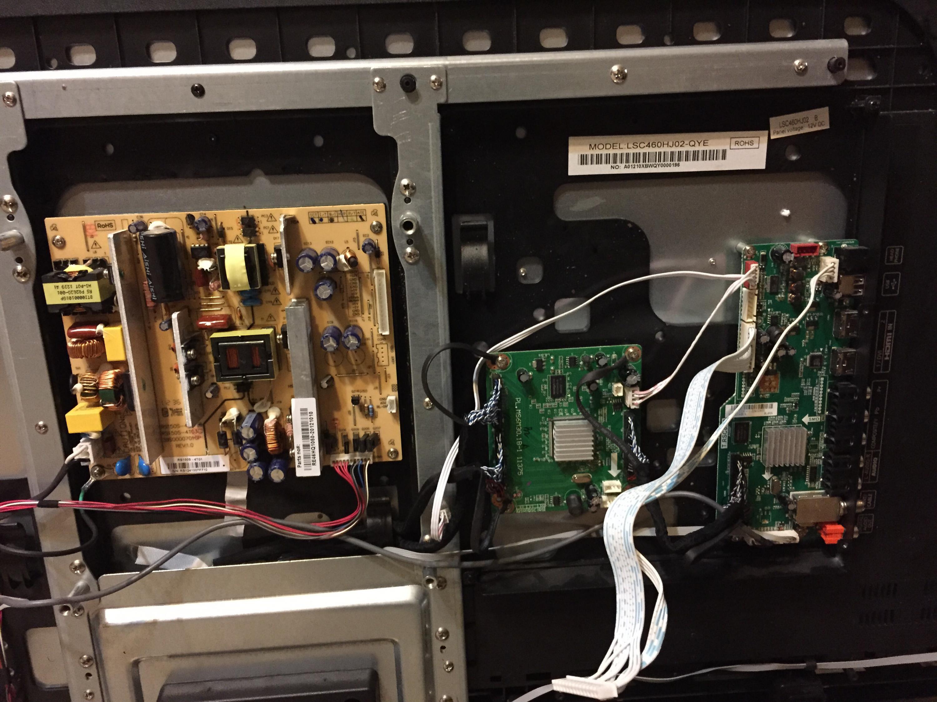

        Re: led46c45rq no backlight
        Can I see the whole board? There must be more than one connectors on that board.
        To turn on the backlights you must disconnect the cables between the power supply and the main board first, then use the resistor between the PS_ON and the BL_ON.
        Right now I cannot tell if that ON/OFF pin is the PS_ON pin or the Inverter ON/OFF (bl_on) pin.

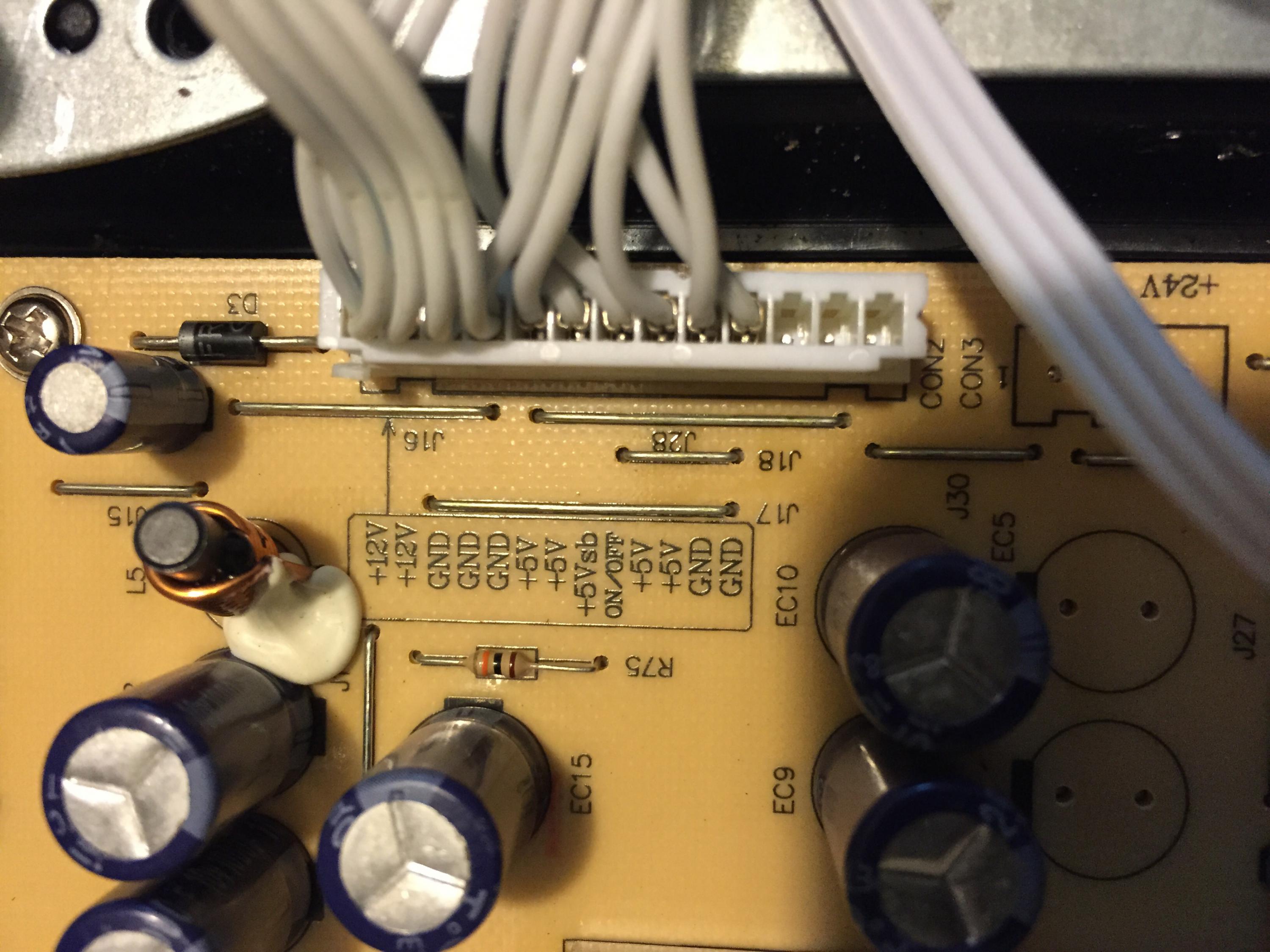

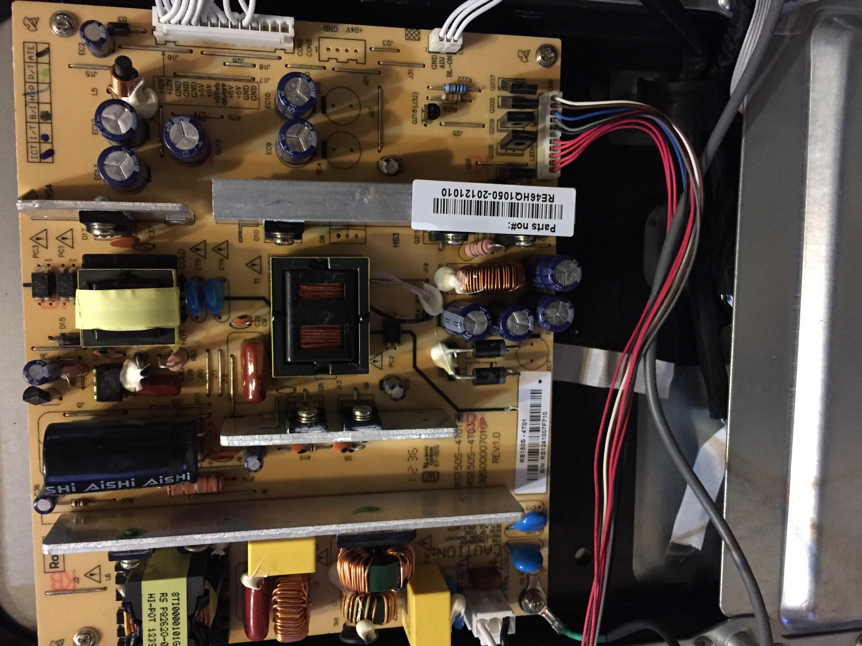

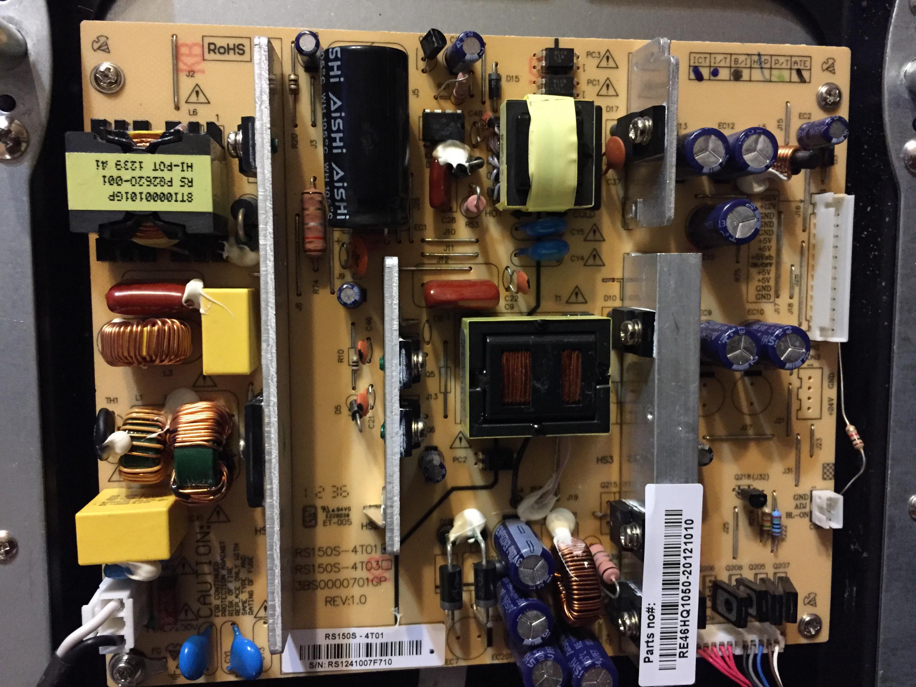

          Here is picture power supply
            OK, you will need 500~1K resistor between 5STBY and the ON/OFF (PS_ON), and another resistor (500~1K) between 5STBY and the BL_ON.
            Make sure to remove both connectors because we do want to back feed the force on Voltage back to the main board.
            When the power is apply you do not have to hit the power switch because we are forcing the power supply on manually.

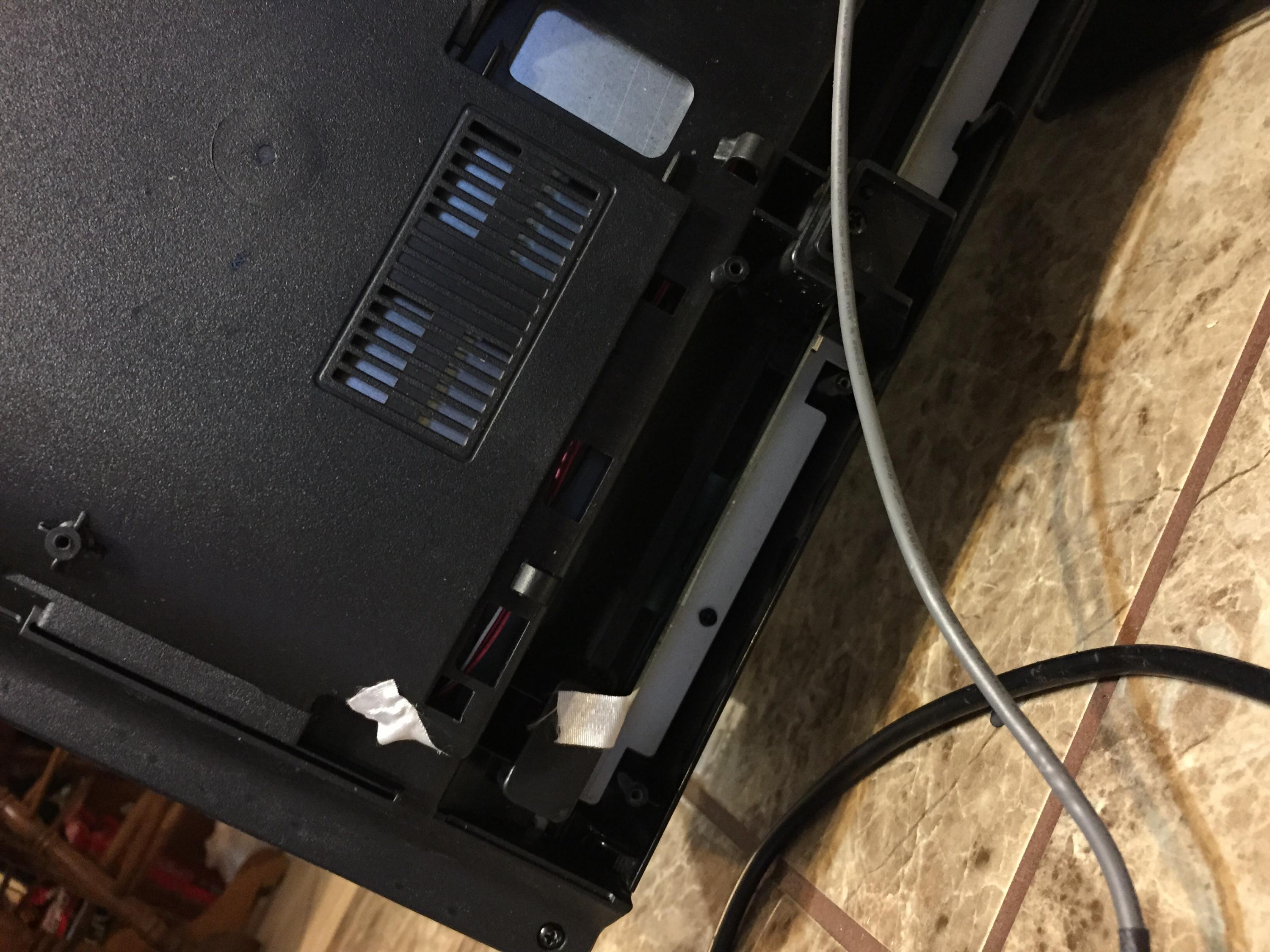

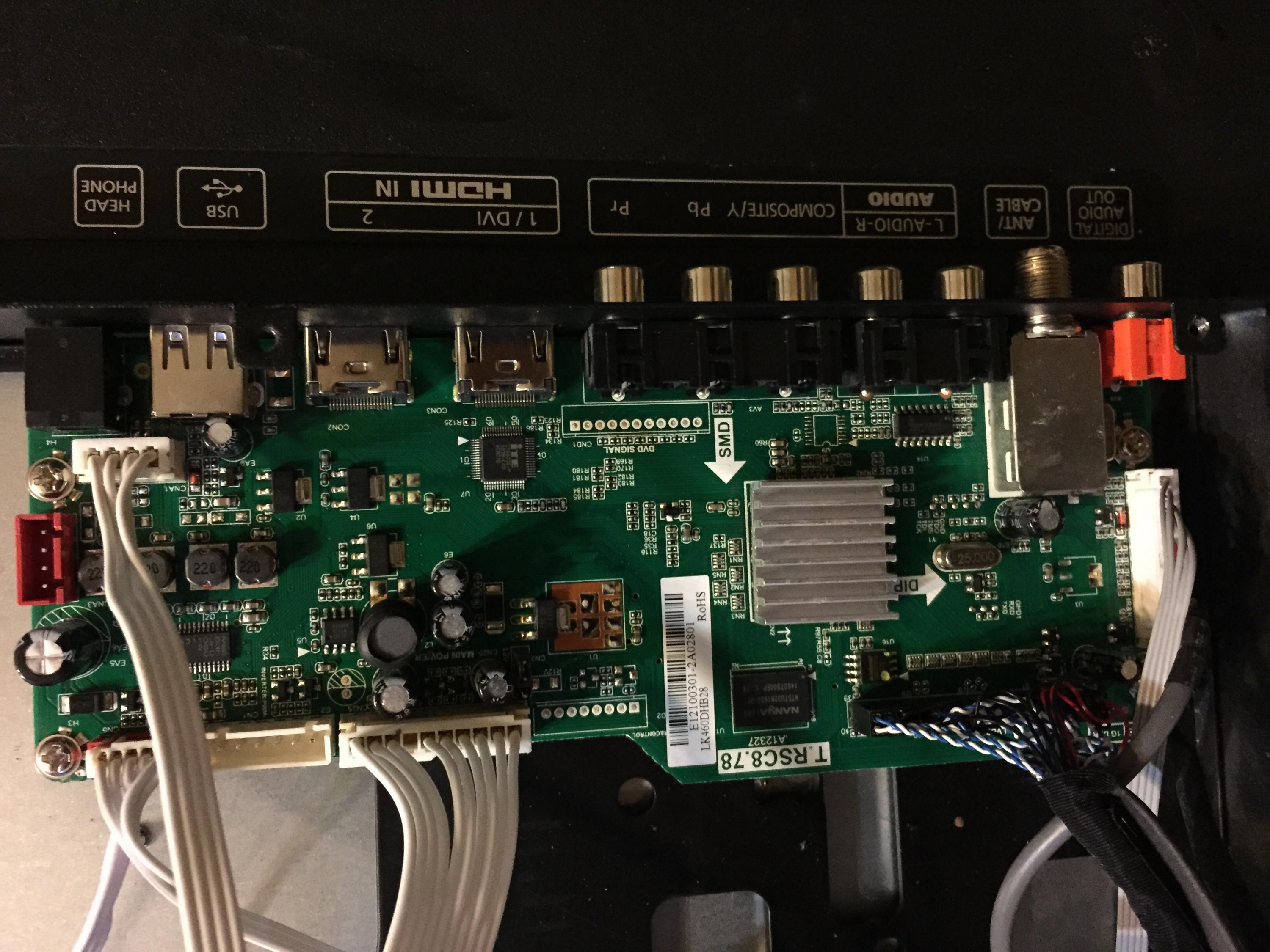

            Can we also see the whole back side of the TV?
            • ricosavy
              • Jul 2012
              • 457
              • united states

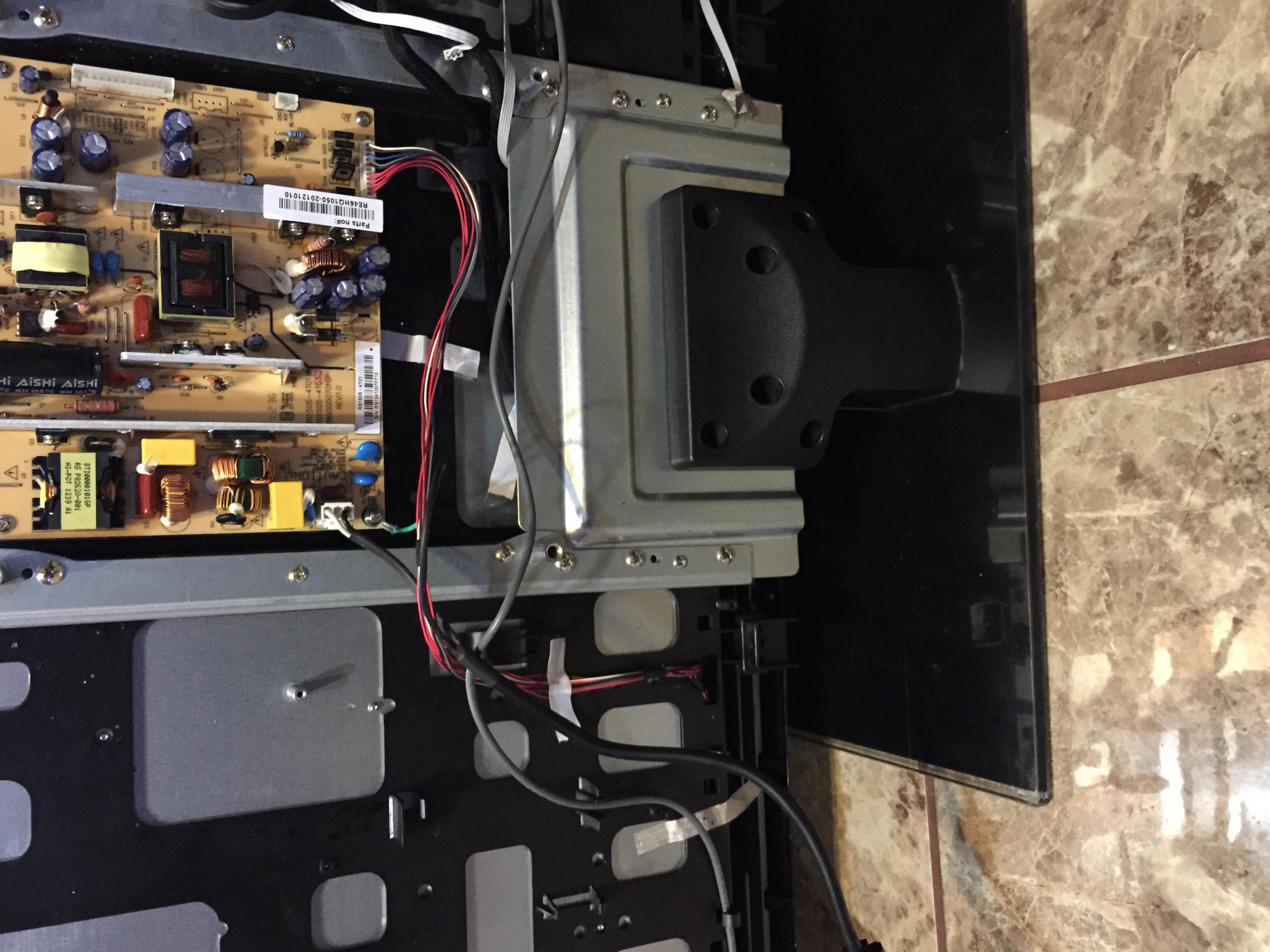

              Here some more pic
              • ricosavy
                • Jul 2012
                • 457
                • united states
                Here pic of the back
                  What is on the left side of the TV in post 8?
                  The connector with red, black, and grey, where does it go to?
                  • ricosavy
                    • Jul 2012
                    • 457
                    • united states
                    Those wires go inside the panel to the led lights and the only other thing on left is the power on button control for volume and channel.
                      That is lots of wires, I wonder if there is LED driver board inside the panel.
