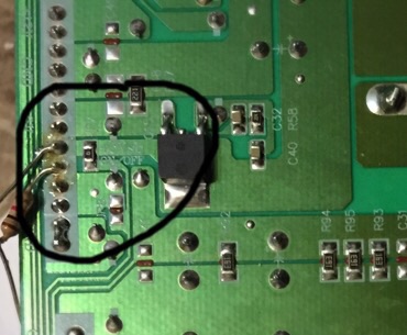

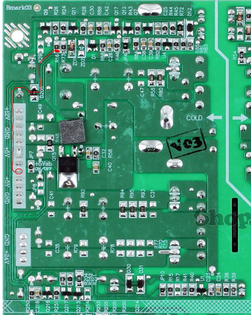

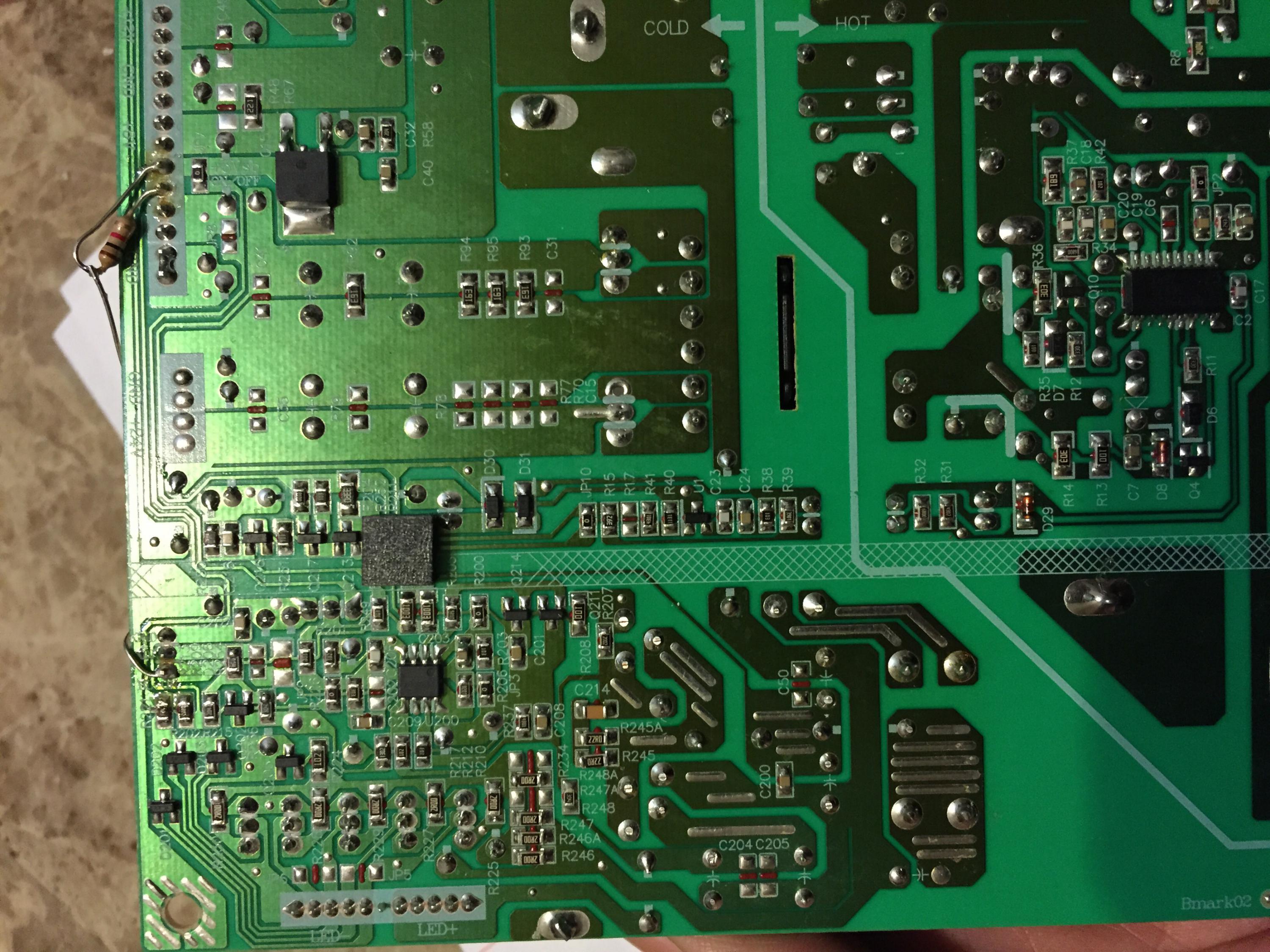

Re: led46c45rq no backlight
The PFC Voltage booster is not working, it should be >360VDC on that main filter cap when ON/OFF pin is forced on by the resistor.
So more in depth troubleshooting will be required in the PFC circuit.
We will need good clear straight shot pictures of the bottom side of the board to locate the PFC Controller IC, and then get the spec. sheet to get the pin out for the VCC pin.
