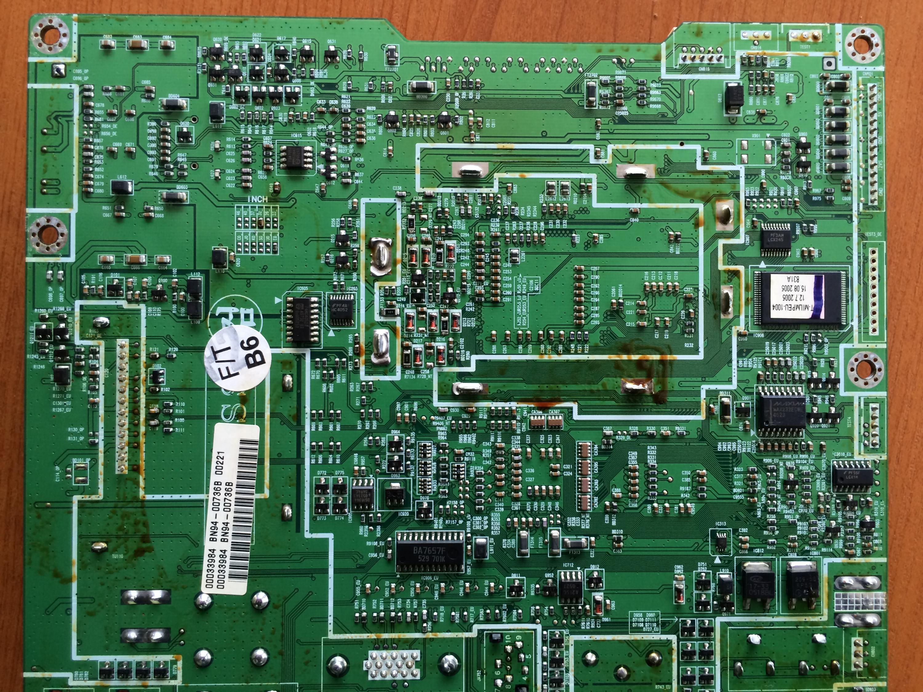

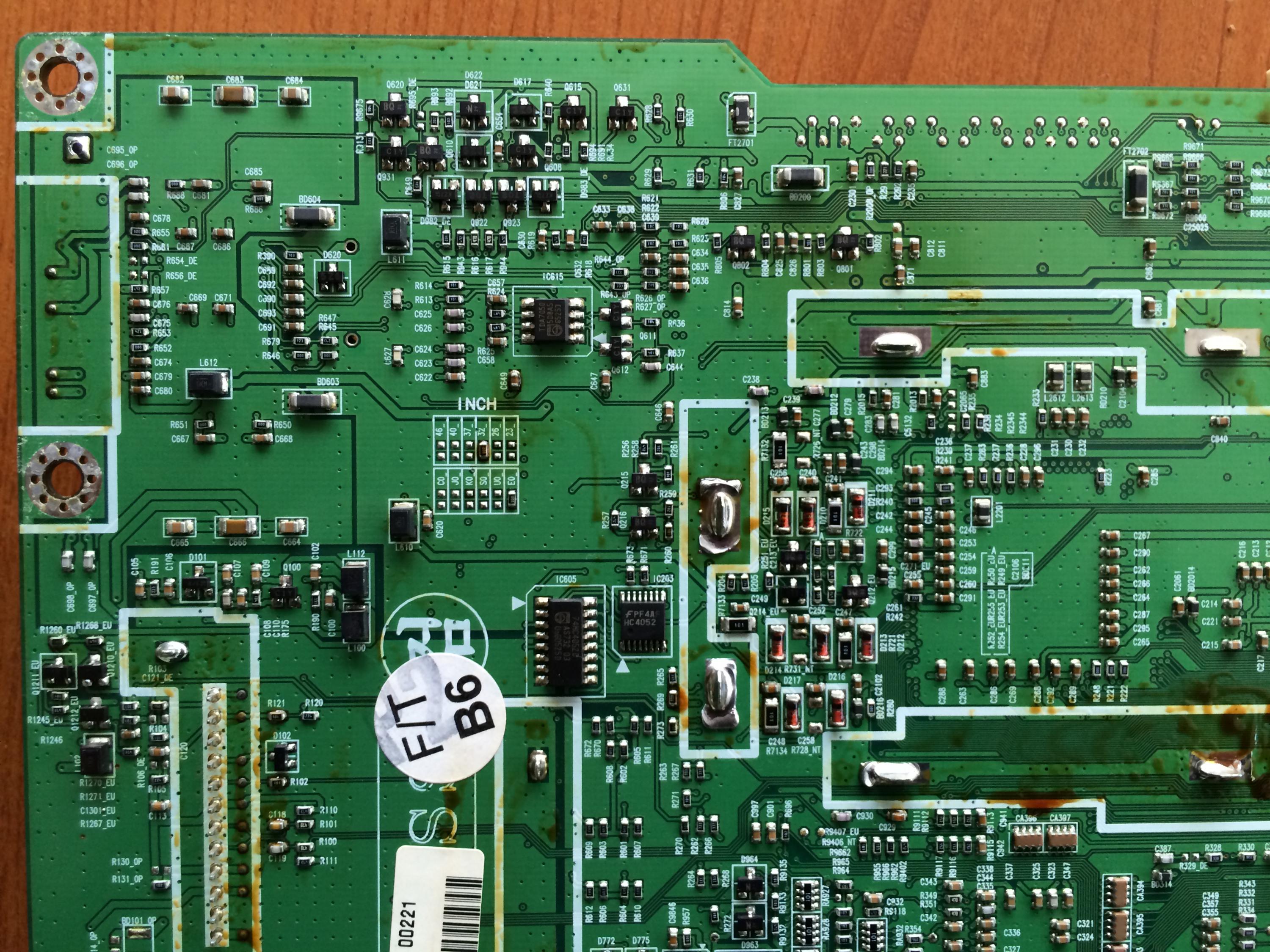

                We will need really really good clear pictures around the LVDS connector on the main board to see if we can locate the MOSFET.

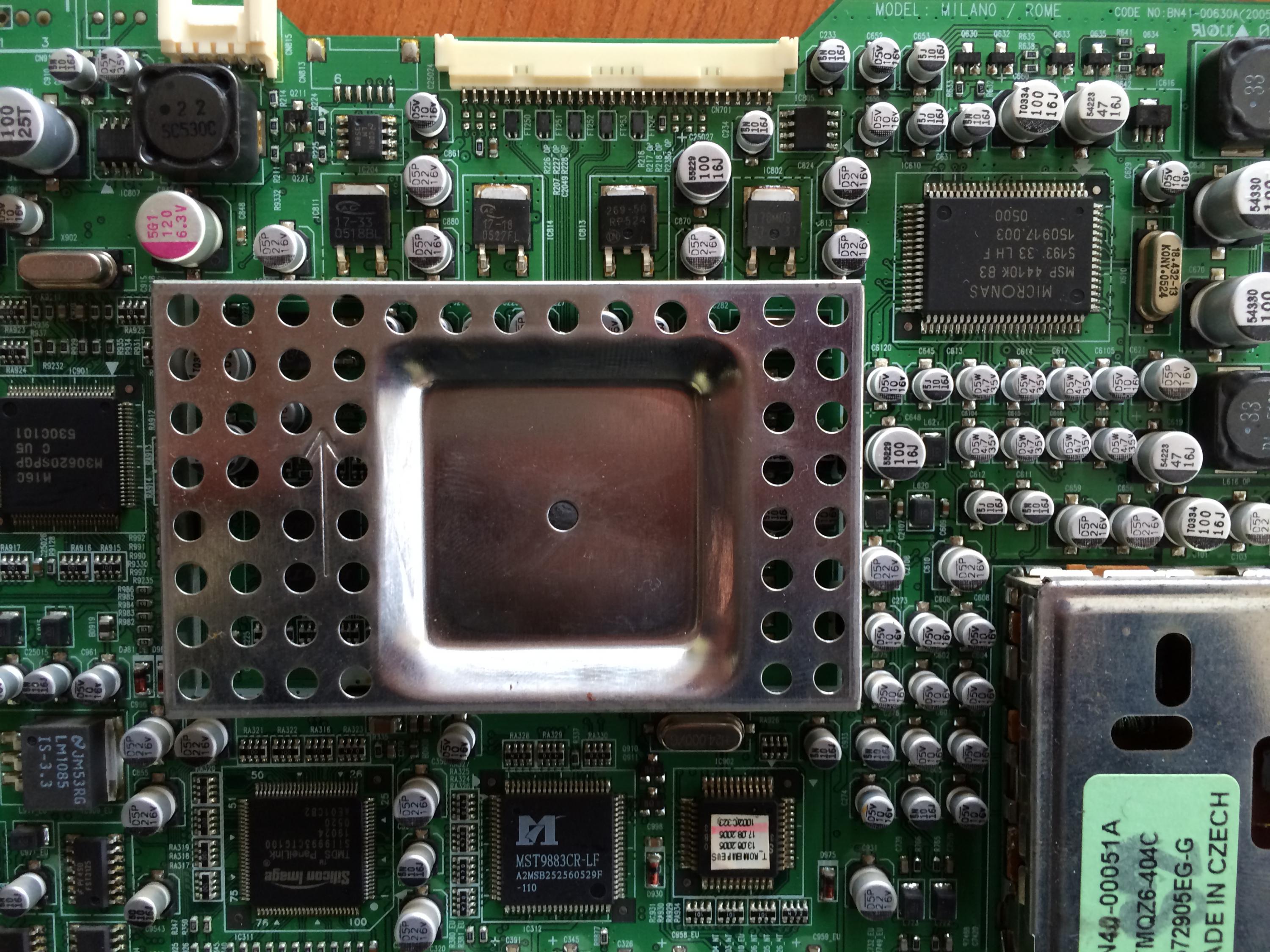

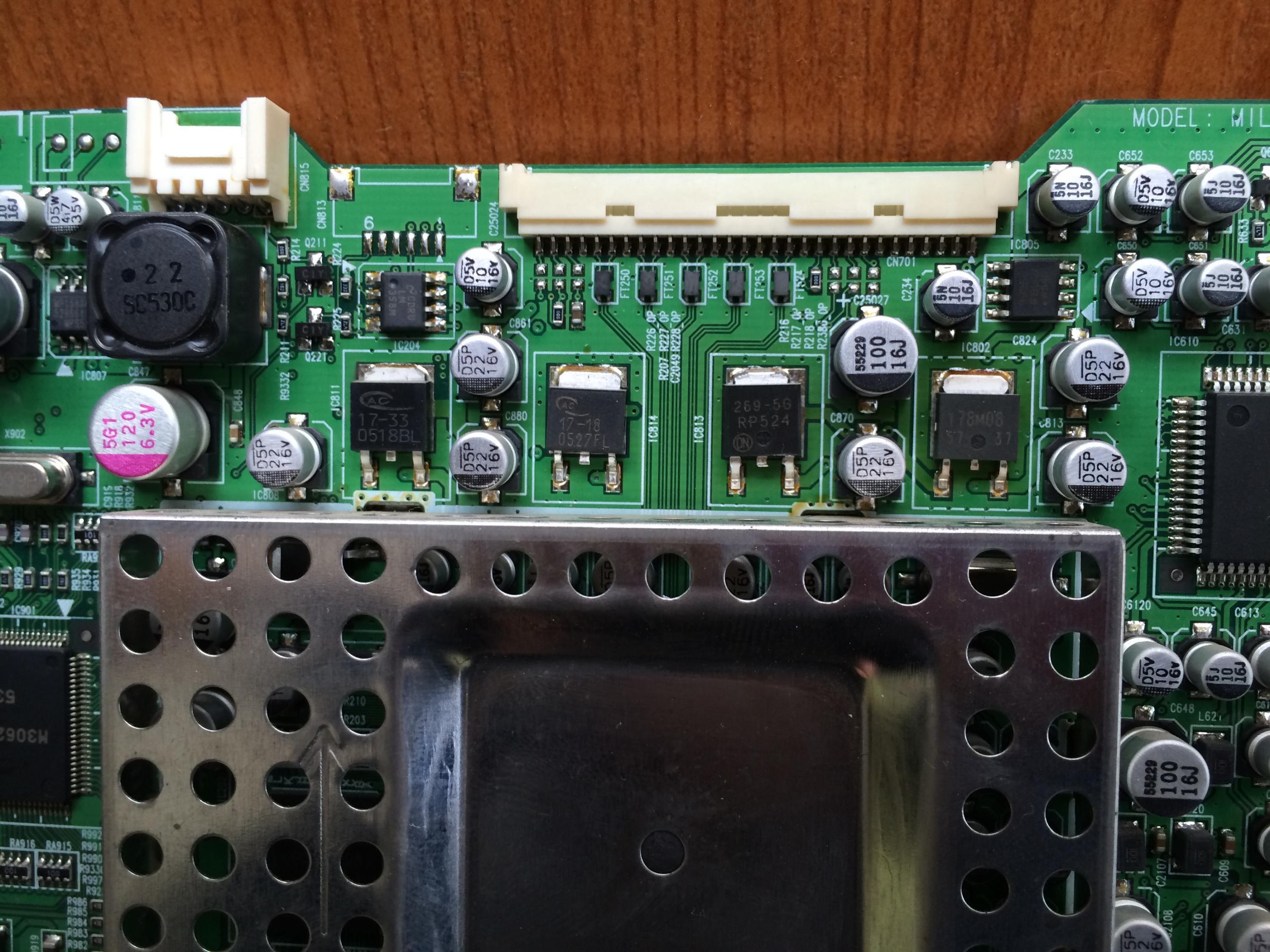

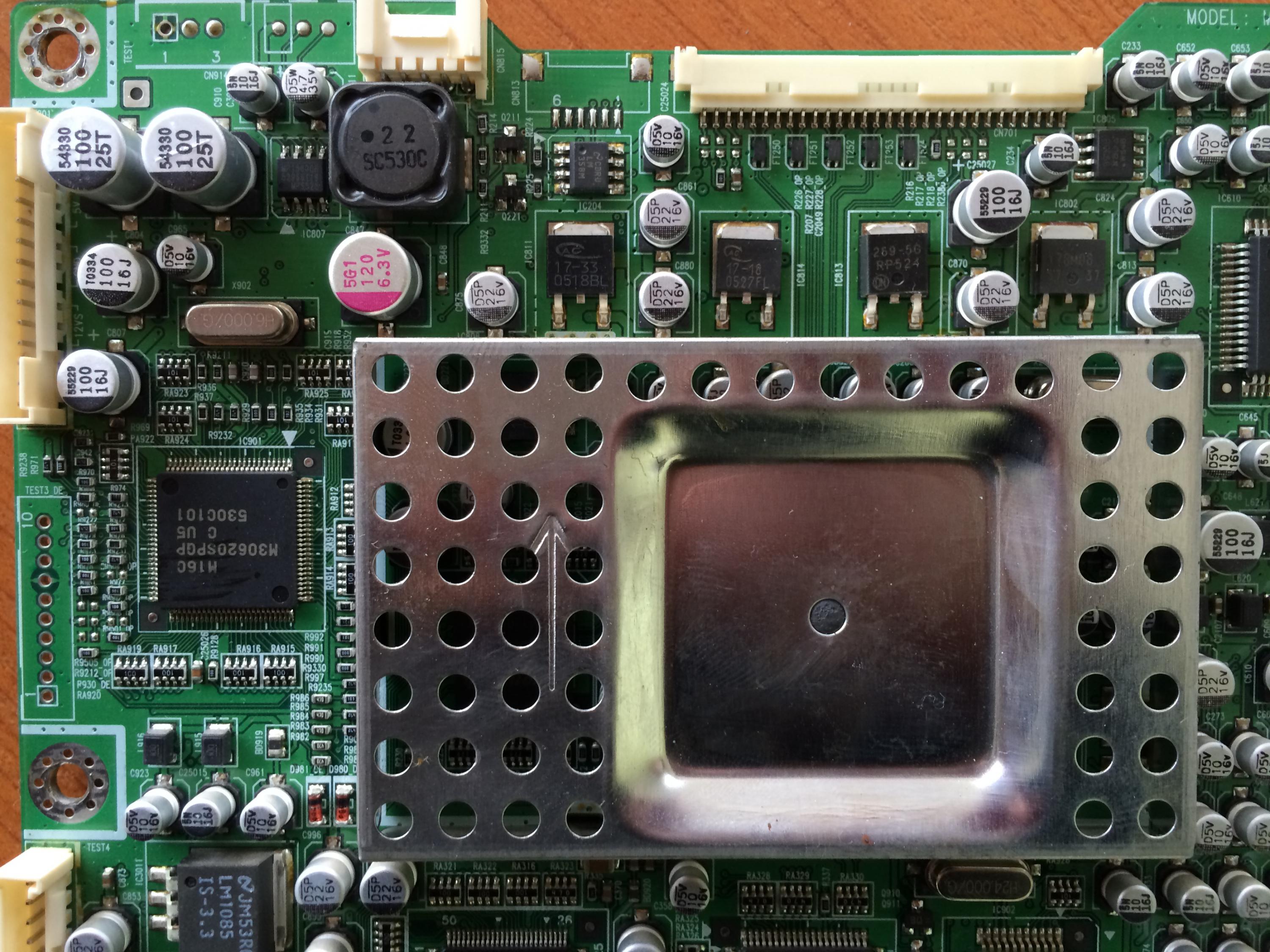

                  Re: Samsung LE32M51B S black screen

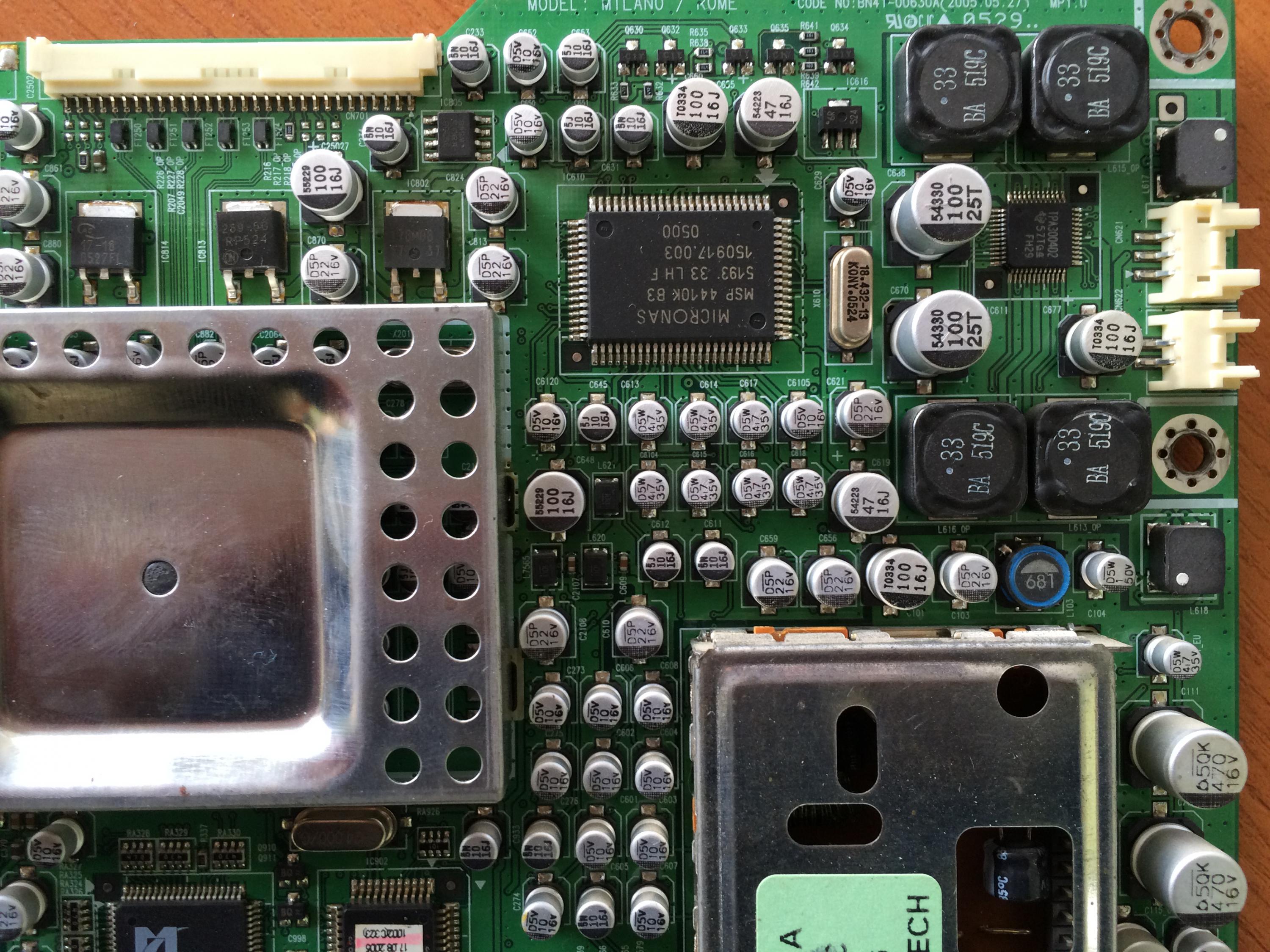

                  OK. Here are some good photos of the mainboard near LVDS connector front and back:
                    #29
                    What is the P/N of that IC 805 to the right of the LVDS connector?

                          #32
                          Originally posted by budm
                          what is the p/n of that ic 805 to the right of the lvds connector?
                          ic 805 - 9933b w548
                            #33
                            MOSFET FDS9933.
                            Put the LVDS cable back in place then check the resistance between either end of the SMD fuse on the T-CON against pin 1 through pin 8 to see if any one of those pins have direct connection to the fuse on the T-CON.

                              #34
                              MOSFET FDS9933.
                              I have direct connection between the fuse on t-con and the MOSFET on pins 7 and 8 on both sides of the fuse.

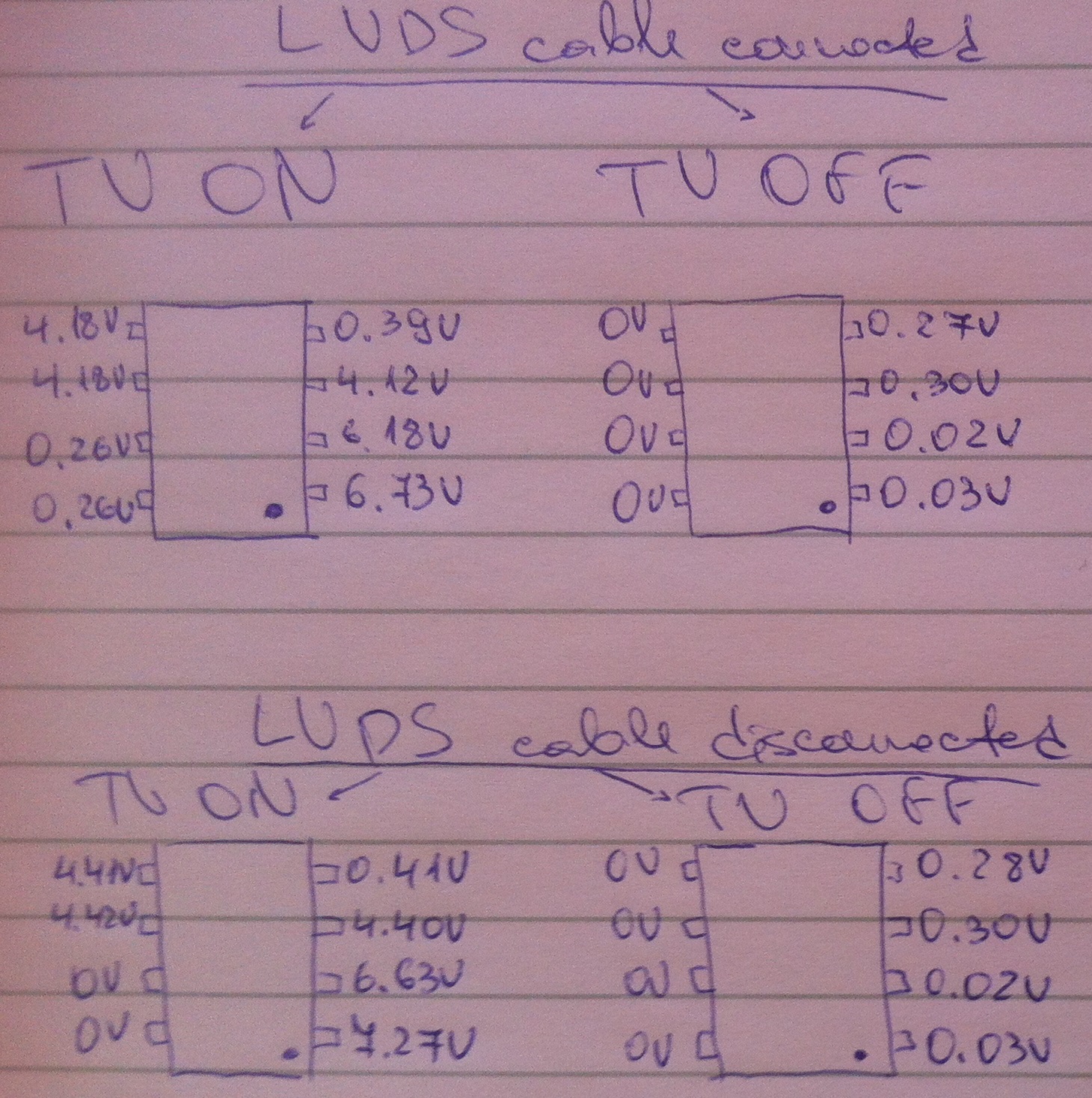

                                  Oh, and someting else I measured the voltage on pins 1 and 2 and it's around 6.35V if this matters. On pins 7 and 8 which are directly connected with the fuse on the t-con I have the same voltage 0.24V
                                    #37
                                    OK so that FDS9933 DUAL P-CH MOSFET, and it is the switched MOSFET for feeding the B+ to the T-CON.
                                    You also need to take the reading without the LVDS cabel connected to the T-CON to see what you have on pin 7/8 (Drain D2).
                                    I need Voltage reading of all 8 pins when TV is OFF and when TV is ON.
                                      Well finally I took the measurments as you adviced me to do and here are the results:
