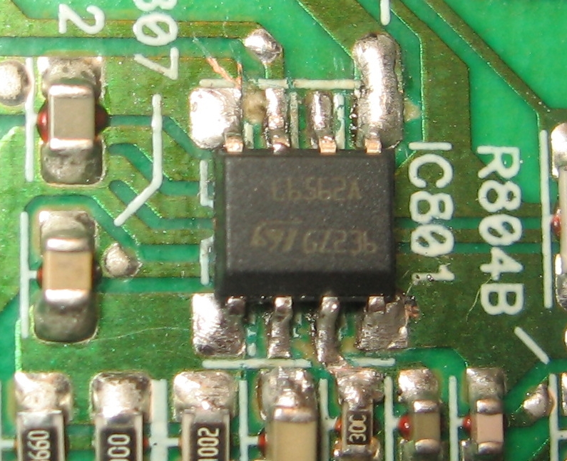

    I just replaced IC 801 with new one - not best soldering job, but other than its not as pretty as original one, Im think all connectors are soldered as they should. Any way, that didn't fix problem - still the same status lights and nothing else...
    Is there anything else i should check?

        Re: VX42L Vizio 42" TV - only amber / white light, no power
        Do you have TV with the same problem? I gave up on replacing components one by one and decided to find a power board for reasonable price on ebay. Found out there few power board models that can be used as substitute for this part and when saw one for $30 shipped plus $5 off coupon ebay gave me, I decided that $25 is fair price. Bought it and TV works fine now.
        One like this http://www.shopjimmy.com/vizio-westi...wer-supply.htm
        If you want check ebay too, you can use this search to see all available substitute parts http://www.ebay.com/dsc/i.html?_sop=...C+DPS-283BP%29
