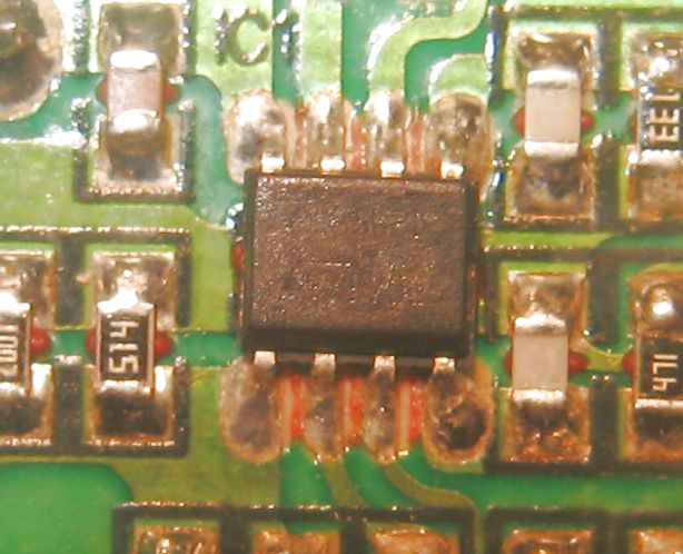

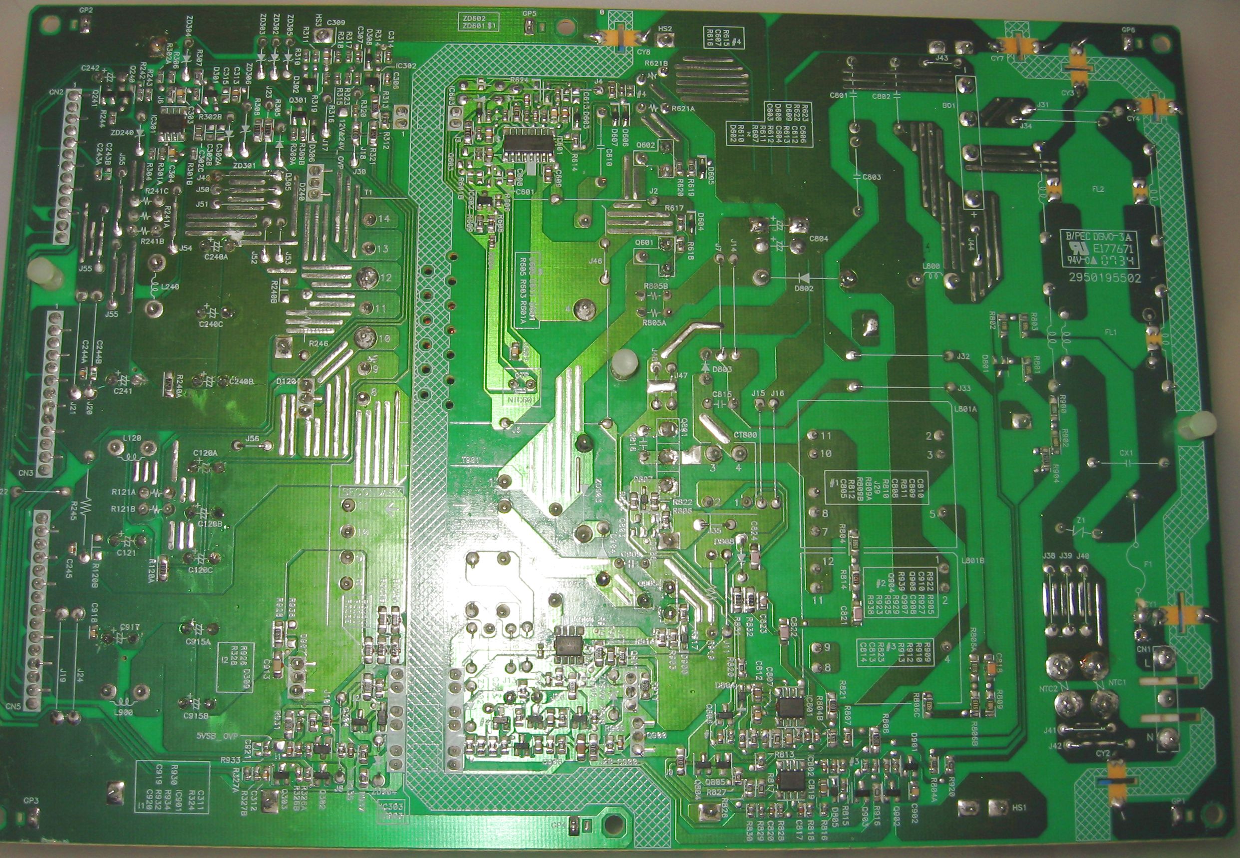

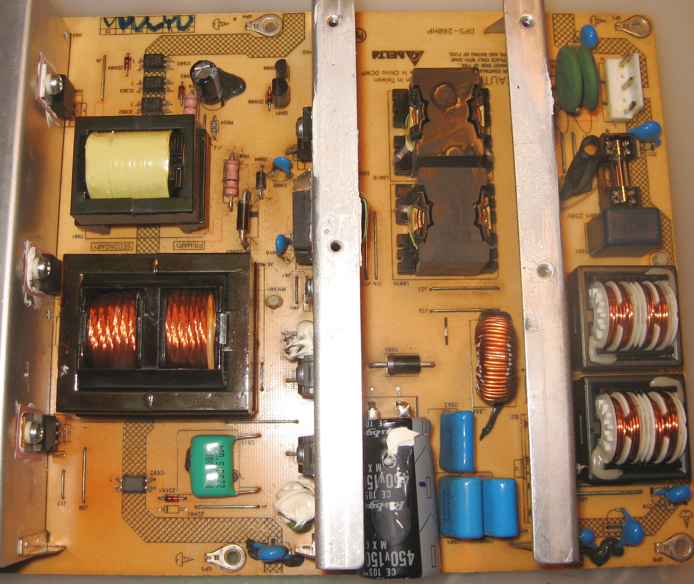

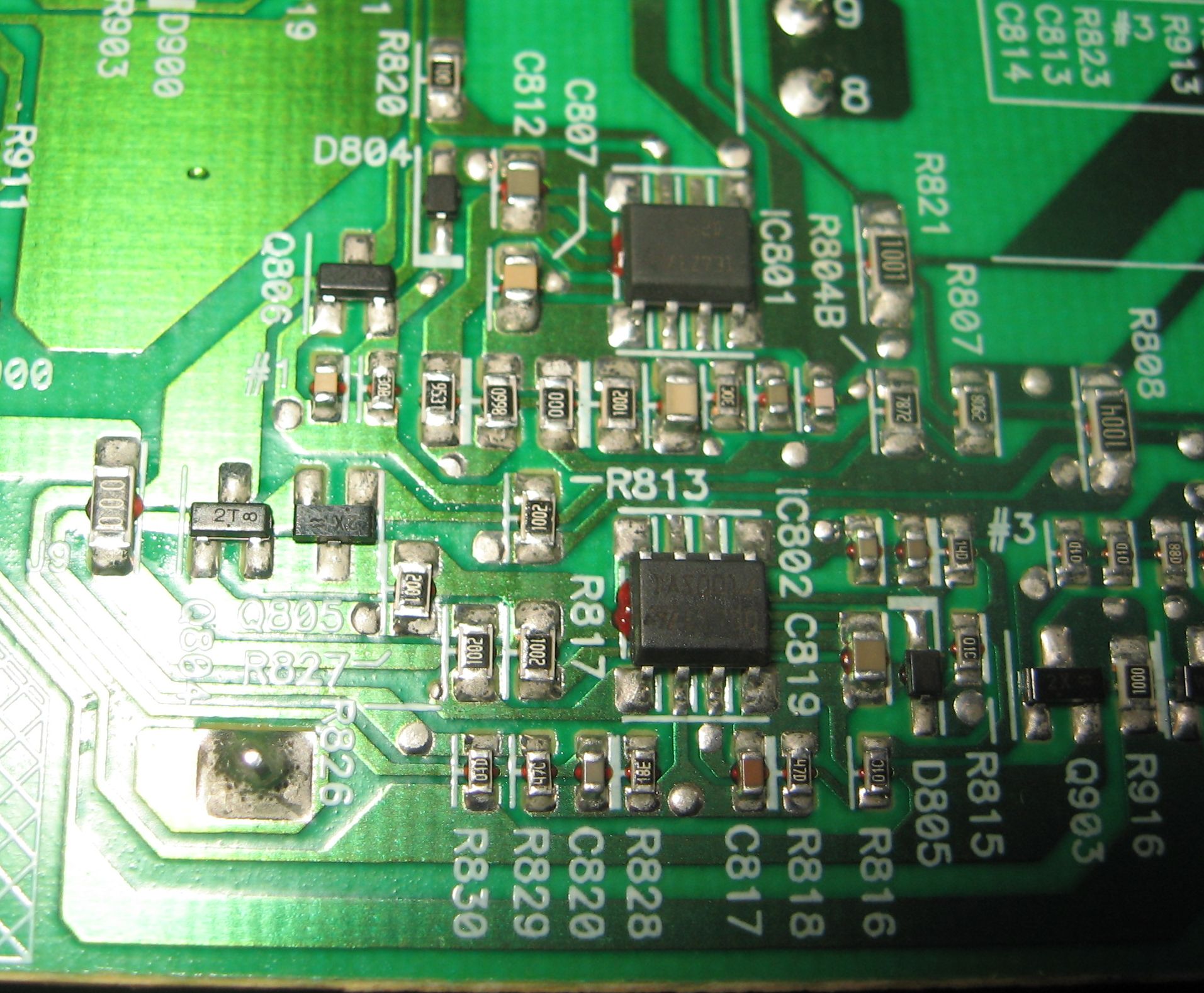

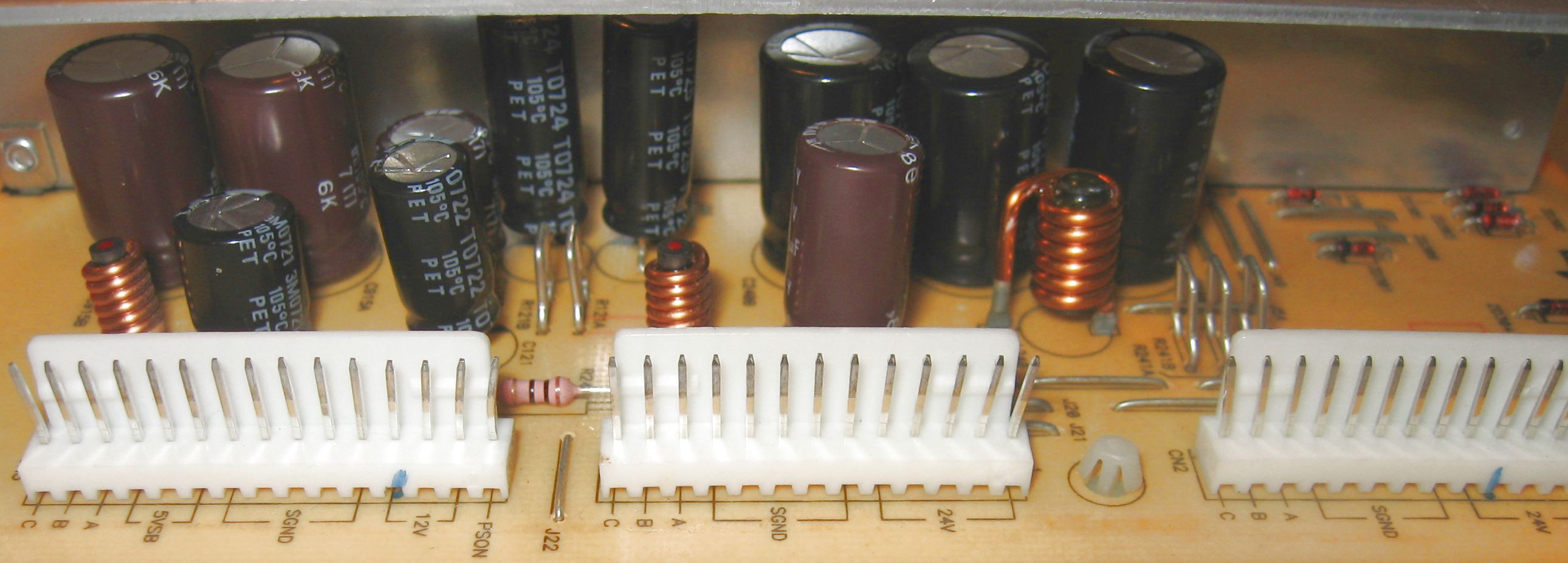

                Re: VX42L Vizio 42" TV - only amber / white light, no power
                Yes, Q801 - it's printed on another side, you can see leads on bottom of board (pic #3 in first post), it's middle part under round plastic pin
                  Q801 is for the PFC.
                  OK, it is either IC801, or 802, more likely to be IC801. You will need to get the P/N as printed om top to get the spec. sheet.
                  You also need to check the resistor and Diode connected to the Gate pin of that Q801.

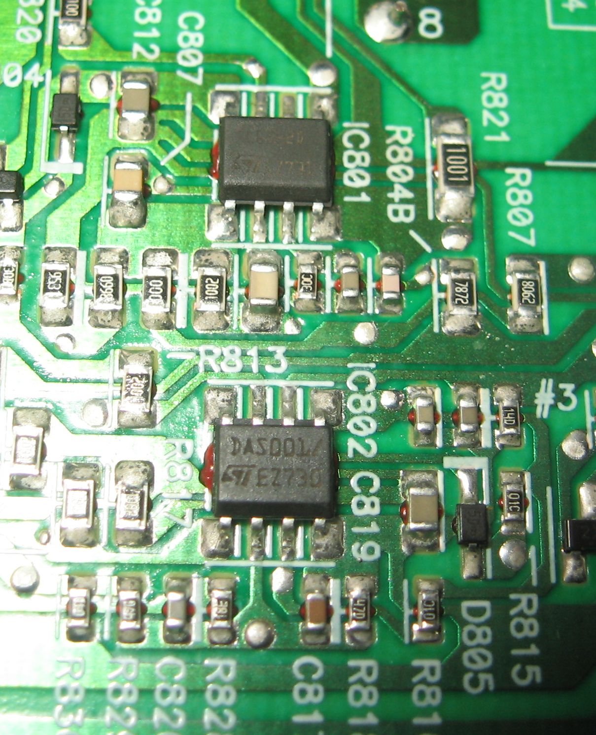

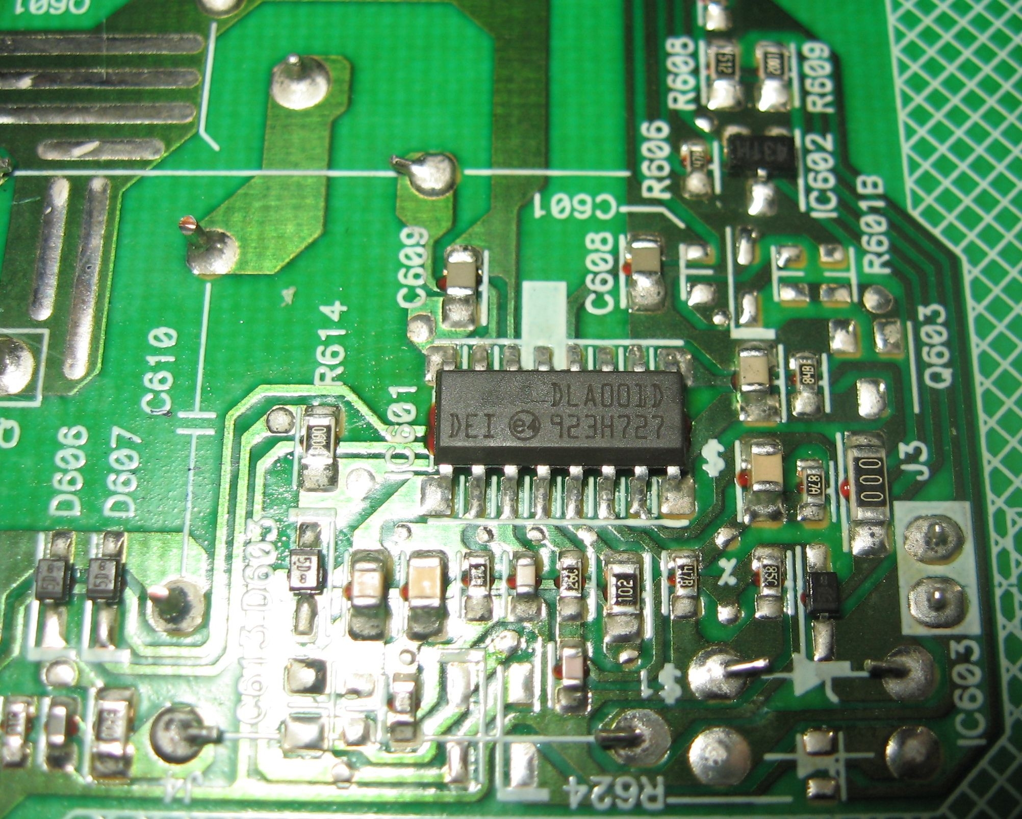

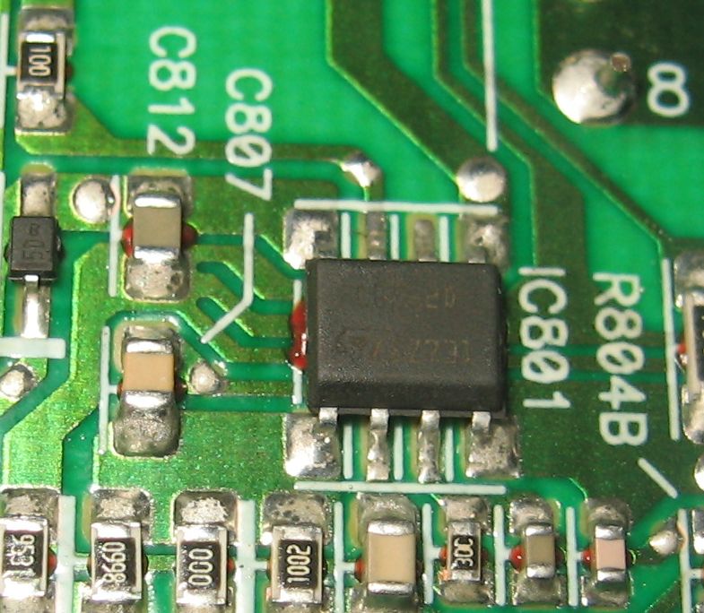

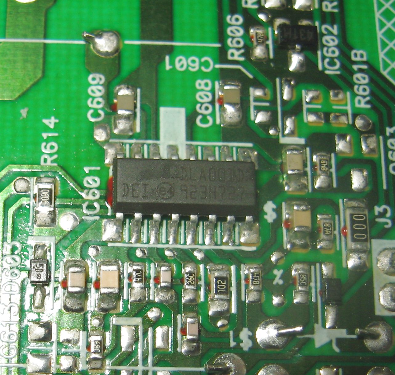

                    Here are pics, I see number on IC802 clearly, its DAS001, but print on IC801 is hardly readable, specially last digits
                    • sansonet
                      • Nov 2013
                      • 245
                      • US

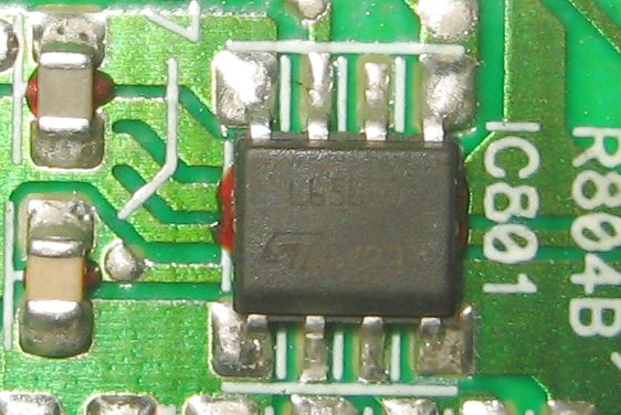

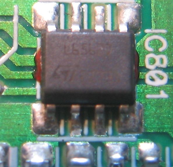

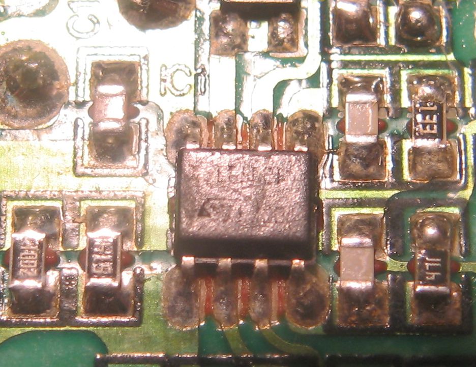

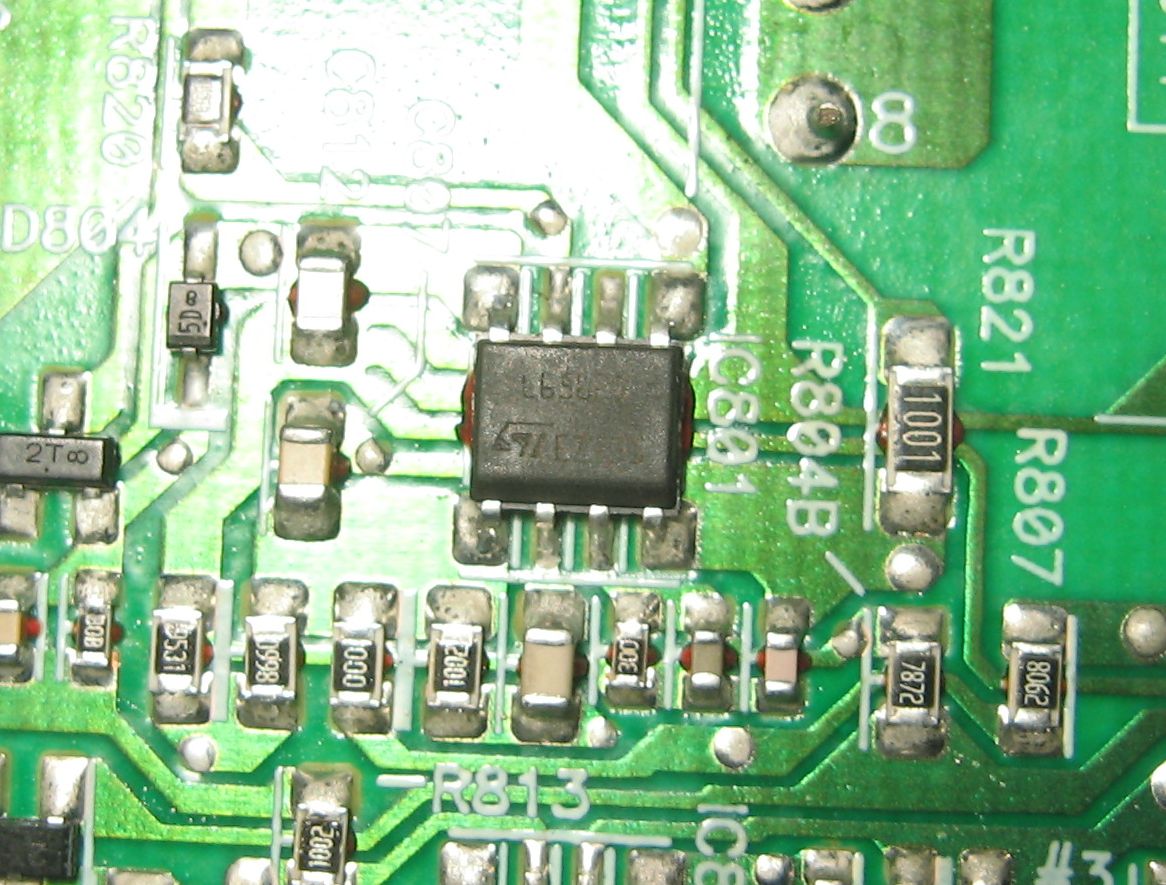

                      One more pic, I think it's L6562D http://www.mouser.com/ProductDetail/...BjkbrTAw%3D%3D
                        L6562, that is the one for PFC.
                        Check the resistance of GND pin against all other pins and report the readings, no power to the TV of course.

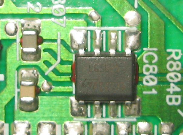

                          I'm not sure where is top and where bottom of this chip, but if I take part with IC801 print as top part, i'm getting no readings on all pins with GND, COMP pin had resistance initially but numbers was raising for few second and then disappeared.
                            https://www.badcaps.net/forum/attach...1&d=1422898205
                            pin 1 is the bottom left, you can see round dimple next to the 'ST'.
