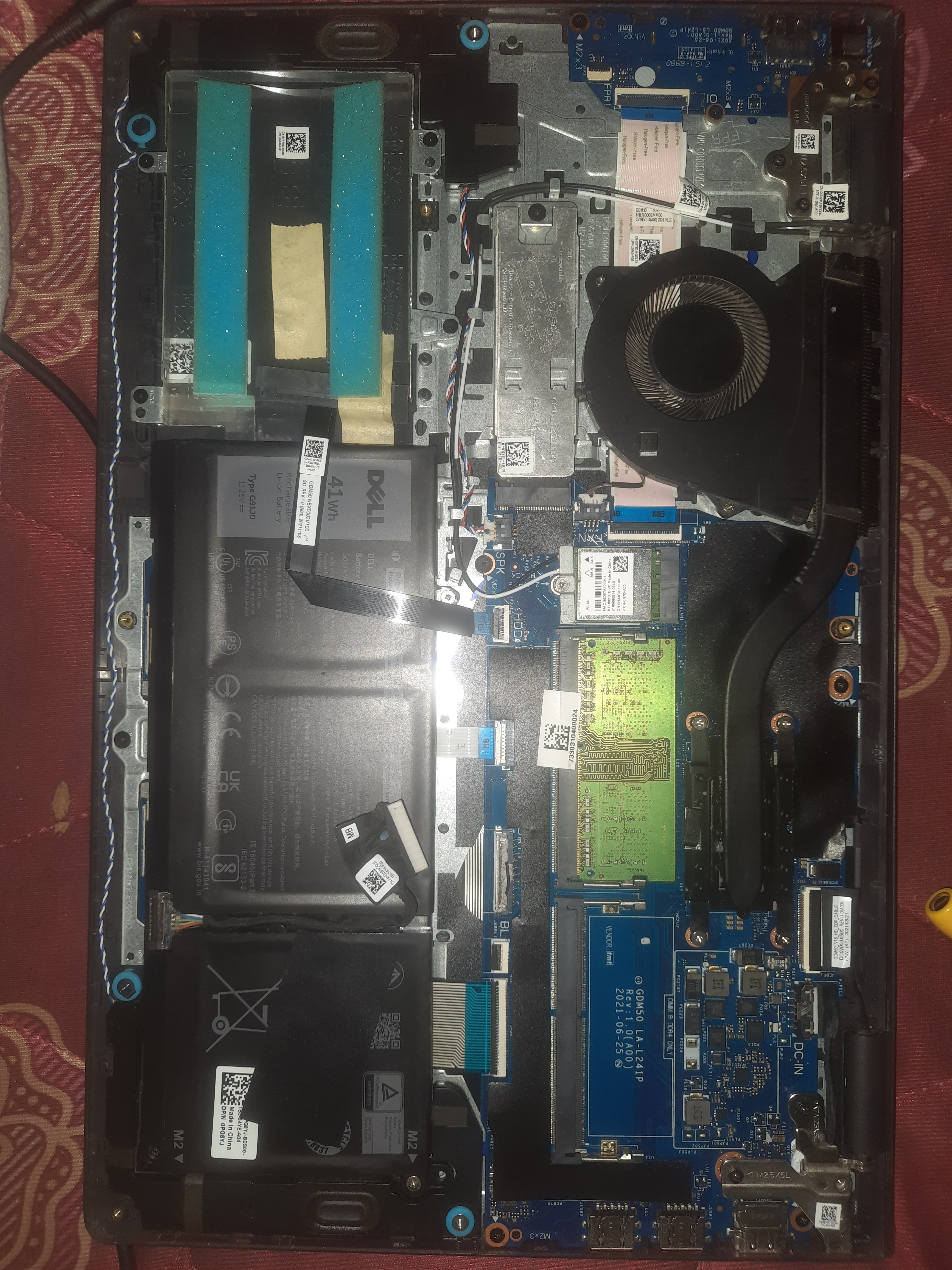

    Hello Everyone!
    I would like to know the Jumper location for the 2 Amber 7 White Led Blink Code error. According to Dell 2,7 Led codes are for display or the Display cable failure. I didn't changed the display nor the cable. The issue happens only when restarting the machine from windows and from the BIOS. And when opening and closing the lid the display turns off and never turns back on. But the machine is working! I confirmed it by pressing the CAPS Lock key. Does anybody has this issue and fixed it by jumpering some fet near the display connector on the motherboard. If So Please Help me. And other help is also much appreciated
    Note: I tried cleaning the display Cable connectors on both the display end and the motherboard end. Tried squeaking the cable nothing worked. Please help BTW My laptop Model is Dell Inspiron 15 3511
    Thank you!Click image for larger version

        Tried it Mr.Mon2

          Well I replaced the display. The Problem Solved 😕 😪
