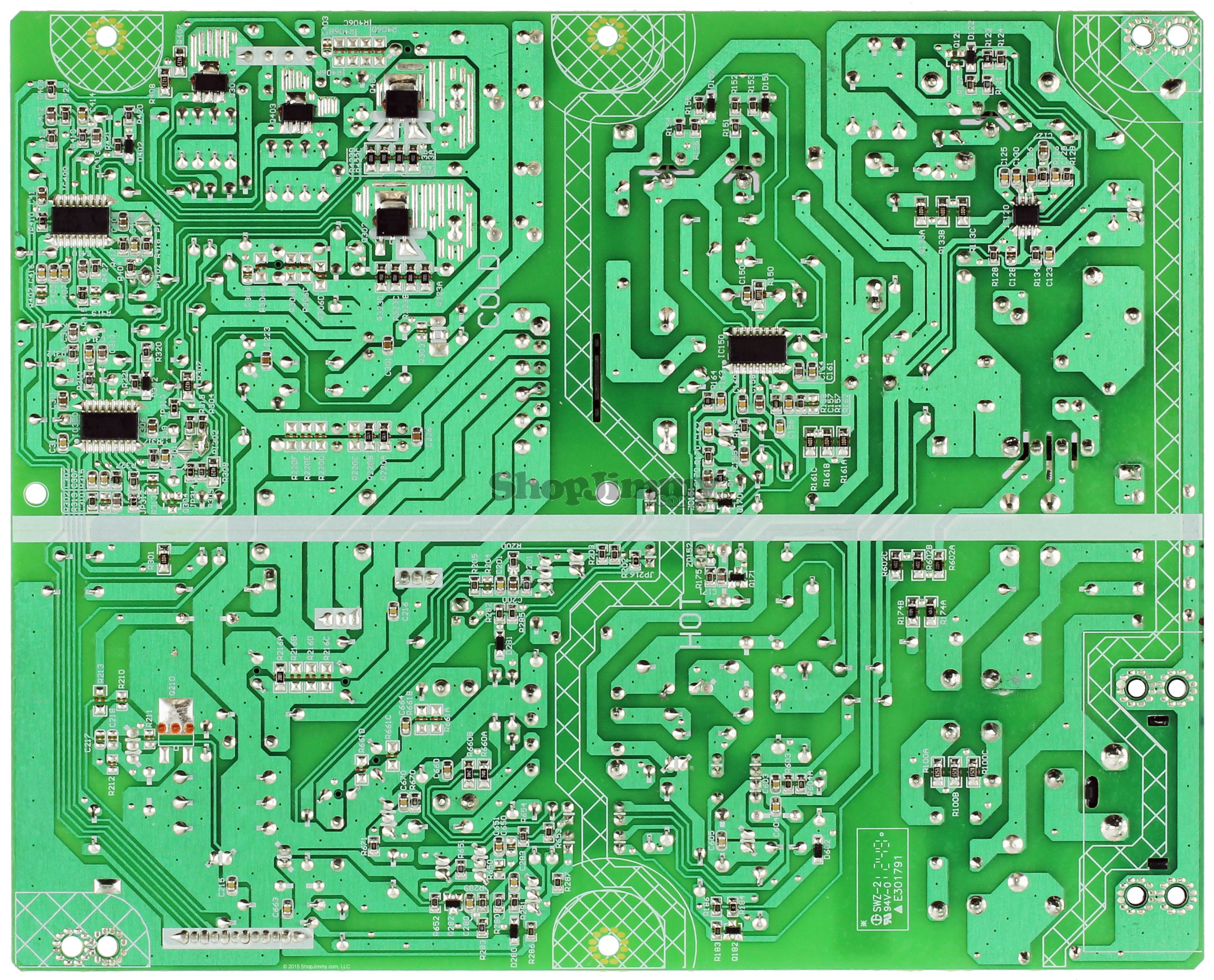

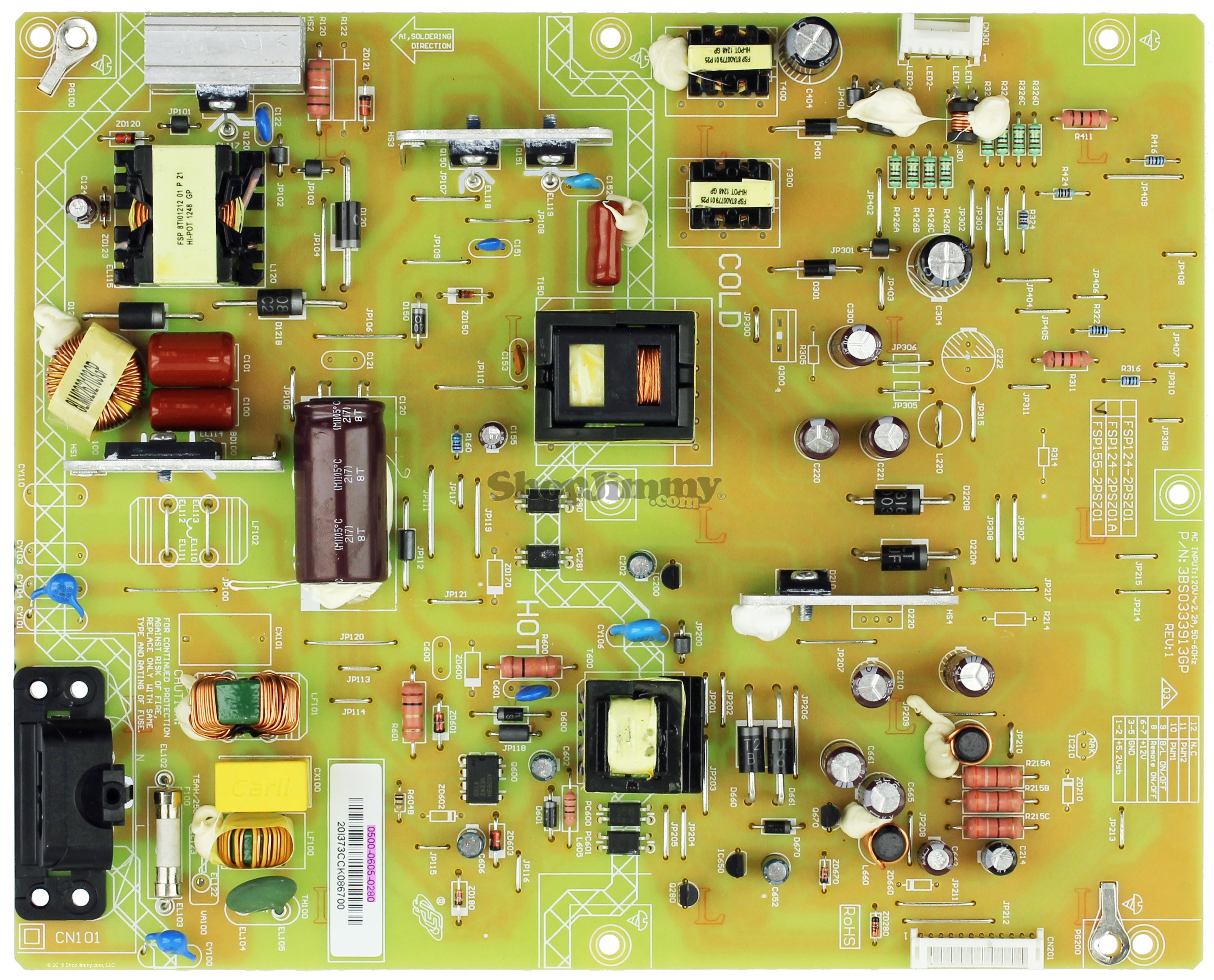

                          If you look at your board:
                          Vizio 0500-0605-0280 (FSP155-2PSZ01) Power Supply / LED Board
                          http://www.shopjimmy.com/vizio-0500-...t-inverter.htm

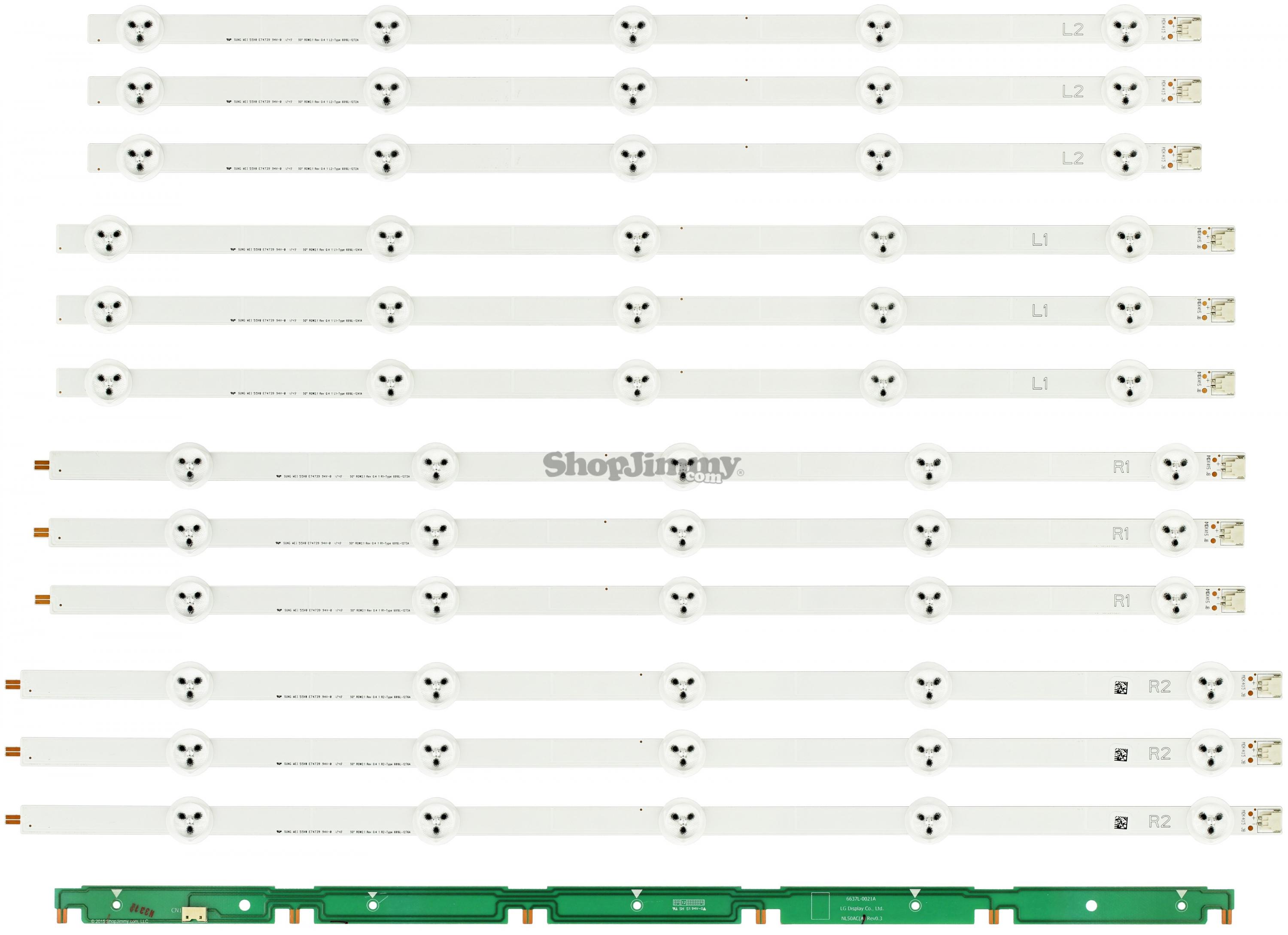

                          You can see that it has TWO LED string drive circuit, MOSFET Q302 for the boost converter, MOSFET Q303 is the PWM controlled to maintain constant current through the LED string set #1, Q402, Q403 are for the second LED string driver.
                          The panel has 12 strips of LEDs, 6 strips (each strip has 5 LEDs) are connected in series to form one long string consist of 30 LEDs, so you have two set of the LED strings and each one are driven by its own driver.
                          LG LC500DUG-JFR1 LED Strips - 12 Strips & 1 Board Vizio E500I-A0 E500D-A0
                          http://www.shopjimmy.com/lg-lc500dug...ps-1-board.htm
                          The Anode (L+) of the first set of the string is connected to the Boost converter output, the Cathode return (L-) of the string is connect to the Drain pin of the PWM controlled MOSFET, the Source pin is connected to the current sensing resistors, the other end of the resistors are connected to GND return circuit, the Voltage drops on the current sensing resistors are used as the feedback to maintain the constant current through the LED string.
                          So each string has 30 LEDs, so the minimum power supply Voltage has to be at least 30 x 3V = 90V + V drops on the MOSFET, you have 120~130V so that is more than enough to drive the LEDs.
                          "I think -1 rolls between 50-39v and -2 rolls between 30-18v." This pointed out that you do have LEDs problem because the L- should show about the same readings.
                          Pictures provided by SHOPJIMMY.

                                          You very likely have one ore two bad led's. I suspect one or more led's on a string are shorted, causing an over current condition and shutdown of the backlights.
                                          If a string was open you would likely read 0 volts on the LED1/2-
