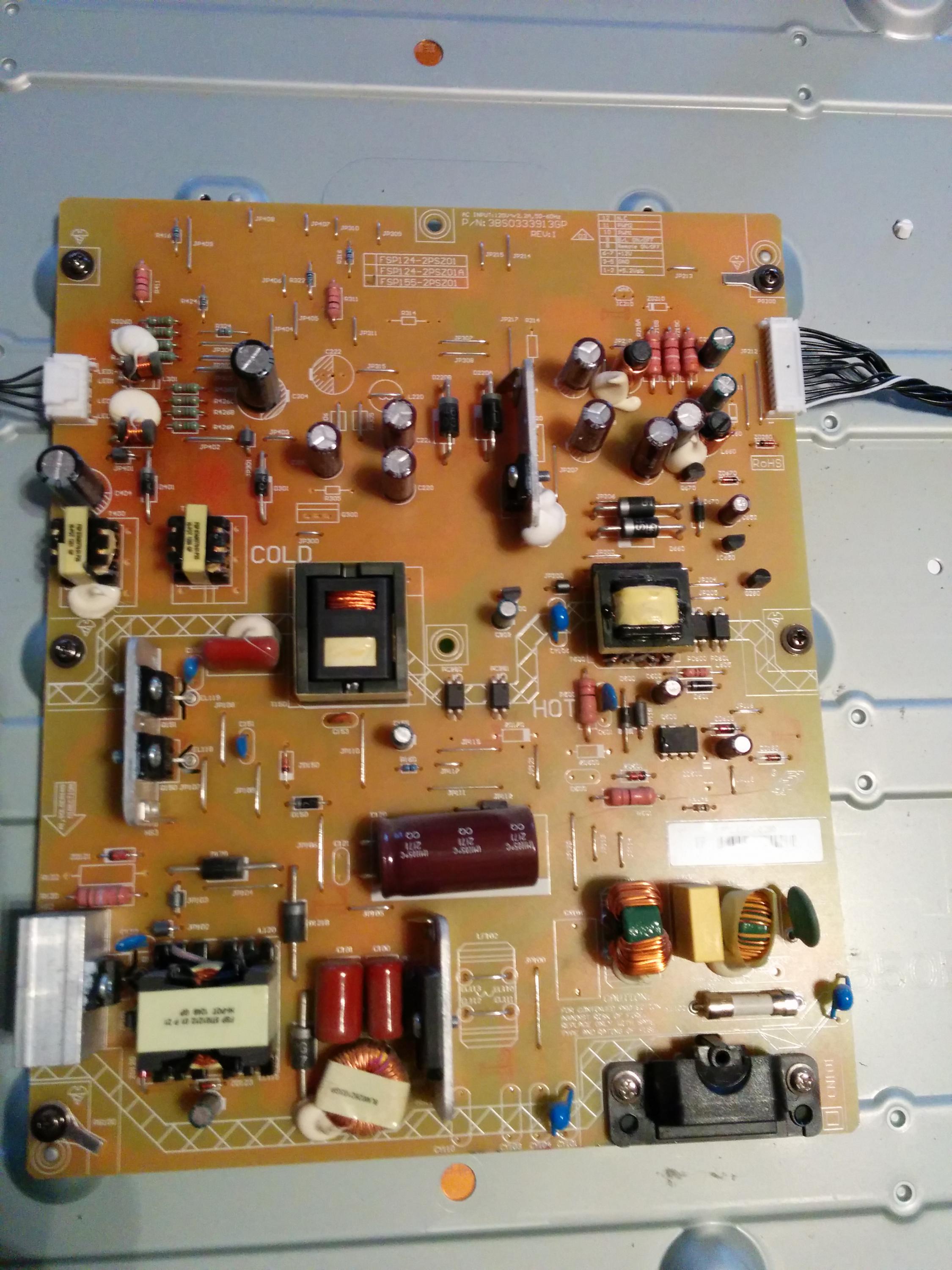

    My issue is no picture. When turning on the TV, the screen will show the VIZIO logo on the screen, but will immediately go black. The LED back light seems to die suddenly. I tried the flashlight trick, but no picture is being shown that I could see. I have sound, the led indicator light on the front is working. I took the back off and looked for bulging caps or burn marks, but there are no signs of damaged parts. I have not checked any voltages from the power supply yet, but I intend too when I get time. I believe the LED Driver board is built into the power supply, so could that be the culprit? Any help and advice is welcome. Thanks
    Re: VIZIO E500i-A0 No Picture With Sound
    I checked all the voltages on the power supply connector to the main logic board and all were good. I believe the back light LEDs are powered by the power supply (led driver), so could that be the issue?

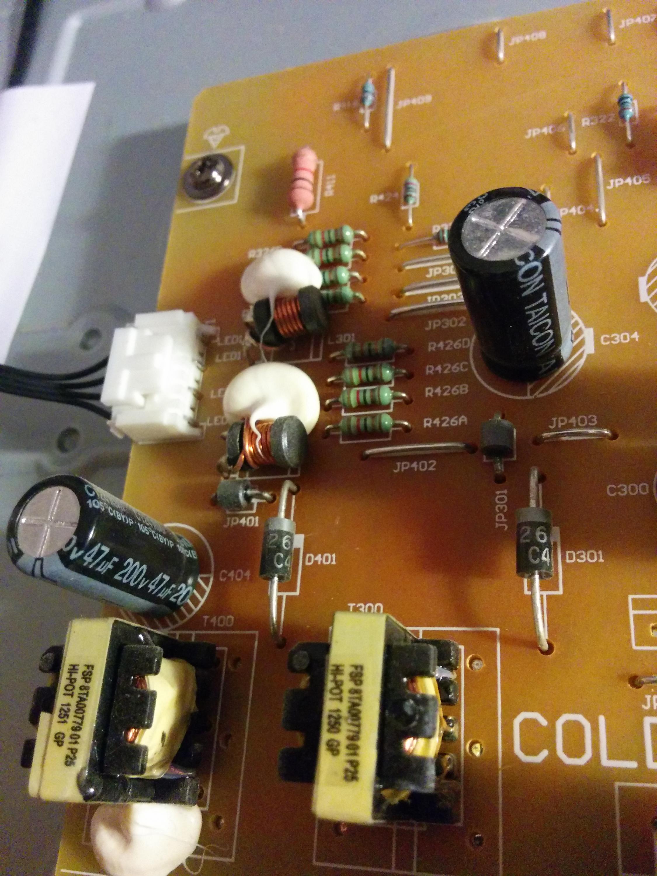

          Check the DC Voltages on the LED+ pins of that 4-pin connector when you first turn on the TV to see if there is any LED drive Voltage on the pins.
          That section of the board looks like it got hot.
          There are two large electrolytics caps (c??4), what are their Voltage ratings? I believe they are the filter caps for the boosted voltage power supply for the LEDs.
              Led1- : 10.5v
              Led1+ : 66.7v
              Led2- : 4.6v
              Led2+ : 66.7
              The led+ readings started much higher like 100+ volts but started to decrease and settle at 66.7v.
                The caps are C304 and C404 both 200v 47uf. I noticed the TV seems to shut off after about 10 minutes.
                  That sounds like you have open LEDs that is why the Voltage went up high (no load due to open LED) and then it goes into protection mode.

                    Here is a close-up.
