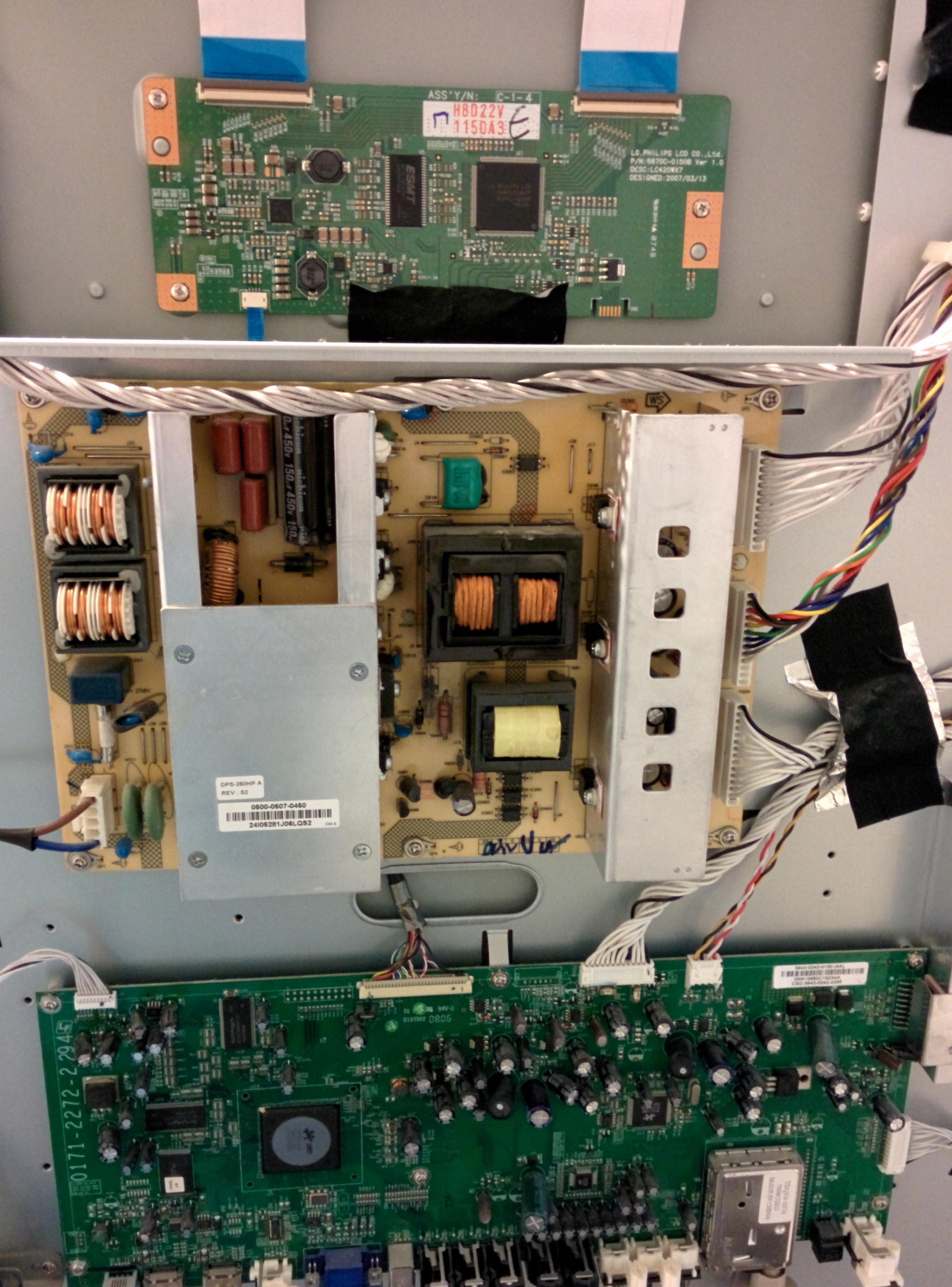

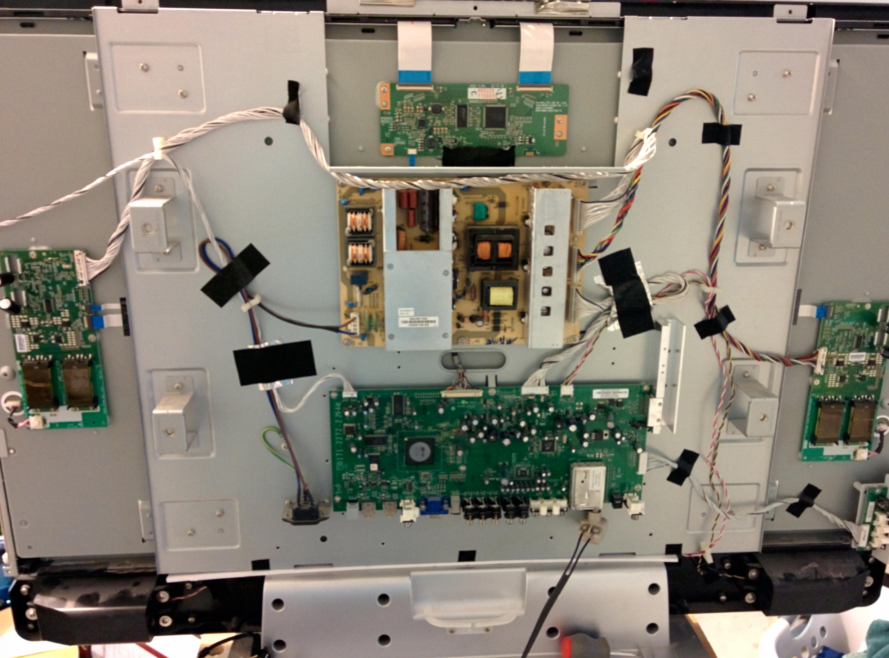

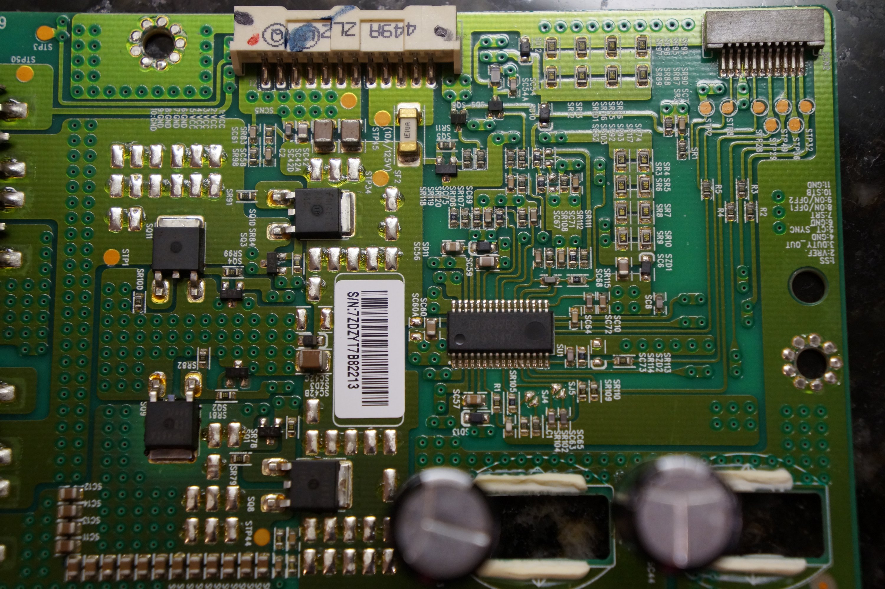

    My vizio VX42LHDTV10A had the screen go blank.
    No previous flickering, etc.
    Yellow logo on standby, white when powered on.
    TV turns on/off normally and stays on or off.
    LCD is working, verified with a flashlight shining into the screen.
    Sound is working.
    Checked power supply board for bad caps, but all look good.
    with TV on, voltages from the power supply board are:
    24V is 24.2V
    5V stby is 5.17V
    12V is 11.69
    "A" is 2.89V (bl_on?)
    "B" is 5.02 (brightness?)
    PSON is 3.12
    Did a quick check of the LDOs on the main board, but all had the appropriate differential and/or fixed output.

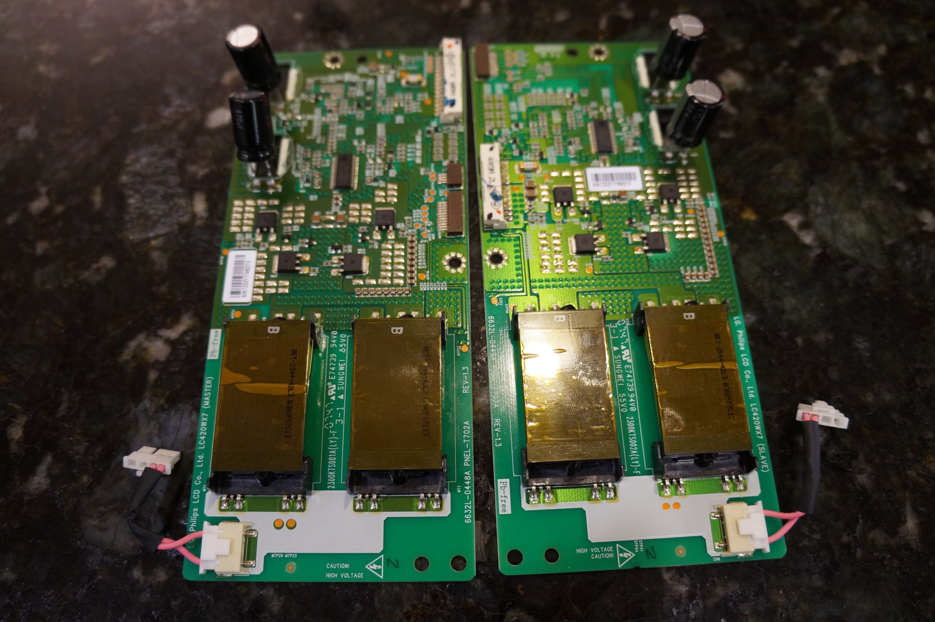

    Looked at the Master/Slave inverter boards, and noticed the 4 large caps were bloated/blown, so i replace them with the same value, but 50v instead of 35v.

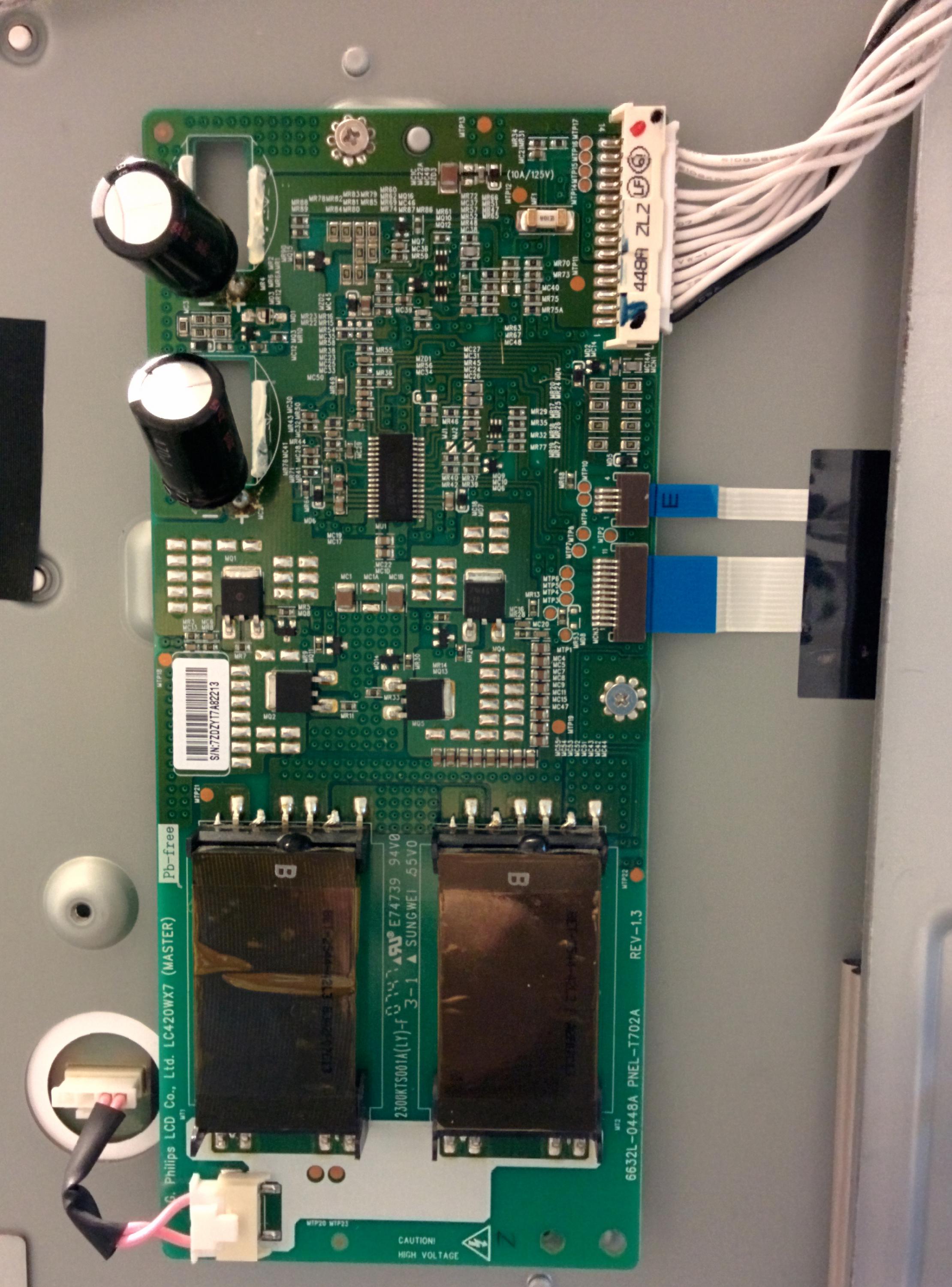

    Master Board:
    Philips LCD LC420WX7 6632L-0448A PNEL-T702A

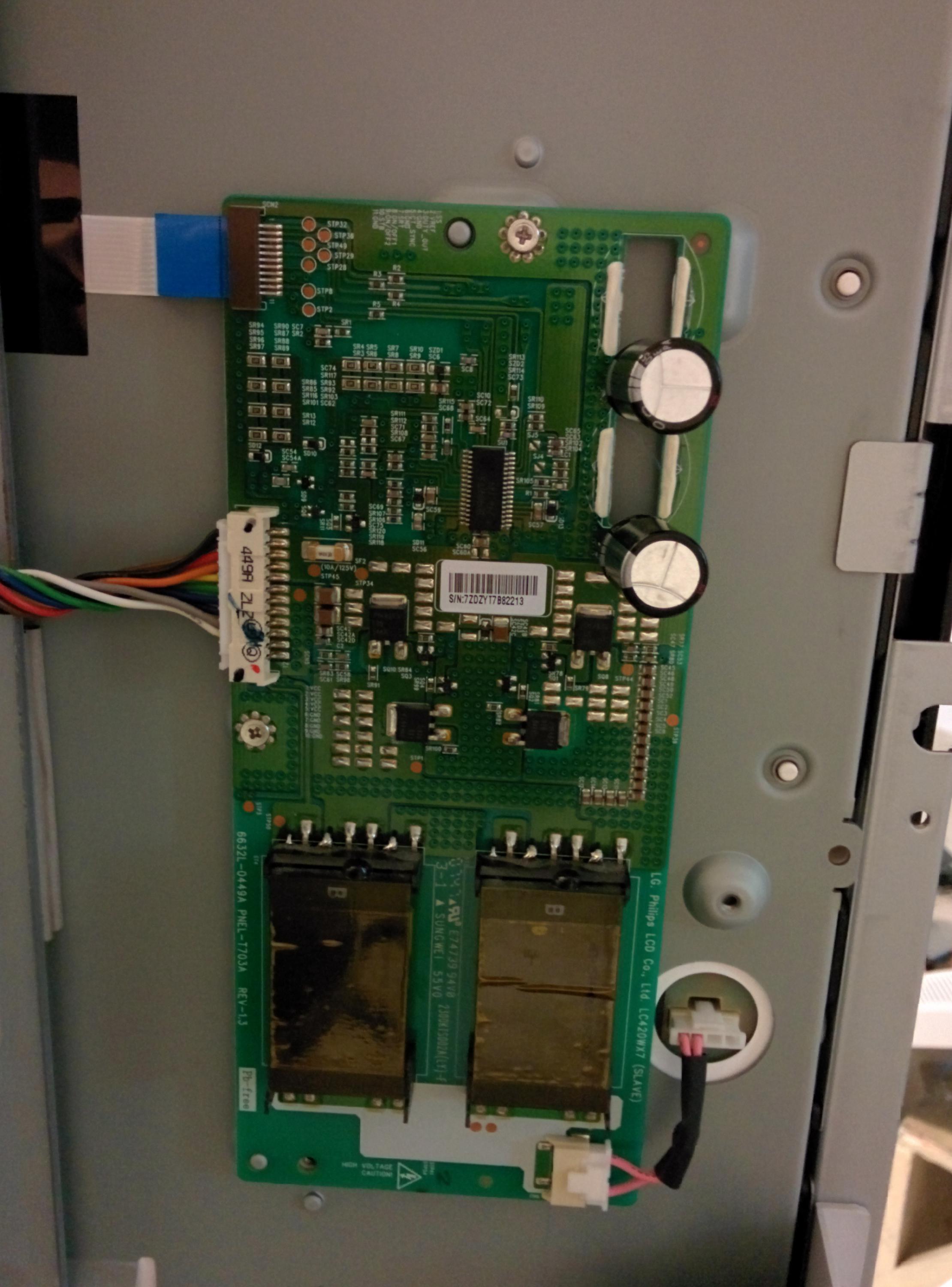

    Slave Board:
    Philips LCD LC420WX7 6632L-0449A PNEL-T703A
    Unfortunately, that didnt help.
    Found 1 fuse on each inverter board and they were good.
    I tried jumpering the 5VSB to PSON before turning on tv to see if it was a timing issue, but no luck.

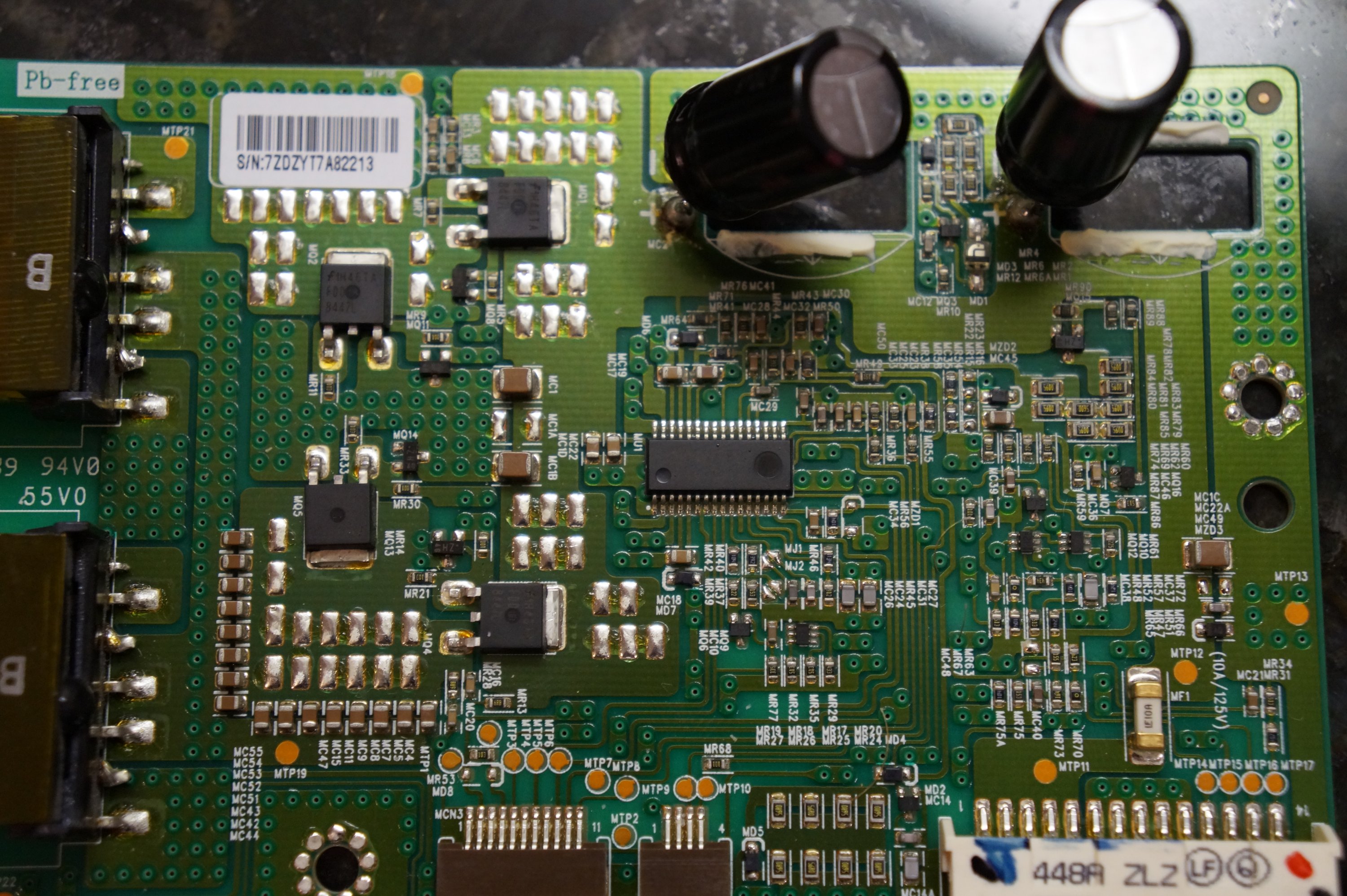

    I checked the 4 MOSFETS on the boards
    MQ1,MQ2,MQ4,MQ5
    1H46TA
    FDD
    8447L
    The top two (MQ1 and MQ4) have +24V on D, and 0 on both G and S
    The S of MQ1 feeds the D of MQ2, which has all pins at 0v.
    The S of MQ4 feeds the D of MQ5, which has all pins at 0v.

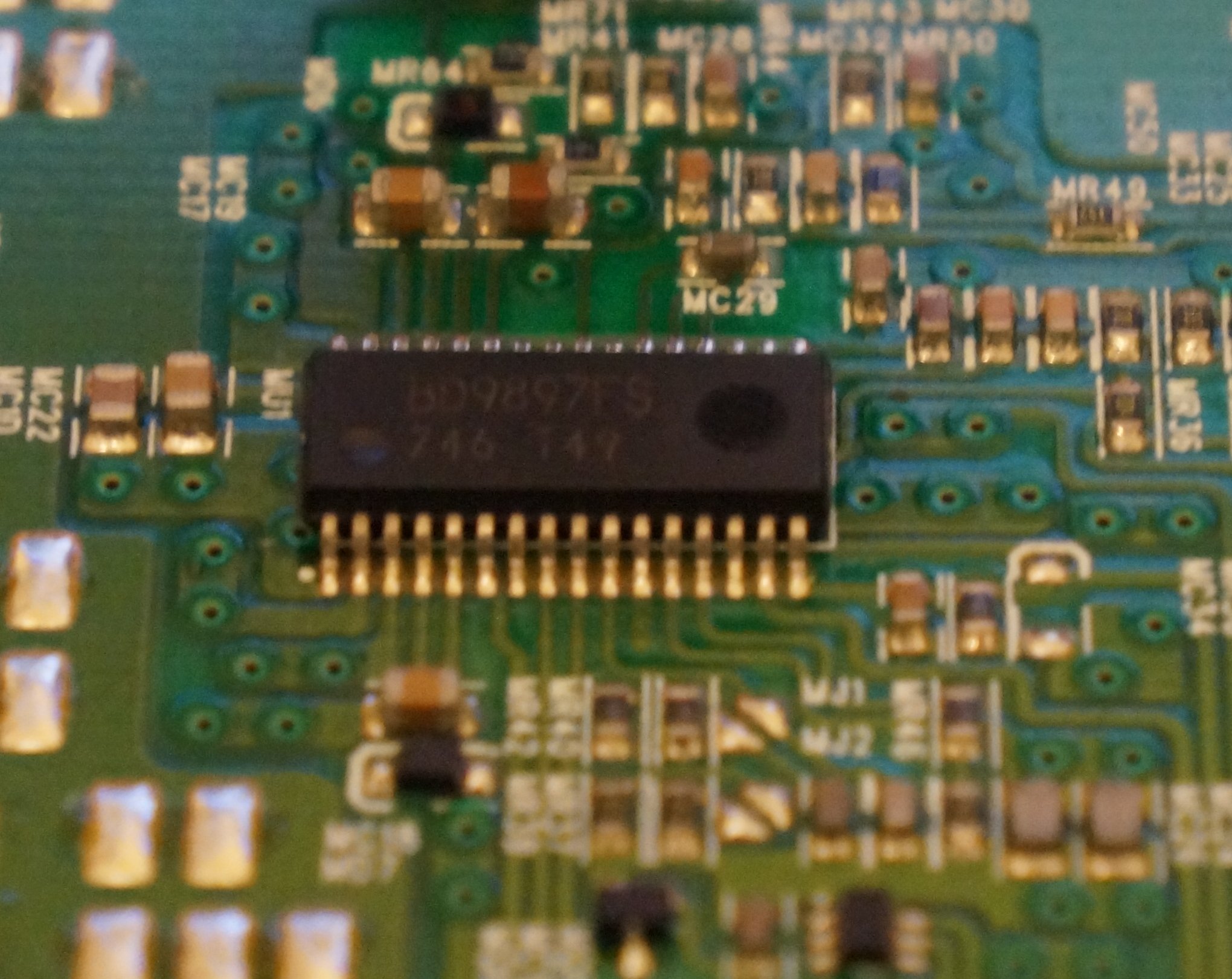

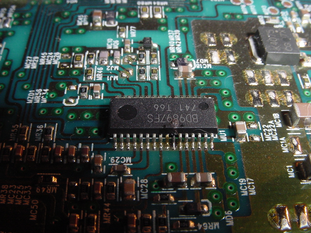

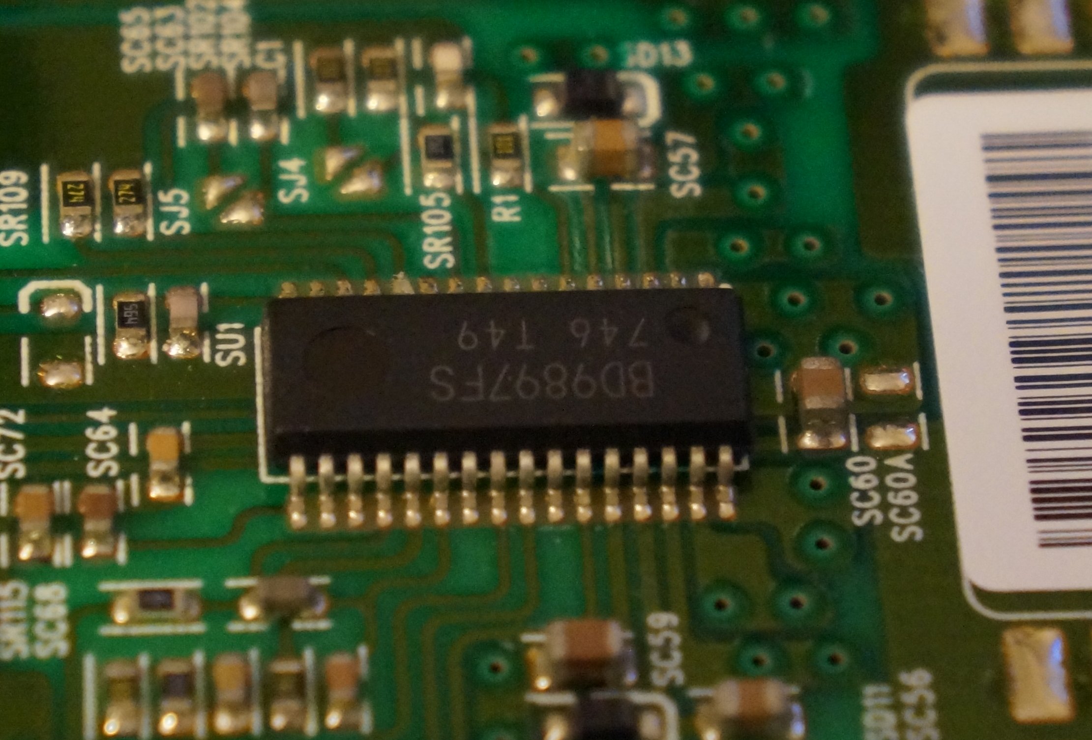

    The G of MQ1 and MQ4 are both traced back different pins on MU1, the main IC
    BS9897FS
    746 T49
    how likely is it that the main IC would go bad? It might be above my abilities to fix, but I might be able to get someone at work to help.
    Is there a way to make sure it's the inverter boards and not the actual CCFLs?
    I saw mentions of a mod for other phillips inverter boards, but not mine specifically, anyone know of a similar mod?
    Everywhere I looked on google, no one had the boards in stock. Anyone have any recommendations for a reputable store?
    Thanks for any help

    Probably not the lamps unless they were (somehow) shorted to ground. If the lamps are old or one is bad, they usually flicker momentarily then the inverter senses an error and shuts down. Sounds like yours isn't even trying to come on.
    If the MOSFETs have 0v on their gates they are probably getting no drive signal from the controller ICs, unlikely both boards went bad at once, so probably the controller ICs aren't getting signal to turn on.
    Where do the inverter's control signals come from? Can you add photos showing what connects to what etc?
    -David VanHorn

          I've tried looking at the IC's spec sheet, but couldn't find a good idea which one is the "on" line for the IC.

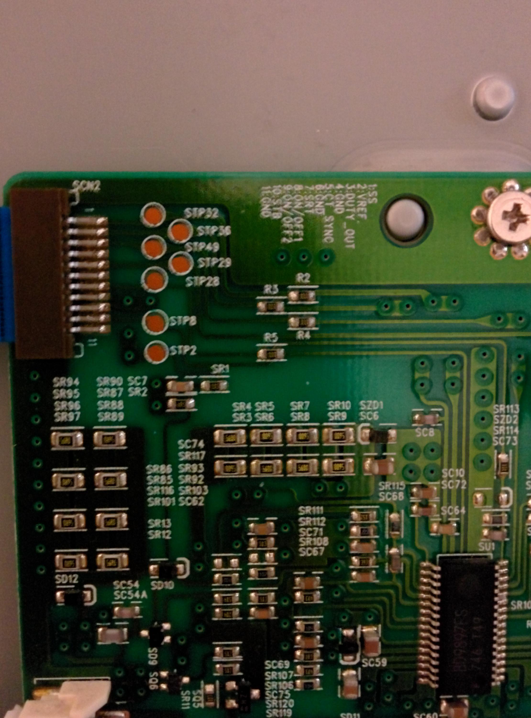

          for the inverter boards:
          There is an 11 pin ribbon cable connecting the master-slave inverter boards:
          1:SS
          2:VREF
          3UTY_OUT
          4:GND
          5:CT_SYNC
          6:GND
          7:SRT
          8:ON/OFF1
          9:ON/OFF2
          10:STB
          11:GND
          There is also a 4 pin ribbon cable going from the master to the TCON bd, but no clues as to what's on those pins.
          The master has a cable going to the pwr board with the +24, GND, ON/OFF, VBR-B
          The VBR-B is brightness, I'm assuming and ON/OFF is the BL_ON 2.9v
          The slave's to the pwr board only has the +24 and GND populated

                Ok, looked a bit closer and it seems as though on the master bd the On/Off from the pwr supply board goes to ON/OFF2 on the mas/slav ribbon. On the slave these two are connected together, so ON/OFF1 on the master will have the ~3v when the slave is connected. ON/OFF1 goes through a 10k resistor an then to pin16 on the IC (labelled as STB) which is also pin 10 on the mas/slv ribbon.
                Just checked and on both the master and slave, ON/OFF1 and ON/OFF2 are both at 2.88v and STB is at 0.7V
                looks like i need to figure out what else is on the STB line

                    The caps are connected in parallel, the minus is connected to the circuit ground (24V return), the Plus are connected to the fuse which is fed by the 24VDC B+.
                    The master-slave inverter are setup as push pull to drive the lamps, The master inverter send the drive signal to the slave to synchronize the circuit of the master and the slave. If the Master inverter board is working but the slave is bad, you will see one side of the screen lights up only, if the Master is bad but the sync signal is still good, the you will see the other half of screen lights up only.
                    So right now the MASTER is not active.
                    There is a small flat white cable between the Master inverter and the T-CON board, remove it to see if you will get the backlights, this TV has what is called Dynamic Contrast function so they can claim that the TV has high contrast ratio (B.S), the brightness of the backlights is controlled by the T-CON which depends on the scene of the Videos.

                          Something dead in the inverter that didn't blow the fuse? The inverter controller tries to start, and shuts down? The backlights never flicker because whatever is bad stops them from getting any power?
                          -David VanHorn
                            Re: Vizio VX42L NO picture, good sound and LCD
                            He can try replacing the IC that will be my first choice.
