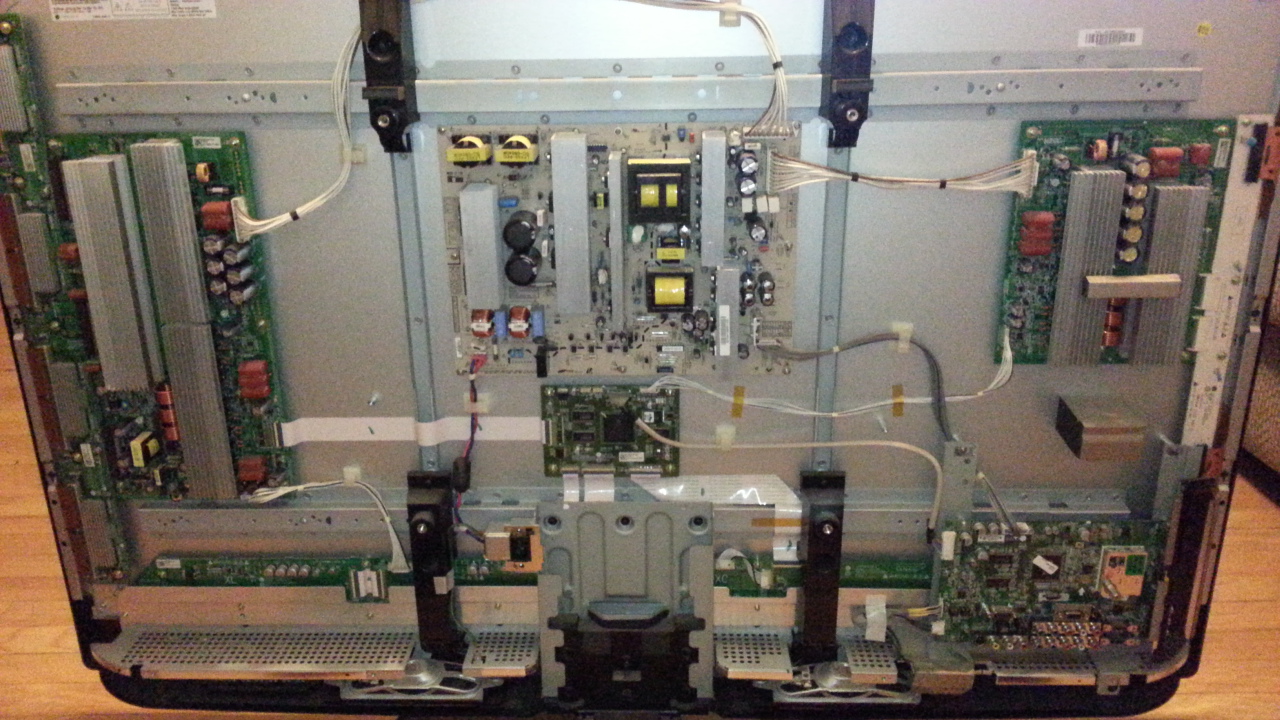

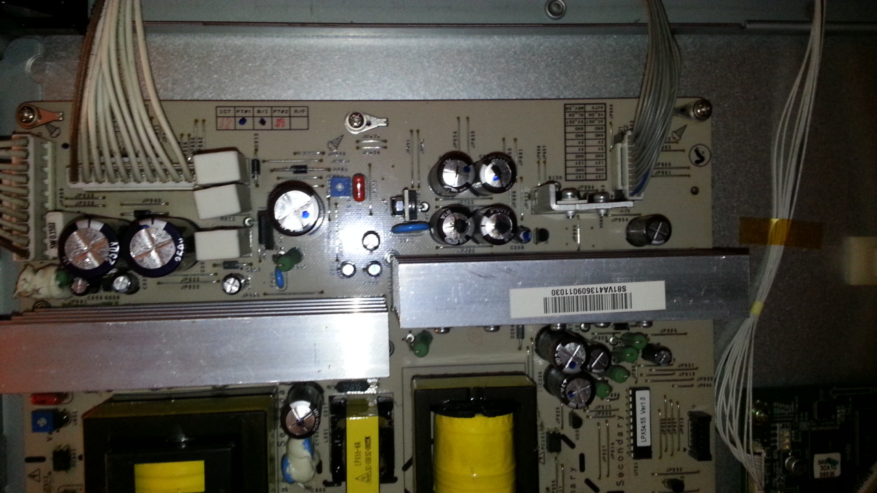

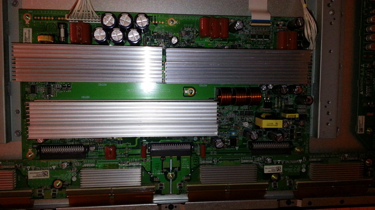

    I forgot the issues with this tv
    So I just removed the back cover
    Found a few blown caps on the psu and the ysus board
  • jose6326
    • May 2013
    • 707

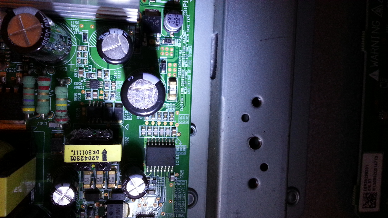

    Re: Lg 50pg20

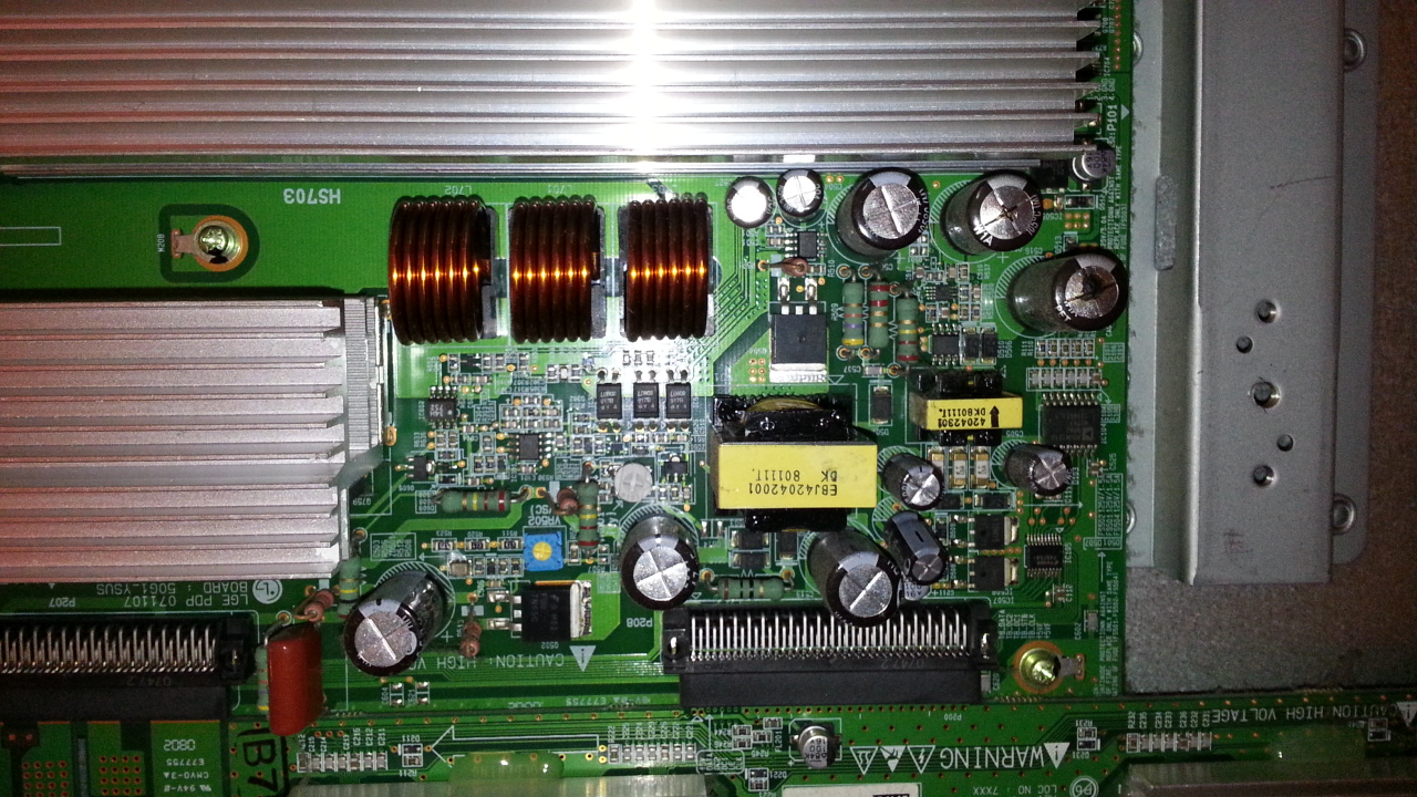

    Here is a closer view of the blown caps
    I haven't tested any voltages because of the blown caps.
    Or should I?
    What other caps should I replace?
    Or should I just replace the faulty ones?
    • MagicSmoke
      • Feb 2011
      • 275

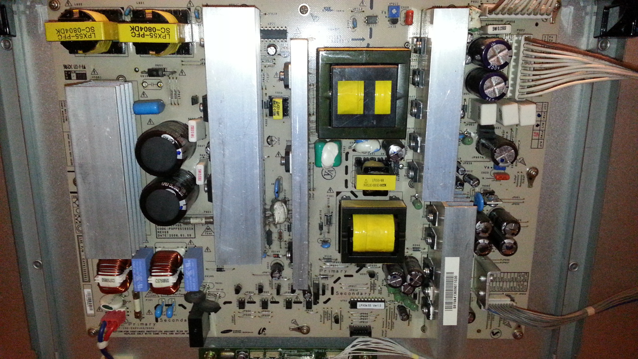

      Re: Lg 50pg20
      I would change all that are under 100v. It's good insurance that you wont have to open it up again in the near future.
      But be aware that the bad ones can cause other parts to fail also. So far I have been lucky on the PSU's that I recapped.
      Same on the X & Y replace all under 100v. All of them have the same hours even though they may not have the same stress on them.
      Test PSU first after recap to make sure all of the voltages out are to spec.

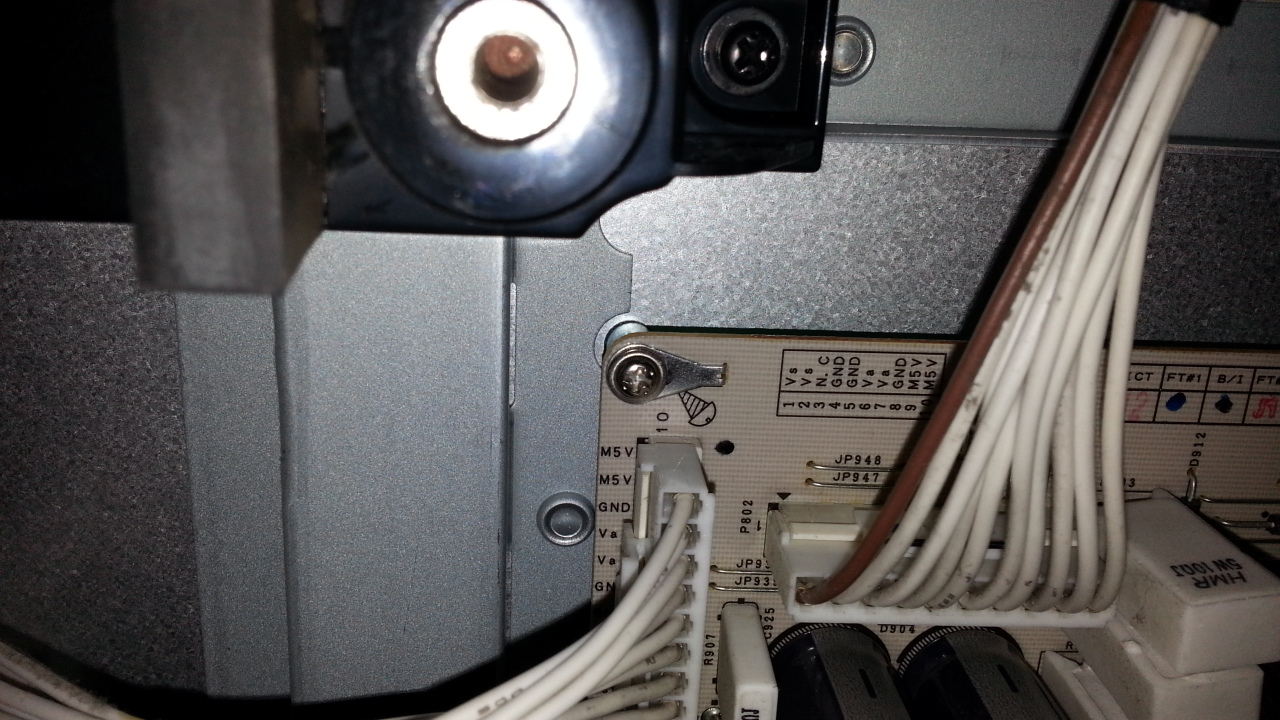

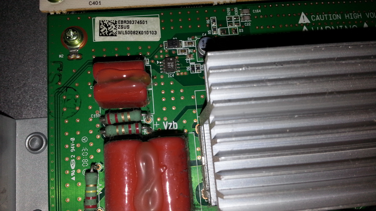

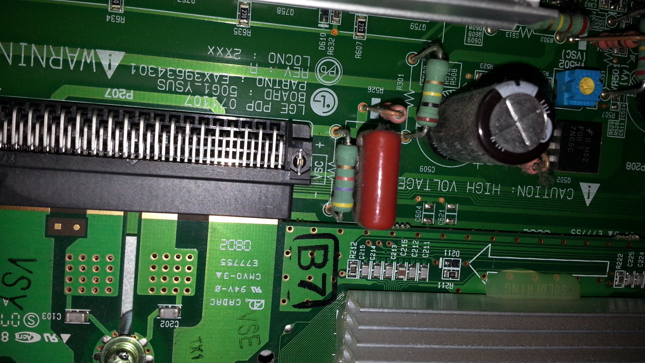

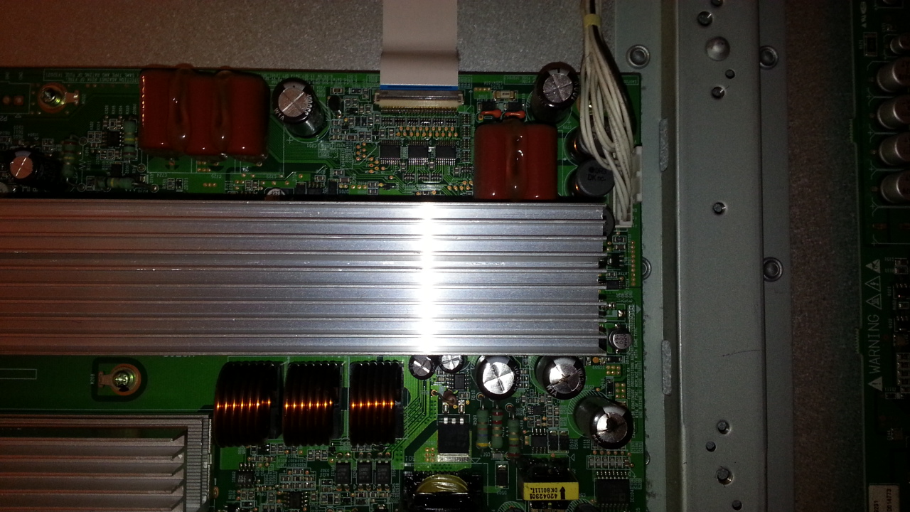

            Here are the voltages
            Vsc on the ysus board .382v
            Vzb on the zsus board 96v
            I could not find the test point for Vs or Va
            So I tested at 2 locations

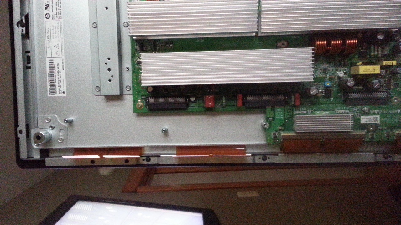

            First was on the ysus board (see pic)
            Va 65.3v
            Vs 192.4v
            Second point was at the connector on the psu going to ysus
            Vs 192.4v
            Va 65.3
            Connector going to zsus from psu
            Va 65.4v
            Vs 192.3v
            • jose6326
              • May 2013
              • 707
              Re: Lg 50pg20

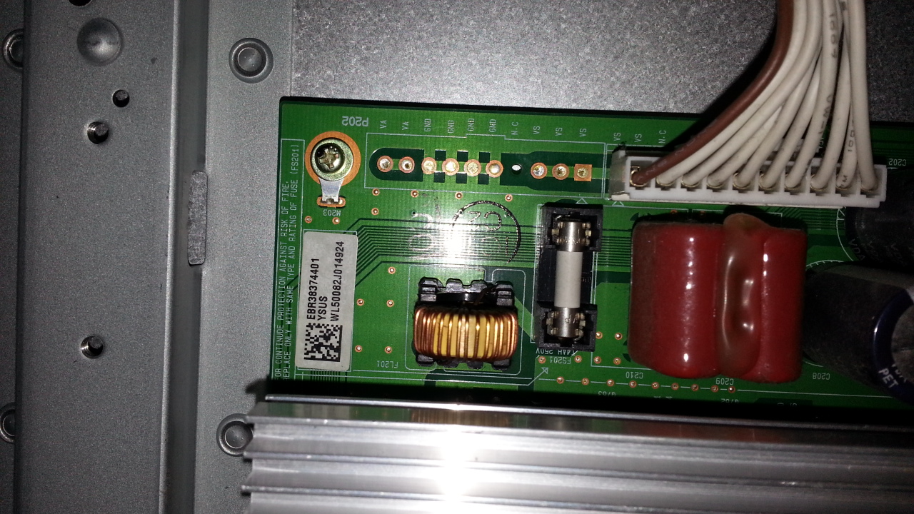

              After doing some searching I see that theses sets have bad ysus boards and possible faulty buffer boards as well
              https://www.badcaps.net/forum/showth...ghlight=50pg20
              I did find a blown surface mount fuse on the ysus board below one of the caps I replaced
              Should I bother replacing it?
                      yes

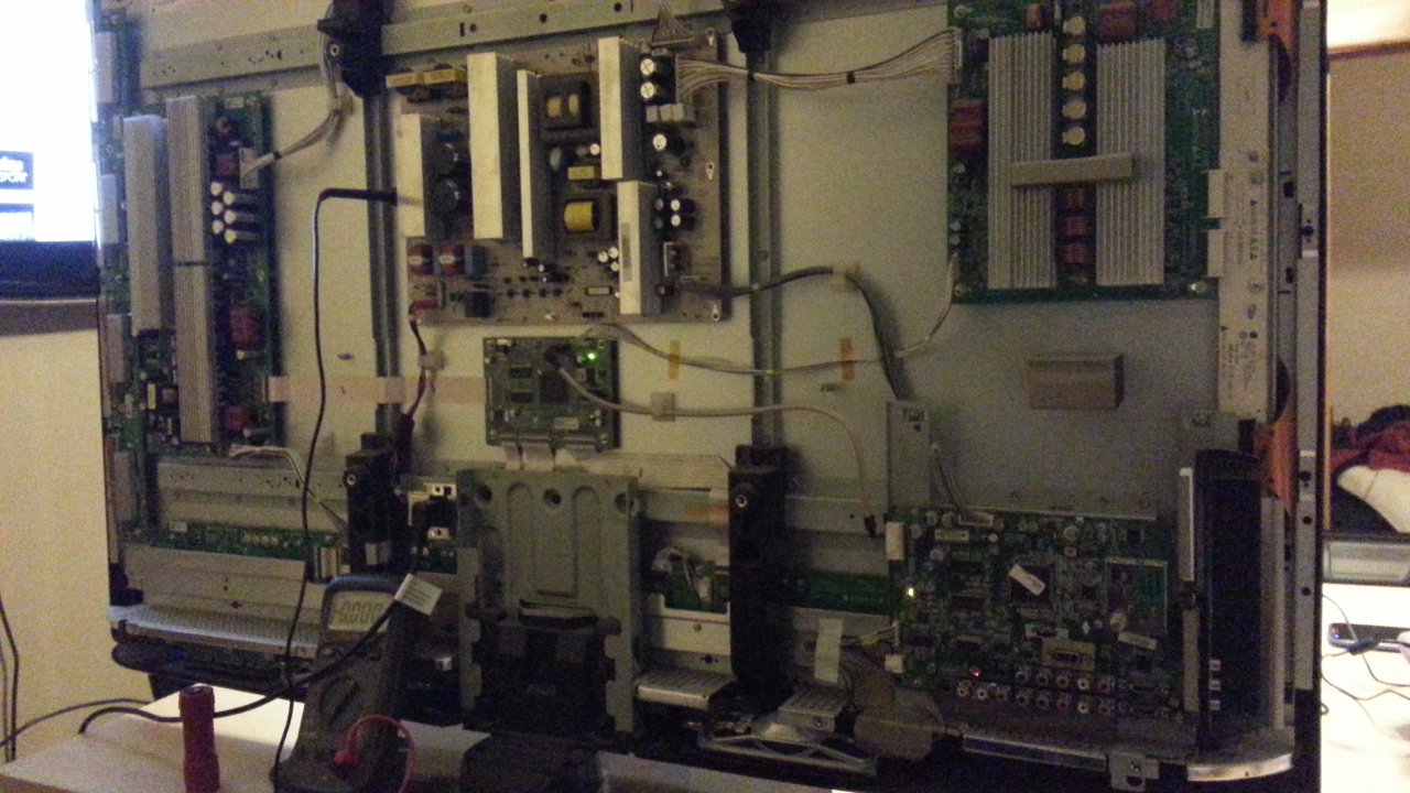

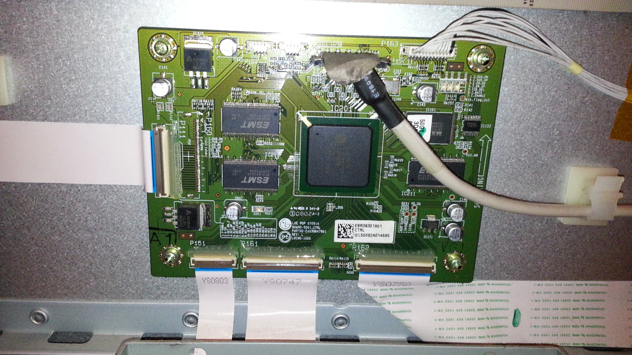

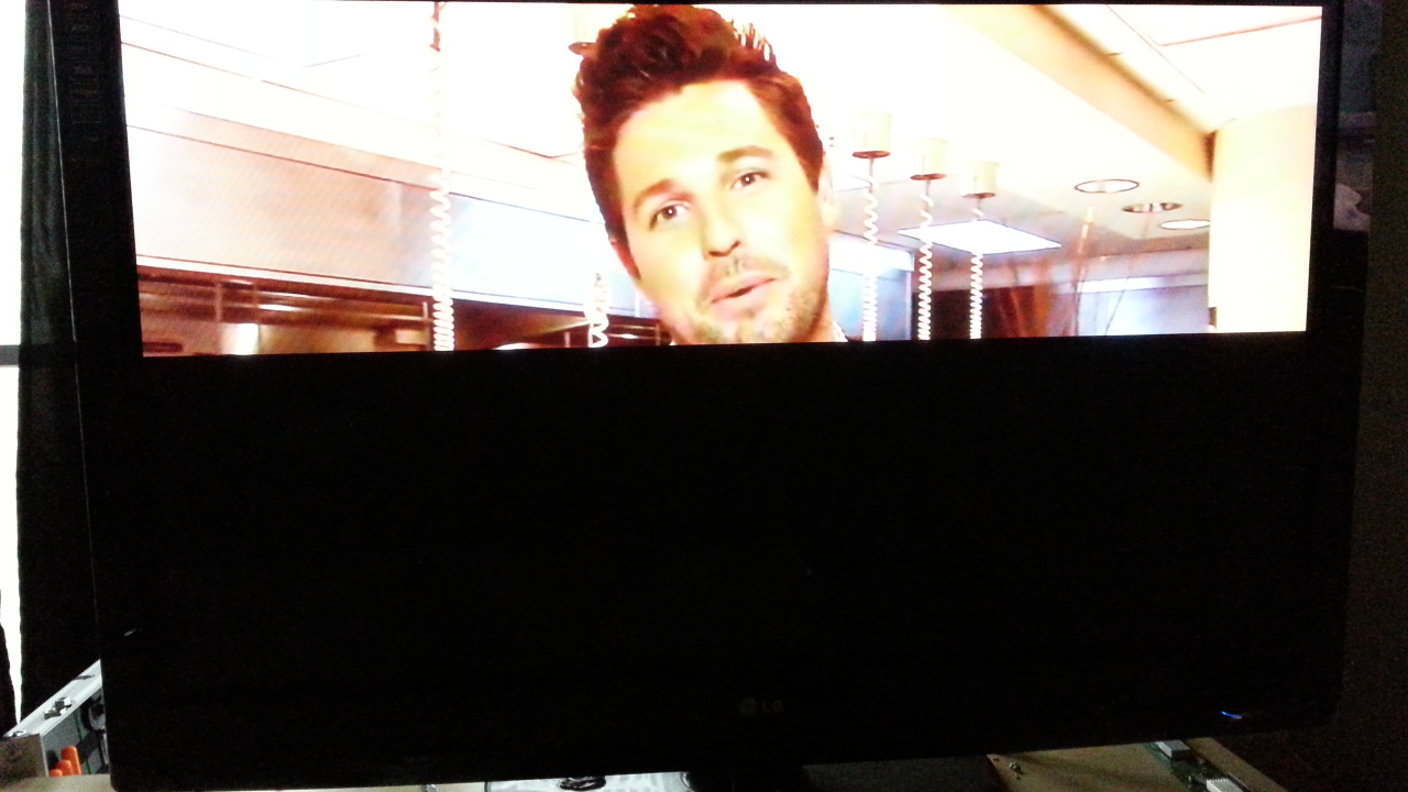

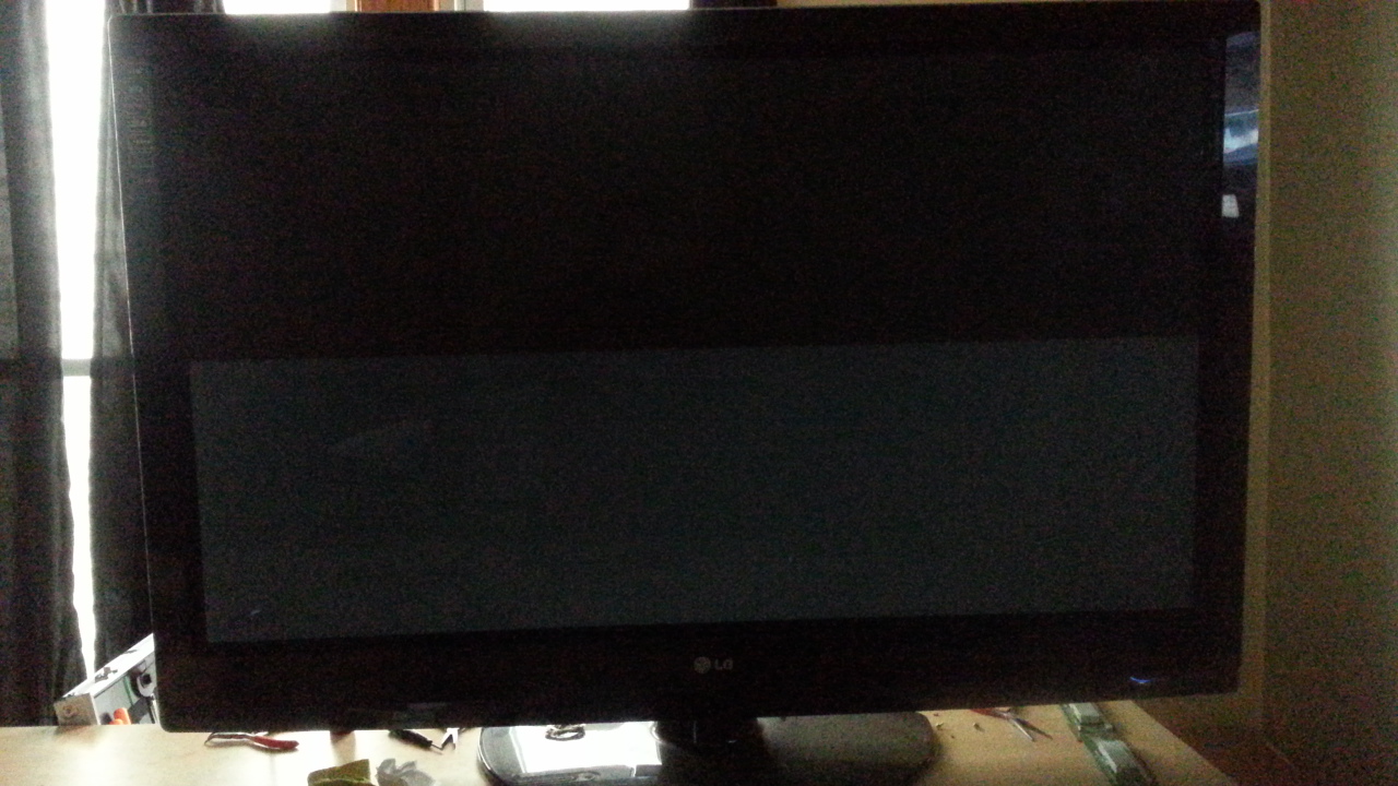

                          Re: Lg 50pg20
                          Ok so I replaced the fuse from another defective board
                          I removed the top buffer board and powered the tv on
                          I get a black top screen and a grey bottom screen
                          Does that mean the top buffer board is bad?

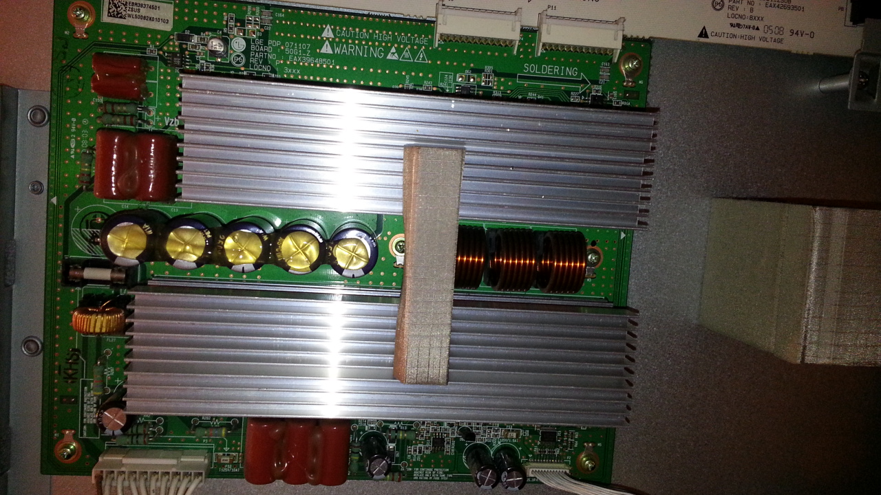

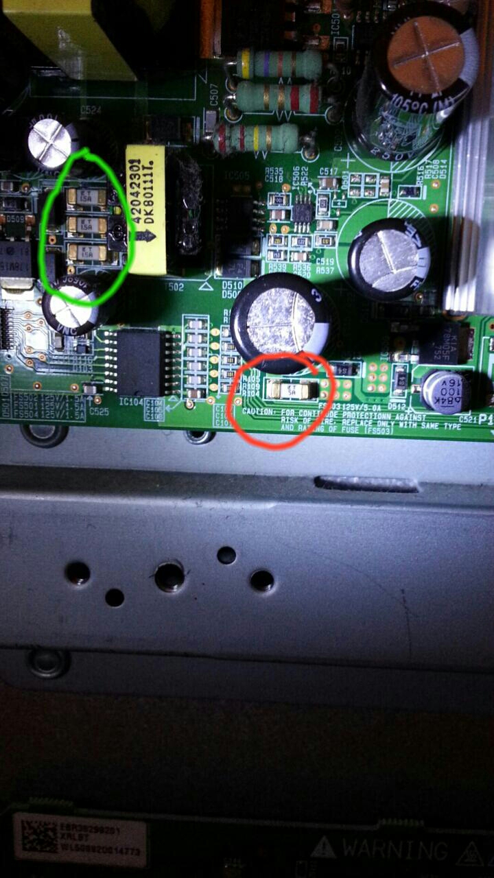

                            I was reading on another thread that if a fuse is blown on the ysus an ipm failed
                            Tom66
                            A common fault is for the fuse on the Y-sustain to blow. Most often it blows when one of the IPMs on the Y-sustain fail. These IPMs can be difficult to replace, but the board will certainly cost less than $560!! And it will take less than a half-hour to replace it.
                            Which fuse would tell me if an ipm failed?
                            There are 6 surface mount fuses and 1 socket mount fuse
                            • jose6326
                              • May 2013
                              • 707
                              Re: Lg 50pg20
                              The fuses in the green tested fine
                              The fuse in the red is the one that blew and I replaced

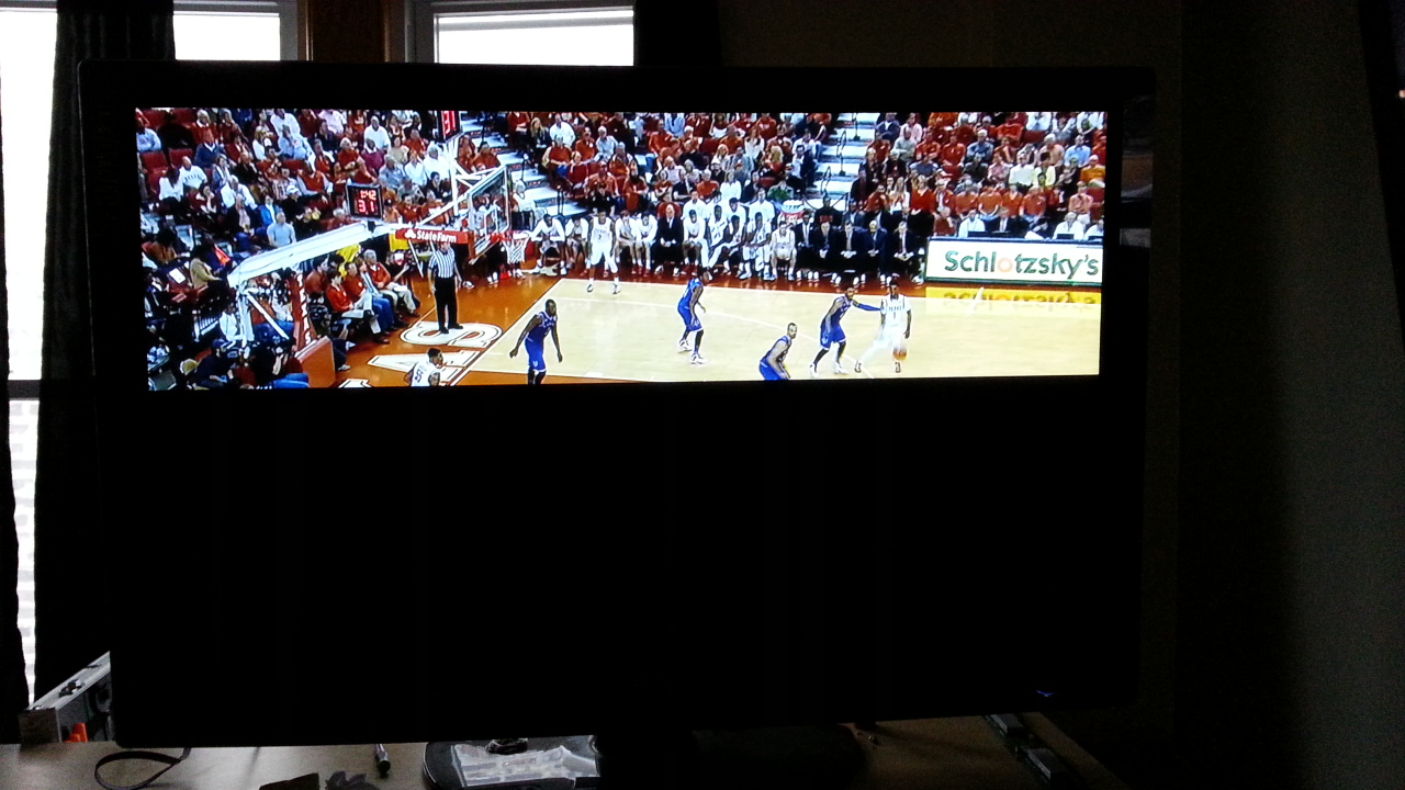

                              • jose6326
                                • May 2013
                                • 707

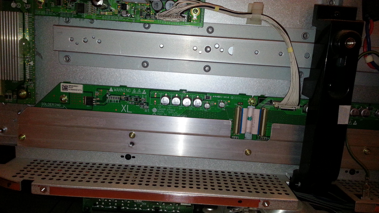

                                Re: Lg 50pg20
                                I am confused
                                I removed the bottom buffer board and put back the upper
                                Now I get a top screen image and bottom black screen
                                Which board is defective? Or is the ysus board defective?
                                Please help
                                • rccrasher65
                                  • Mar 2014
                                  • 619
                                  Re: Lg 50pg20
                                  Looks like y sus is good, and lower buffer is bad.

                                    • jose6326
                                      • May 2013
                                      • 707
                                      Re: Lg 50pg20
                                      Thanks for the help guys
                                      I want to make sure I order the right part
                                      I figured it would be the lower buffer board
                                      I will reinstall the bottom buffer and hopefully its just the ribbon cables were not seated properly
                                      If not I wilk order the lower buffer
                                      Thanks again

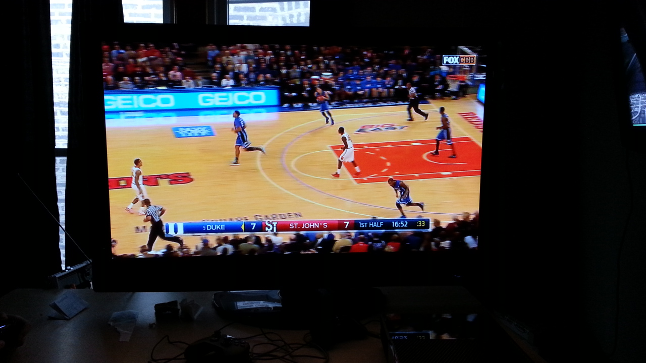

                                      • jose6326
                                        • May 2013
                                        • 707
                                        Re: Lg 50pg20
                                        Sugar ray thanks for the suggestion
                                        I probably would have just ordered a new board
                                        I got a full clear picture
                                        Thanks for the help everyone
                                        Another tv saved from the landfill
