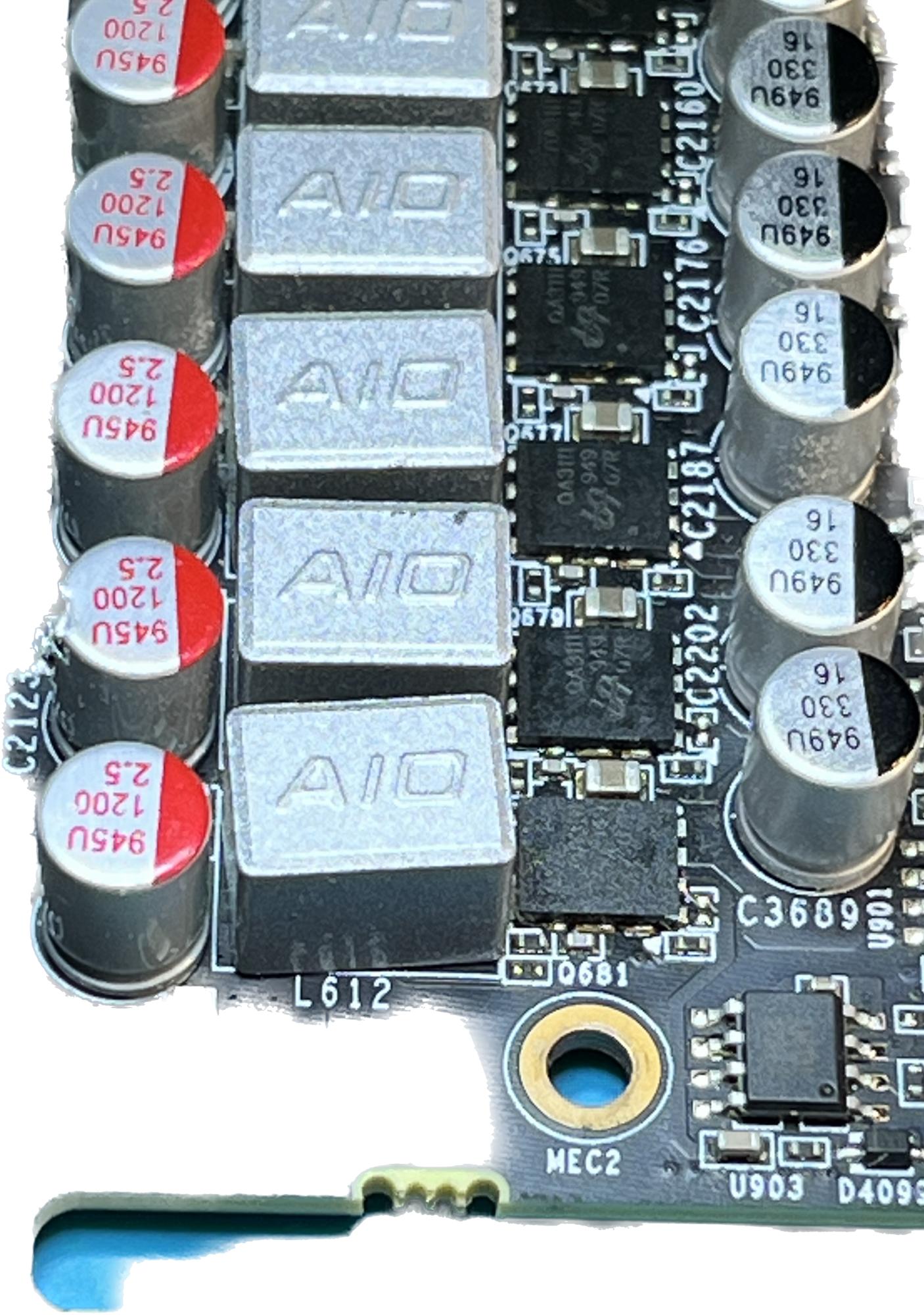

Zotac RTX 2070 super.What can i use to replace this blown cap?

    I have a non working Zotac RTX 2070 super. One of its caps is blown. I need help finding out where i can buy this exact capacitor or a suitable replacement for it.
    The diameter is about 5mm

    as u see there are two types. 330uF/16V and 1200uF/2.5V. replacemet must have same size can have lower capacitance

      The 1200µf/2.5v looks physically damaged, not likely blown, I would check the board for other damage.
      Most suppliers carry Aluminum Organic Polymer Capacitors of that value

        Thnx for replying (to both of you). I agree that it doesn't look blown, but the physical inspection didn't reveal any other obvious damage. Also, the material around the hole in the capacitor is pointed outwards and not inwards.
        The suppliers near me don't have the correct size capacitor (or smaller). And with mouser i have to pay 20 dollars for shipment. So i ordered it from Aliexpress instead. I hope some of the 100 pieces wil work .
