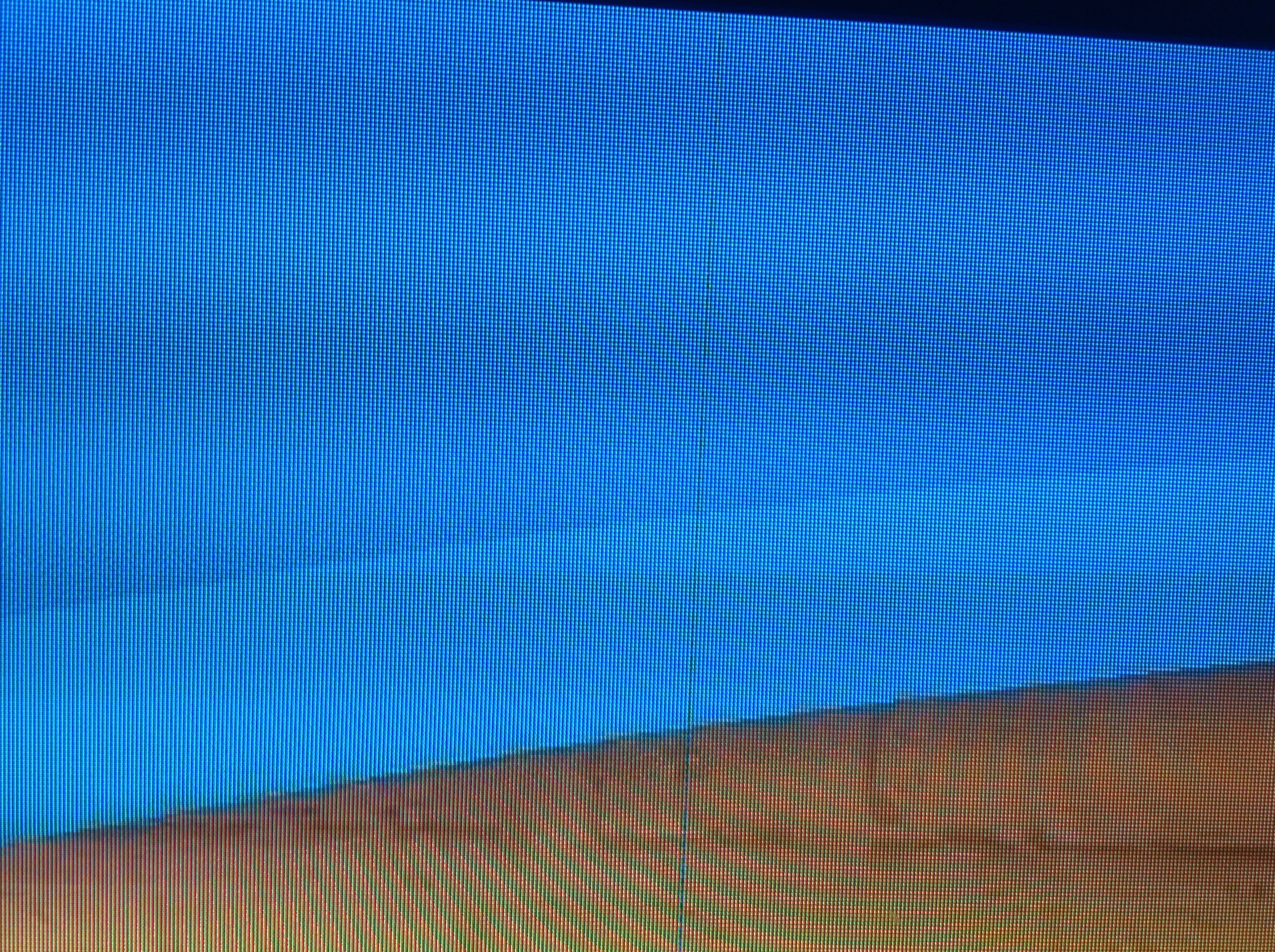

    Hi there
    2 weeks ago our 60PS8000 developed a color changing vertical line.
    It's almost in the middle of the screen.
    The color it has depend on the picture on the tv. Picture red - line blue, picture blue - line red. If there are several colors on tv the line also has more than 1 color. On the picture you can hopefully see what i am trying to explain.
    What can it be? Is it the panel like i read several times or is there anything i can do?
    Thank you
    Flauschi

    Looks like the panel itself is faulty. Unlikely to be bad connection between the panel and buffer board because the line is very thin

      The line is just 1 line of pixels wide. Until now it runs like this, no other problems or other lines appearing.
      Edit: Forgot to mention it: The 60PS8000 is a plasma TV.

          Yes single-pixel lines are a very bad sign, could be the cof on the relevant panel ribbon. You could disassemble it to that point and have a look - but don't run the set without the long metal bracket (heatsink) in place or it will kill the cof's in short order.

            Thanks. I will open it and try to find anything
