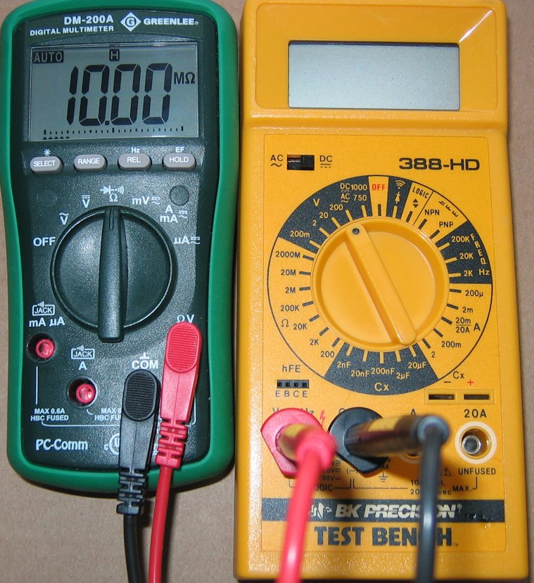

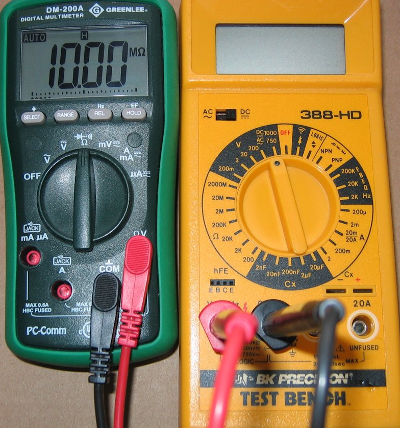

      1) Put your RCC into 200 DCV mode.
      2) Put the Greenlee into resistance mode.
      3) Put the Greenlee red probe tip into the RCC Volt/ohm input jack. Put the Greenlee black probe tip into the RCC COM input jack.
      See pictures as an example. Report your reading. You should get around 10.00Mohm.

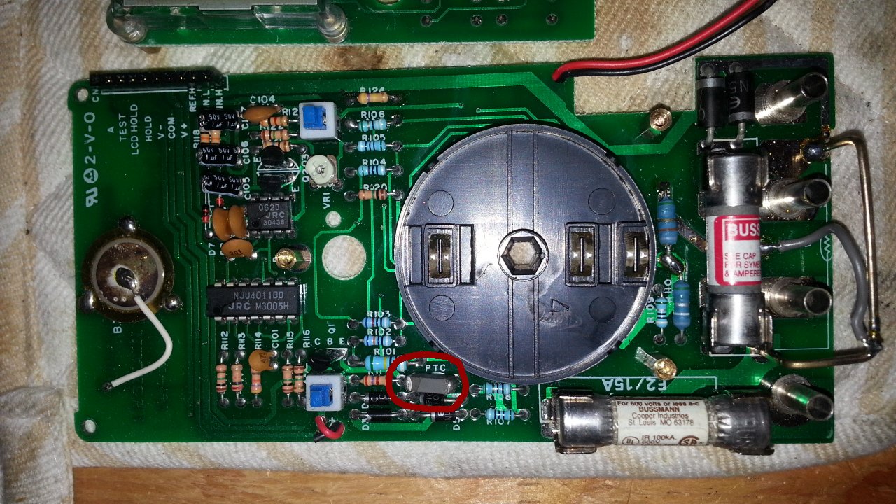

      5) On the pcb, there is a PTC (circled in red). Measure the resistance of it. It should be in the 1 to 1.5k ohm range. The PTC can be measured in circuit (no desoldering required).
