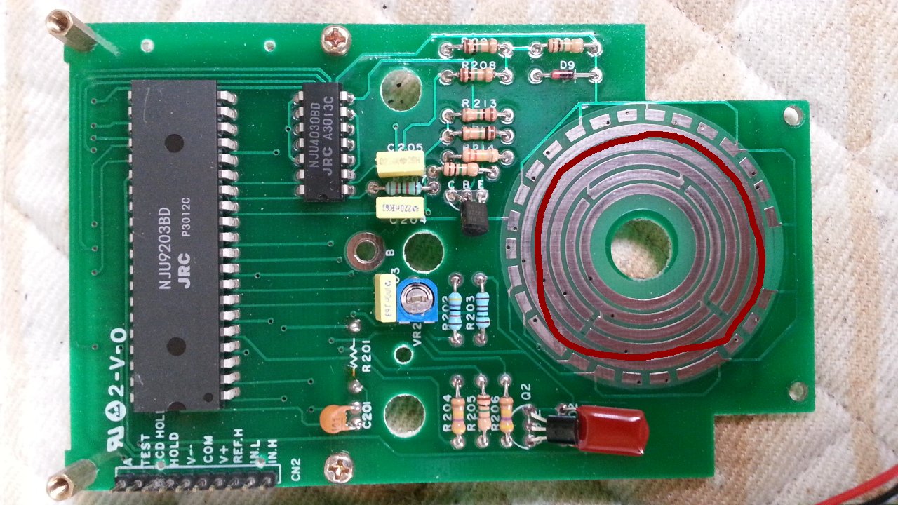

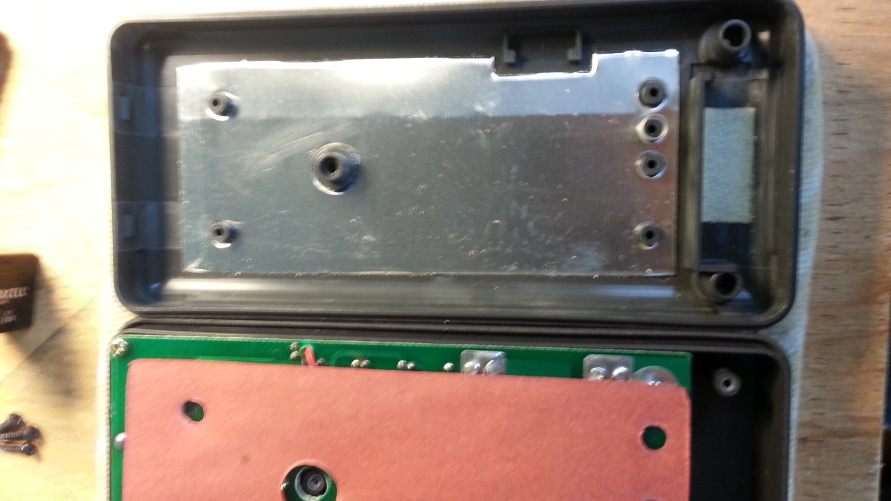

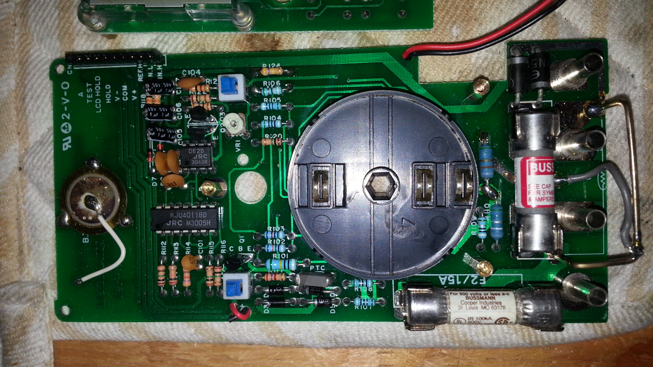

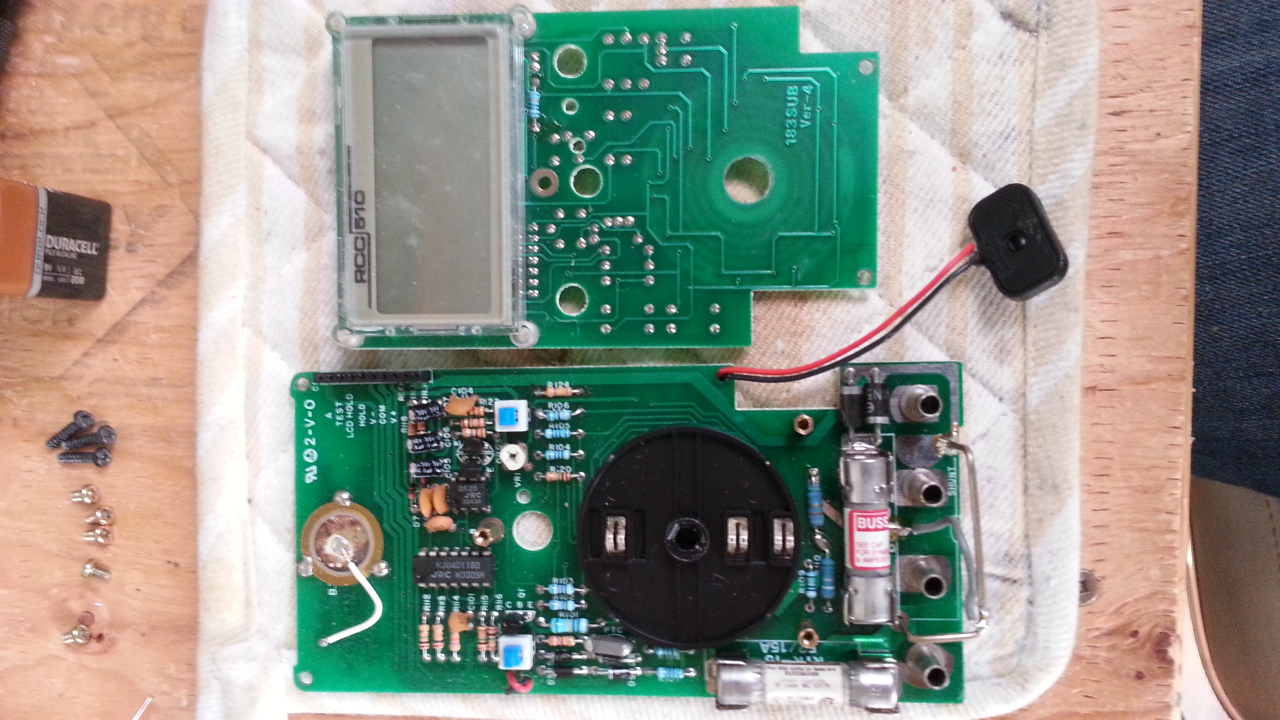

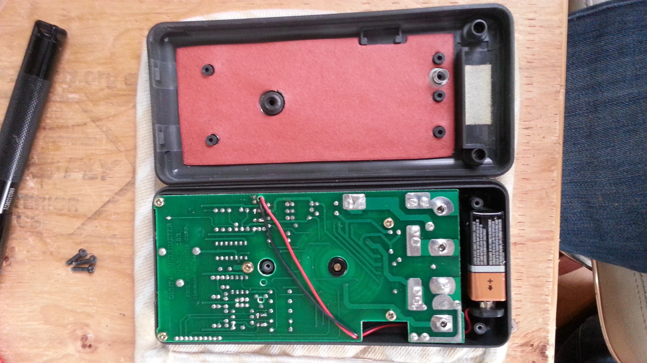

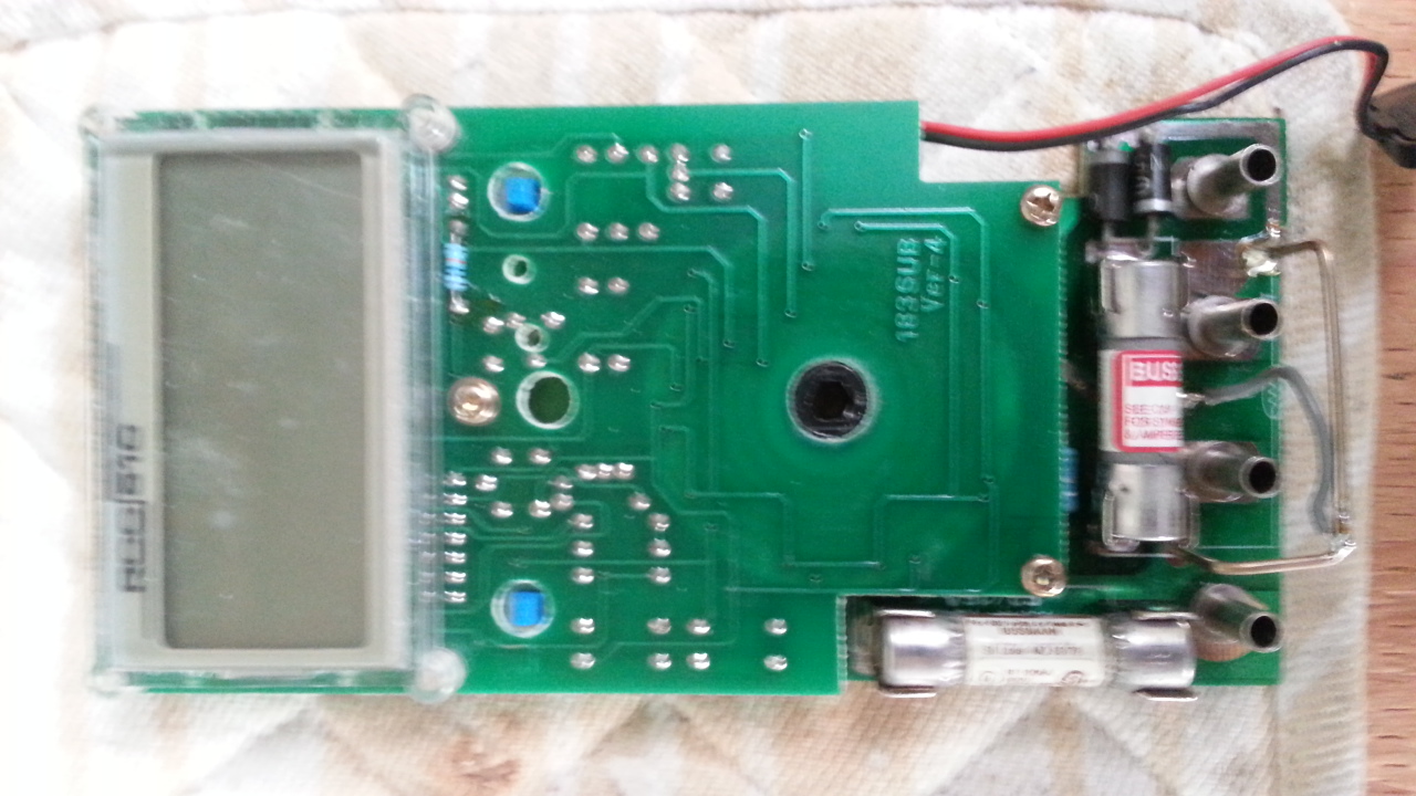

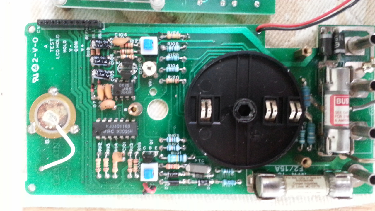

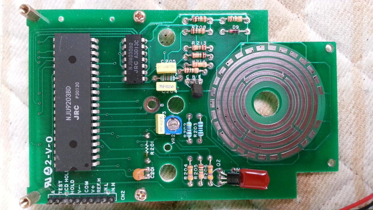

              RCC510 (Fine Instruments Model 183) disassembly for your perusal...
              Quality looks ok to me but the rear shield is connected to the ground with a spring which may or may not be making a good enough contact.
              What you think ?
                Re: Is There Some Earthly Reason my Meter Can't Read Vsc and -Vy ???
                Well, the HRC fuses are a pleasant surprise. The ground tag is important for the shielding. If it is not making proper contact that would explain your issue.
                • mmartell
                  • Oct 2013
                  • 3189
                  Yes that's why I mentioned it in light of what you had said previously. Maybe I will solder a wire directly to the two surfaces or is the distance between the two critical ?
                    Absolutely.
                    Those Bussman are the same fuses found in Fluke meters. They are anywhere between $5 and $10 each.
                      I would just extend the spring a little bit and clean both the spring and contact area with some IPA.
                      BTW, in your picture, the rotary switch shows some sort of potential conductive debris/carbon (circled in red). You can clean it with a toothbrush and IPA. They may cause problems in the future like this modemhead blog post.
                      http://mrmodemhead.com/blog/fluke-83-iii-rotary-switch/
                        I did lengthen the spring and clean the rotary switch contacts while I was in there. The spring however is a PIA as it is prone to fall out of its place if not extremely careful during reassembly. Maybe it should be tacked on the backside to the shielding plate. Will update when I do a measurement with floating ground to see if it has improved.

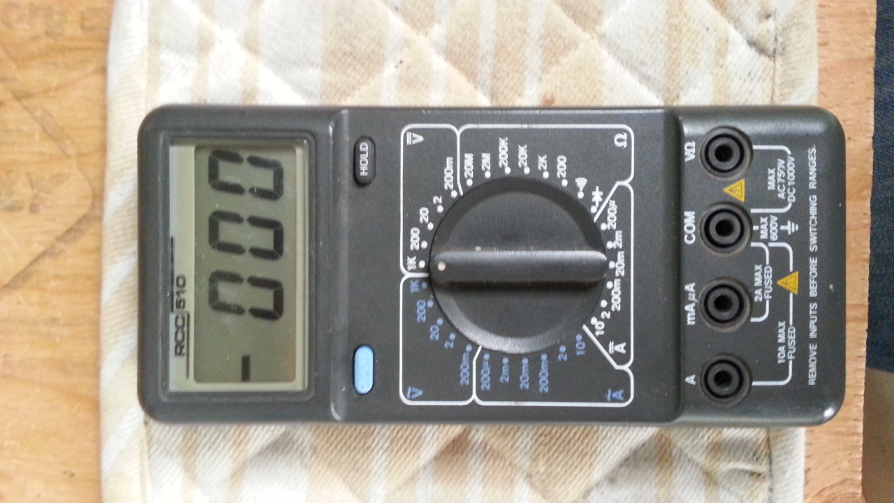

                          I made a Vsc measurement tonight on an LG plasma and I swear I saw a proper reading briefly before the display quickly switched to the nonsense reading I'm used to. There may be something wrong with this meter internally. May investigate further later on but as for now another meter is on the way and there are things needing repair !
