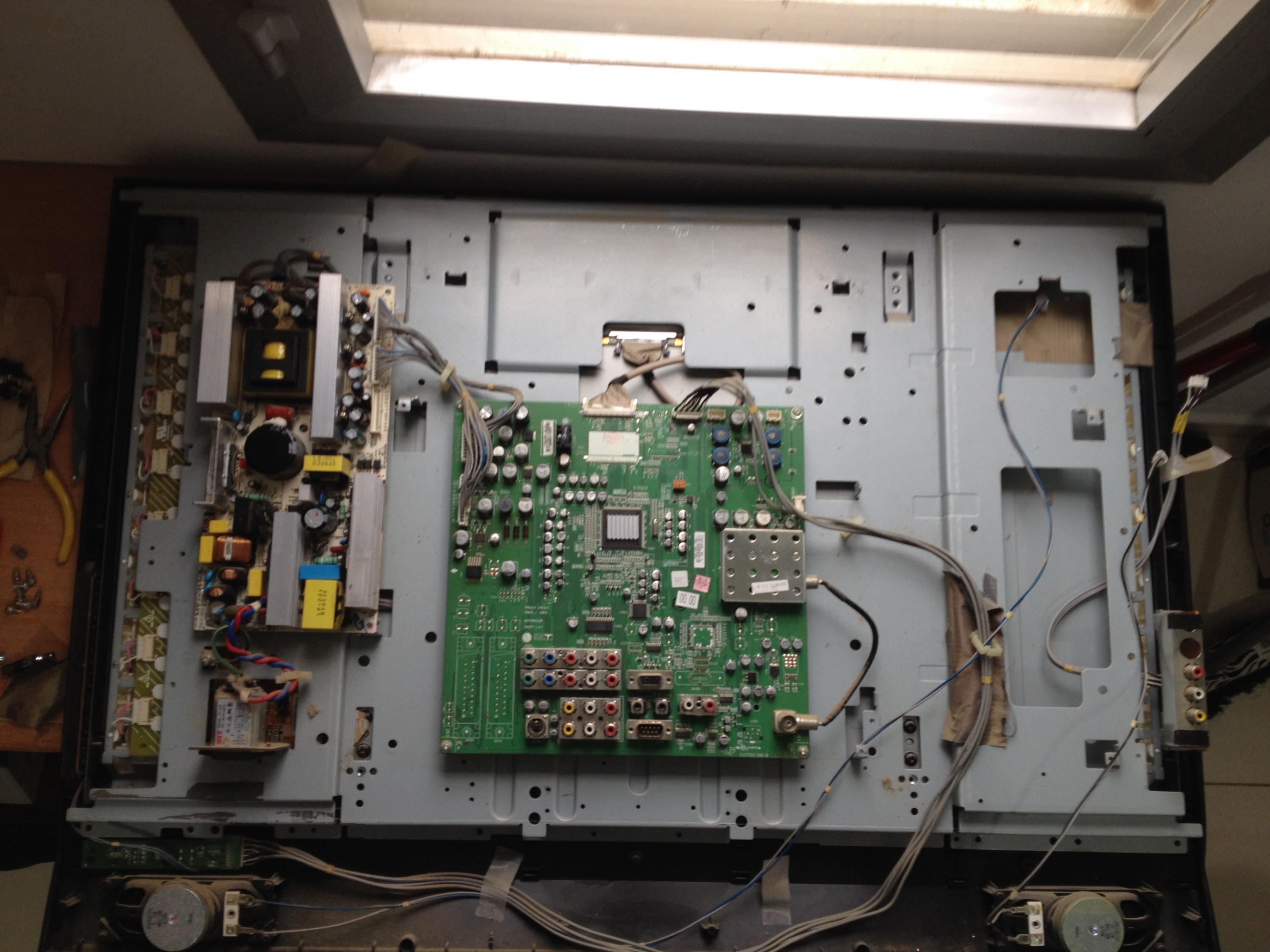

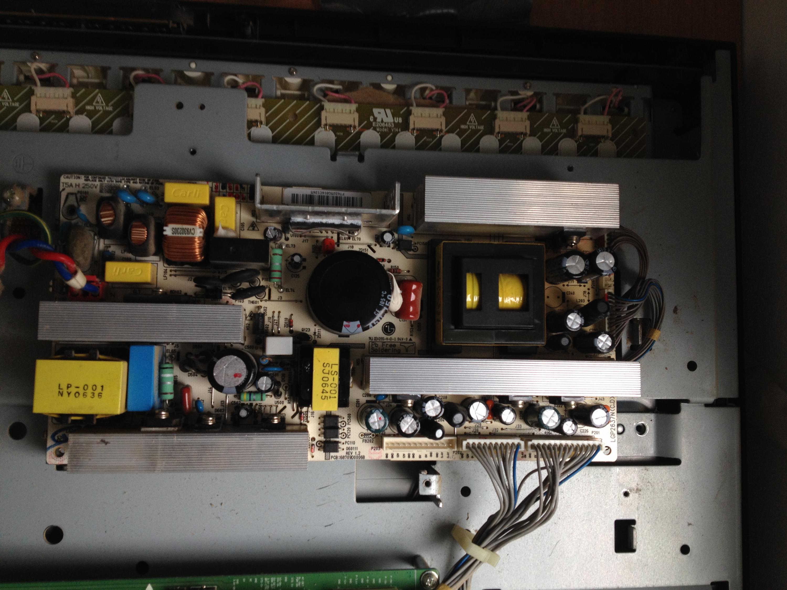

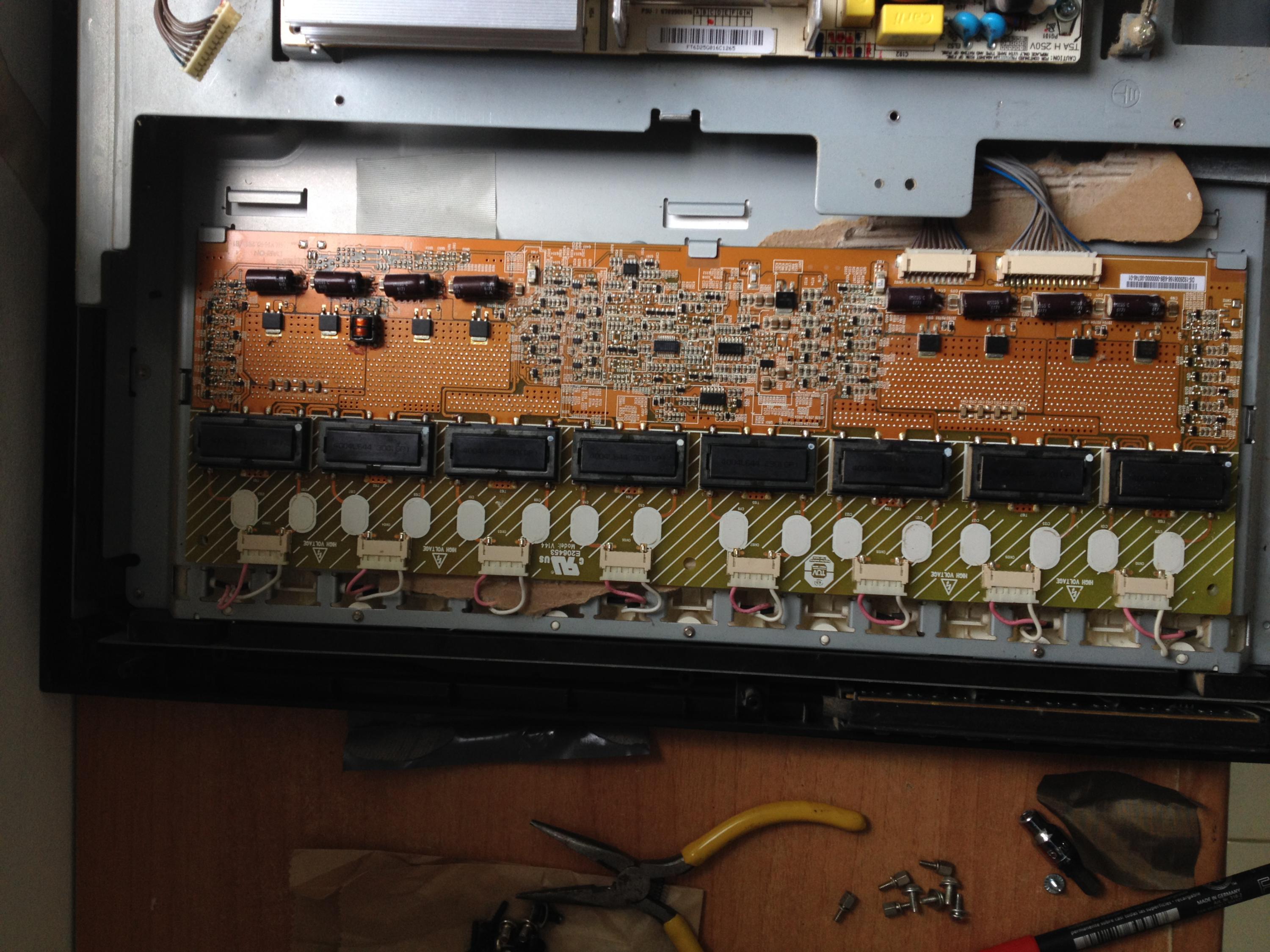

    Hey friends,
    I need your help on this one,
    The TV powers on, but got no backlight and had strong hissing noise.
    Replaced almost all of the caps on the PSU.
    Hissing noise stopped :-), but still got no backlight.
    TV remote is working, i didn't check for sound but im pretty sure it's working.
    Checked Inverterboard, the white rubber spacers melted down, all the inverted was full of with goo (front and back!).
    Tried my best to clean it with alcohol, tested the 8 220uf caps, all were good (capacitance and ESR), all smd fuses were good.
    Plugged in and tested it in the dark:
    As soon as it powers on i can see that i have backlight for a sec then powers off again.
    I tested voltages and i can see 25vdc going from the psu to the inverter.
    I think it goes to protection mode as bulbs or transforms are bad... or maybe i have another fault with the psu...
    Re: LG 32LC2R-CJ No Backlight
    The resistance testing on the secondary side of the inverter transformers are good?
      Hi budm,
      I wanted to test the transformers, but i dont have a lopt ring tester.
      some resistance testing refrence would be much appriciated!

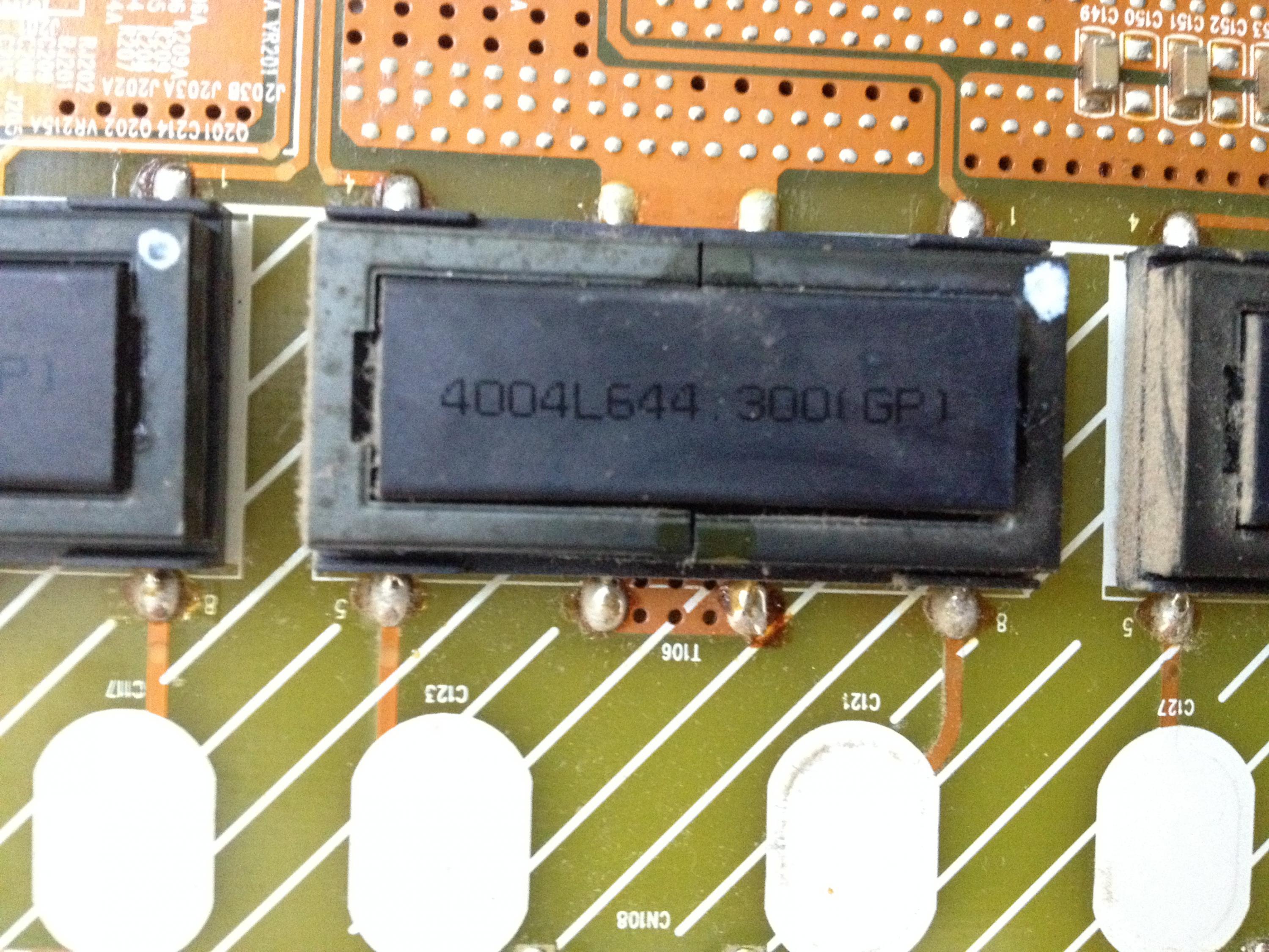

        What are the part numbers on the gray oblong transformers on the inverter board
        • s_henya
          • Jan 2011
          • 483
          • Israel
          i will report the numbers and add a better picture
          as soon as i get home...
          • s_henya
            • Jan 2011
            • 483
            • Israel

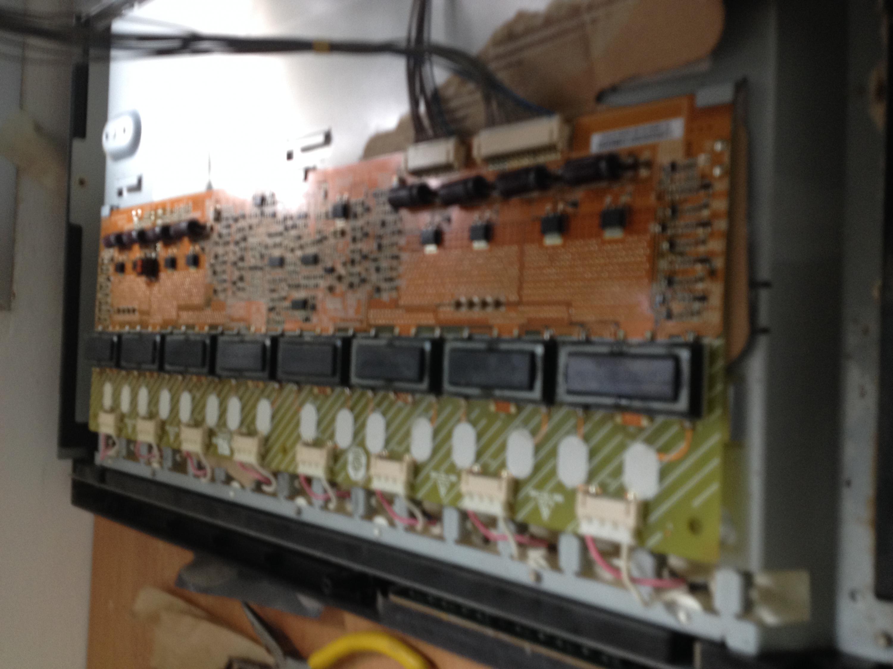

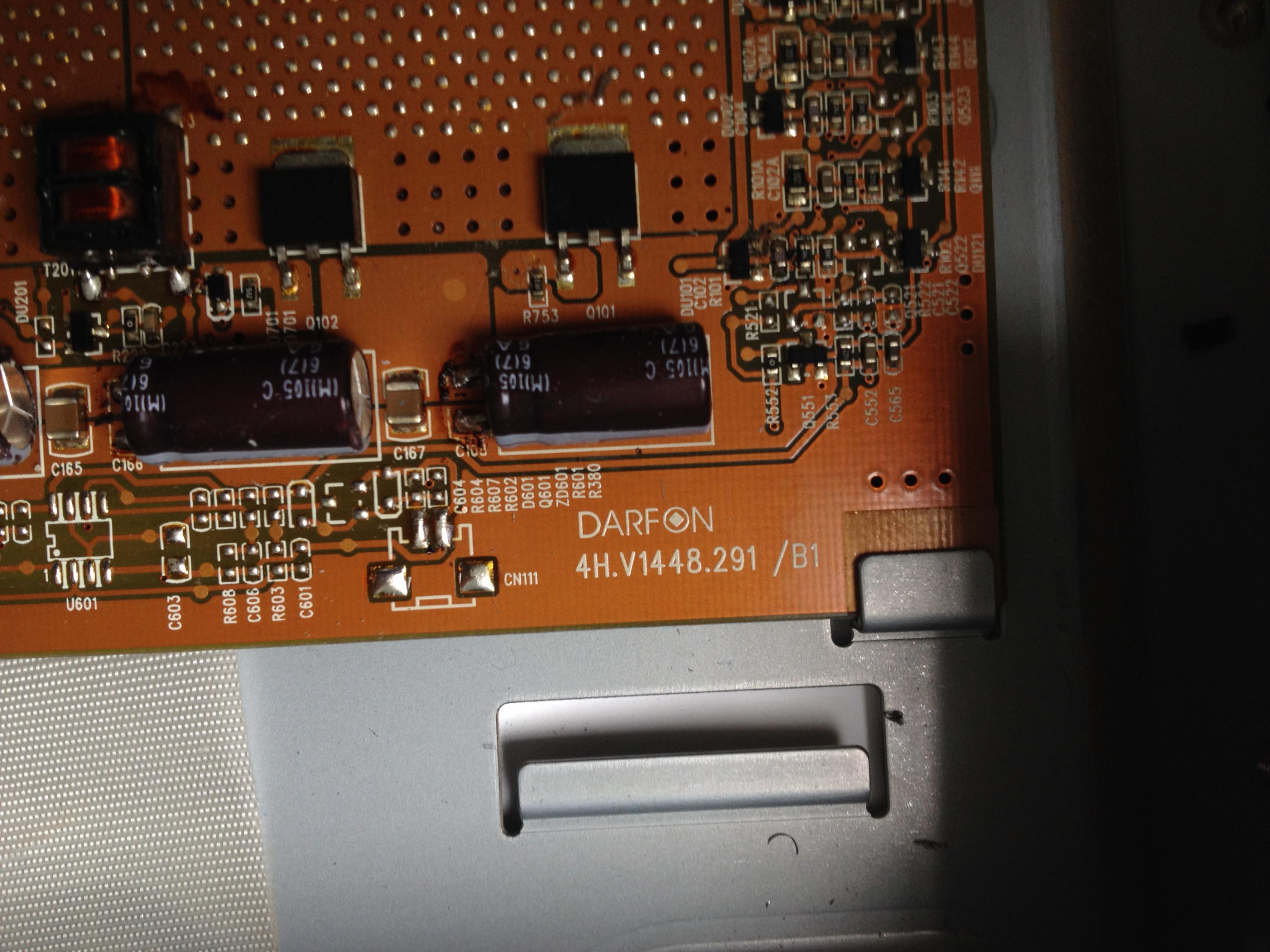

            As requested another picture of the inverter, it's model and
            the transformer: 4004L644 300(GP)
            i never checked for transformer resistance, so guidance would be nice,
            identifying the primary and secondary winidings...
            normal resistance for each coil, and testing it in or out the circuit.
                        OK found one bad transformer:
                        secondary on one side got 70kohms instead of 1.4kohm
                        primary was fine 0.6ohm
                        verifyed out of the board too.
                        so i need to serch for a replacement.
                        found some on ebay and aliexpress for about 15$ but i hate ordering and wating about a month for parts.
                        i will search in the local shops although the odds are very low...
                        i will update as soon as i can get a replacement.
                          So...
                          I replaced the transformer, and got progress! i got a picture.
                          the problem is, i can hear some noises, and after some very quick tests no more than 5-10 seconds each.
                          i didn't get a picture everytime.
                          im afraid that i still have some unresolved issues to deal with the psu/inverter.
                          any more guidance?
                          • s_henya
                            • Jan 2011
                            • 483
                            • Israel
                            The hissing is coming out of the inverter or CCFL's
                            In order to test the bulbs, i ordered this CCFL tester,
                            http://www.aliexpress.com/snapshot/6515156861.html
                            As soon as i get it i will update the results..
                            • vinceroger69
                              • Mar 2012
                              • 6714
                              • uk
                              Did you test the new transformer before you fitted it? ive had a brand new one faulty!
                              • s_henya
                                • Jan 2011
                                • 483
                                • Israel
                                The transformer seemed as it was taken out of an inverter (used)
                                i tested the resistance as i did before and it was good.
                                i really don't know why i still have issues as everything looks good.
                                that's why i ordered the tester in order to eliminate CCFL faults.
                                • vinceroger69
                                  • Mar 2012
                                  • 6714
                                  • uk
                                  Hissing does sound like a bad ccfl wiring or mounting point its just which one theres a few in these sets if i remember.
                                  • s_henya
                                    • Jan 2011
                                    • 483
                                    • Israel
                                    Finally had some time to do some more testing..
                                    Soldeired all the inverter transformers again.
                                    Cleaned some more of the inverter pcb,
                                    Finally found i had a problem with one of the ccfl sockets on the inverter.
                                    Fixed it.
                                    NOW THE TV IS WORKING AGAIN!
