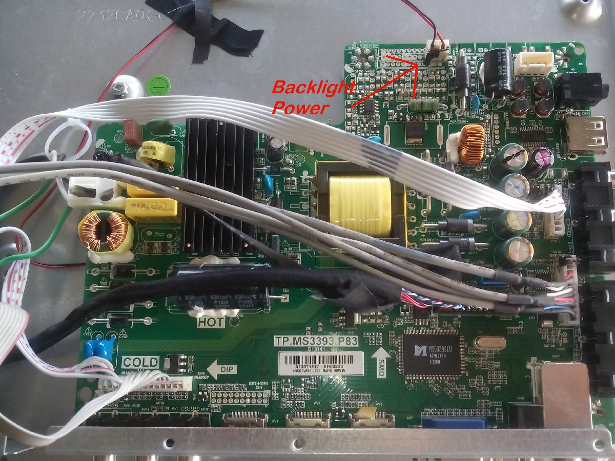

    Rolling with my new found courage to check voltages...
    Proscan PLDV321300.. Once powered up, I see a quick flash of the screen, then it goes dark. Flashlight reveals the image is still there..
    I found where the backlights plug into the main board (the ONLY board)... I put the pictured meter on those connections..
    When probes first applied, I get a reading of around 31v-33v +/- with the TV plugged in..
    Once I push the power button, the voltage spikes to as high as 70v... Then it settles down to around 40v +/- 3 or 4...
    A replacement board is around $45.. Doable.. But if it's possibly a short in the LED strip, a replacement board ain't going to help me..
    Once again, I am hoping that I can find the issue is on the board and not have to fiddle-fart with breaking the unit down to the bare backlights..
    I stand ready to apply my probes...

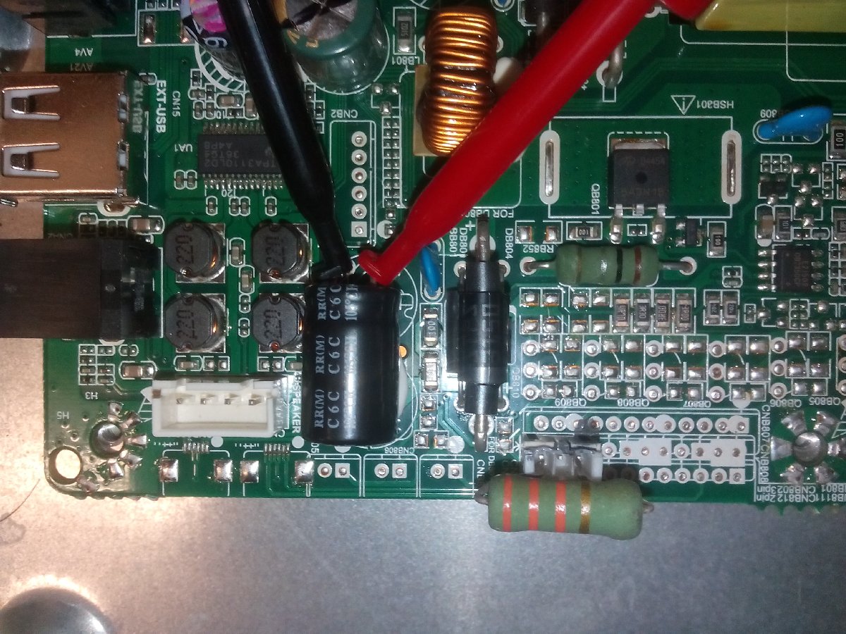

              It looks like simple boost converter with single MOSFET, Inductor, filter cap, current sensing resistor, and one rectifier diode. It's probably does not have open LED detector due to only single string LED but it will have over current protection.
              So remove the LED connector, check the DC Voltage on that filter cap's legs laying on its side to see what you get.

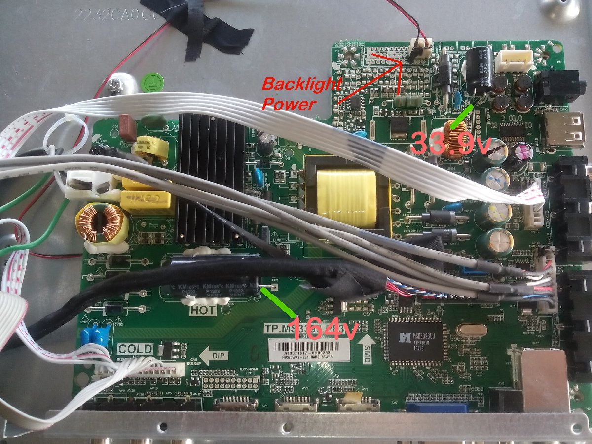

                    Re: Proscan PLDV321300 Quick Flash Then Dark
                    OK, with the LED Connector unplugged...
                    I get 33.9v +/- on the small cap right by the LED Connector...
                    And I get 164v +/- on the large cap at the bottom of the pic...
                      with the backlight plugged in, do you get the 33.9V, or does it go away?
                        "I get 33.9v +/- on the small cap right by the LED Connector..." So it did not jump up higher than that when power switch is activated?
