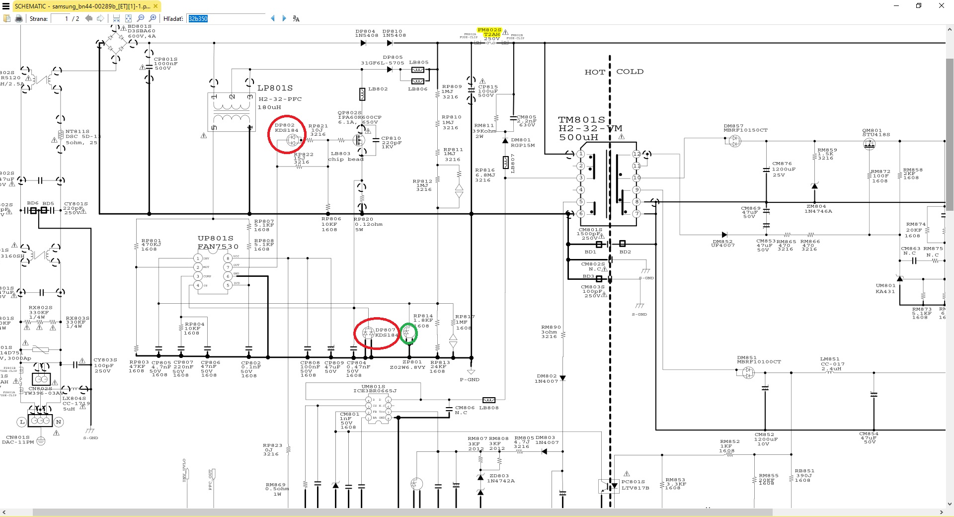

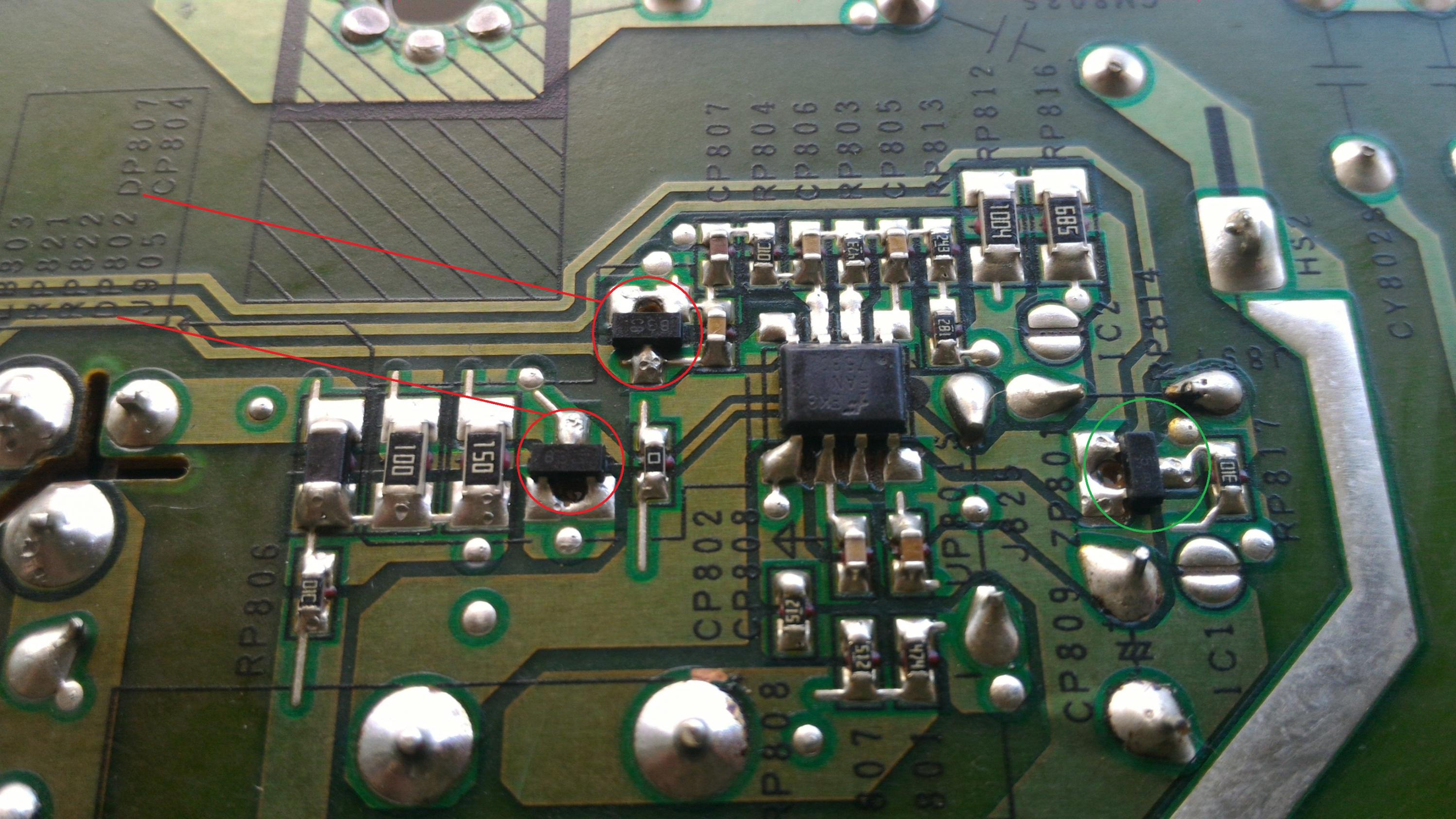

                                        Need advice : I found two diodes on the other side of board, they measured results are strange to me, look at picture
                                        DP802 = KDS184 24mV 26 Ohm both sides!!! (ok they are probably good they have low resistor connected paralel)
                                        DP807 = KDS184 2mV 1.4 Ohm both sides!!! (ok they are probably good they have low resistor connected paralel)
                                        compared to
                                        ZP801 = Z02W6.8VY 534mV PN 25.5 KOhm, which is zener, but seems for me good
                                        I have not much skill in desoldering smds, before I try could you confirm me to continue or search for problem elsewhere?
                                        I dont know how to measure the mosfet, I post mmy results for QP802 = IPA60R600CP 6.1A 650V
                                        tested like diode
                                        pin 1 - 2 = 1726 mV NP
                                        pin 1 - 3 = 1545 mV NP
                                        pin 1 - 3 = 450mV PN
                                        pin 3 - 2 = 485mV PN
                                        pin 1-3 even 3-1 = 8.4 KOhm
                                        could the mosfet bad?
