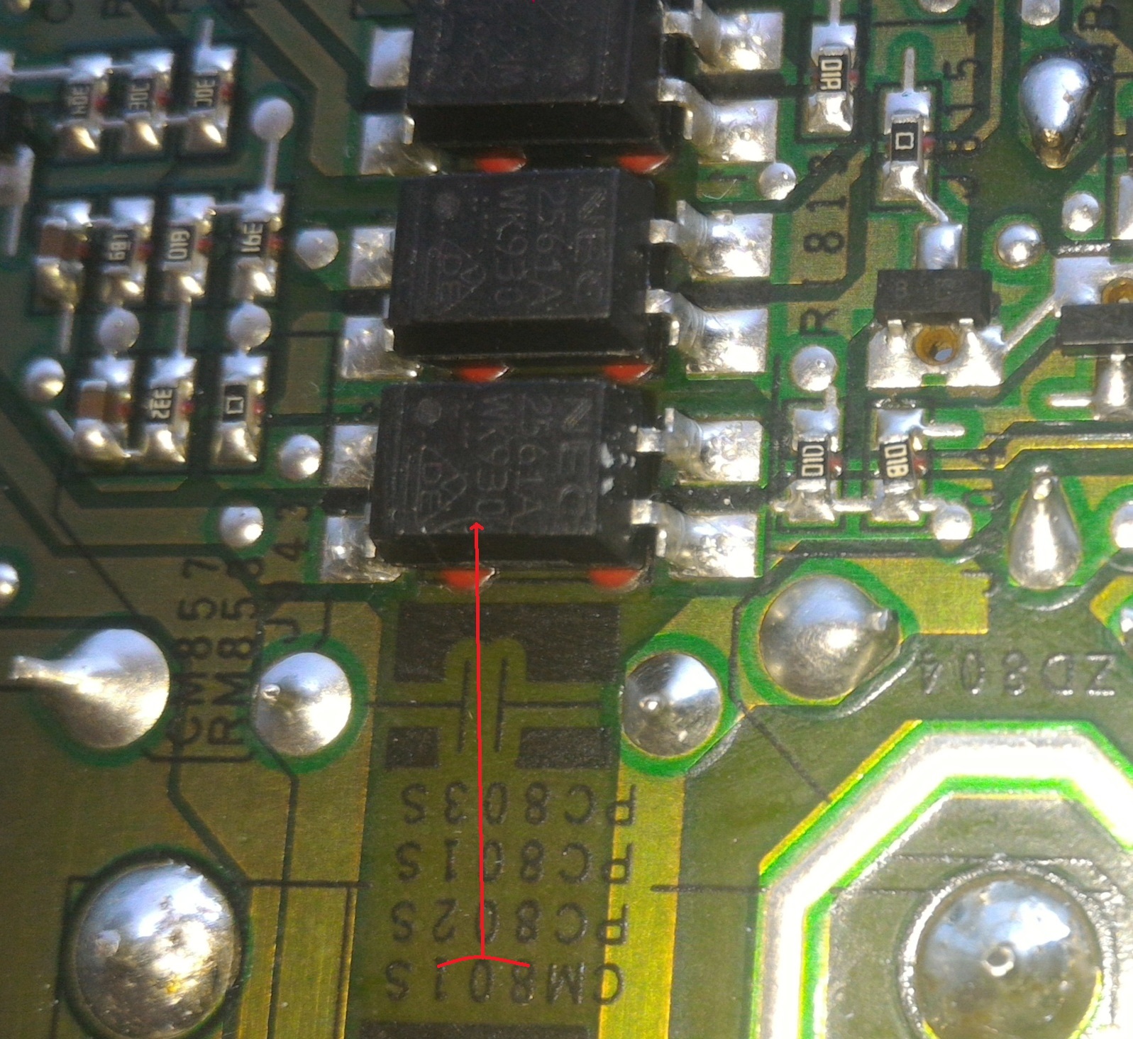

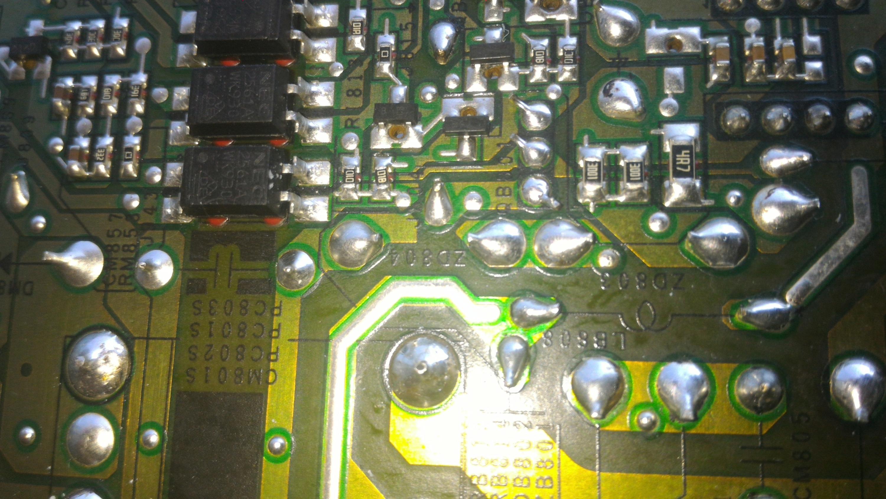

                              When I inspected the other side of the circuit board where are smd parts I found out a little crack (not 100% sure if it is crack, but on the other two parts there is no so crack) on one part PC802S = NEC 2561A which seems to be PHOTOCOUPLER? (I don't know nothing about it), could someone tell me how to check it and what does the PHOTOCOUPLER, or tell me if I should search there for my tv problem?

                                #55
                                Re: Samsung LA32B350F no backlight
                                changed the CP809 = 47uF 50V and here are my new measurement
                                1. Power On/Off = 0.77V when stand by
                                1. Power On/Off = 0.01V when powered on
                                2. 5.3V = 5.14V when stand by
                                2. 5.3V = 5.15V when powered on
                                3. GND
                                4. 13V = 12.93V when stand by
                                4. 13V = 13.04V when powered on
                                5. GND
                                6. GND
                                7. 5.3V = 5.14V when stand by
                                7. 5.3V = 5.15V when powered on
                                8. 5.3V = 5.14V when stand by
                                8. 5.3V = 5.15V when powered on
                                9. GND
                                10. 13V = 12.93V when stand by
                                10. 13V = 13.04V when powered on
                                11. 13V = 12.93V when stand by
                                11. 13V = 13.04V when powered on
                                12. InverterOn/Off 4.75V when stand by
                                12. InverterOn/Off 0V when powered on
                                13. E-PWM 2.16V when stand by
                                13. E-PWM 0V when powered on
                                14. DET_5V = 2.44V when stand by
                                14. DET_5V = 0V when powered on
                                15. Sync 0V
                                16. GND
                                on big filtering capacitor i measure 396V when stand by -313V when powered on
                                also changed the schematic to this one:
                                https://www.badcaps.net/forum/attach...7&d=1343456910
                                could be the 5.3V compared to my 5.15V too low?
