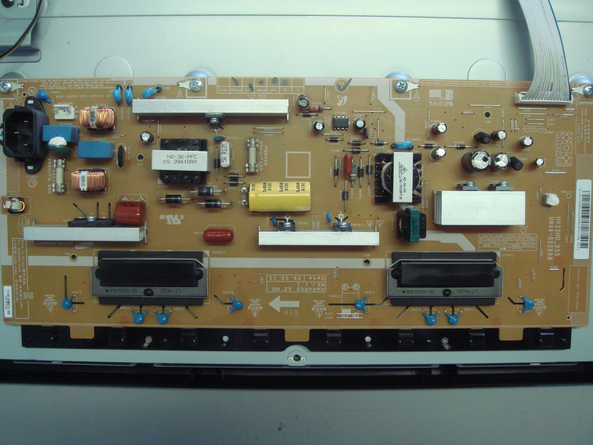

    Hi Guys,
    First post so be gentle with me. Samsung 32inch LCD with no backlighting. Power supply board is a BN44-00289B.
    Plugging in AC supply, the stby light is lit solid. Power on the TV and Stby light flashes 5 times and then extinguishes with audio welcome tone from speakers. Watched the screen in a darkened room and no flashes from CCFL's. Used the flashlight trick and can see menu when selected. LCD panel appears good with no cracks visible.

    "PWR on/off 0.01 0.766" This one does not look right.
    Check the DC Voltage right at the TWO LEGS of that yellow main filter cap to see what you have, it should be >360VDC.
    Do not touch any thing with your hands or body, you are working in the primary hot deadly side of the circuits.

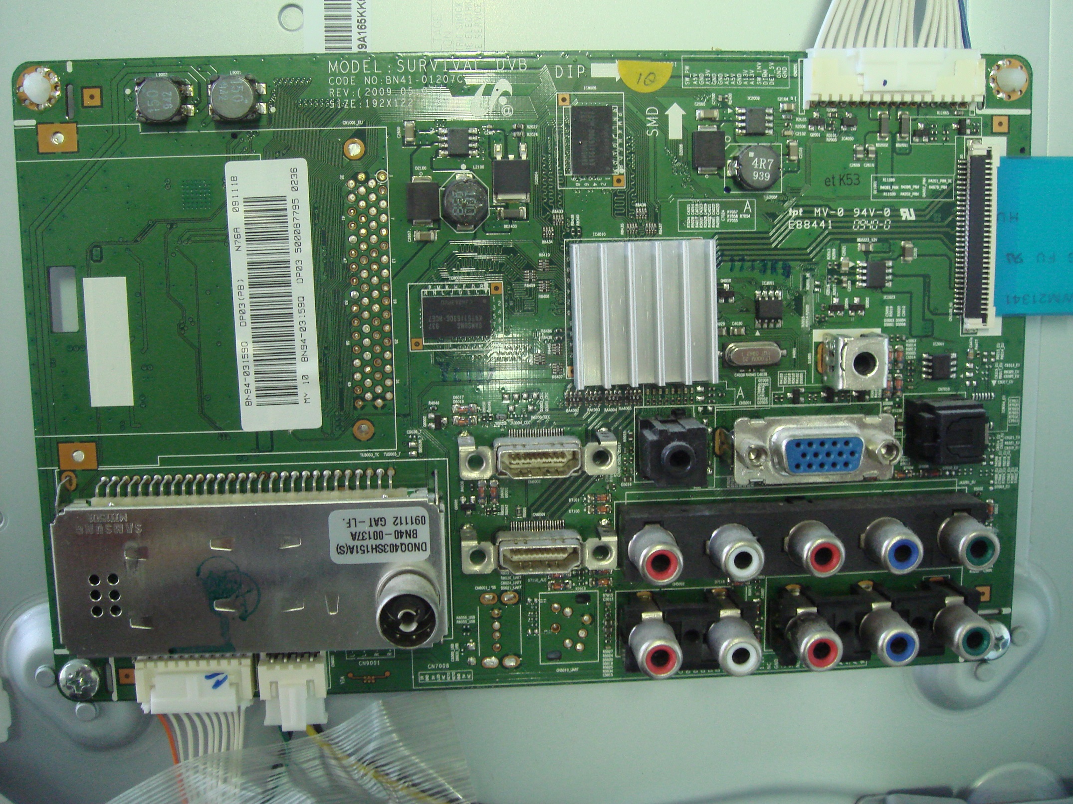

      And a nice pic of the main board please.

        Back again,
        Voltage on the yellow cap (listed as main cap in first post) 331 VDC standby mode and 326 in power on mode. Confirmed the power on/off switches to 0.766 measured at pin 1 of plug CN802 with all cables connected.
        Pic of main board attached.

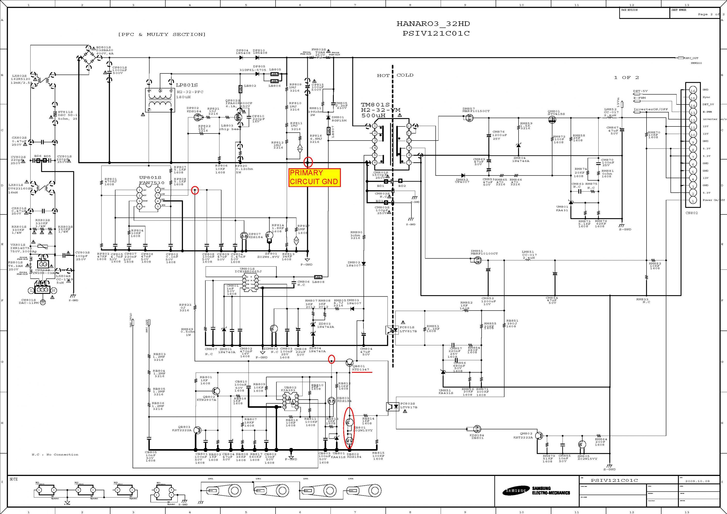

                                @beechman35, Please check the Voltage at the Emitter and Primary circuit GND of QB801, at the Base and Primary circuit GND. You may have leaky ZB801 or bad PFC IC controller.
                                  Re: Samsung LA32B350F no backlight
                                  Hi Bud, First off, let me thank you for your efforts on this. As we all know sometimes it just might not be worth fixing something on a commercial basis, but now I just want to know what the hell is wrong for my own personal benefit. OK, the results. PS board installed, all wiring intact. turn on TV, get the welcome audio and then measure the voltages. Collector of QB801 has 18.2 volts, base has 0.5 volts and emitter has0.6 volts. PS board removed and Zb801 checked in circuit and no apparent leakage. Removed QB801, tests normal so refitted. Removed RP823 (zero ohm) resister and powered board up again, no change in voltage at emitter.
                                  Looks to me to be around the dual op amp UB802 if its output to QB802 is telling it to limit base voltage to QB801.
                                  Can you briefly describe the purpose/ops of this circuit, I am assuming its looking at output of the PFC and regulating same?
                                    OK, I need more Voltage and resistance testing. Right now the QB801 is not turned to supply the Voltage to run PFC IC or the dual op-amp UB802 (and latching circuits (QB802, 803) which monitors the PFC output Voltage to see if it goes too high and also detect UV (Under Voltage) INVERTER circuit.
                                    But since there is no Voltage out put of the 15V linear regulator to run the UB802 is not functioning until you get 15 at the Emitter of QB801.
