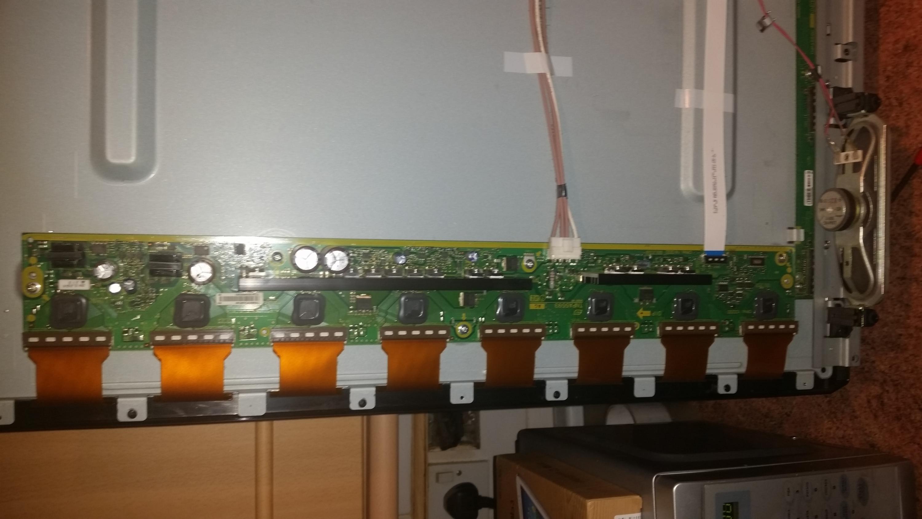

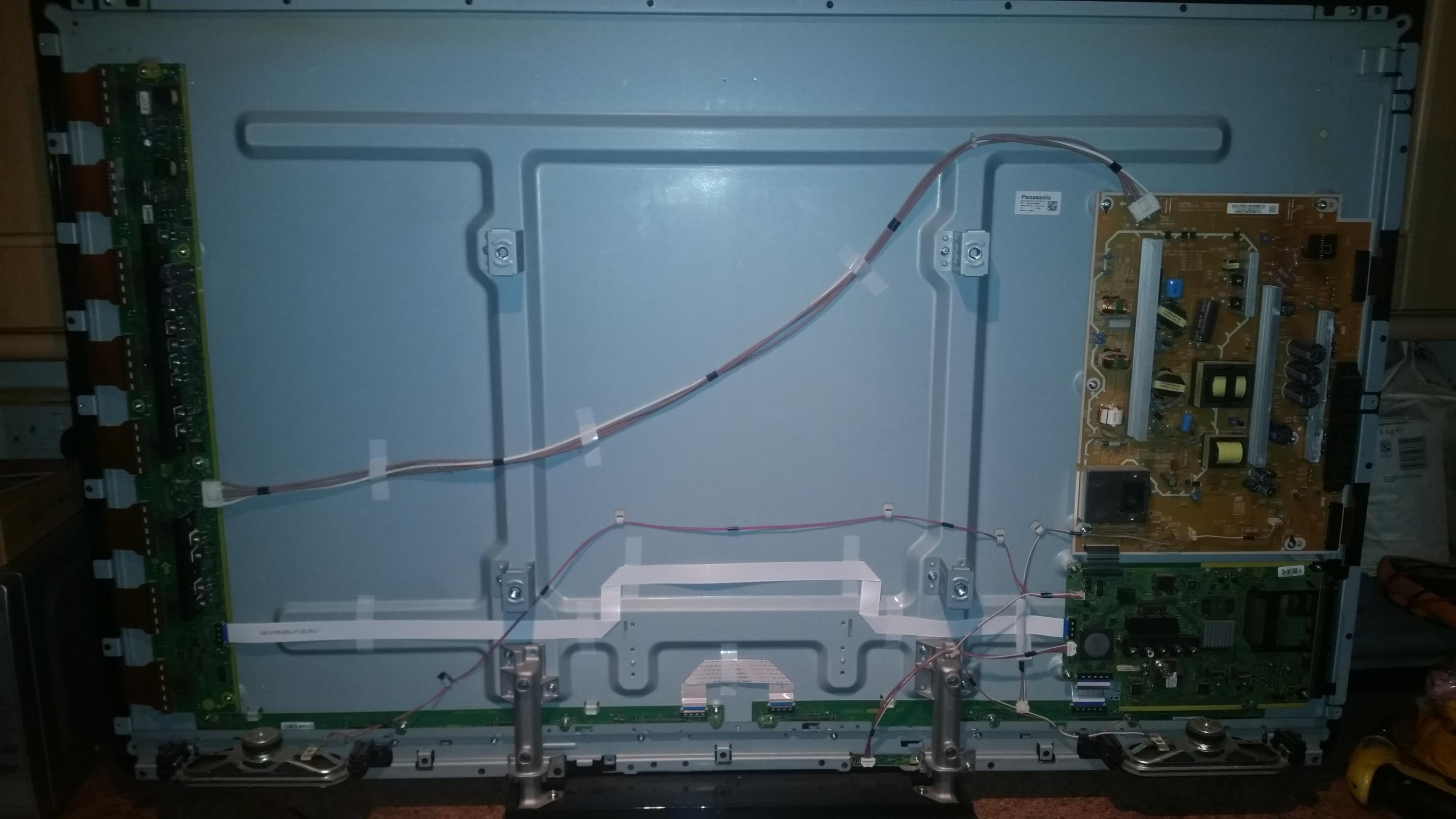

                Have same set , my problem is 7 blinking lights , could it still be the TCZAA6755U chip,
                i have 5v on jp67 but there appears to be no readings on jp79 or jp82
                does this point to the vsus board or still psu
                how do i ensure vsus board is discharged before looking at it ,
                i have looked round the fets and there seems to be a few heat affected solder joints on the pins of one or two of them q601 and q401
                does the white ribbon cable and screen ribbon cables just require gently pulling out or are there clips
                thanks

                  Re: panasonic tx-p50x50b
                  thanks
                  for the ribbons you need to lift the latch, then gently pull out, for the SN20, lift latch and if you lift the ribbon it should just come out. there's a couple of tabs on the sides of that one.
                  7 blink normally would be SN board I'd expect. The 6755U IC is more to do with a dead set, no standby voltage, no life at all. You don't have that problem if 5v is present and you have error blinks.
                  Not sure what goes on these, if you have a meter check the heatsinked transistors for shorts.

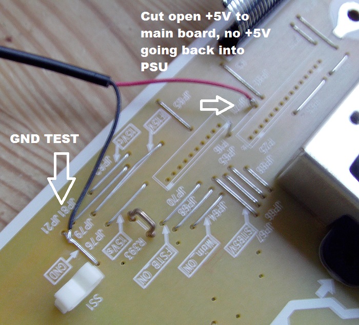

                    drussel, when you say to ground the external source on the PSU output
                    connector, which do you mean? I just attached the external GND to the
                    GND-test point on the PSU. (Please see attached image below)
                    All I get is three flashes, over and over
                    Thanks,
                    Nicholas
                      The stby supply also supplies unregulated output Vcc to the PFC and main converter. No Vcc, and you'll get an error code.

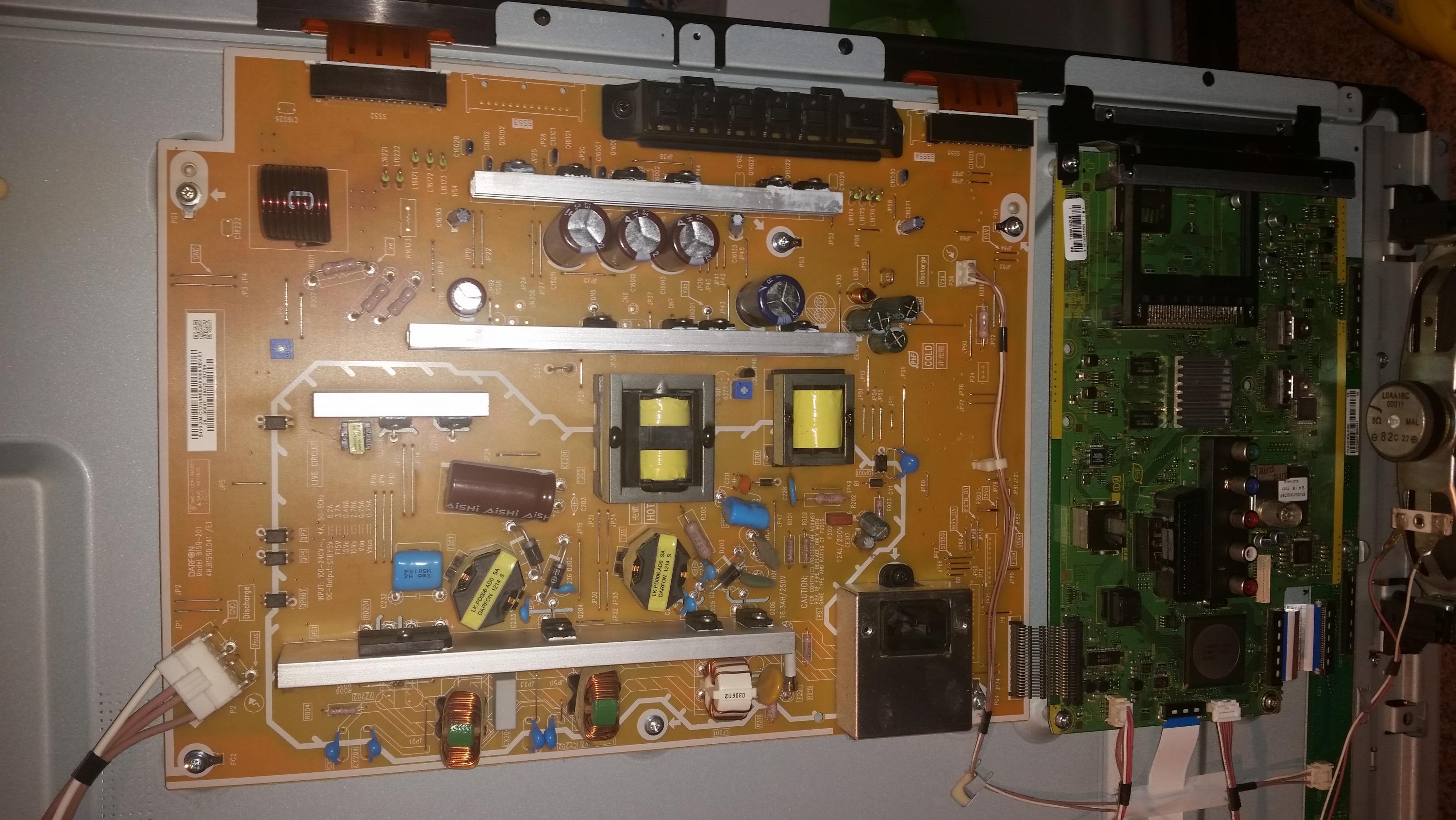

                        where can i measure that , is it marked vcc on psu board
                        does anyone have a circuit for this tv ?

                          In my picture above I have cut the jumper so the +5V standby only goes out, not
                          back in. Is that wrong?

                            In your other post you mentioned that B159-201 is printed on the board. Attach is circuit diagram for the B159-201 board
                              Vcc is not marked, but will come off the standby transformer. Also, the 15V is probably generated by the standby transformer too.

                                    Update on issues with 7 blinks , having found a panasonic guide for another plasma model i did some checks and found by disconnecting S20 connector the light on front flashes green , then goes solid green , short while after i hear what i presume is a relay click and the light blinks red 7 times , i presume in response to the fact i have S20 disconnected
                                    If i take the power feed to the bottom board as well the light remains green
                                    Is this indicating the panel is faulty or does the fault lie solely on the ysus board where the s20 connector is ?
                                    I cannot find any obvious shorts when testing igbt's with meter and peak dca tester the only odd reading i get is when measuring the power diodes where it appears to be dead short across the two anode pins , are they connected together to cope with power ? cant find any datasheets on them or the igbt's
                                        A separate thread would have been nice to start.
                                        The board should have connectors marked SN2, SN20 and this board is known as the SN board in panasonic speak. It's a combined SC,SD,SU board all in one.
                                        So equivalent to a ysus+upper/lower buffer boards.
                                        Anode-Anode will show short.
                                        If none of the heatsinked components are showing short, have you checked also those large SMD diodes DAF30A? center pin to both outer for short.
                                        If still nothing found on that board next to the SN22 panel ribbon connector there is a test pad VFG & VFO. Check resistance between those and vfg - vf5v
