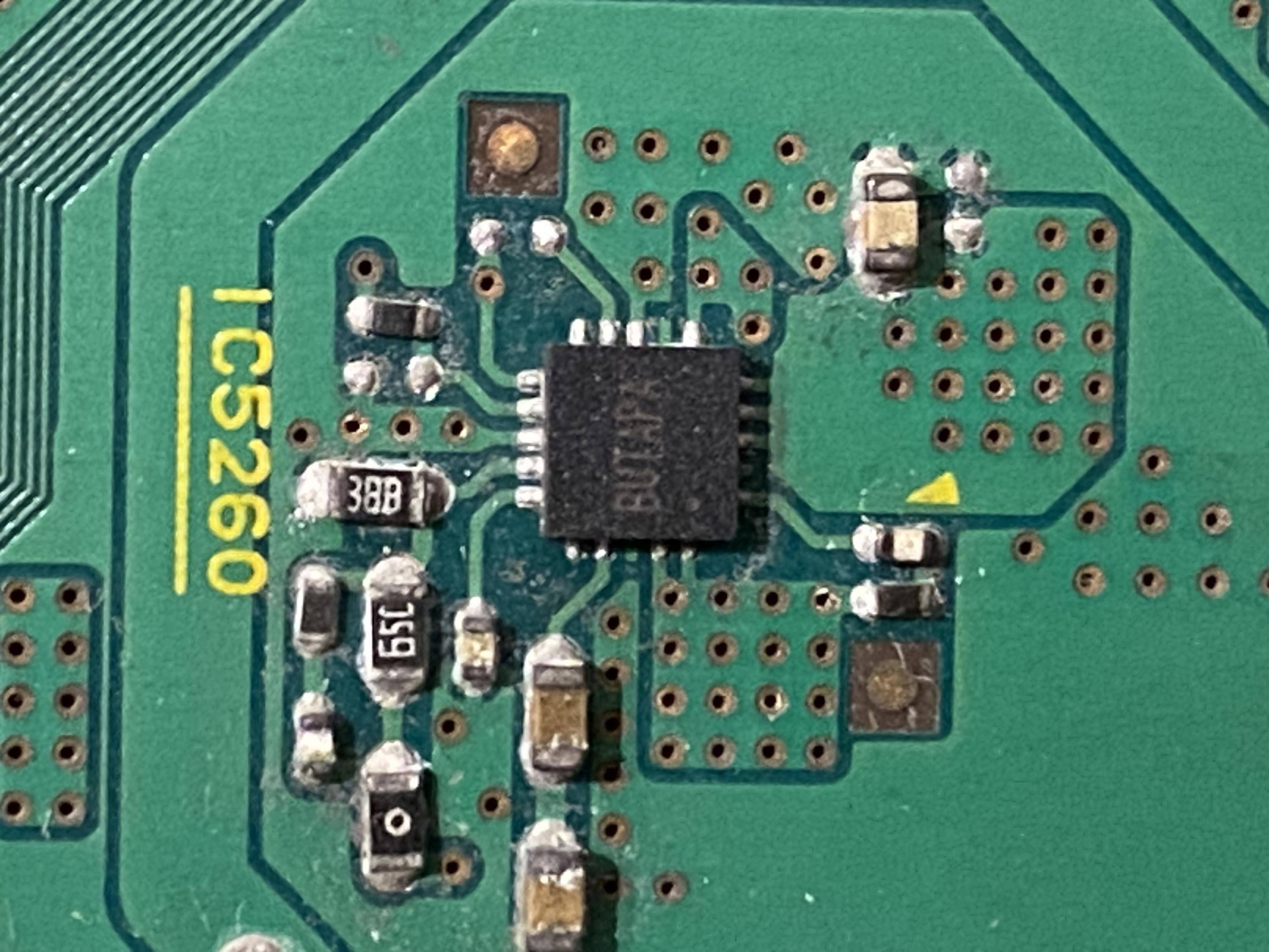

    Hello
    I haav a Panasonic TV model TX-65FX623E which dosn't show any picture. The backlight is on.
    Upon testing the T-con i couldn't find the 12v at fuse, the fuse is ok.
    I traced it back to the main bord and the QFN25 buck IC responsible for generating the 12v is in the pic below with marking BUTAPA. No shorts where detected and the IC is not heating. Input of 16v is there, and 3v on another pin which i presume is enable signal.
    Cant find any data or schematics for further troubleshoting.
    Any ideas or if anybody came across this buck converter IC and can share would be much appreciated. The main bord model is TNPH1196.
    Best regards.

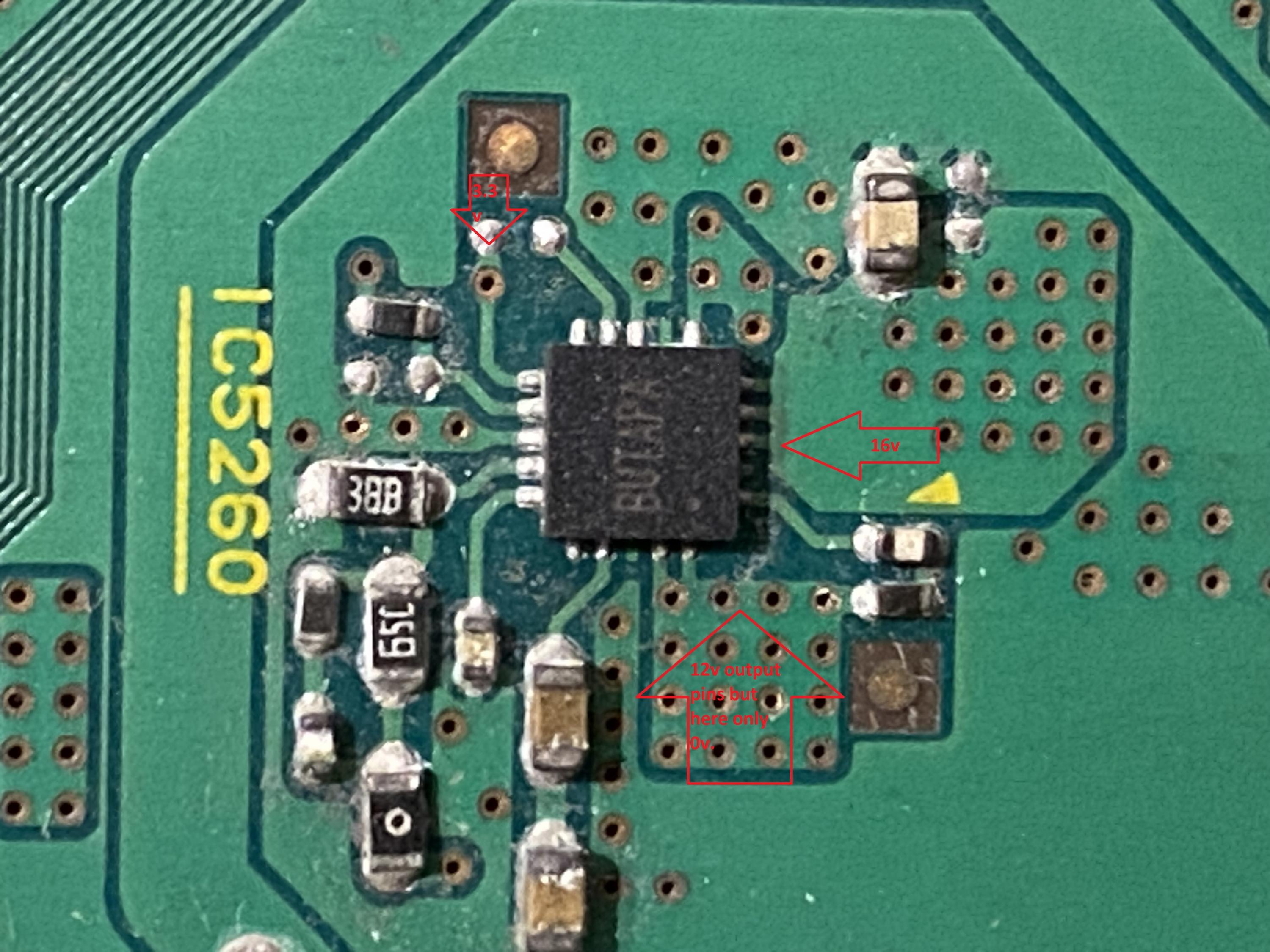

    Re: Panasonic TX-65FX623E identidy IC.
    Anoter pic with measured voltages at pins

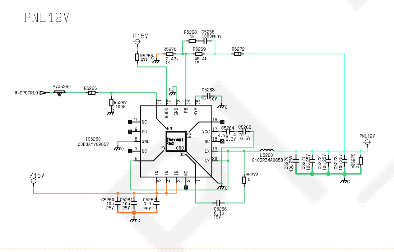

      IC5260 pinout
      The font and markings are very similar to Silergy.

        It looks like a silergy part to me too,but i can`t find it . Here`s a service manual for the Tx-49fxw584 https://www.manualslib.com/download/...-49fxw584.html IC5260 has panny part number C0DBAYY02857
          This could be a special Panasonic order from Silergy.
              the IC are fine... its pin 11 receive I/O from main chips. to switch VCC... there are error come to the main chips or there any other reason with DC/DC or epprom/ emmc
                    By the way. If I’m getting 3v on pin 11 as I mentioned in first post and post two(pic) then it might be wrong voltage? What to expect here? Any data sheets?
                      I/O are bus signal not only current.. i would try to put DC/DC 12V regulator and DIY the chips with In from 15V and the out to pin 19.... then see what the main chip will proceed Video or audio signal as well the t-con & Panel

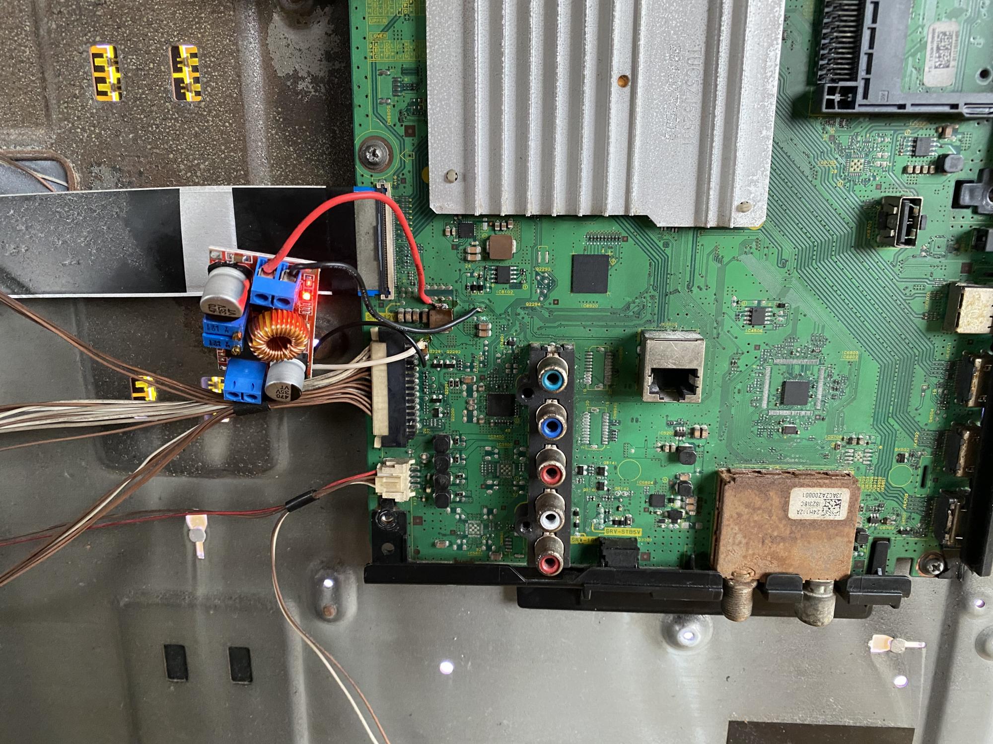

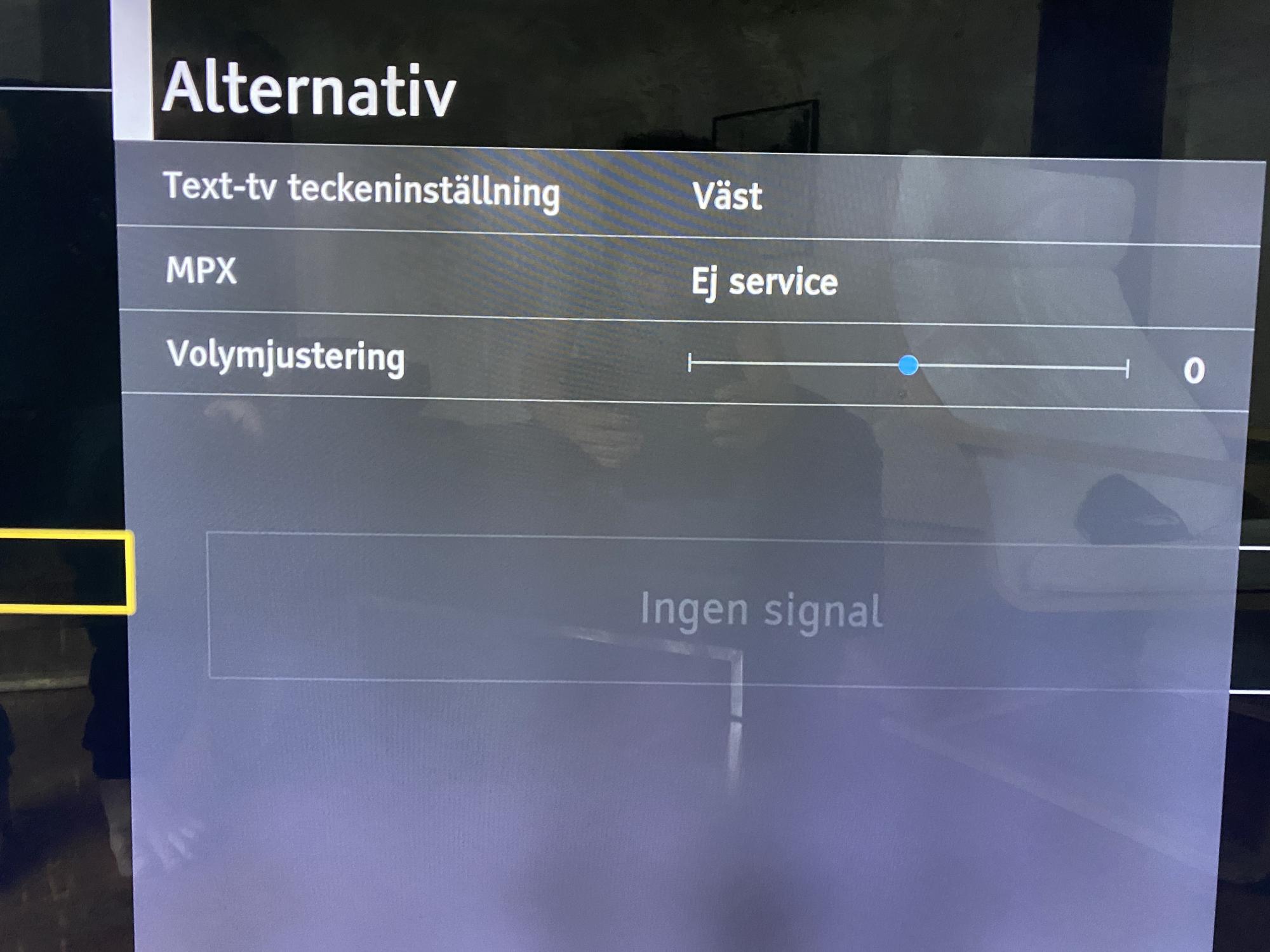

                            Hello again.
                            Injecting 12v using dc-dc buck converter with common GND as of the attached pics. The tv shows steady pic. So it narrows the whole defect to the pwm ic first suspected. The question that remains is whether the IC can be bought, any known vendors that ship to Sweden? All answers would be much appreciated.
                            If anyone have a doner board can send a PM.
                            BR and thanks again to everyone for help.
