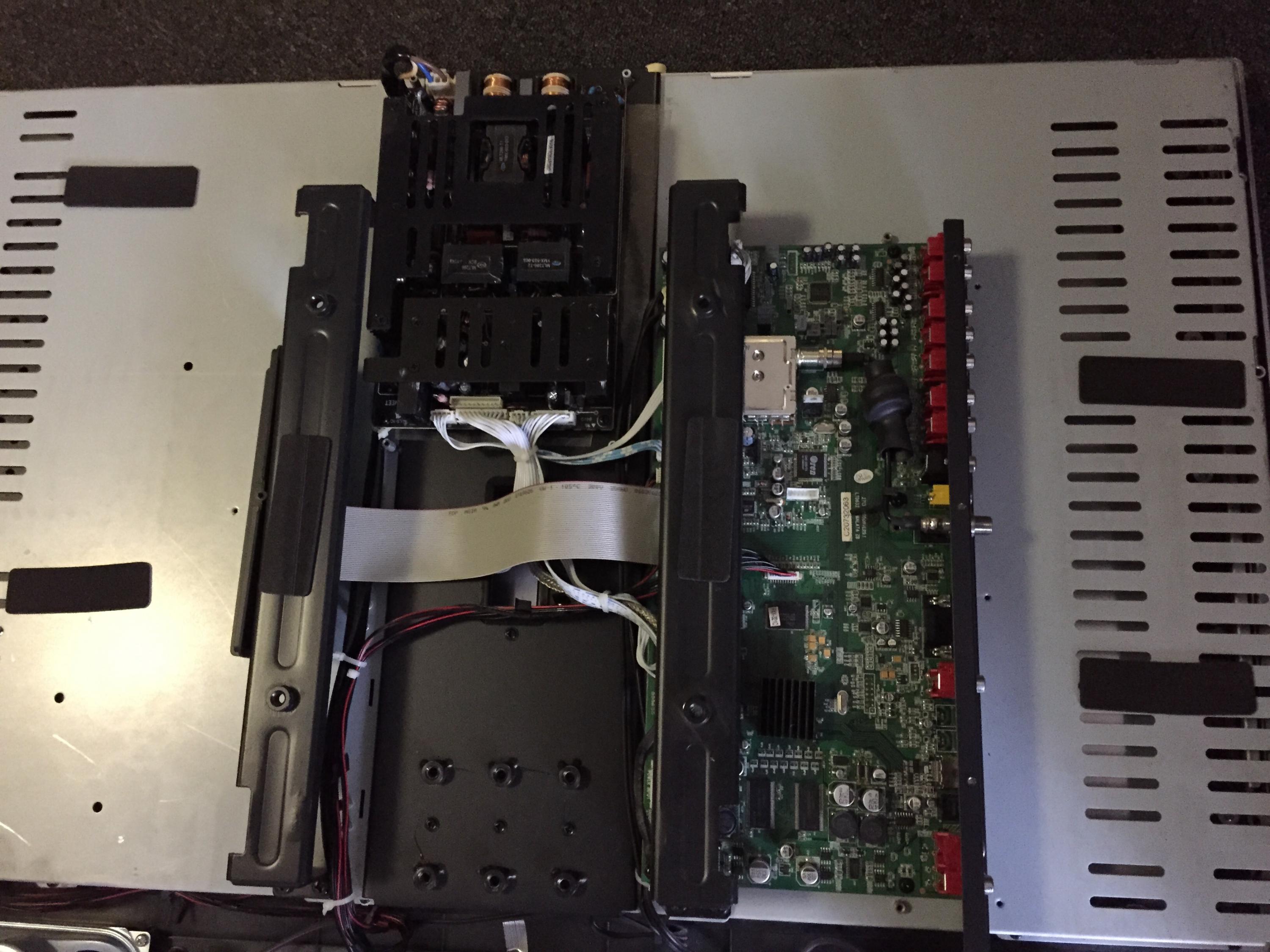

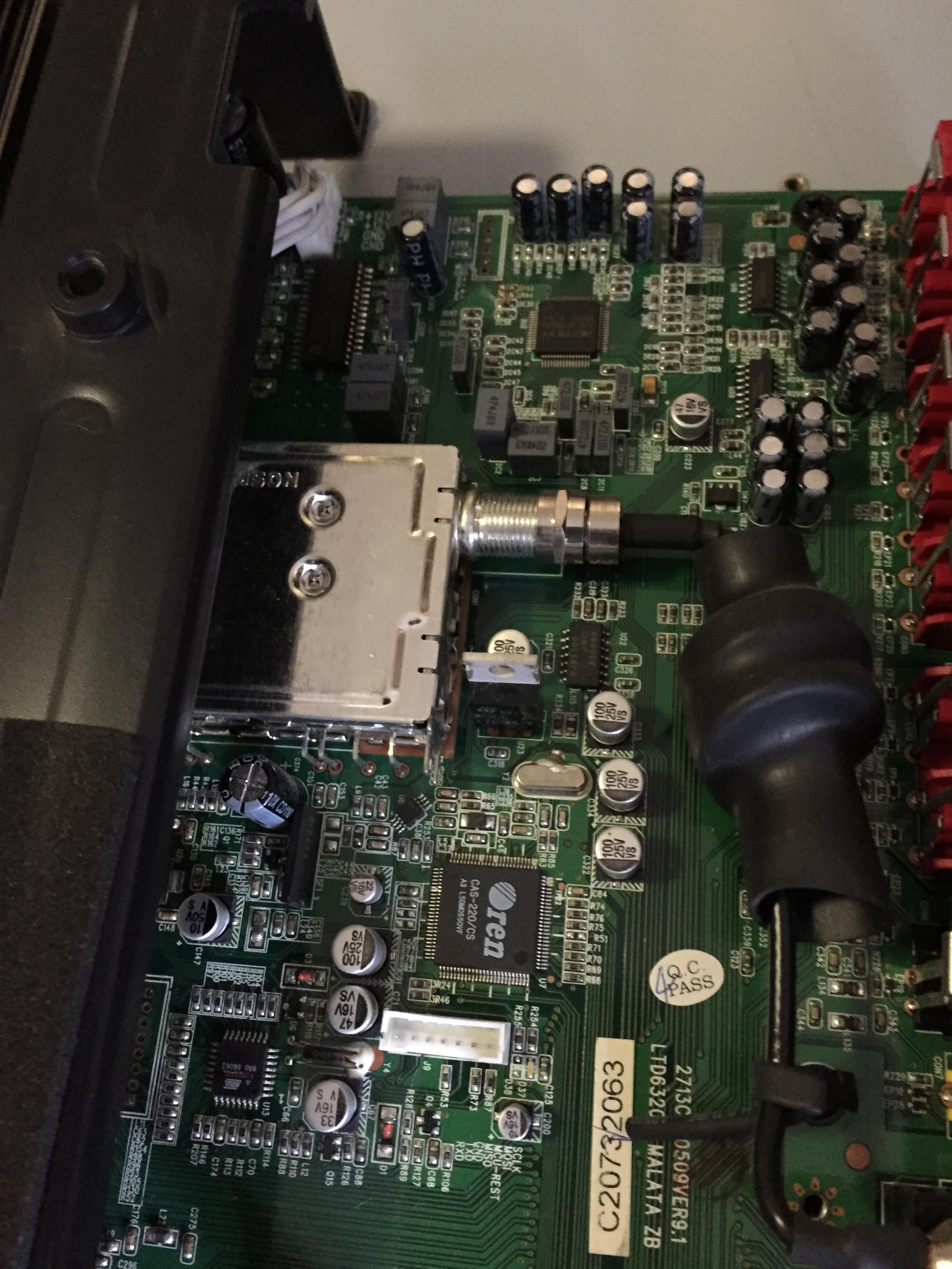

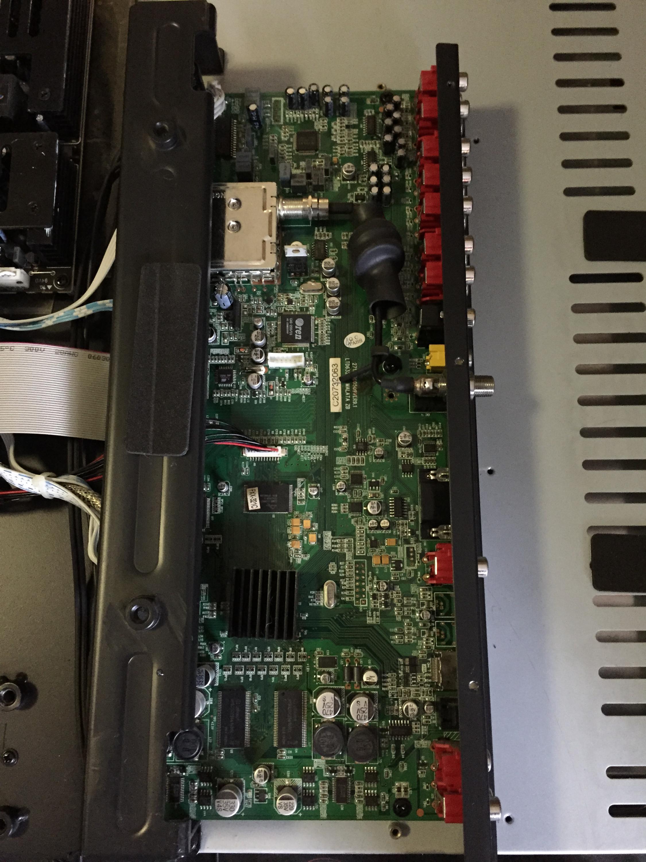

        Here are some pics, I don't really know what I'm looking for here or where to trace power to the tuner?
        Let me know if you need any specific angle or anything that might help

                    Are the main caps rated at 450VDC?
                    The pictures are too dark for me to see the details on the power supply board, if it has PFC, then the DC Voltage should be >360VDC.
                    But since you indicated that it works fine on one of the HDMI, then I doubt that it will be the power supply board.

                        12V output is not tightly regulated power supply because it is for running the Audio amplifier that does not need tightly regulated power to run.
                        I am not sure how much we can do on the main board without the diagram, you may want to do real details visual inspection of the main board both sides to see if it has any sign of damages. My be check the Voltage regulator ICs, ect.

                          you should be able to open the metal can of the tuner. Have a look inside. Maybe you see something. Check that the tuner is actually getting proper power. No power, or not correct power, no tuning. my post #3. Looks like there is a regulator U23 (what is it?) in front of the tuner. May be also that the pins don't make good connection in the RF terminal.
