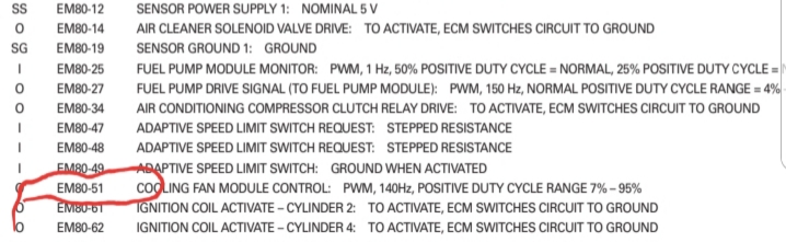

      I should have provided this info in the first post! Actually a Jag Forum member pointed out, I had missed it. It's the operating range for the fan - it's not something I fully understand. 140hz?
      Pls see photo. It's the EM80-51 line...
      Much much appreciated!

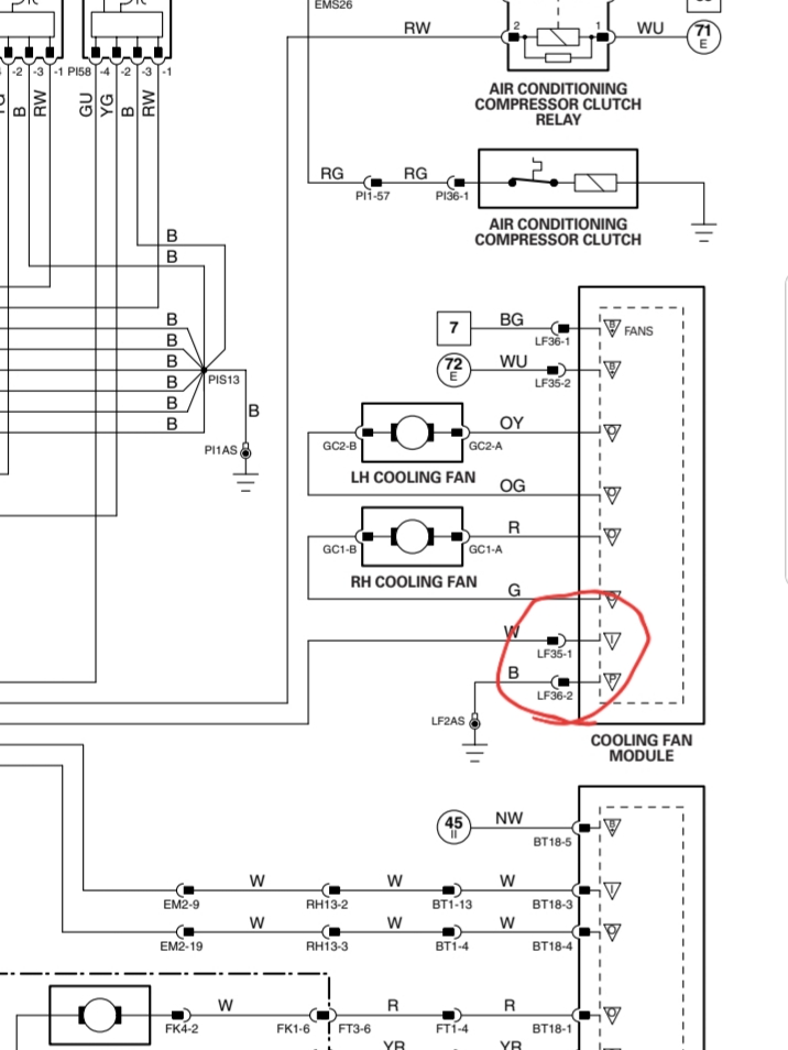

          This is about the extent of the electrical info available...
          From the EG, the signal from the ECM to the FCM is:- "EM80-51 COOLING FAN MODULE CONTROL: PWM, 140Hz, POSITIVE DUTY CYCLE RANGE 7% – 95%"
          Output from the coolant temp. sensor to the ECM is:- "EM80-70 ENGINE COOLANT TEMPERATURE SENSOR SIGNAL, NOMINAL 0 – 5 V: NTC SENSOR – VOLTAGE DECREASES AS TEMPERATURE INCREASES"

            The cooling fan module pic looks like solid-state mosfets, so a 140Hz PWM signal fed (5V?) in will modulate the cooling fans' speed.

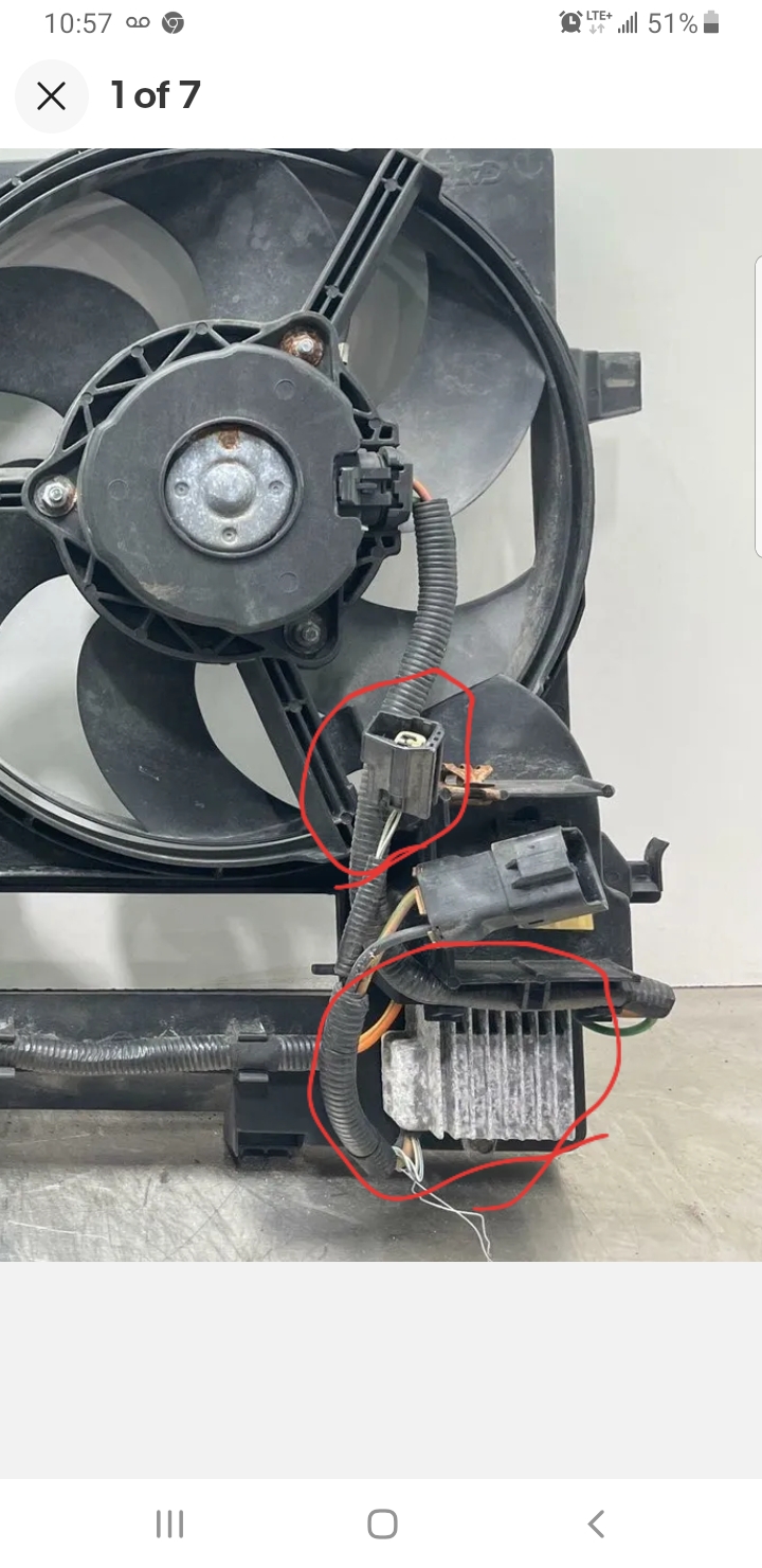

              The hope/want is to use a set of OE PWM fans from a new more modern vehicle (there are millions of them and they are of very good quality) in an OLDER CAR that originally came as a mechanical fan set up OE...
              To gain an ability to drive/control the speed of the fans with a V signal (usually a varying 0-5v) from a coolant temperature sensor OE in the older car... The sensors business end is usually bathed in the cars coolant - reporting the temperature in a varying voltage form.
              In many automotive setups (older and newer cars) the coolant temp sensor is a thermistor type sensor,,, 5 volts comes into the sensor, as the temp of the coolant rises and falls the resistance of the sensor changes effecting/varying the voltage coming thru sensor. These voltages are understood by the ECU and translated to do many things.
              In this conversation/question the want is to take the signal from the coolant temperature sensor in an older car (that doesn't have PWM capabilities for cooling fan speeds built into the ECU) and somehow convert that voltage info into a usable and accurate PWM signal for the coolant fan control module from a newer car.

                            The Jag fan module usually driven by an open-collector PWM output on the ECU, some are full speed when output on (0V) or off (12V), so you'd have to experiment to figure out what the module wants if you are using one.
