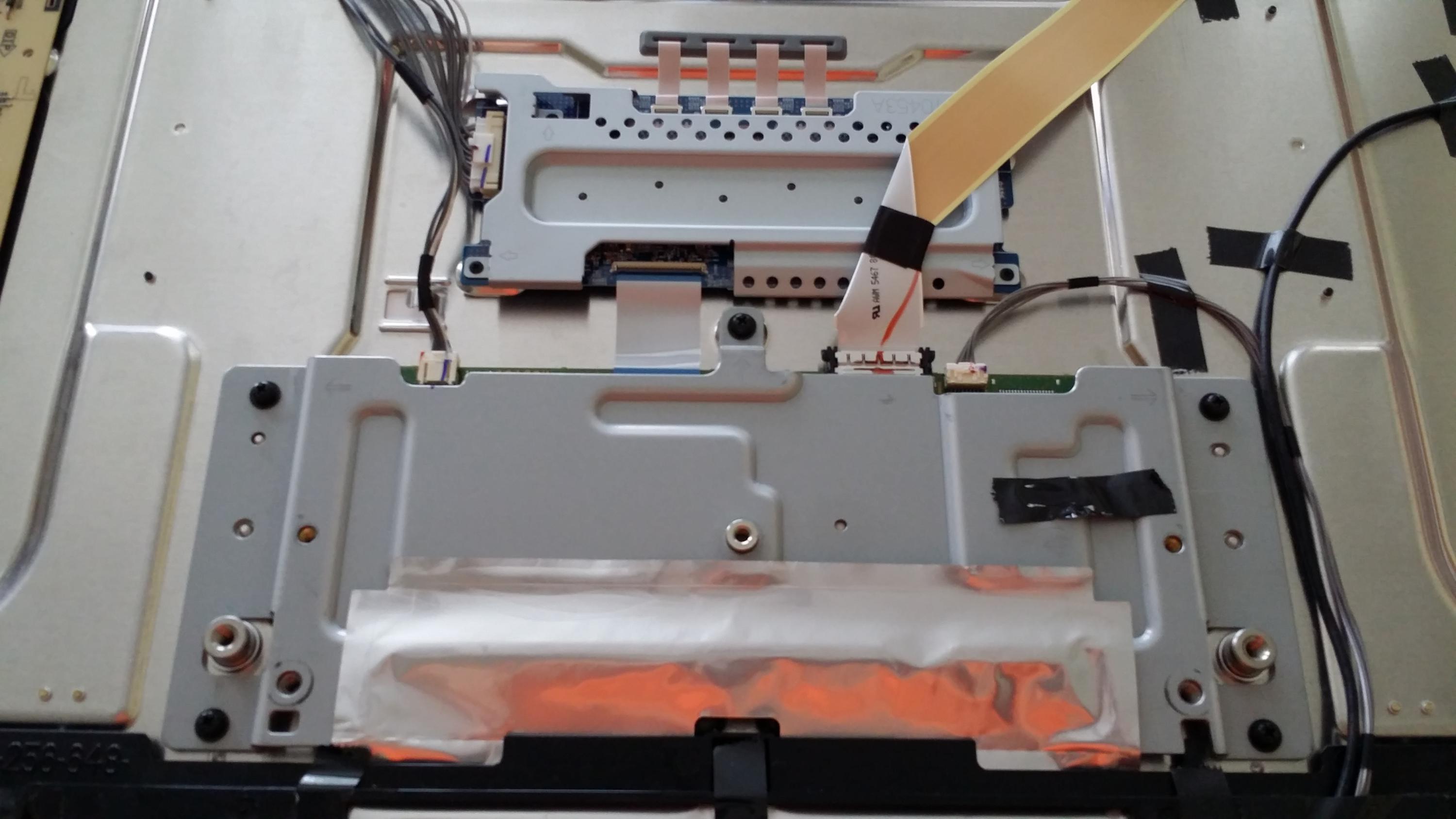

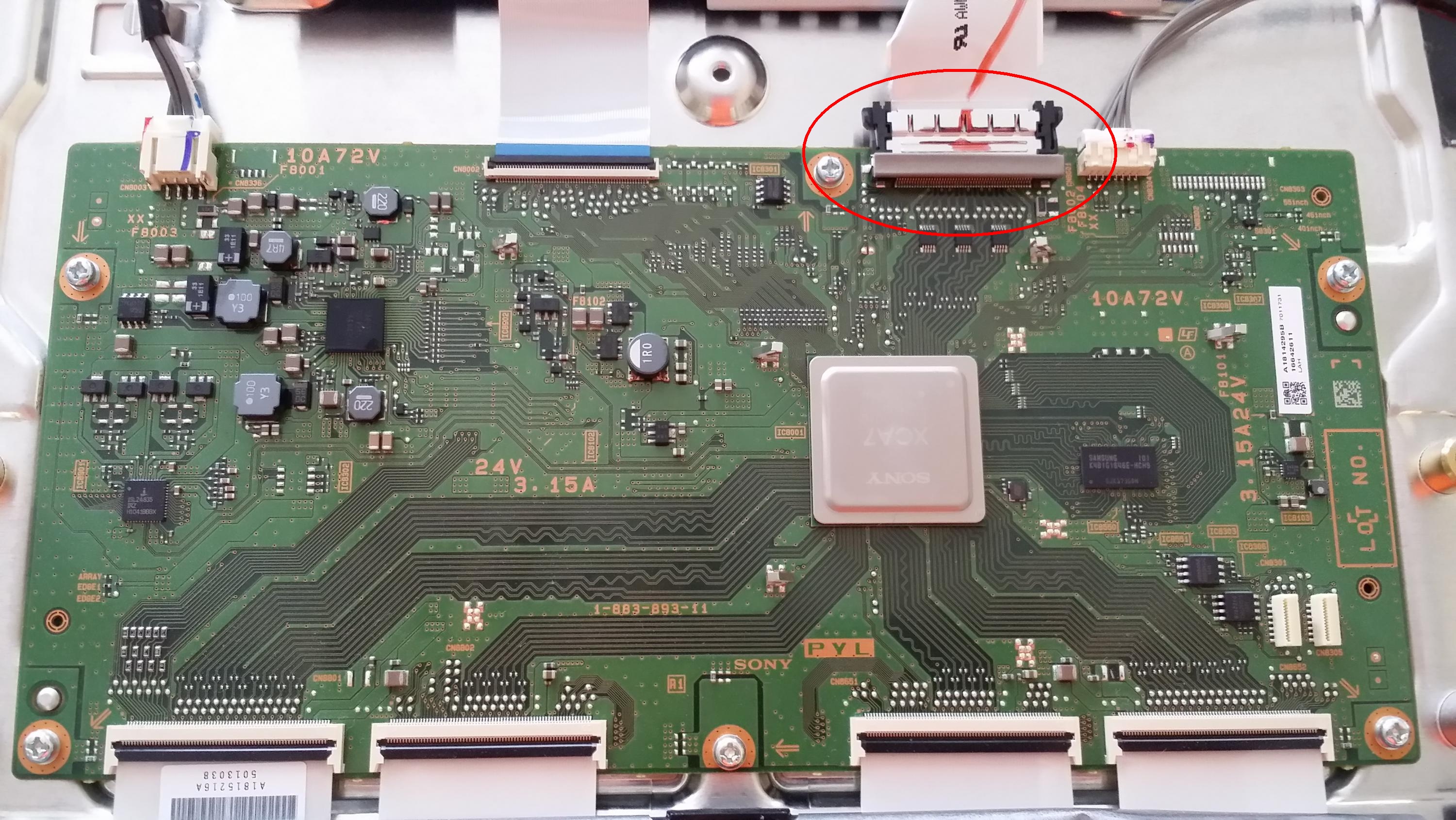

    I just Picked up this TV. I would really like to fix it. I turn it on and get 5 red blinks. I understand this error means T-Con but I was also told it could be a panel. I will take some pictures when I get the back off and post them as well.
    I see at your first startpost after opening of the TV, that the connector on the T-con (from the cable between mainboard and T-con) is not seated correctly. Such a thing could just give you the '5-blink T-con' Error from the start.
    Was that picture taken when you first opened the TV?

                            Make sure the ribbon cable going from the main board to tcon is OK where the plastic clip holds it to the main board. I have seen the ribbon cable get pulled from the plastic retainer clip before and caused damage to the cable.
