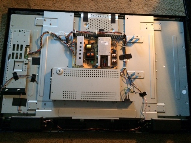

    I have this 42" Vizio TV that would start to FLICKER, STROBE after 3 or so minutes, and then go black. IF I turn it off, the same thing will happen after 3 or 5 minutes.
    I read many threads and purchased the Capacitors to replace on the Master and Slave inverter boards, but to my surprise when I took off the back, it did not look the same as others. No small board at all on the right side, and a bigger board on the left.
    Cover off:

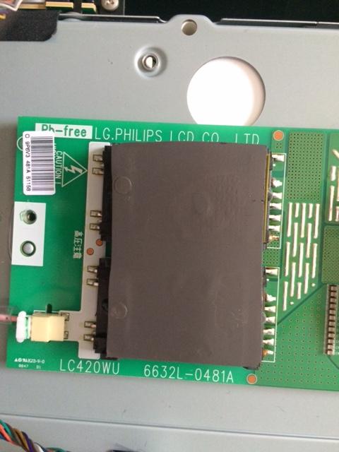

    Closup of cover on bigger board on left:
    Any suggestions as to what to look at next?

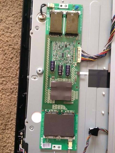

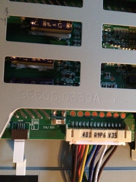

    Here is # on the only inverter board on the LEFT.
    Here is the complete INVERTER BOARD
    The caps seem ok, on this board. Should I replace this board or look elsewhere?
    I get good picture until it warms up, then flicker / strobe, then black screen.

      I'm no expert, but have fixed some power supplies, motherboards, accessory devices, TVs and PC LCDs by replacing caps. Your first pic looks pretty much the way I remember the inside of my VO32L. If you compare the brands of caps you find in yours with the good and bad caps lists here you may find you wish to replace at least some of them even if they don't look bad. Bad caps don't always show outward signs of poor condition.

        First thing you should do is replace all 3 caps in the inverter board.

          id change the u33 regulator also..
