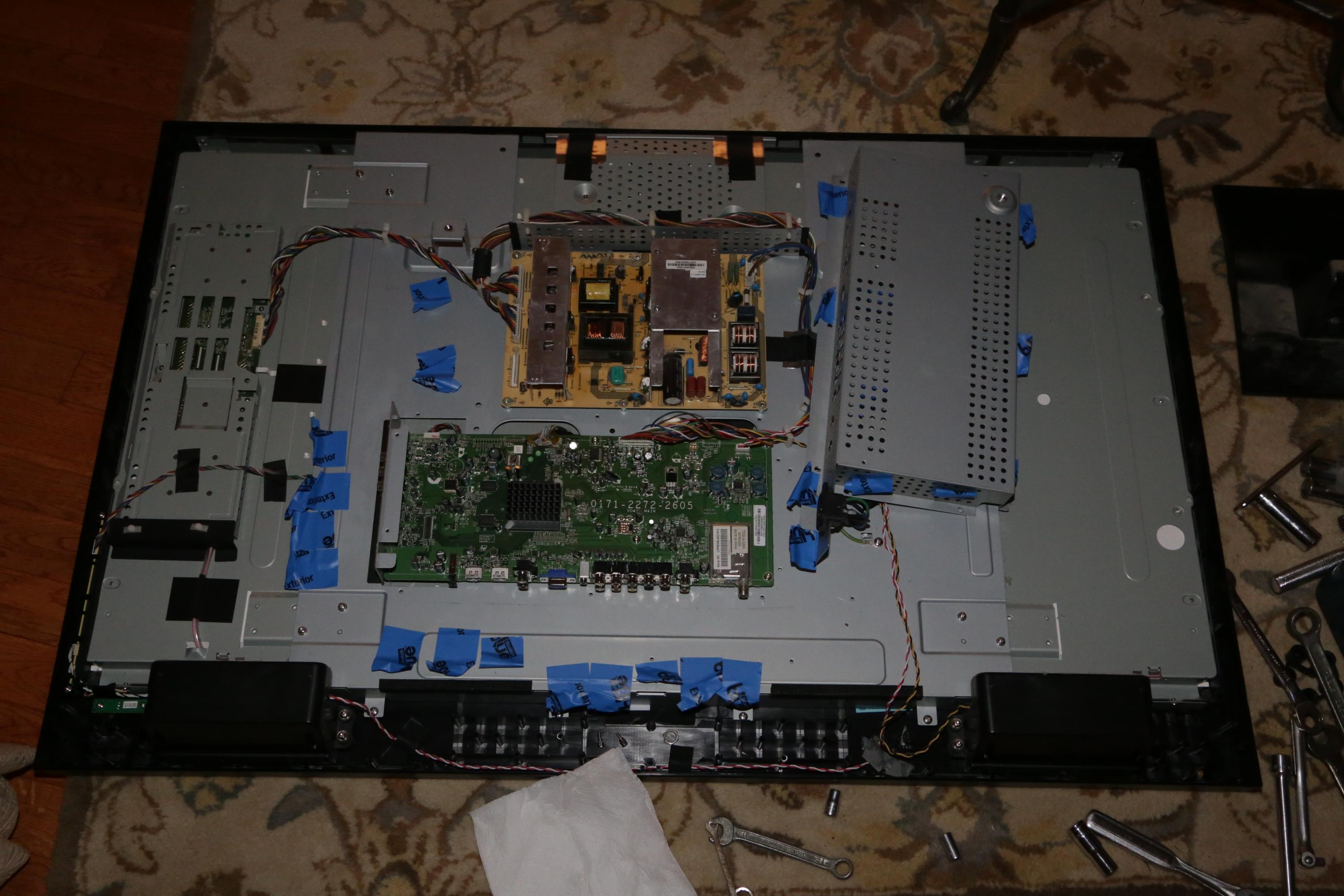

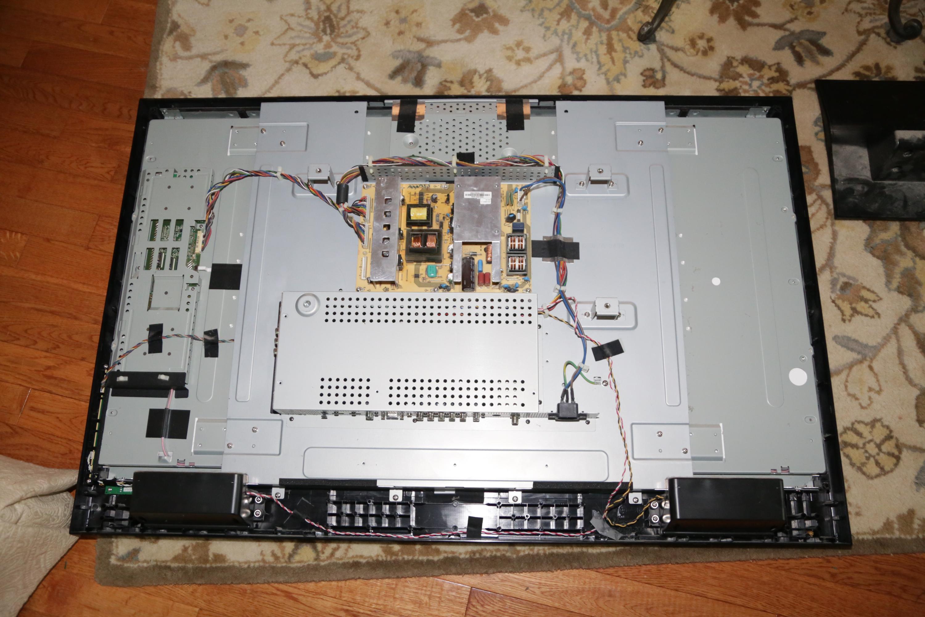

    Meanwhile, I've also taken the back off of the TV after unplugging it, and currently have it set aside for further troubleshooting. My biggest question at the moment is what the most likely culprit is, and/or is there anything else I can do right now in order to isolate the issue here?

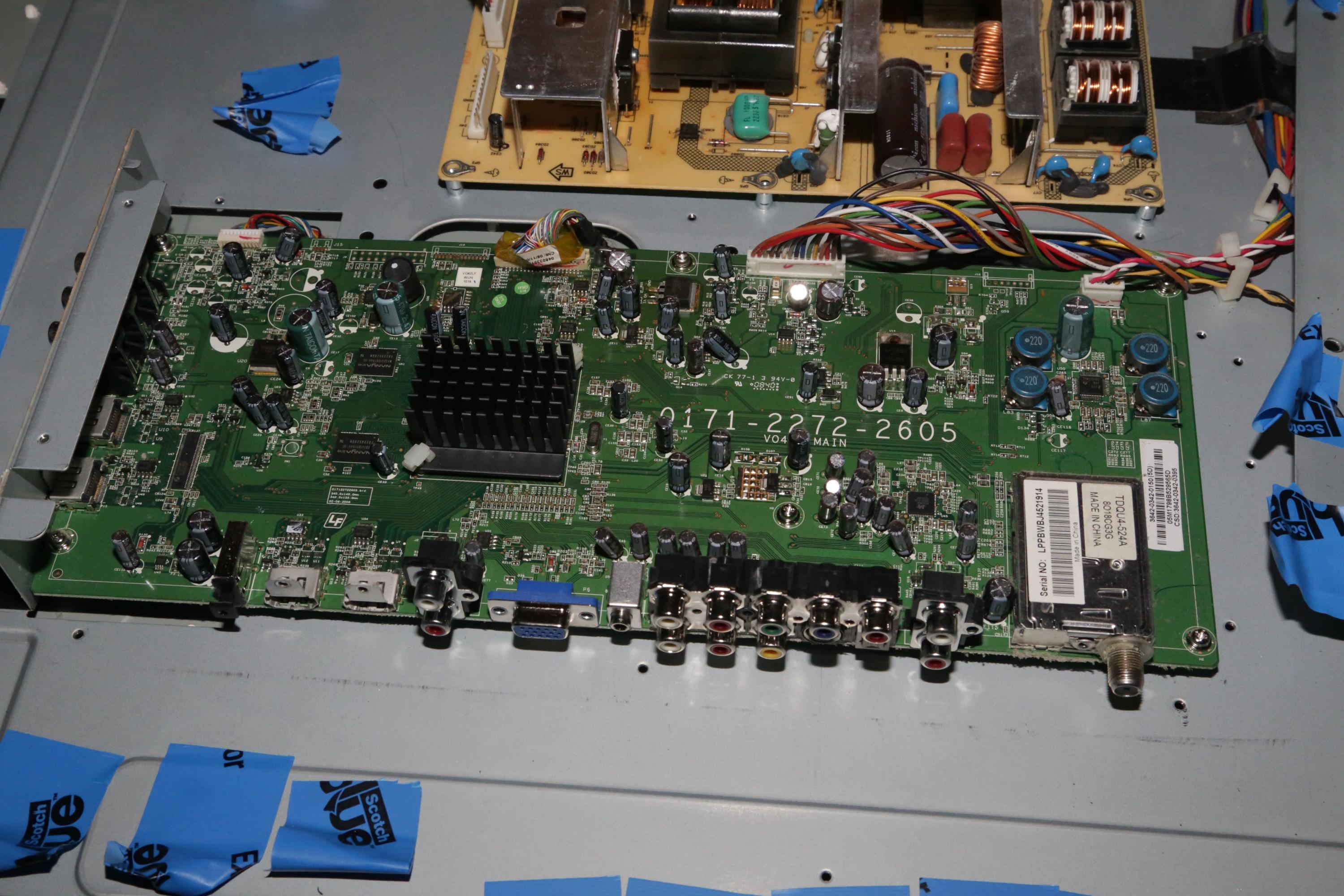

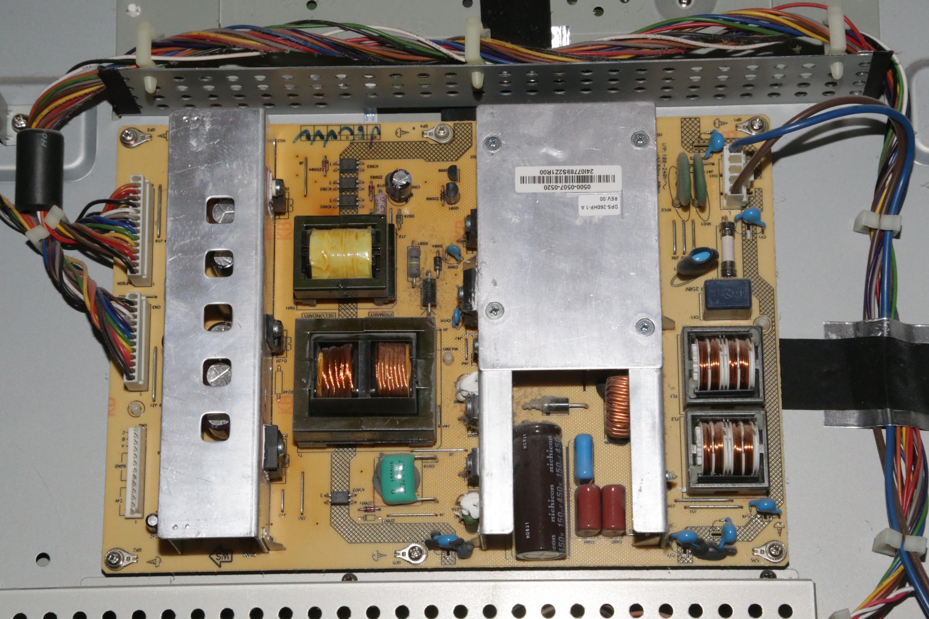

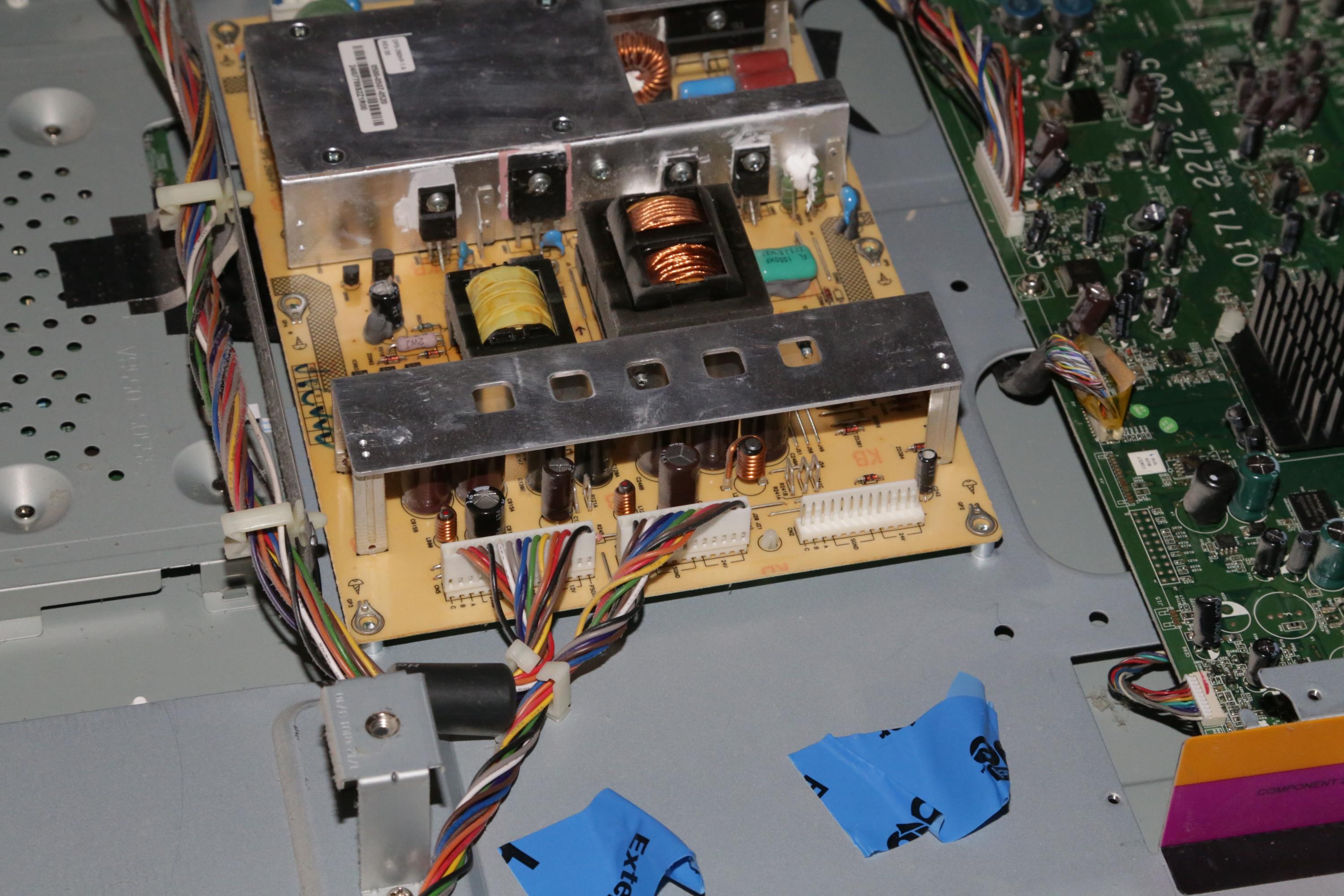

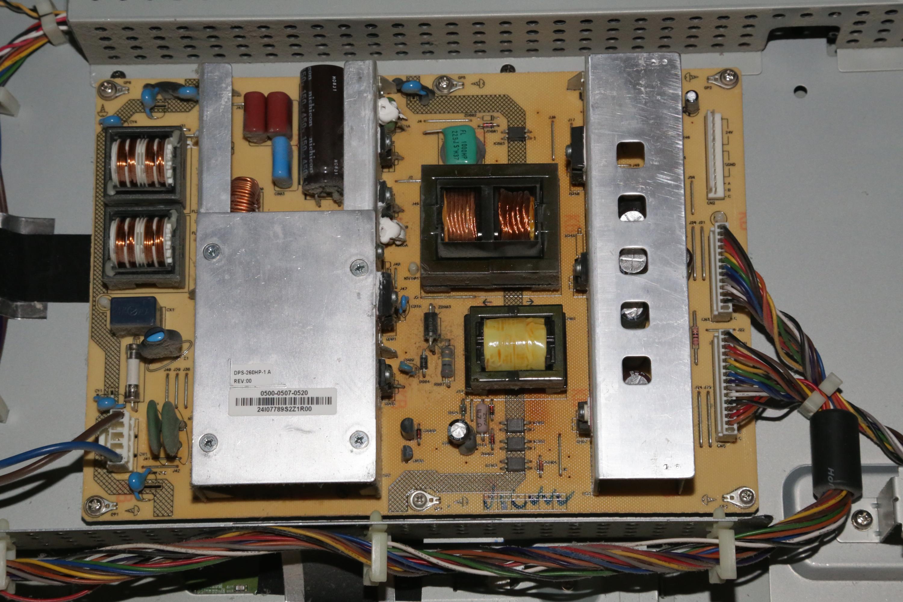

    I've taken photos of the main board and power board, which I've also noted the model numbers of, but I'm hoping that I can be guided in the proper direction before I potentially start ordering a bunch of unnecessary parts.

    If you could post your photo's of the boards they may help.
      Re: Vizio VO42L Issues: Need Guidance
      I've attached some photos of the boards from a few different angles. The only backplate I haven't removed so far is the one covering the board on the far left-hand side of the TV. If anymore details are needed, just let me know. Thanks.
        The power supply could do with a good dusting. I would check all the solder joints on the underside of the power supply especially around transformer joints. The coils at the output also may also have run hot so I would check the solder joints on them too.

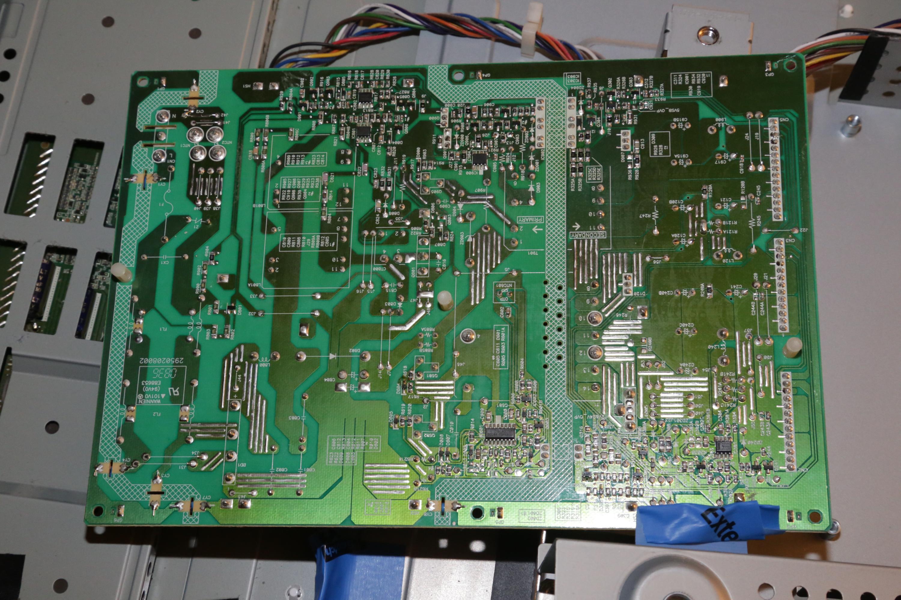

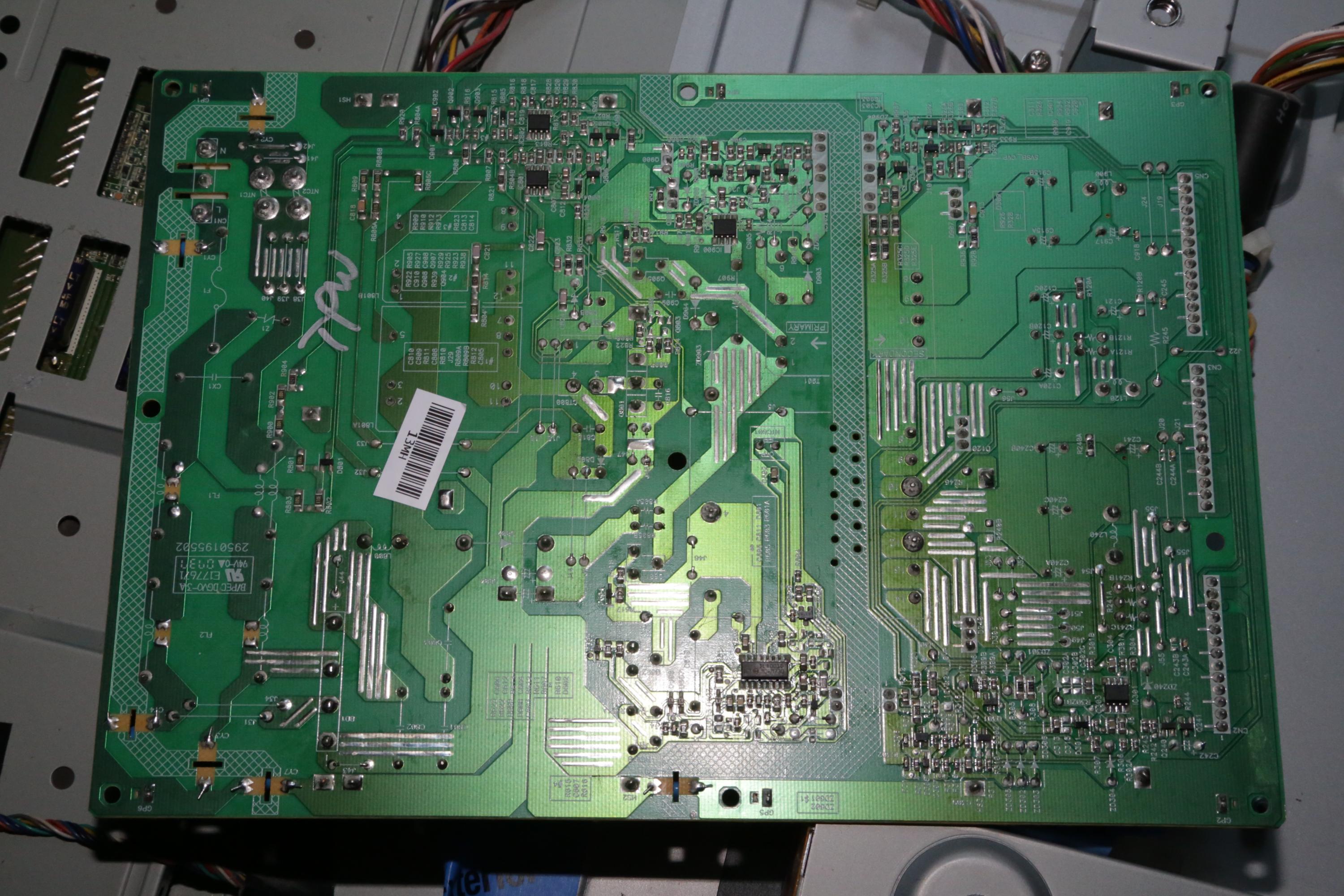

          I just gave it a dusting as you mentioned, and I took some photos of the underside. Everything looks okay to my eyes, but I'm including another photo so you can take a look.
          I also have a video clip of the issue from just now, hopefully this will also prove useful:
          https://drive.google.com/file/d/1Iui...ew?usp=sharing
            J7 link doesn't look so good. Also D604 appears to have some residue around it.

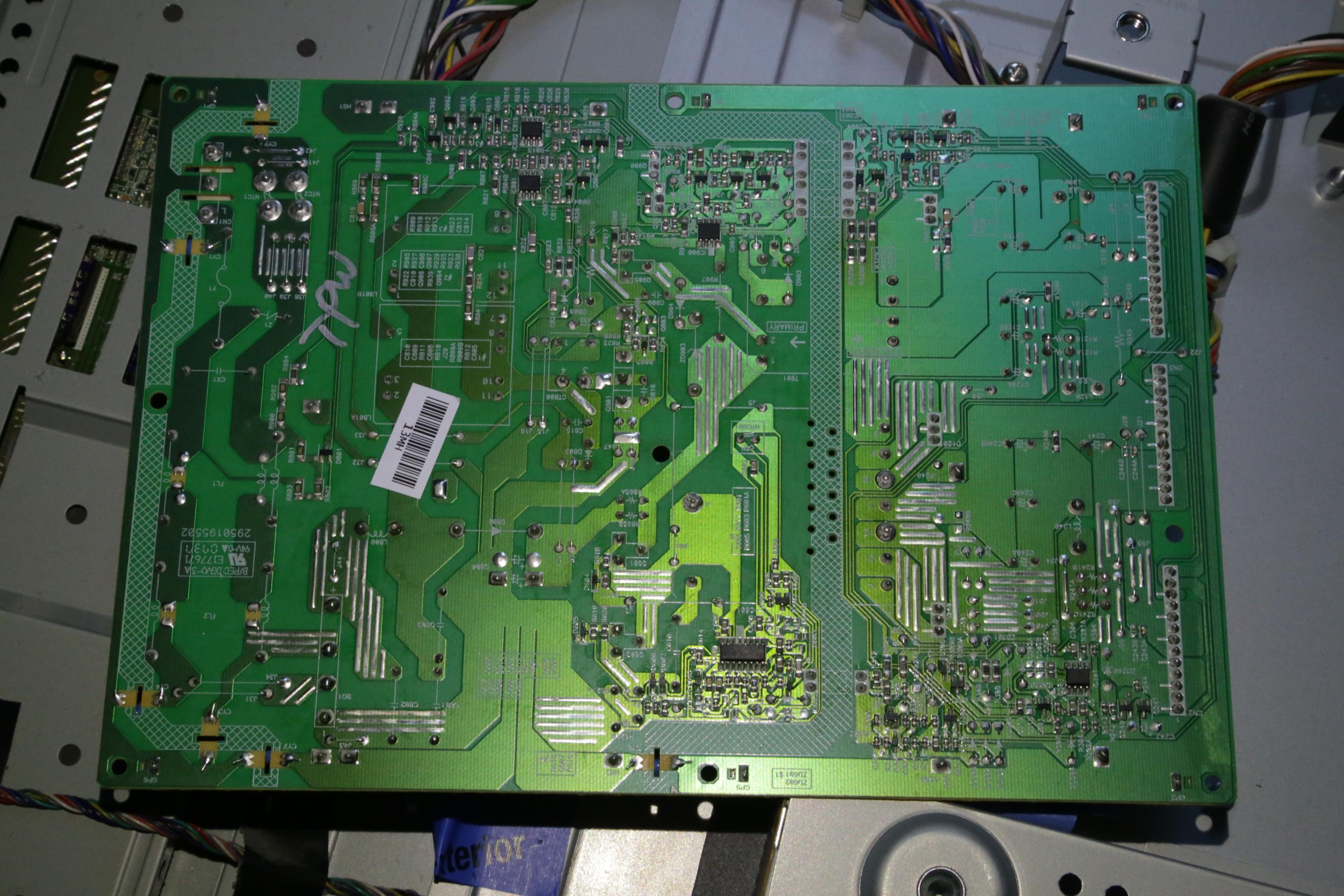

                    Please let me know if anything stands out to you in the photo of the recent board which I've just installed. You have a far better eye for what does and does not look good, and I'll be certain to double-check anything that you recommend I do so here
                    Also, just for my own learning experience, what are some giveaways I should look for in regards to what constitutes a well-soldered joint? I know that no components should be loose, and I obviously expect a clean looking solder from the factory, but is there anything else in particular that I should keep an eye out for especially with regards to wear and tear?

                      The photo's are not sharp enough to make out any poor joints and shadows do not make it easy to tell. An example is D120 looks as though one pin is not fully soldered. However it could just be the shadow.
                      What you are looking for is that transformers, coild and mosfets solder joints look good.

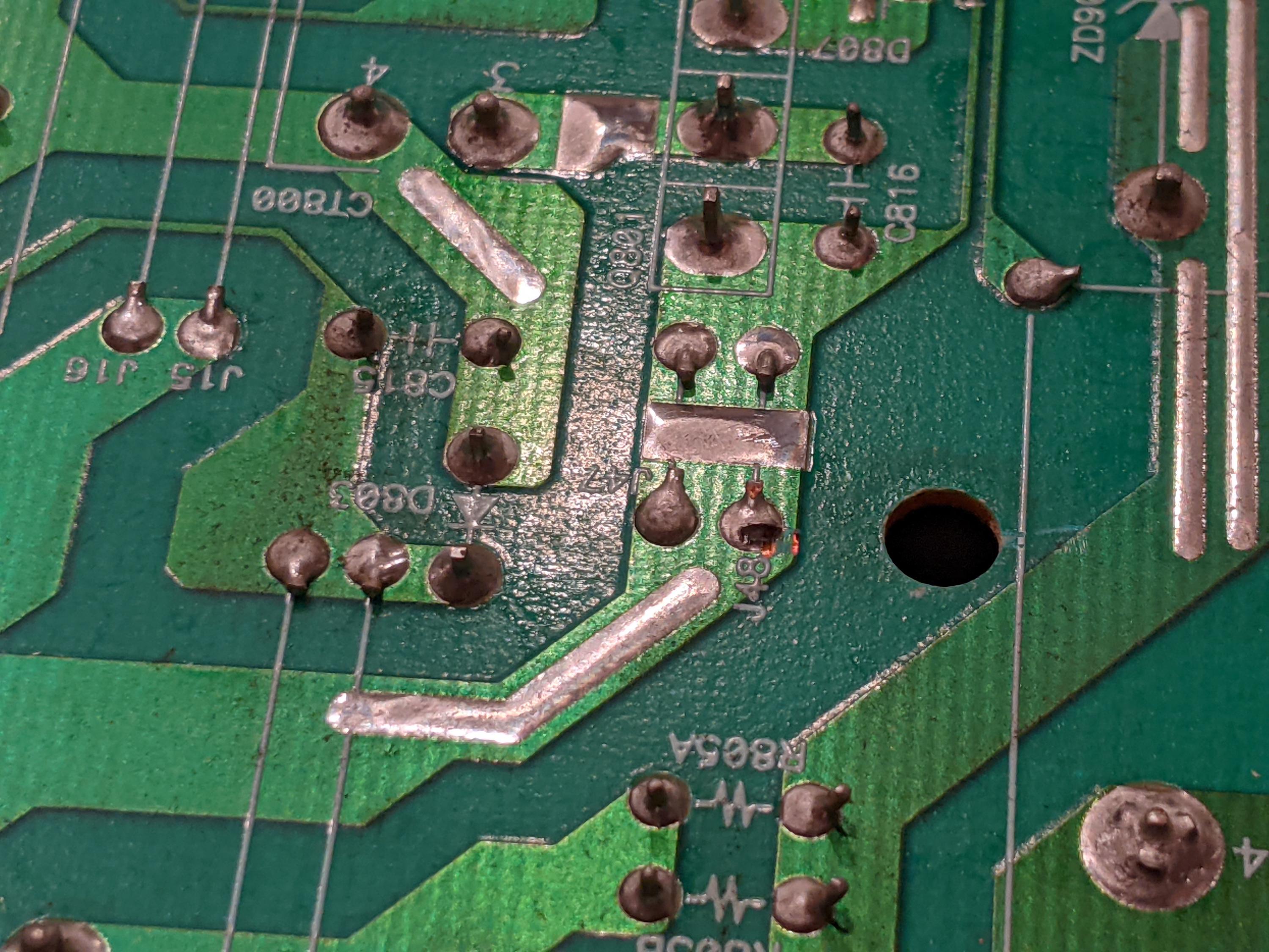

                        After giving it a closer look, it appears that there is a solder issue with J48. Would this be causing any of the issues?
                        Also, is it normal for the power board to ever make any noise at all, or should it be completely silent? Additionally, is it also normal for the heatsink over the capacitors to get rather warm when powered on?
                          It's not a great solder joint but it does look as though it is connected to the pad. I would however resolder the joint.

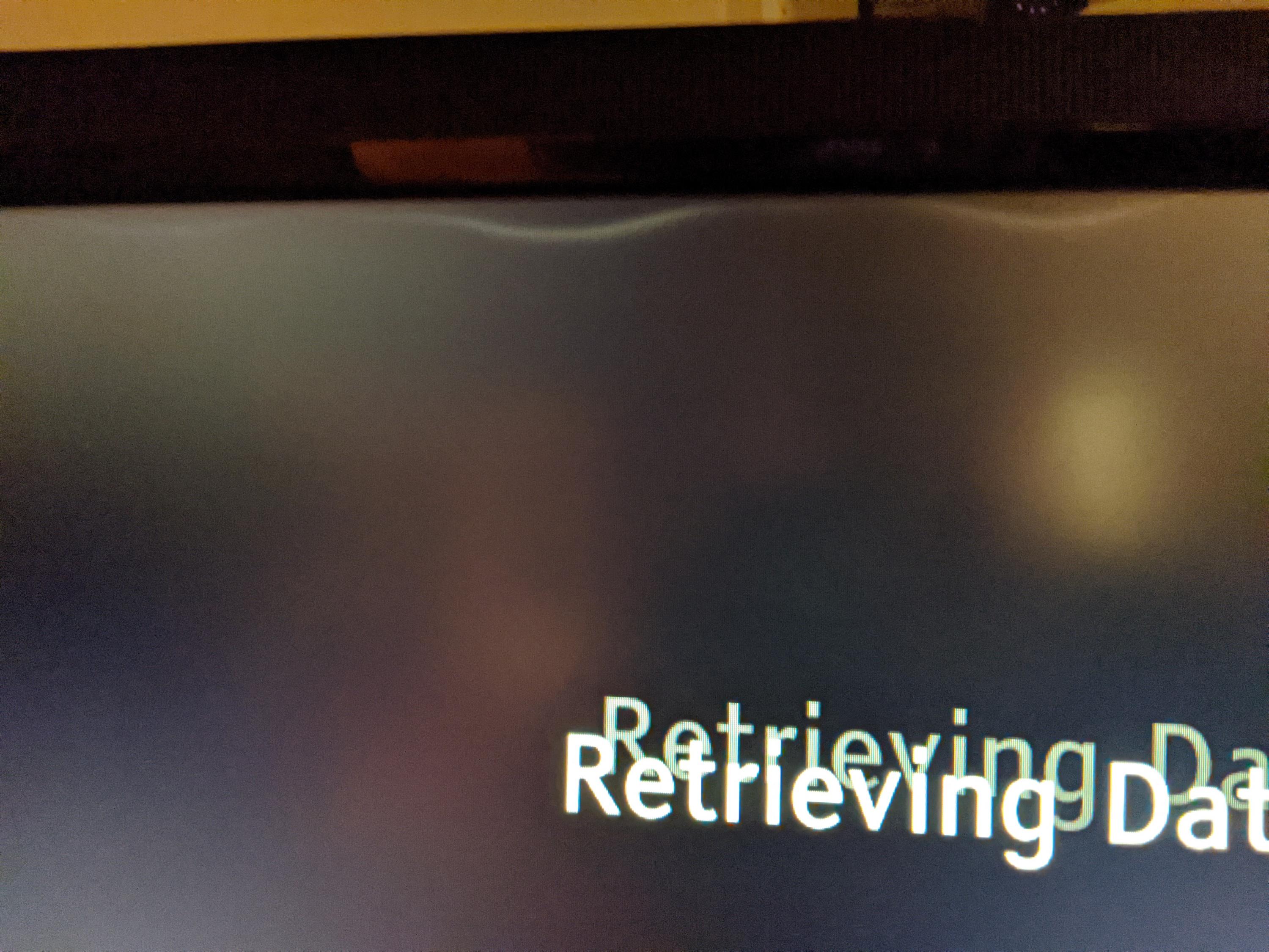

                              Also, somewhat related, I'm now noticing this faint white wavy line or mark across the very top of the screen, almost like a sweat mark on a baseball cap. Any ideas what this could be as well?
                              It's such a bummer right now, because once I reassembled the TV and turned it on everything appeared to be working perfectly fine again, but the moment the HDMI signal began transmitting it was another headache all over again.
                              Edited to add: I've included a photo of the wavy line, and a video clip of the remaining HDMI stutter:

                                  If the wavy line is constant and doesn't move I wonder if it's something to do with the panel diffuser screens.
                                  What's the picture like using other inputs or off-air. Does it suffer the same flickering.
