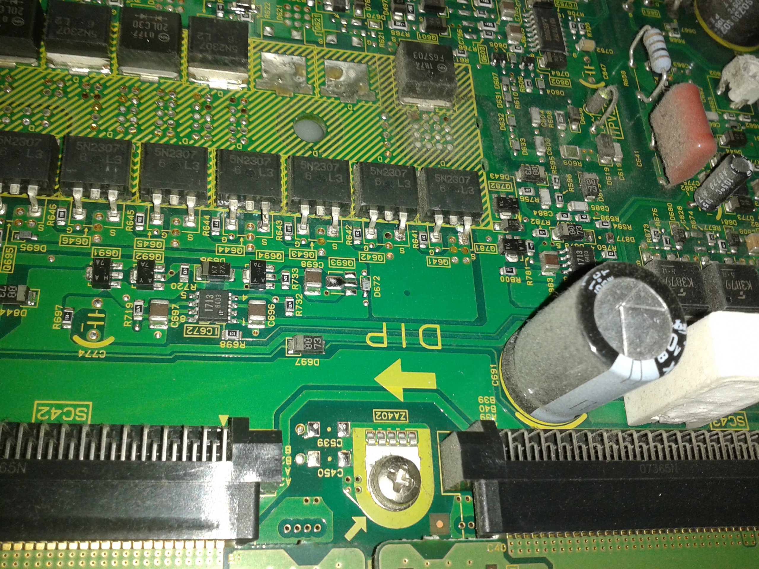

    just picked this up
    http://boston.craigslist.org/gbs/sys/4815882763.html
    And I started lifting legs on the 5N2307's till it powered up. Currently I have the bottom 3 re-soldered and leg on number 4 up. tried it for a hour or so works fine.
    Any Issues running it with one not there?
    I've seen newer versions of these boards with Missing FET's maybe they found out it had a few too many.
    I don't know exactly what it does. So any ideas from people who know about how this board works.
    I was thinking just run it with lower contrast/brightness

    I could easily be wrong here but iirc those are run in parallel and are sharing the workload so with only one you risk releasing the magic smoke in short order.

      that's why i was thinking of running it at half contrast as its considerably darker. I was going to use it as a spare tv for lan party's.So it might see a few hours every week.

        I have to ask what your opposition is to simply replacing that mosfet ??

          Everyone that removed the board had issues with ribbon clips and stuff I don't want the hassle if i don't and I can't solder very well.If anyone knows what exactly these do please chime in.

            You need to replace the FET. Study the connectors really well before you start unplugging them. I had issues with the ribbons but eventually got it. I was a little too rough with The SD board and pulled the connector off. Fortunately, I was able to fix it.

              I've been running it all day and did the firmware update too. Seems fine. I might order the fet and sell the tv with it. I got a free Hitachi p42h01 the guy didn't know ther was a master power switch.I dunno which one I'll keep

                update tv still works great and now i have 2 more exact same model that had 10 blinks and i fixed with a wire on a bad thermal fuse
