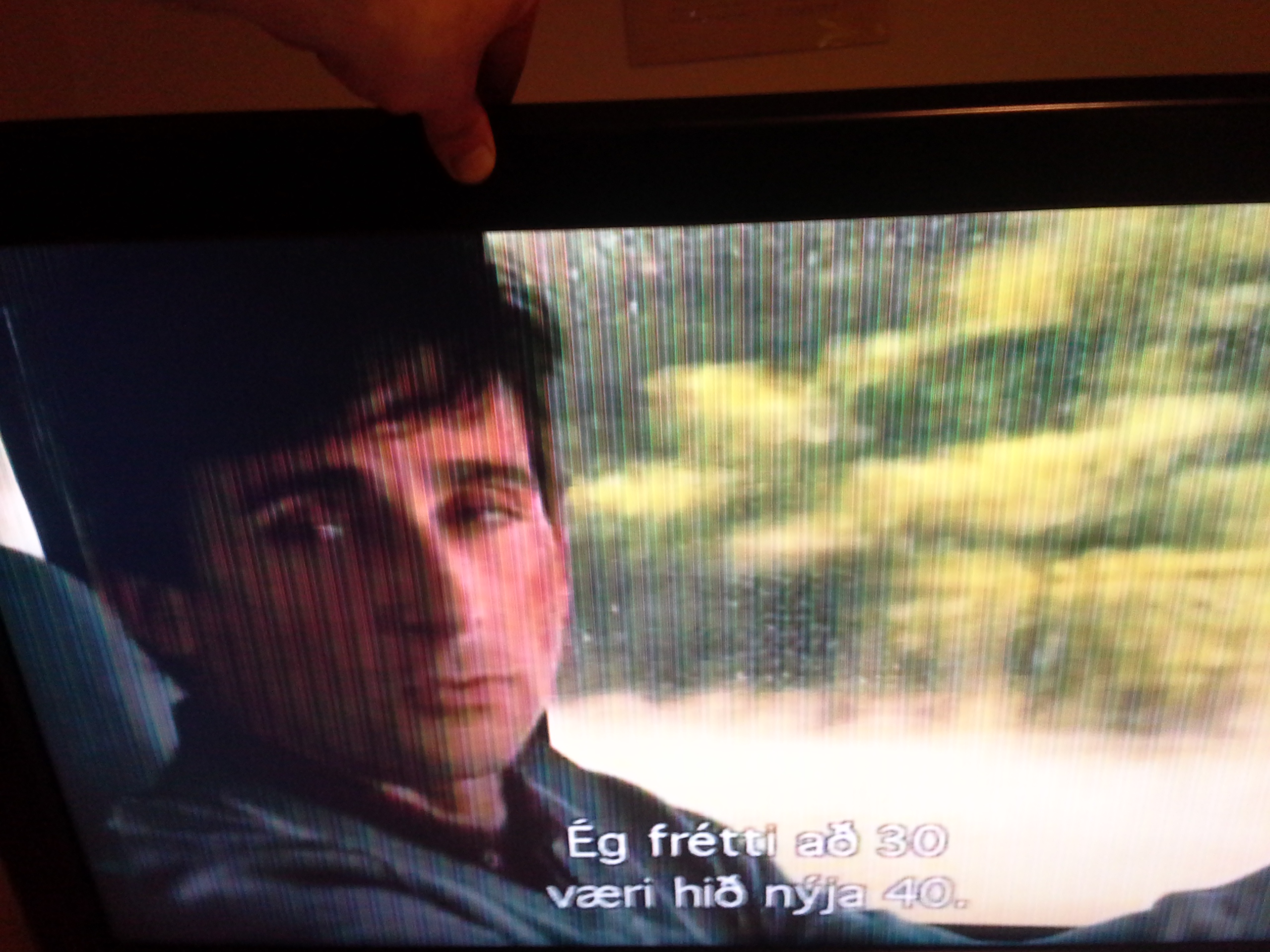

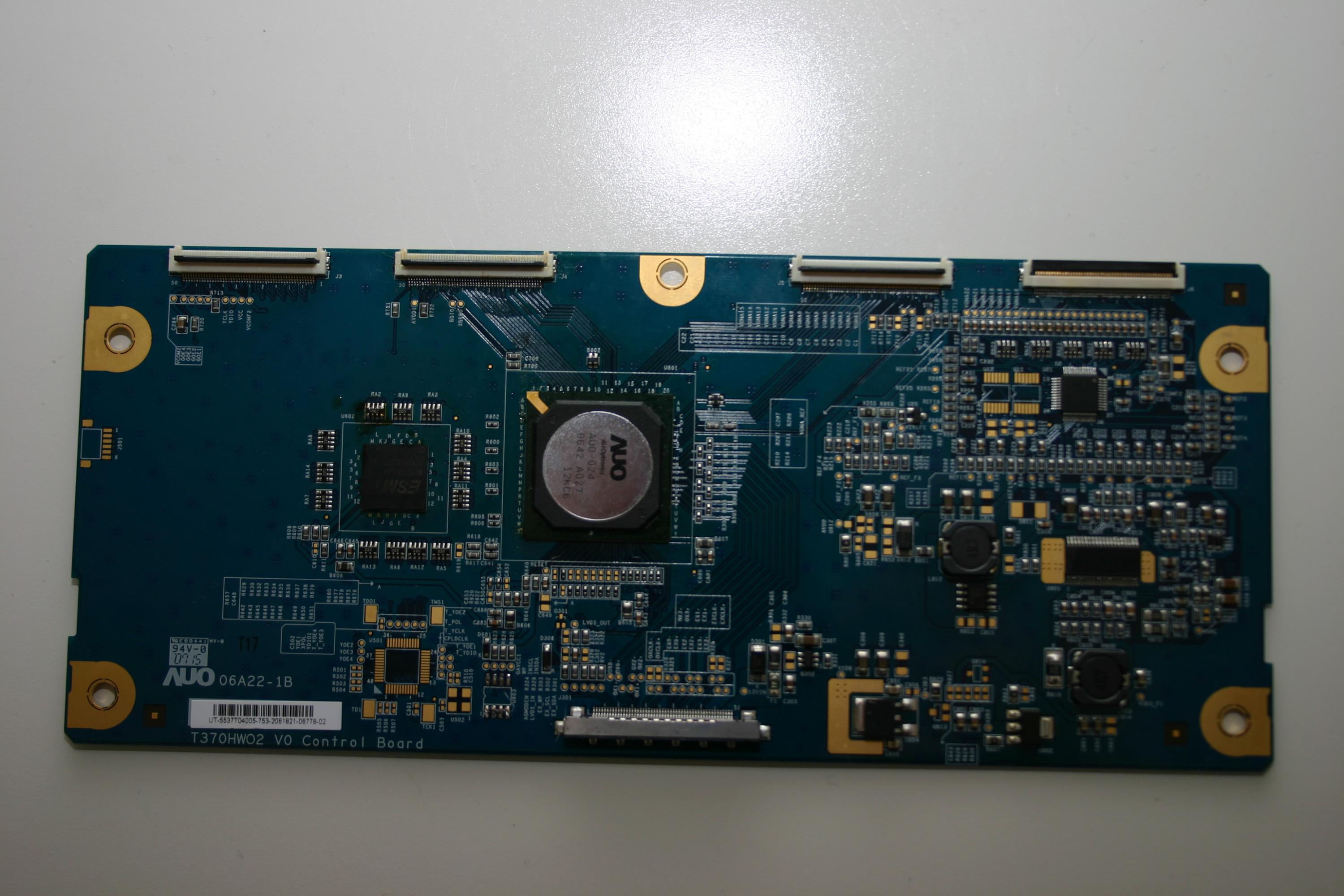

    Hello. I have Hitachi l37v01ea at the beginning the tv was somtimes freezing but my friend try fixing the t-con but made some mistake it have lines now, but it stopt frezzing. so I bought new aftermarket board on aliexpress but when I change it have negative image. There was a extra IC chip so I change it but then I just had some lines no image. What should I do try to take the IC chip from the old board and put it on the new one ? T-CON T370HW02 V0 Control Board 06A22-1B

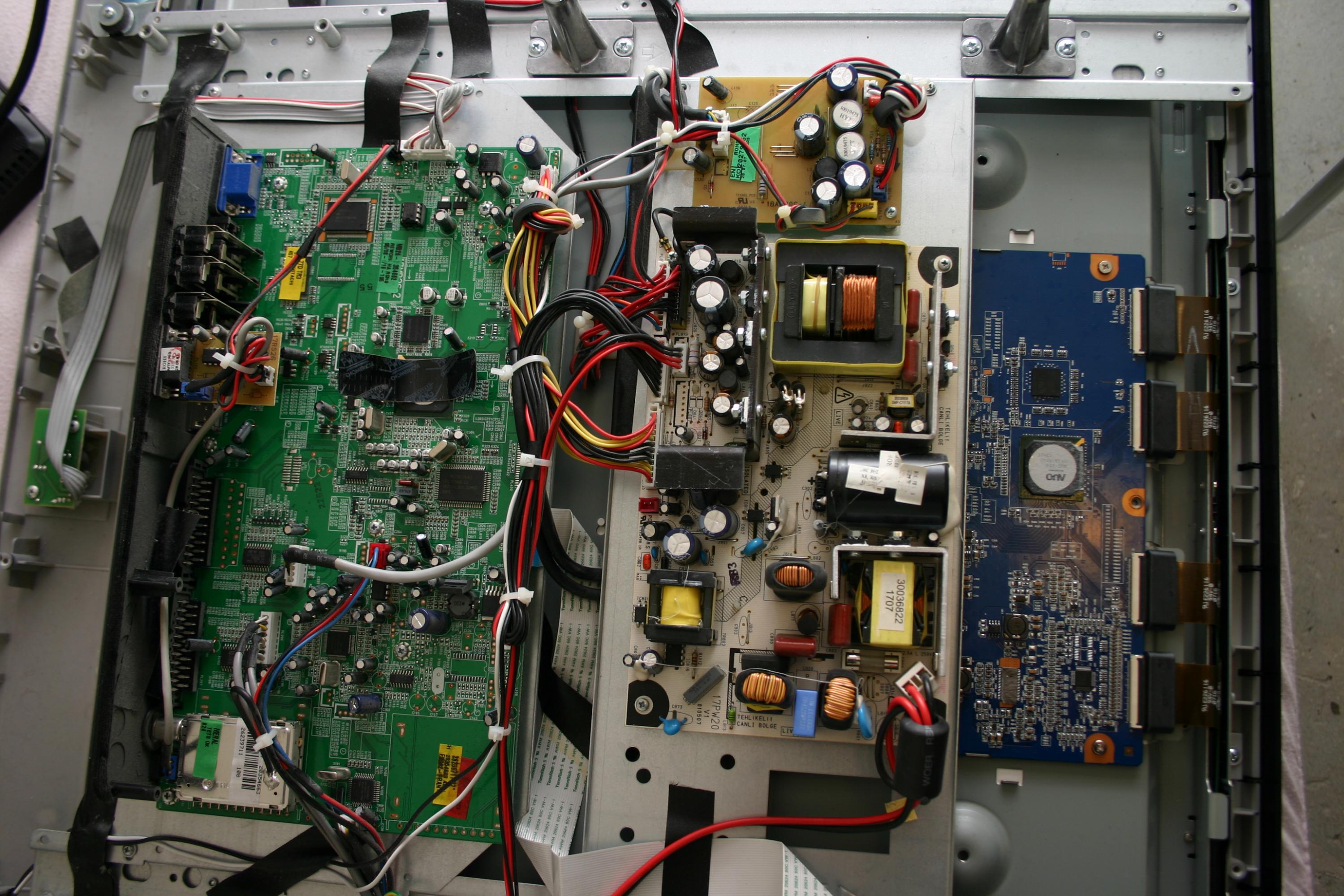

    can you post some good clear pics.?, of all the boards, to get the ball rolling.

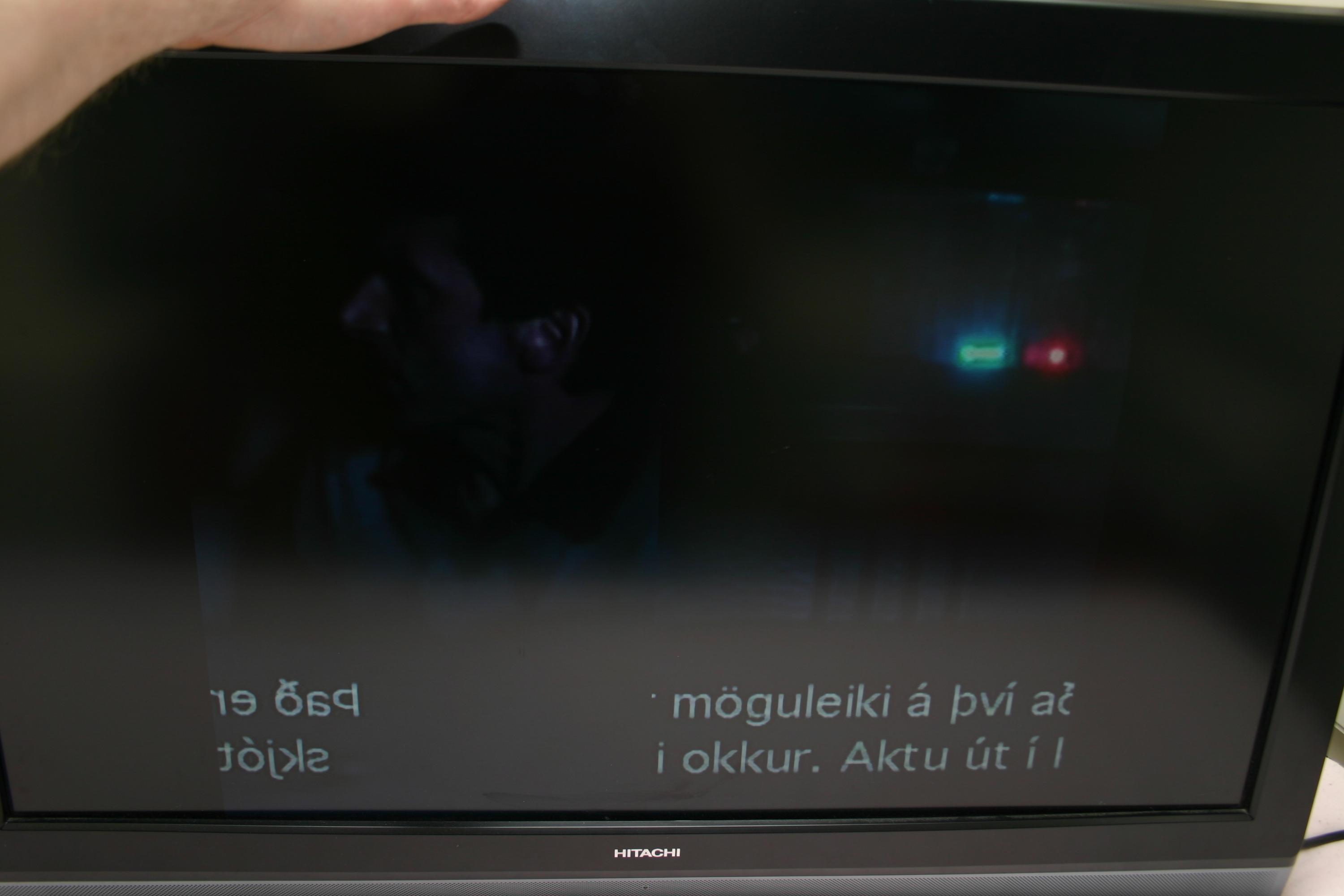

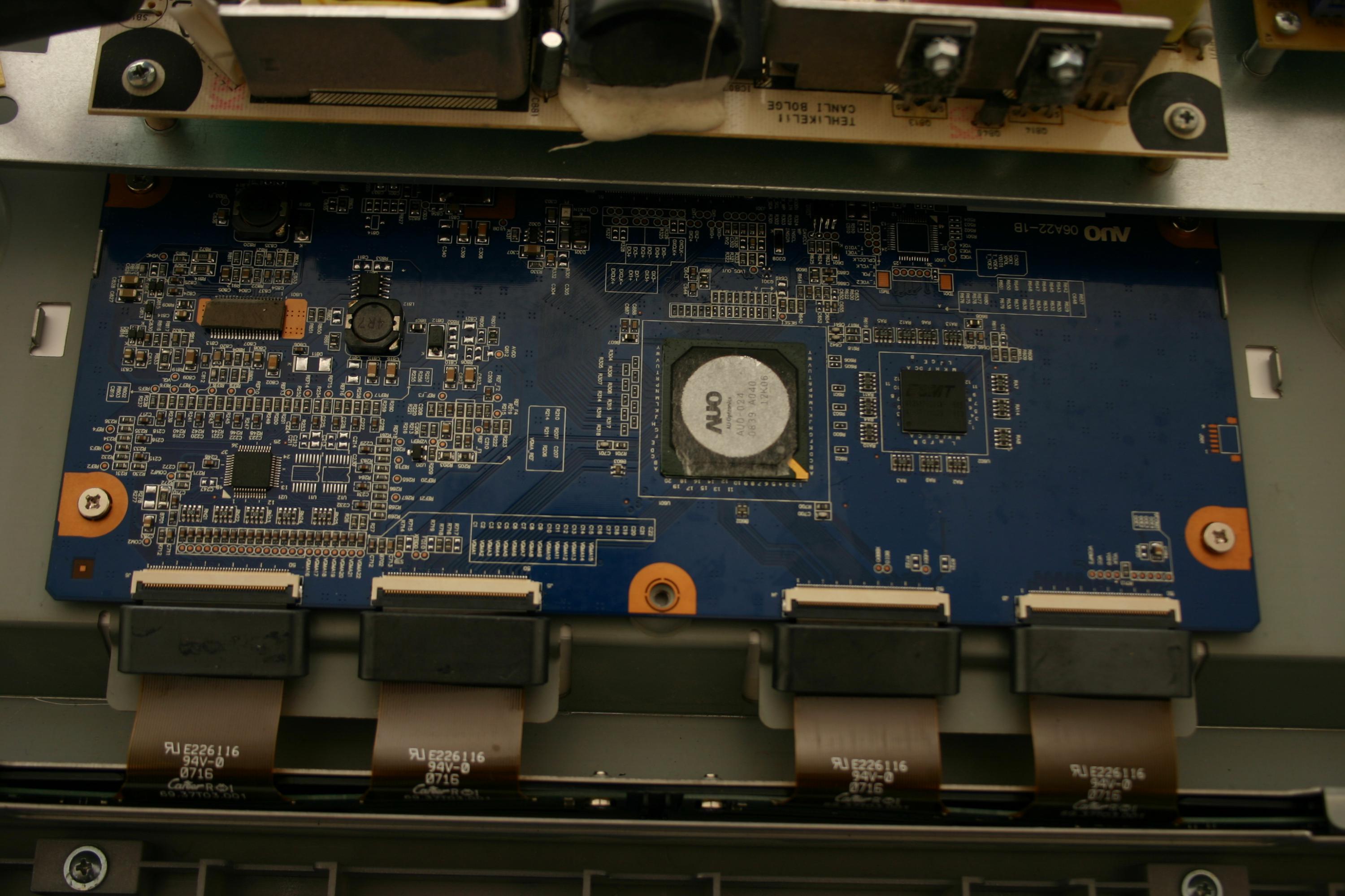

      Here are some pitcure I did try to put the orginal chip on the aftermarket board and there is no lines bud the movie are split left and right you can see it at the text and also the image dont fill the screen.

        Re: T-con proplem
        and the image 4 are the orginal board.

            Re: T-con proplem
            This is proplaby the t-con because if I put the orginal then I have lines bud full screen but now with the new one. Double picture and small. Bud no lines.

                    Re: T-con proplem
                    If one board has more parts on it than the other then they are/may be not the PCB assembly. Manufacturer can use same blank board and stuff it with different parts to create more than one PCB assemblies as needed for certain screens, TV's.
                    What are the assembly numbers as printed on the bard code of YOUR board?
                    Picture #4 has P/N 5537T04005
                    http://www.shopjimmy.com/auo-55-37t0...-con-board.htm

                        Ok so proplapy you have the answear here for this ! this is the number from orginal: Ut-5537T04005-753-206-1821-06778-02 aftermarket:UT-5537T04008-19-L-2005122-0006K-04
                        So Will it be possible for me to make one working out of this ?

                                    Re: T-con proplem
                                    http://www.shopjimmy.com/philips-996...-con-board.htm
                                    the 008 does not show as a accepted sub for 005.
                                    I have no idea as to which parts you need to add or remove to make 008 into 005.

                                      ok so this big proplem but would it be possible to fix the orginal board. It have thin vertigle lines. Are the main chip deat ?

                                        Re: T-con proplem
                                        This is how the lines are with orginal board.
