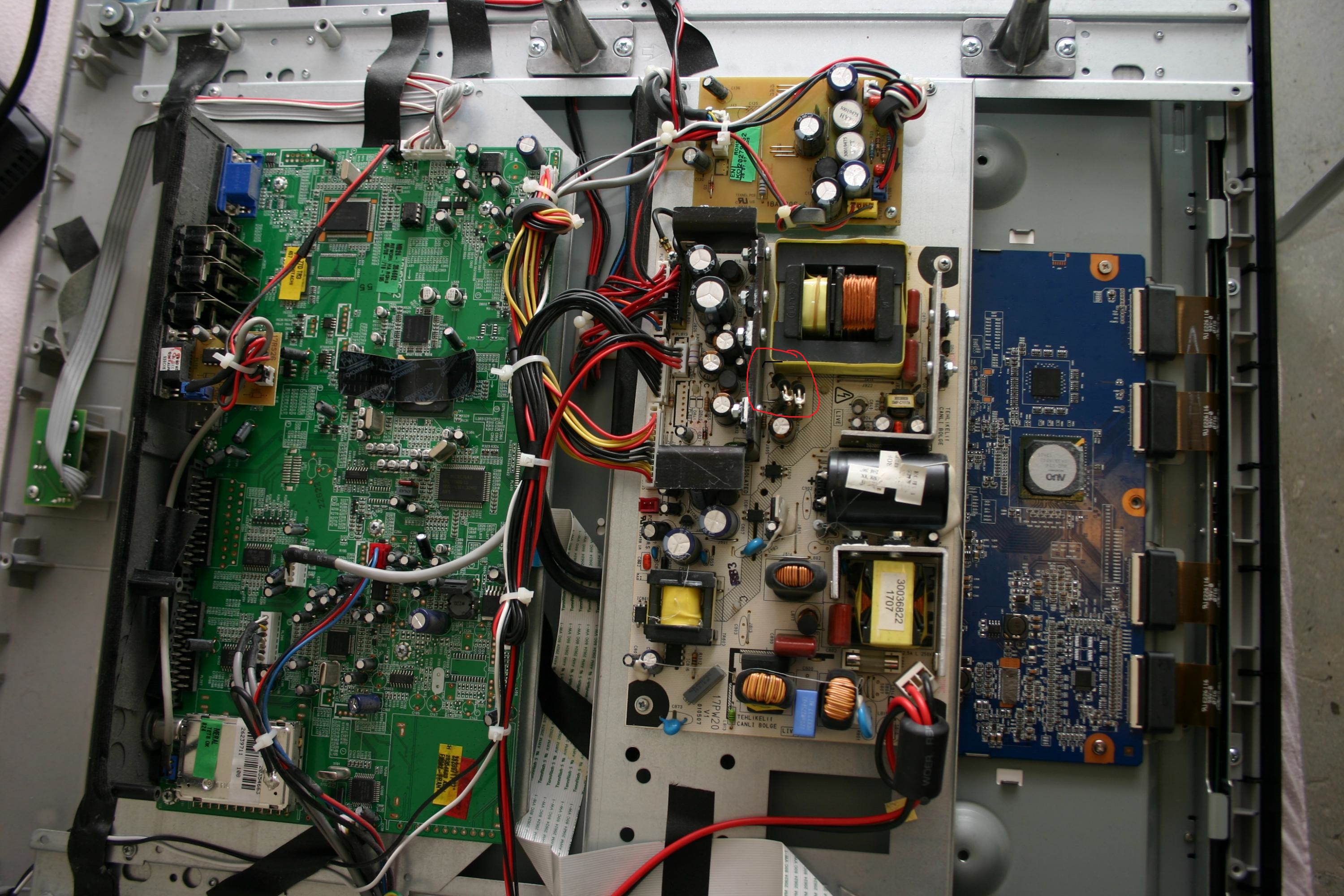

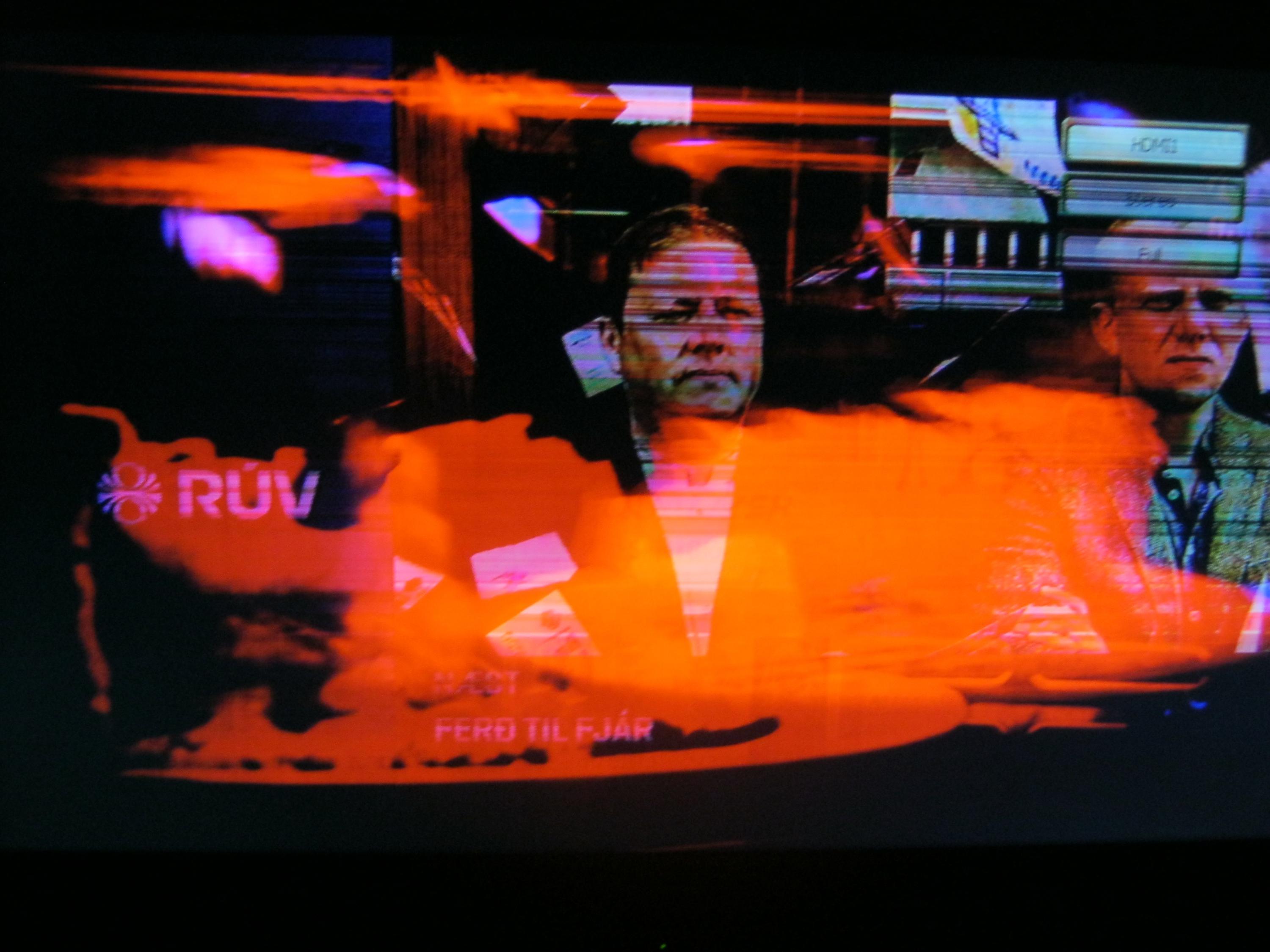

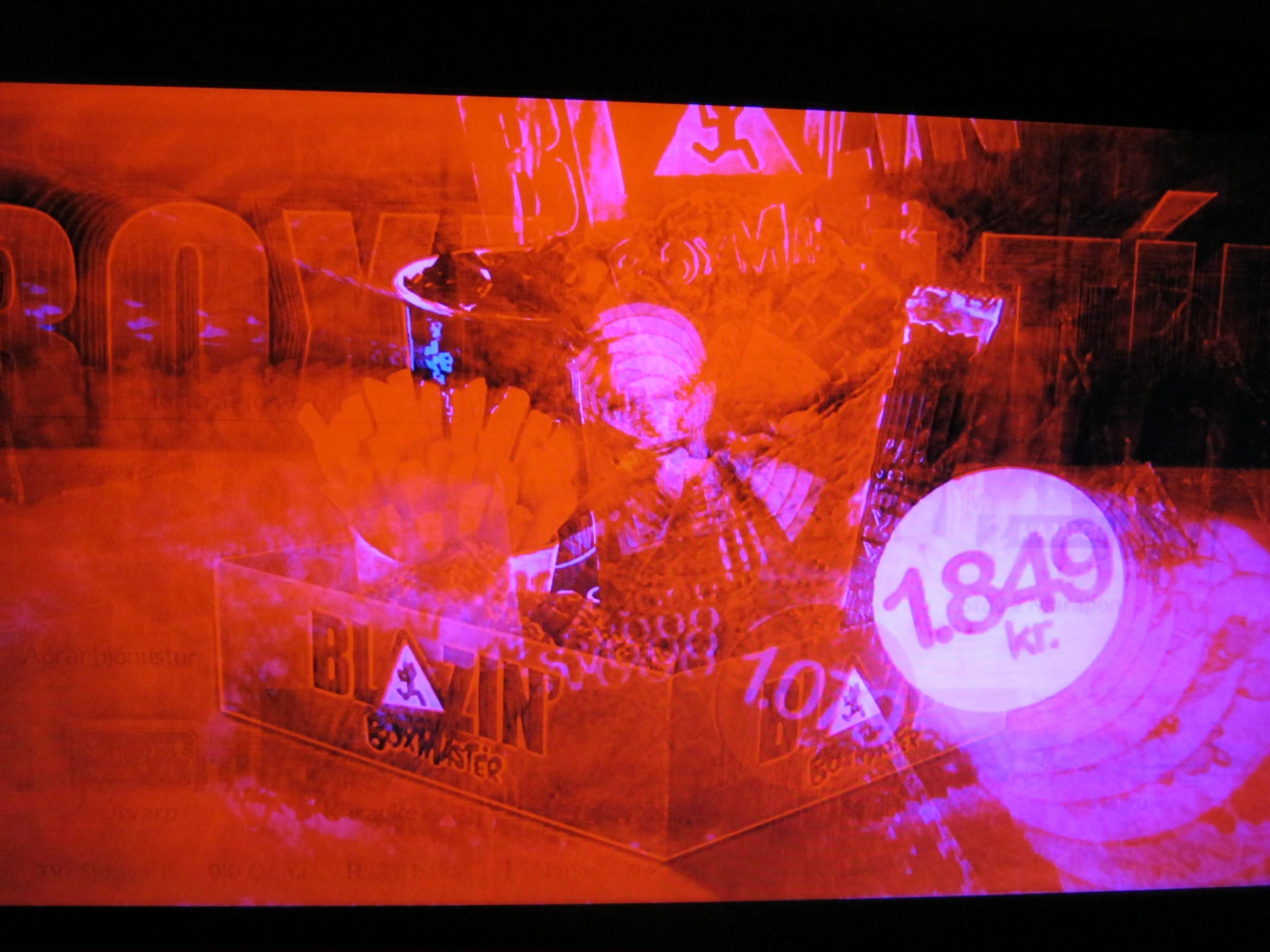

    Ok I got a nother T-con from aliexpress seller "He decided to send me another one." And the status is diffrent now with new T-con. I have good picture for 10 minutes after I turn it on, cold. After this 10 min "tv warm" The picture start to bleed with some red. I have tried to clean the cable to t-con bud with out success. Is possible that it is somthing else ? something on main board or powerboard ? I dont see any bulp caps by the way.
      Re: T-con proplem

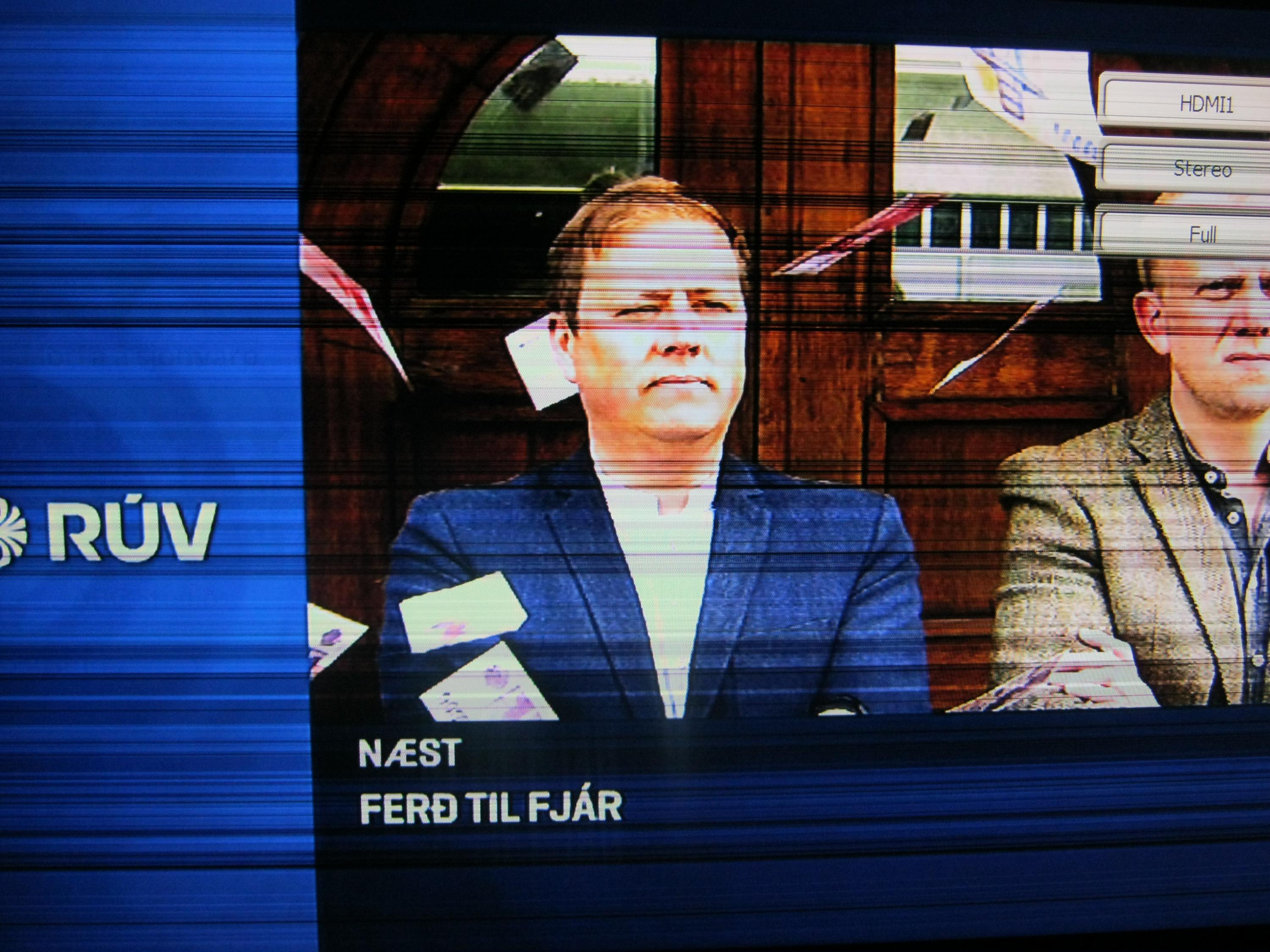

      here are some picture after the tv have warmt up

            Ok thanks. We are on the right way. I maid a cirkle around 2 parts which had a bad solder now are picture ok bud sound are somtimes missing. When I turn tv on and after 2-3 hours the sound are in and out
