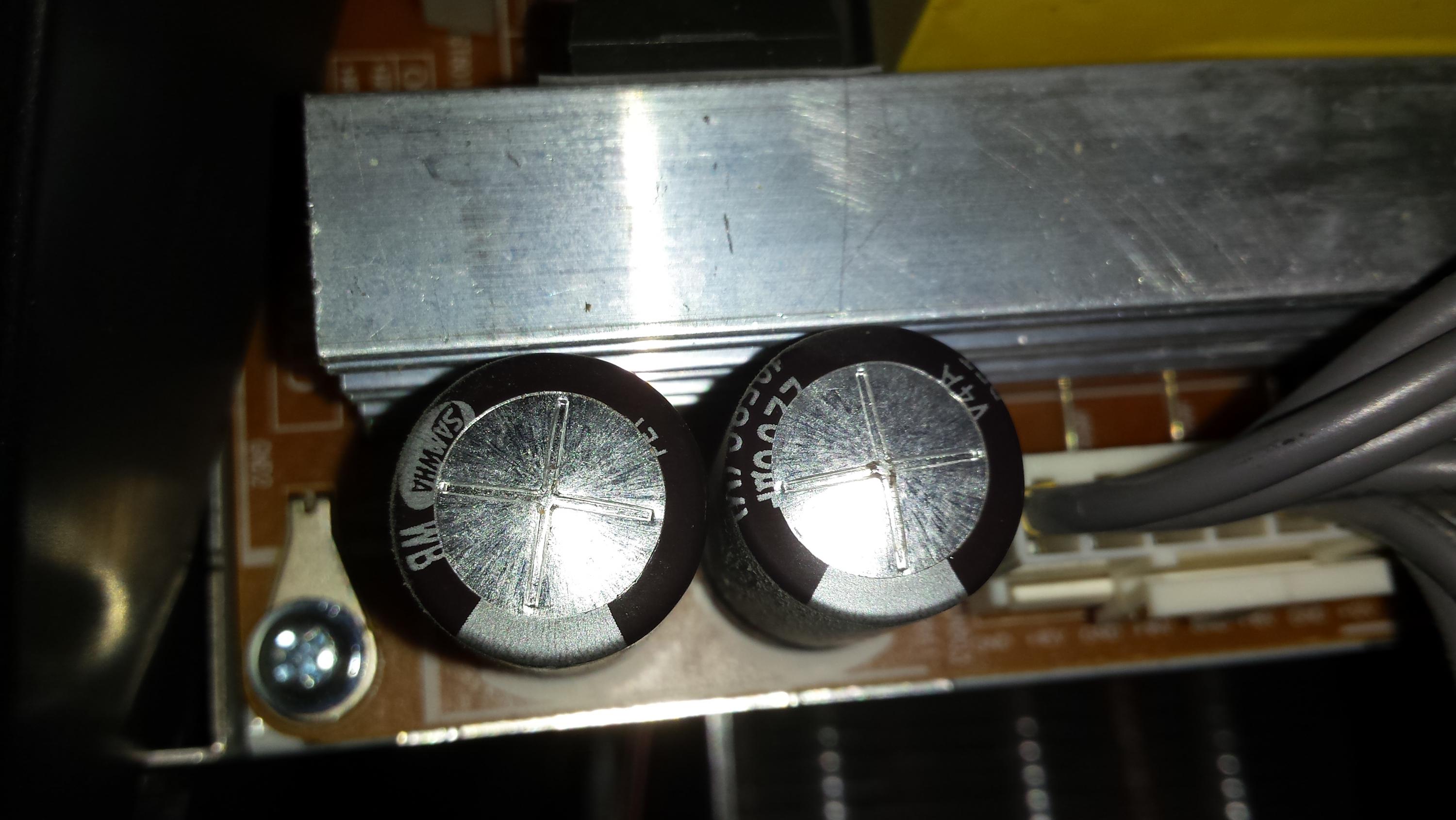

    In my 62in Samsung HLT6187 i found 2 bulging caps on the secondary power board i replaced them with new caps. Does anyone have experience with this issue on these tvs it is an led dlp tv. It cycles through the power up for a few secs than all three leds on the front flash three times and than it repeats. It started out taking longer and longer to turn on each time until finally it just cycles through without ever coming on. I am going to replace the rest of the caps on the board even though they are not bulging yet. Any advice would be appreciated

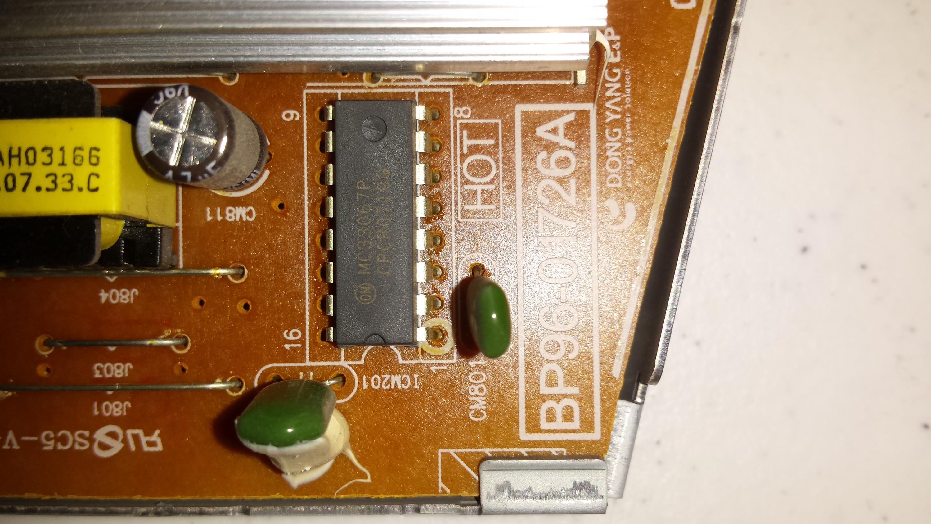

    Here are some pics of the boards

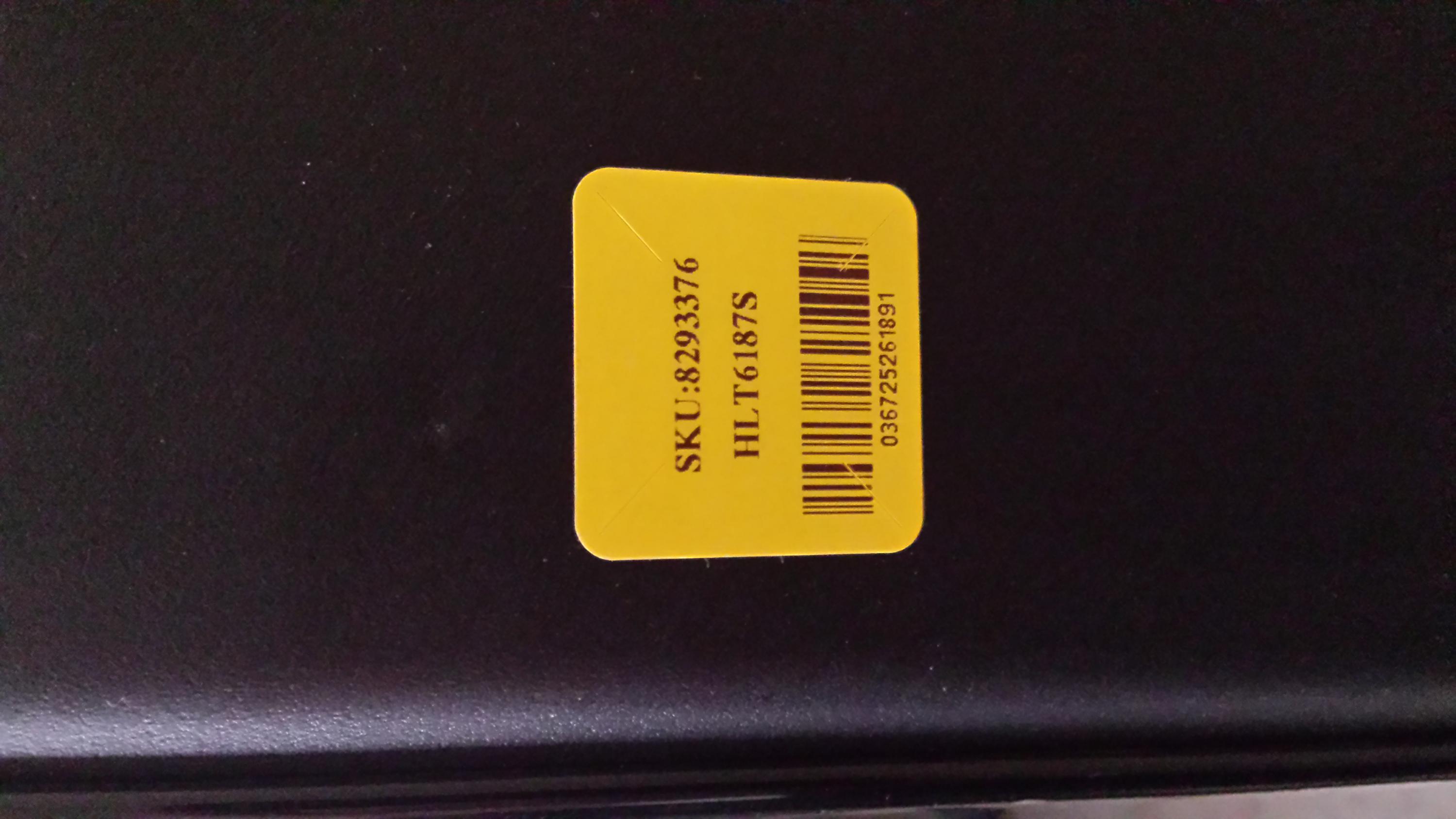

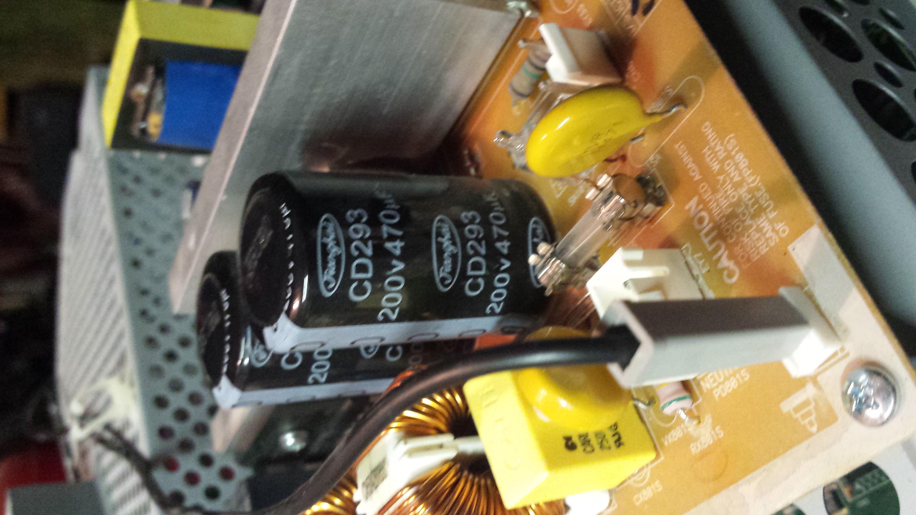

        Can anyone tell by looking are the caps in the third picture with the black tops bulging or is that normal for that type. I apologize for the pics im posting from my phone so once i am home and can get to my pc i can post better ones if needed.
              That is normal for those to look like that.

                Ok thanks magicsmoke i was not sure. Those are on the main power board, the ones i found that were bad were on the sub board but i wanted to double check.
