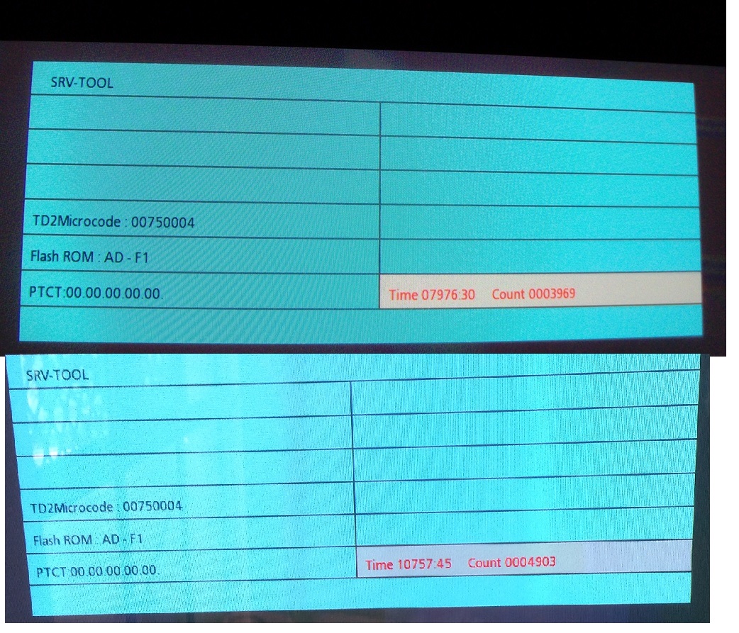

                        approx 2800hrs and 1000 cycles since repaired, will be 2 years, in december
