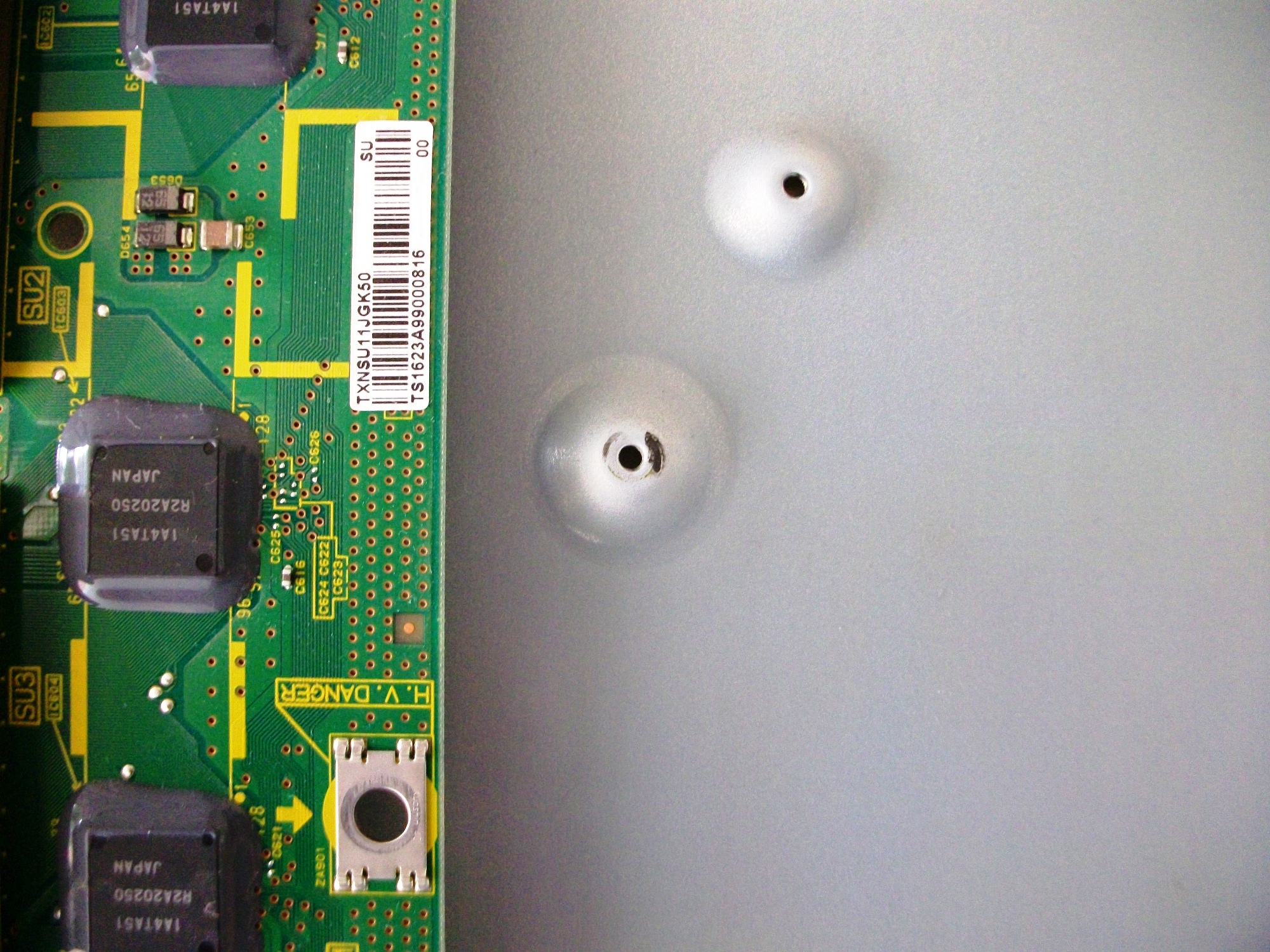

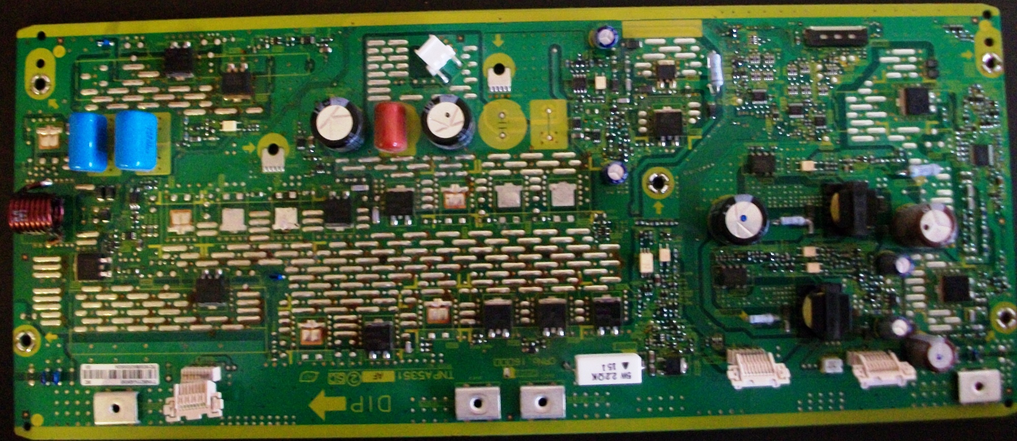

    I picked this one up today, don't have the blink or LED status as I've decided to not power this up already knowing most likely shorted SC. It was described with either locked solid LED or may have been none but i was told no blink codes.

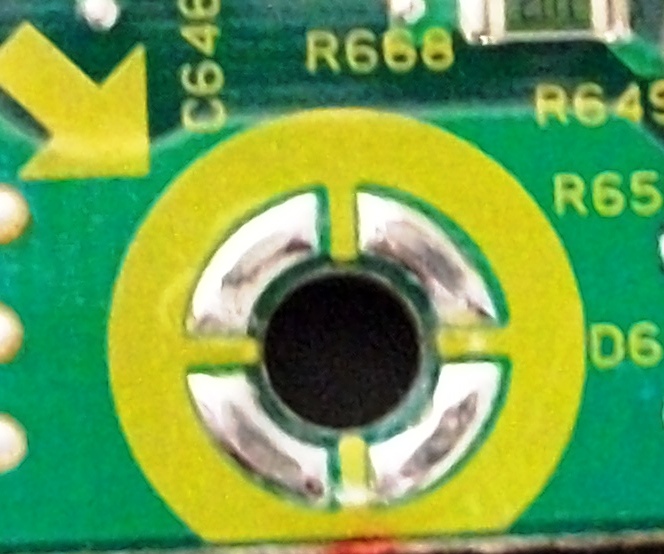

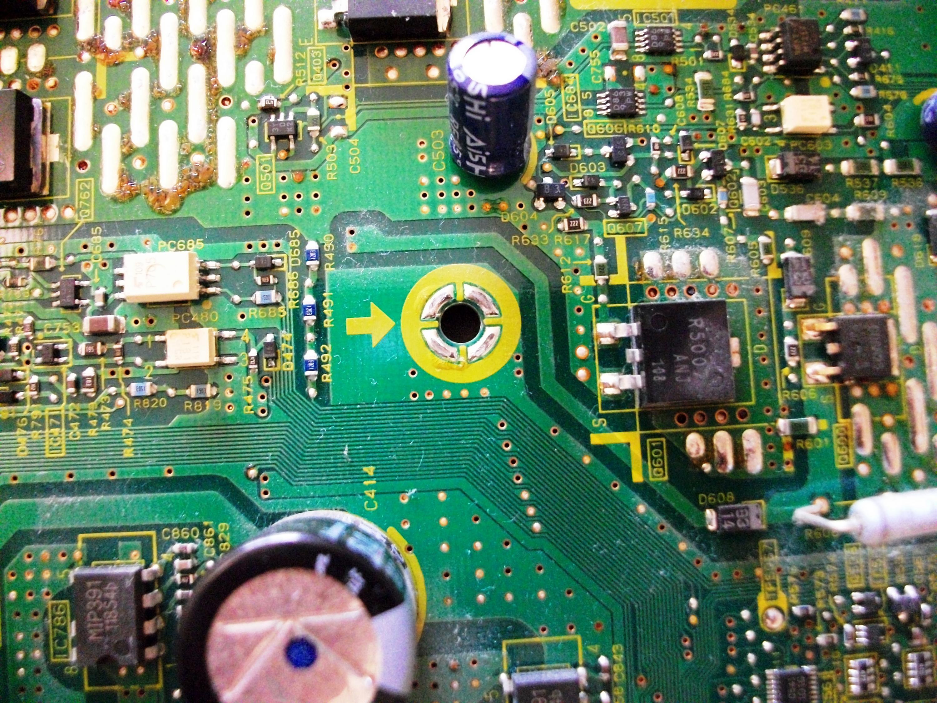

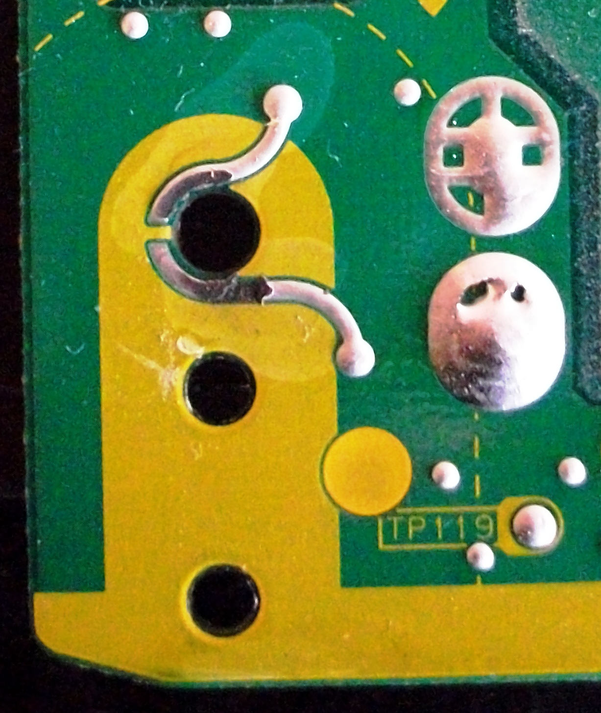

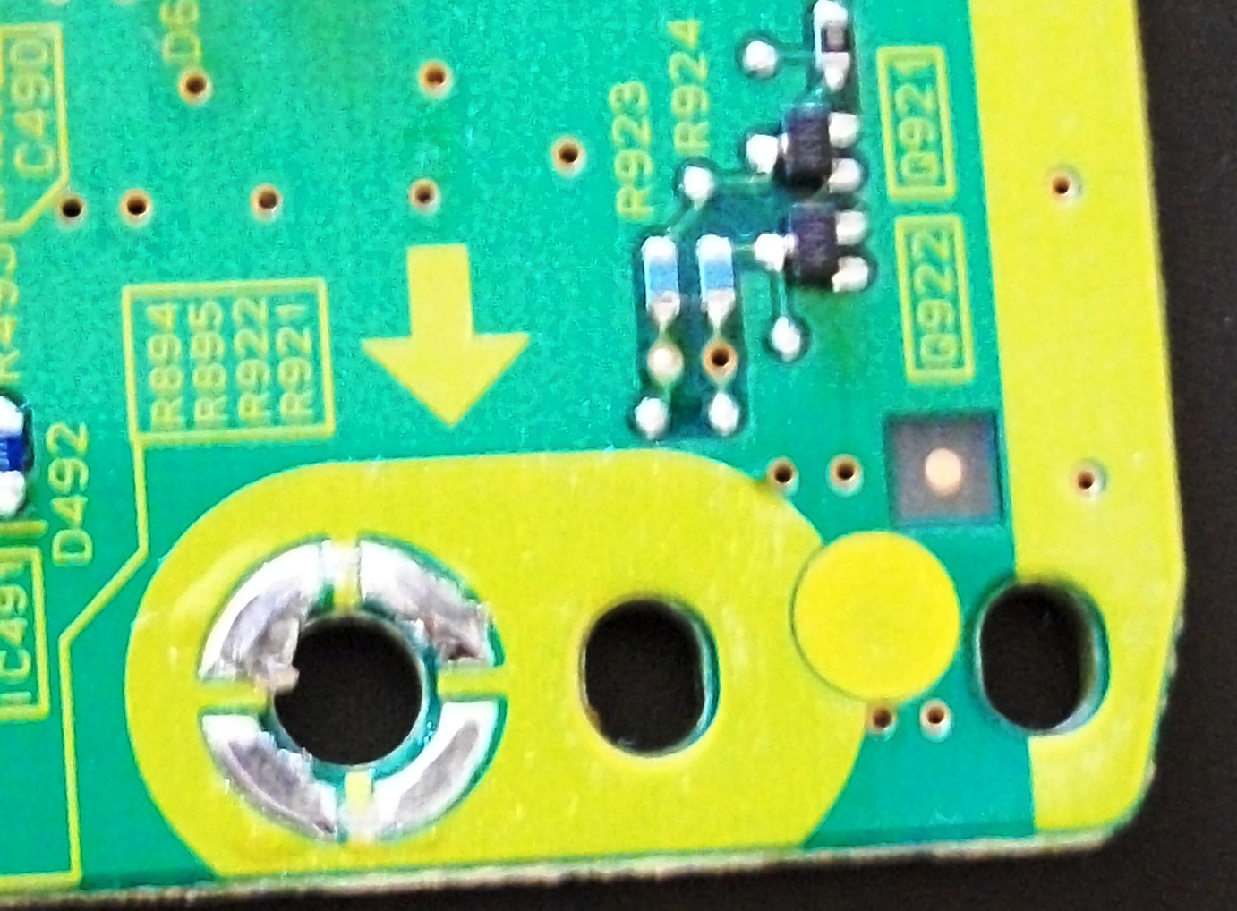

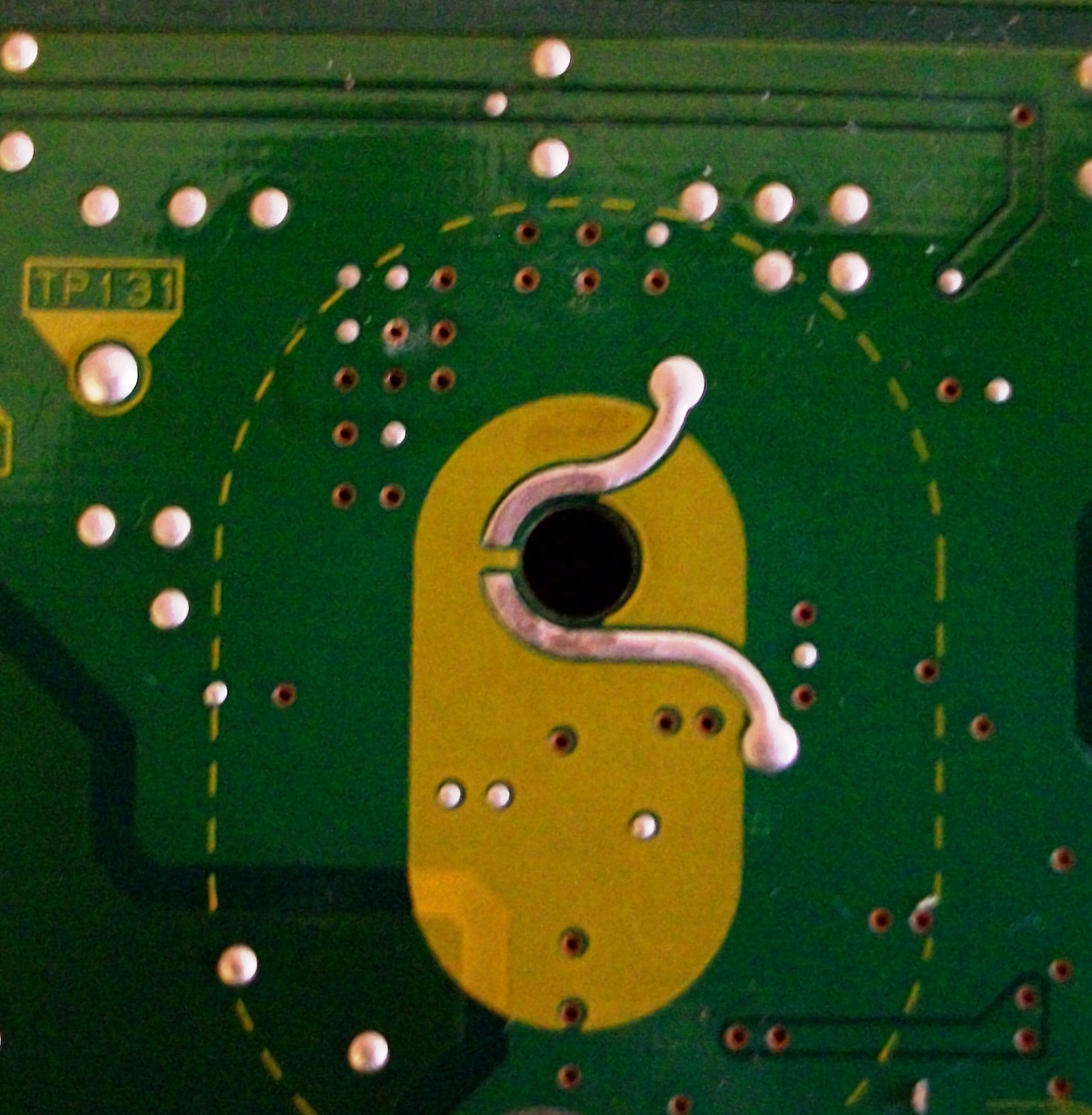

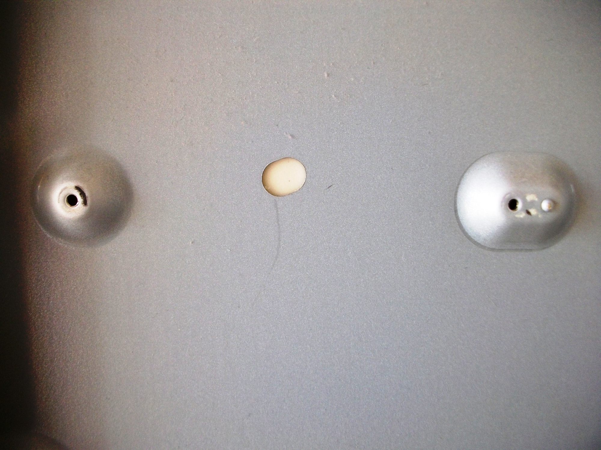

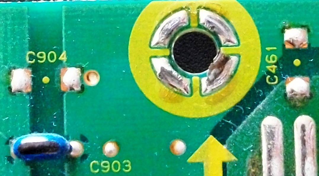

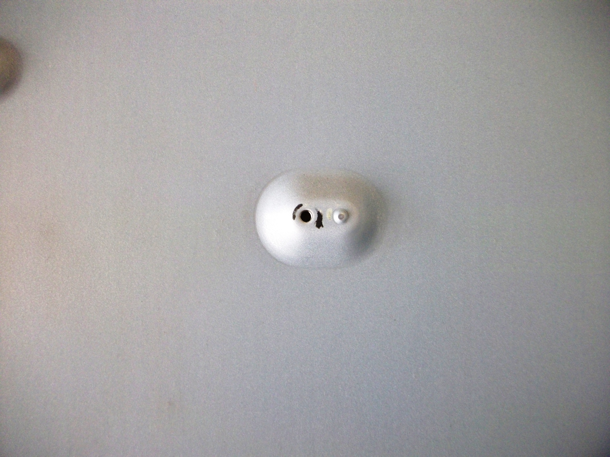

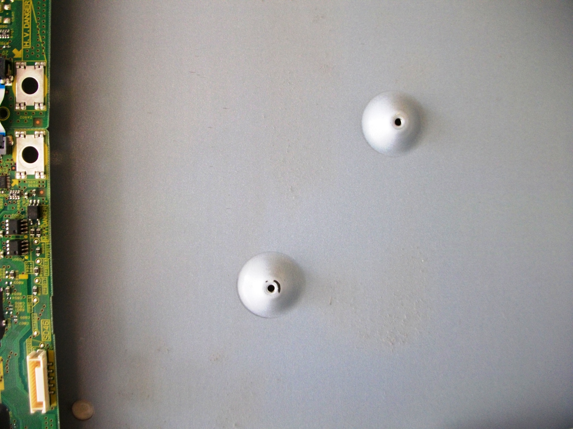

    Just jumped straight into it and SC2 100% dead short, 4 screws loose on the SC, arcing and burn marks underside, burn marks under the screws and solder lands also burnt and eroded away.
    very poor in comparison to my 2010 model and very poor of panasonic not to provided out of wty or recall. these are doomed from the day out of the factory.

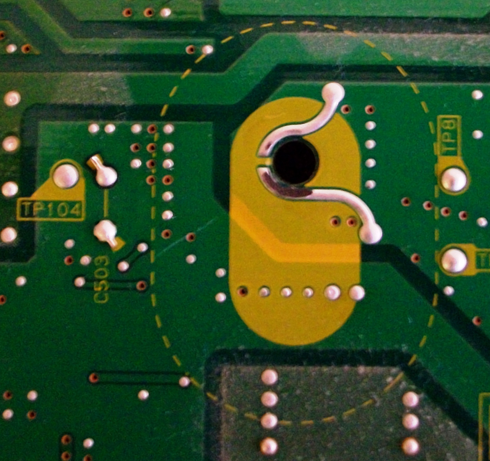

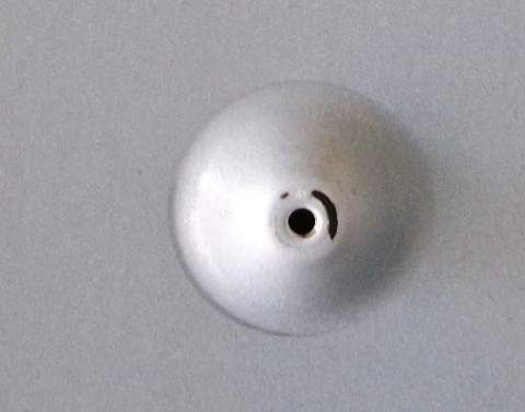

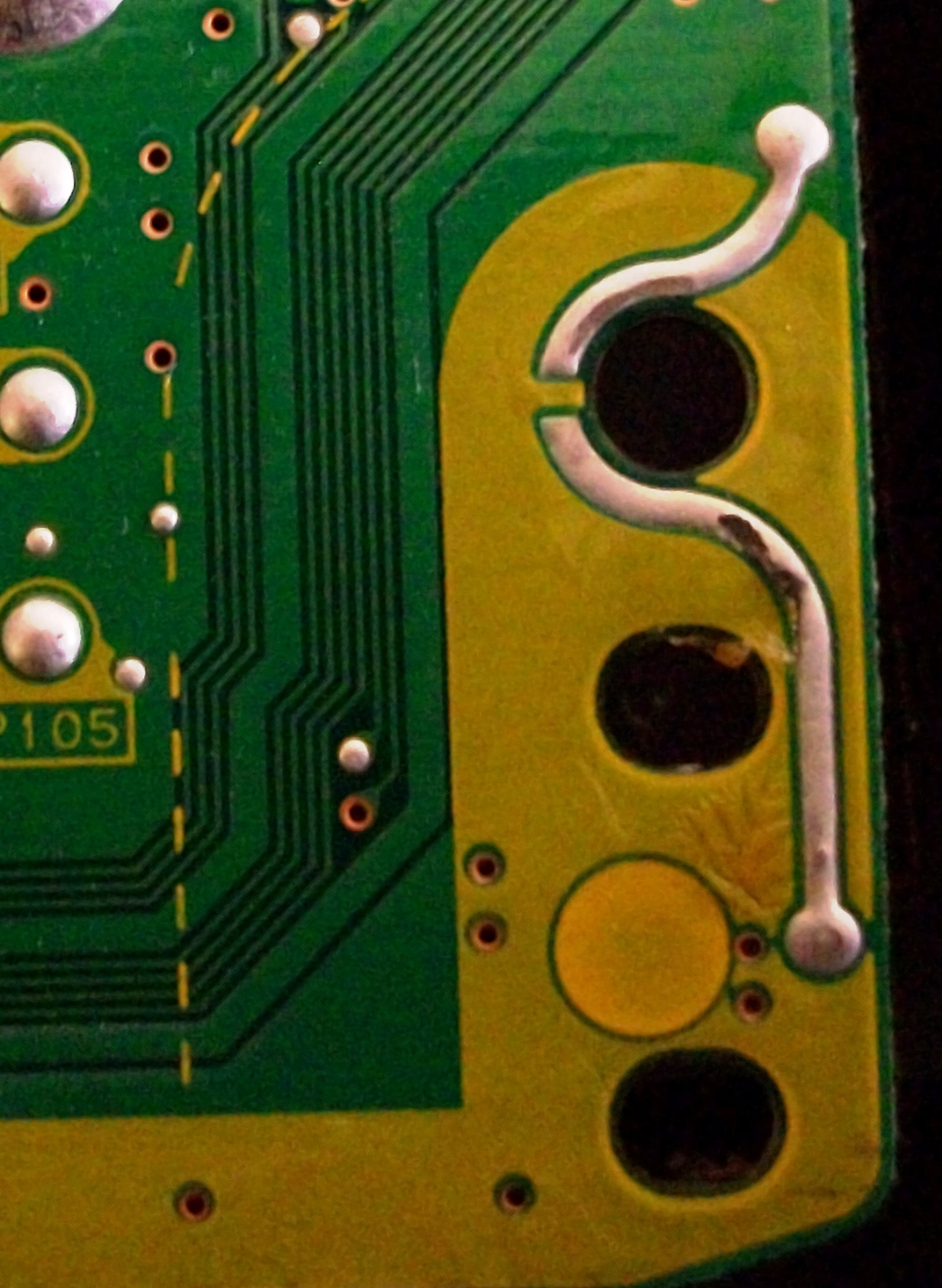

    Also these screws are not even dead flat, slight concave under the heads so only the outer rim contacts the board.
    Looking like just GT30F131 and the 2 diodes although there's more than 4 30F131 showing short, hoping it's not all of these but I am going to sub these with FGD4536TM, from RS components so no risk of chinese copies, and about $1.50 each so cheap repair it should be. Also I'm going to use RF1501NS3S for b both as it's higher spec than the RFN10 and they are pretty common on panasonic sustains which I've scavanged.
    I'll get some shots up showing the burns etc down the track
    Re: Panasonic TH-P50U30A SC Board TNPA5351 AF failure

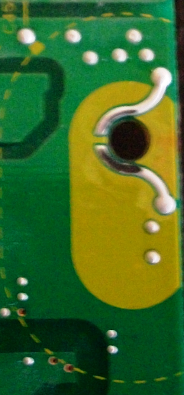

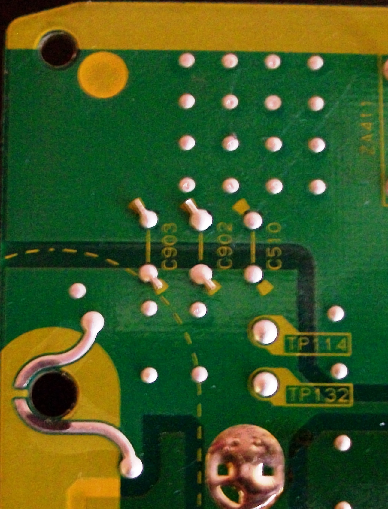

    Well packed the camera, no batteries or charger, poor cameraman but hopefully everyone gets the idea. Similar to all the other reports posted up.
    What I'm thinking of doing is using solder tags and soldering them over the mount holes underside giving a larger contact pad and 360 degrees coverage.
    If anyone thinks this could be an issue, sing out.

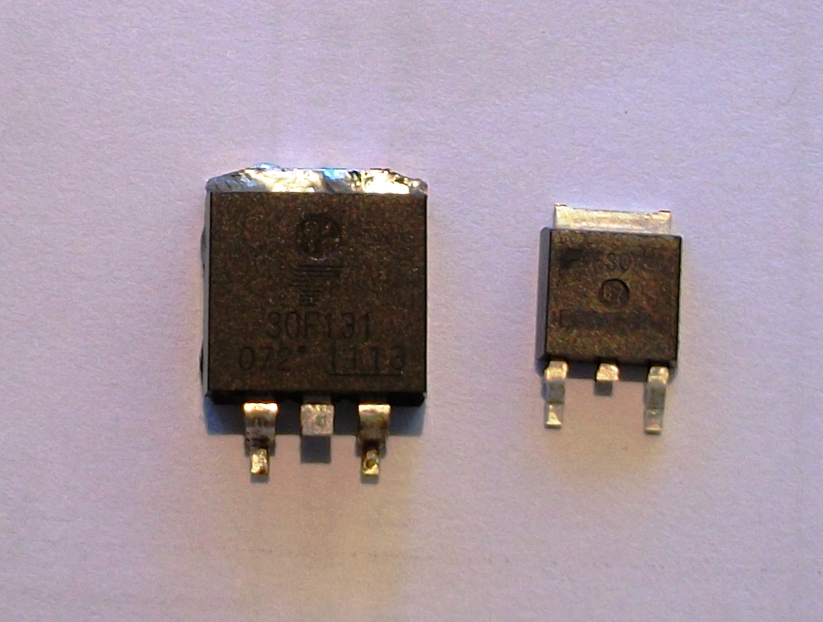

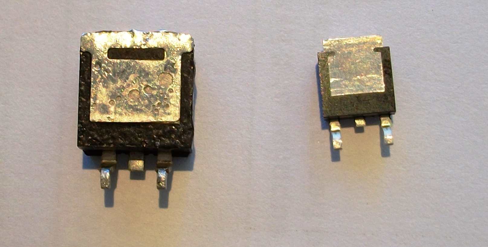

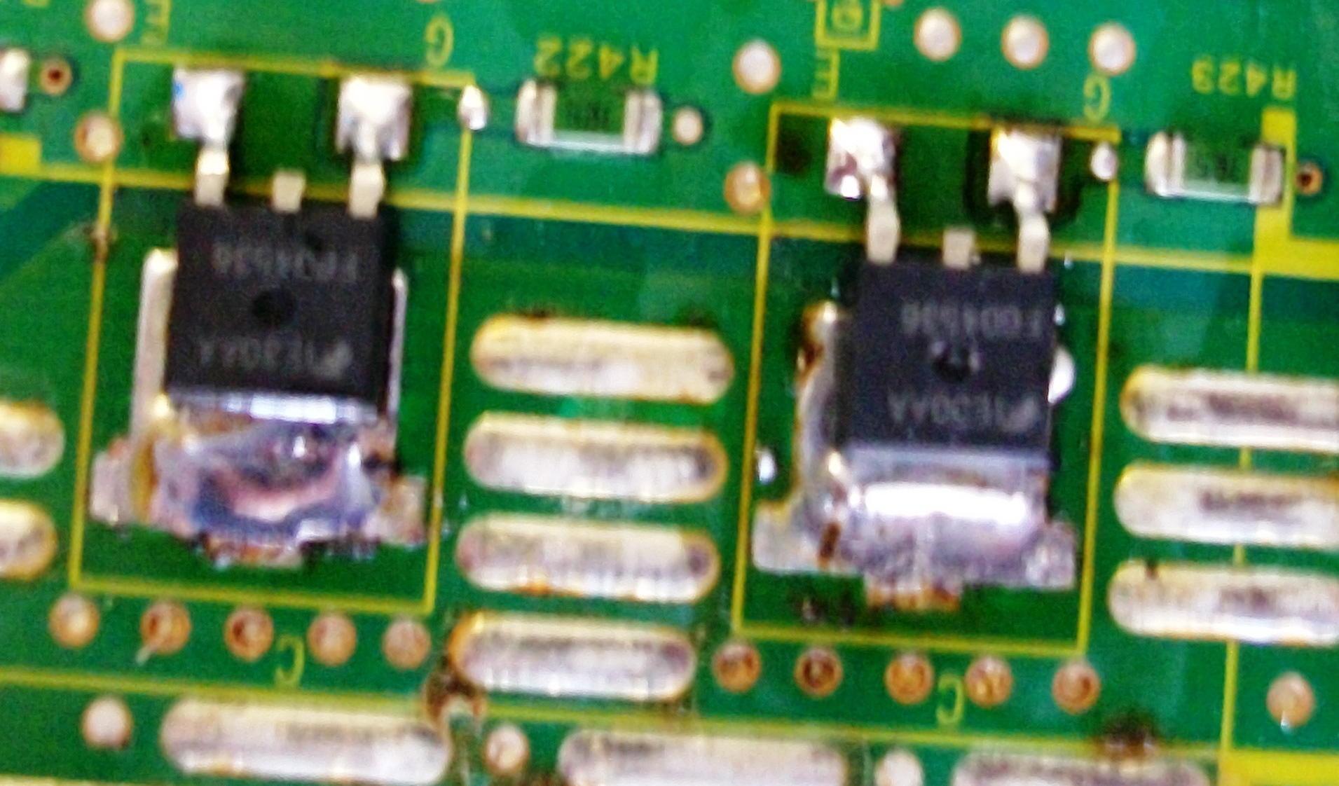

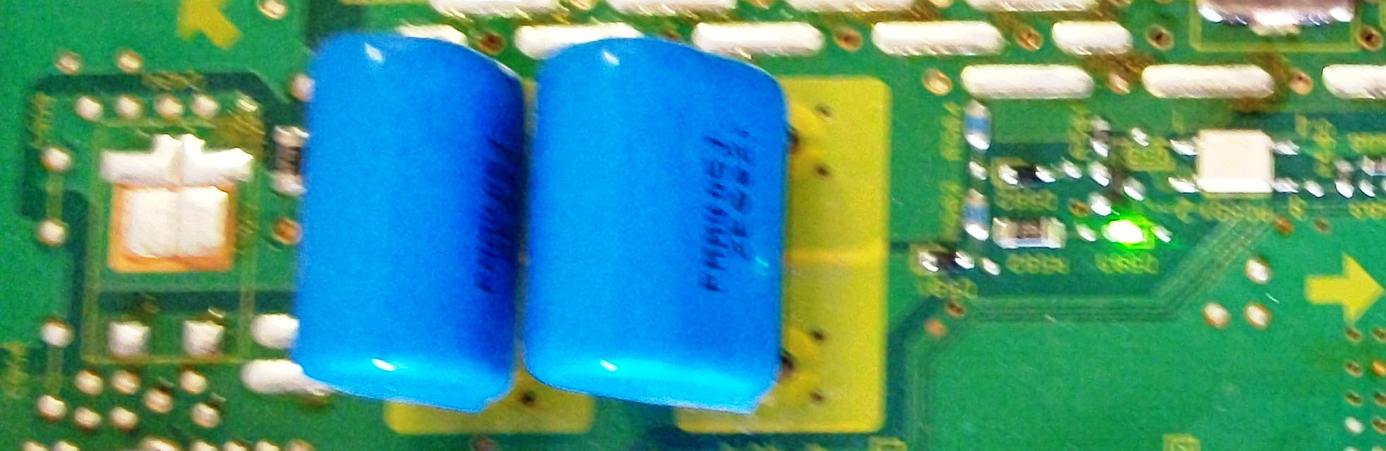

      Diodes(D401,421), gate resistors just fine(R402,403,422,423), just 4 x 30F131 (Q402,403,422,423), drivers and cph5524 transistors fine.
      Initially gate resistors were off, R402,403 were 5 ohms, R422,423 were 7.2 but once all shorts removed all reading 7.5 ohms.
      Also something I noticed. I've seen the driver ICs advertised by a UK seller as D86903, C0ZBZ0001822.
      Well the full part is BD8693FVM-HVT, and the marking on the case is D8693. The "0" is in fact a round impression in the case, looks like an O, at a glance I guess 0.

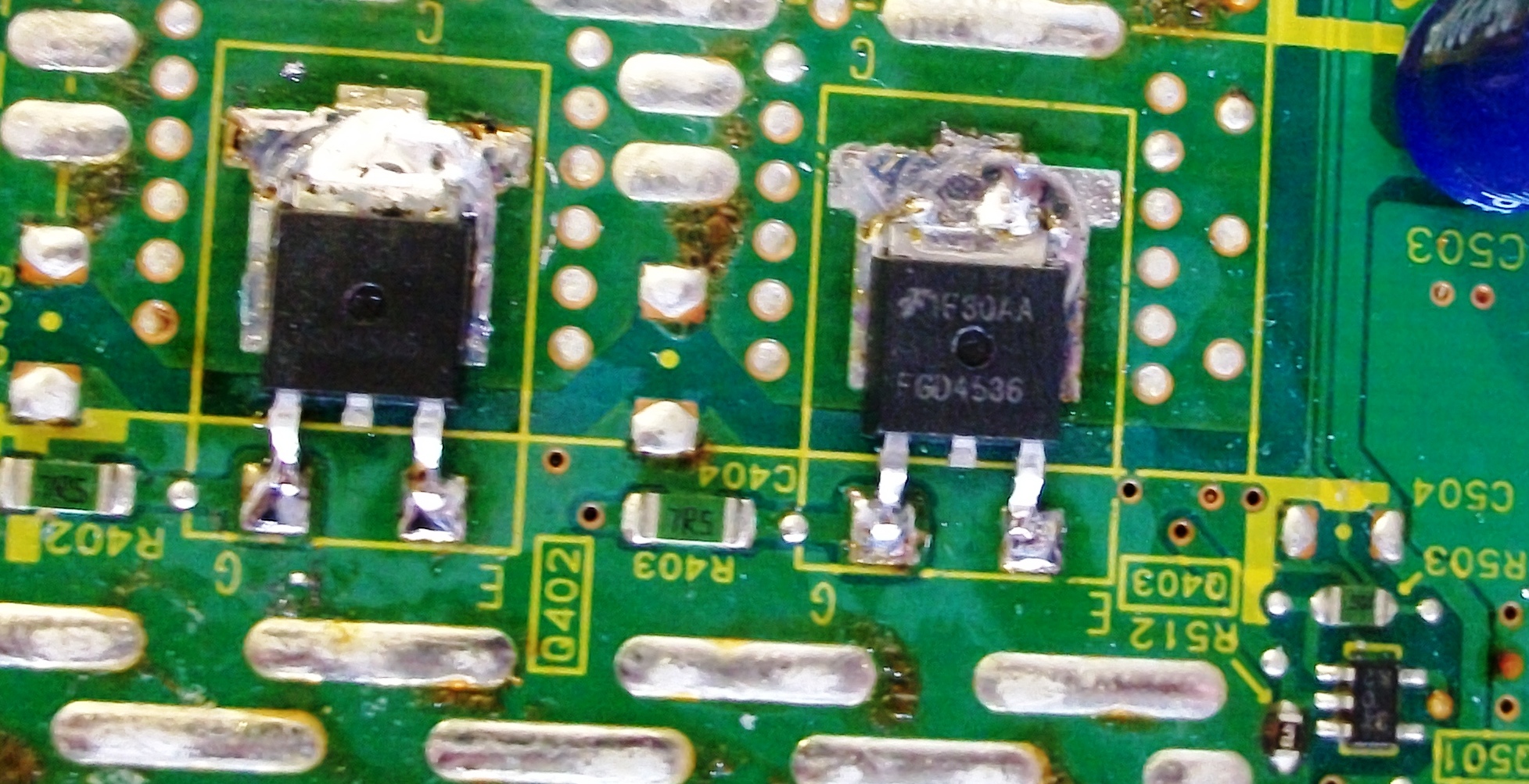

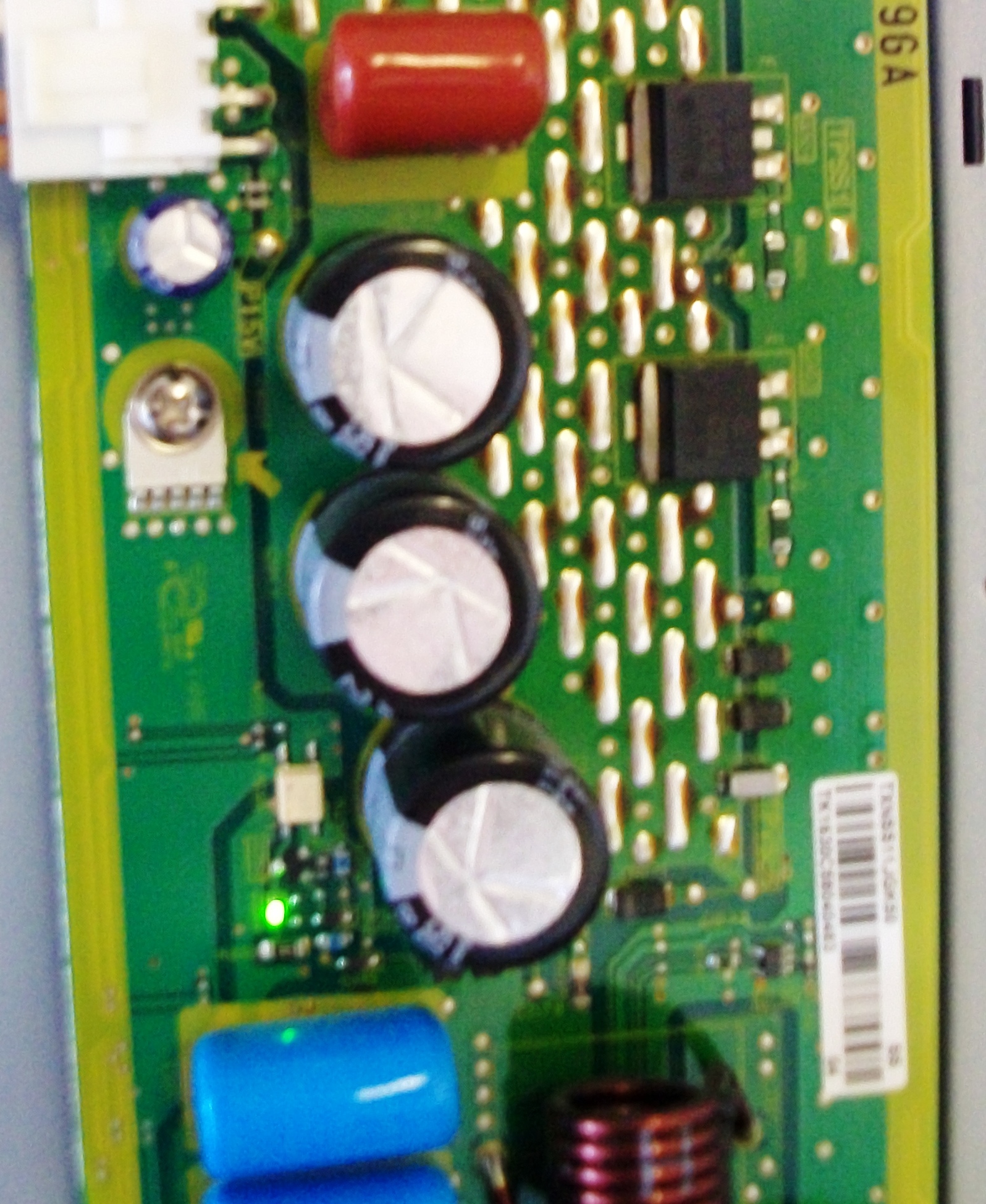

                    Ok, I think I have a problem. - FGD4536TM arrived and looks like I needed to pay closer attention.
                    Spec wise this should be fine but seriously so small is it really going to dissipate enough heat?
                    Also RS had these listed a P channel IGBT, I'm pretty confident that's wrong.
                    Any thought? Put them in and see or what?
                      No, I wouldn't use them to fix it, the case resistance will be higher so it won't be able to dissipate enough heat into the board. Maybe as a quick test, but not permanent.
                      P channel IGBTs are theoretically possible, but I don't think anyone has ever made one - there's no need to.

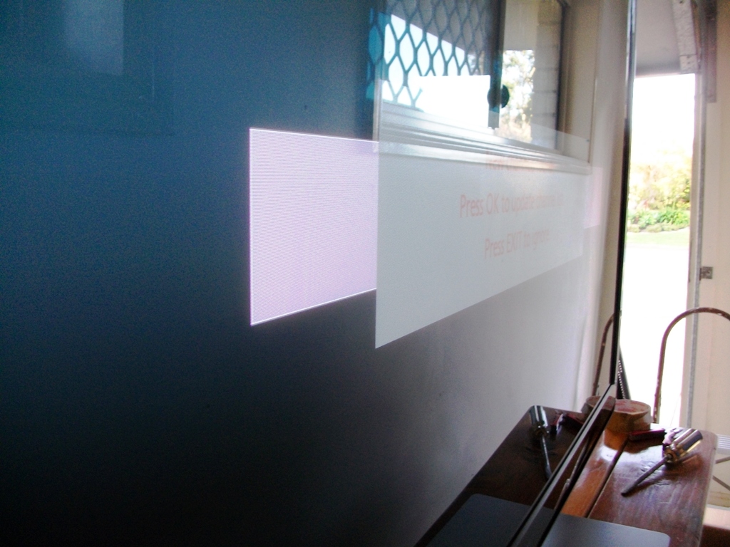

                        In the interest of science, I forged ahead (LOL). Got them in just, problem was making suring 100% of the tab was soldered and getting the legs to reach. Just makes it .
                        They do say these are designed for PDP panels and so it fired up fine. Running full white, they appear not to be getting as hot as the remainder of the 30F131.
                        These heatsinkless boards are eerily quiet. Full white is not exactly like the old models, definitely washed out a bit but nothing abnormal at least. Has about 7500hrs

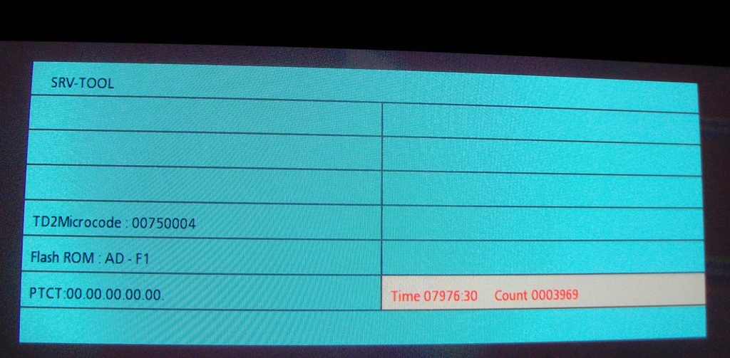

                        can also confirm the SOS history was 00:00:00:00

                            Just be aware, if one of those small IGBT/FETs dies around the ramp ckt area, it's night-night for the buffer board!
                            Turn off C.A.T.S. in the user menu to do a proper full bright test. (Or service menu full white works too.)
                            My experience with the U30B was it had a very faint buzz but that was all.

                              I was running in serv tool. My ears have re-calibrated over the years so I could only just make it out.
                              Seems to have a clearer image than my 2010 FHD

                                  I think it's definitely related to the arcing of the SC, but then 8000hrs is probably about right these days.
                                  I found 1 screw (very top ) on the SS burnt and loose. The SU top screw was also a little loose.
                                  replaced all the SC / SS screws and the top screw at the SU.
